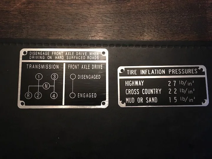

Here are the extra plaques that i have. I got these from Metric TLC.

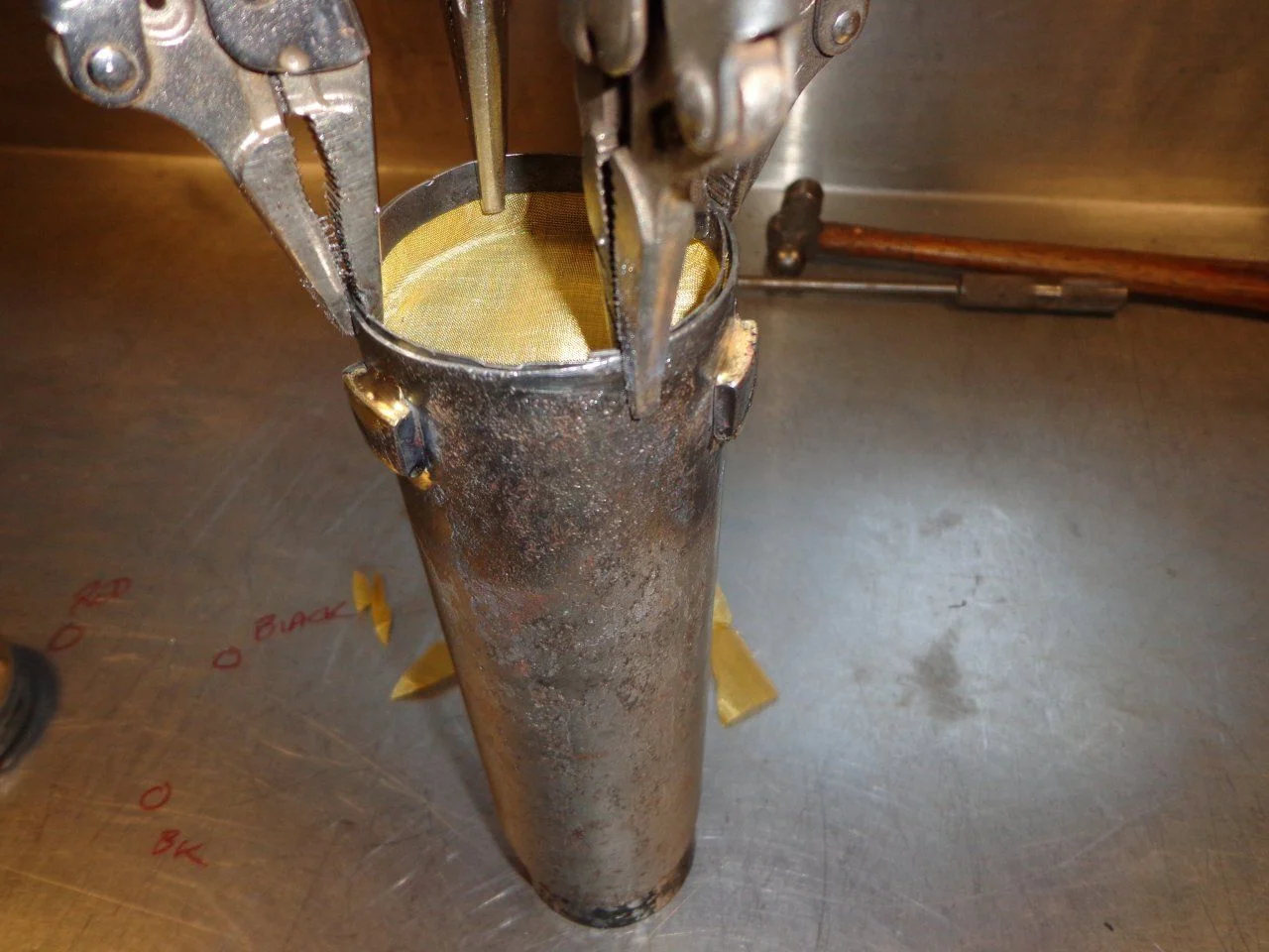

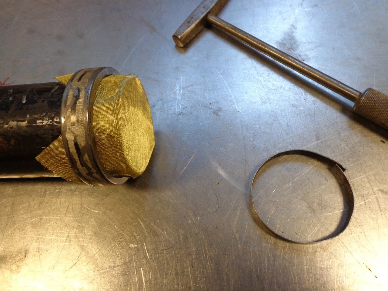

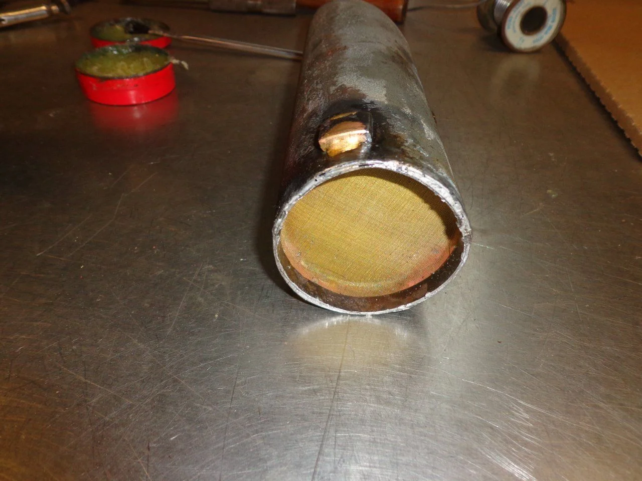

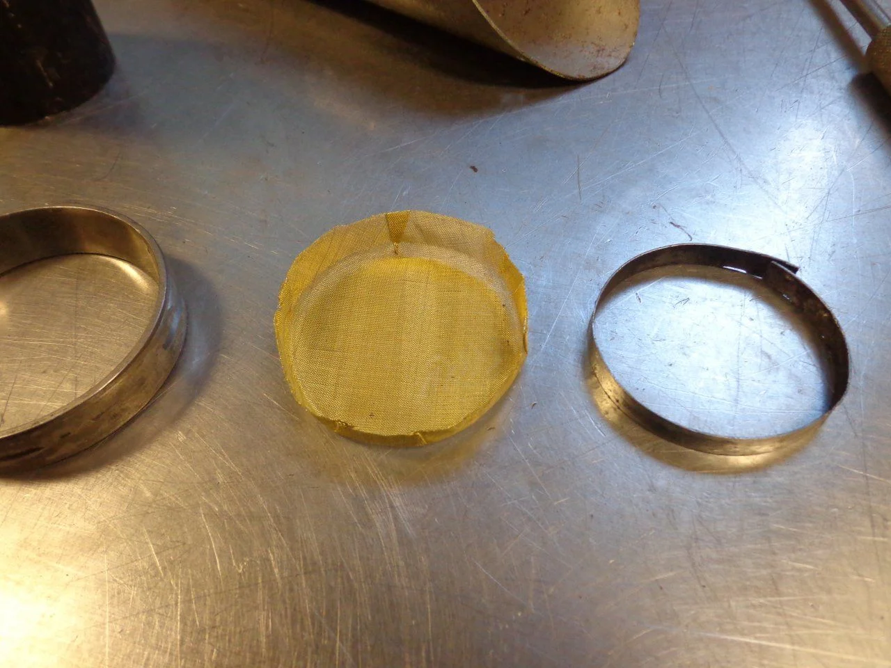

Finished the gas fill pull out funnel from post 215, braised on the 3 key way plugs so they don't fall in the tank. Made a die to shape the brass filter screen from a piece of 2" pipe and an old bearing race, soldered the inner retaining ring. Sound easy? Not at all, 3 hour job, but done.
