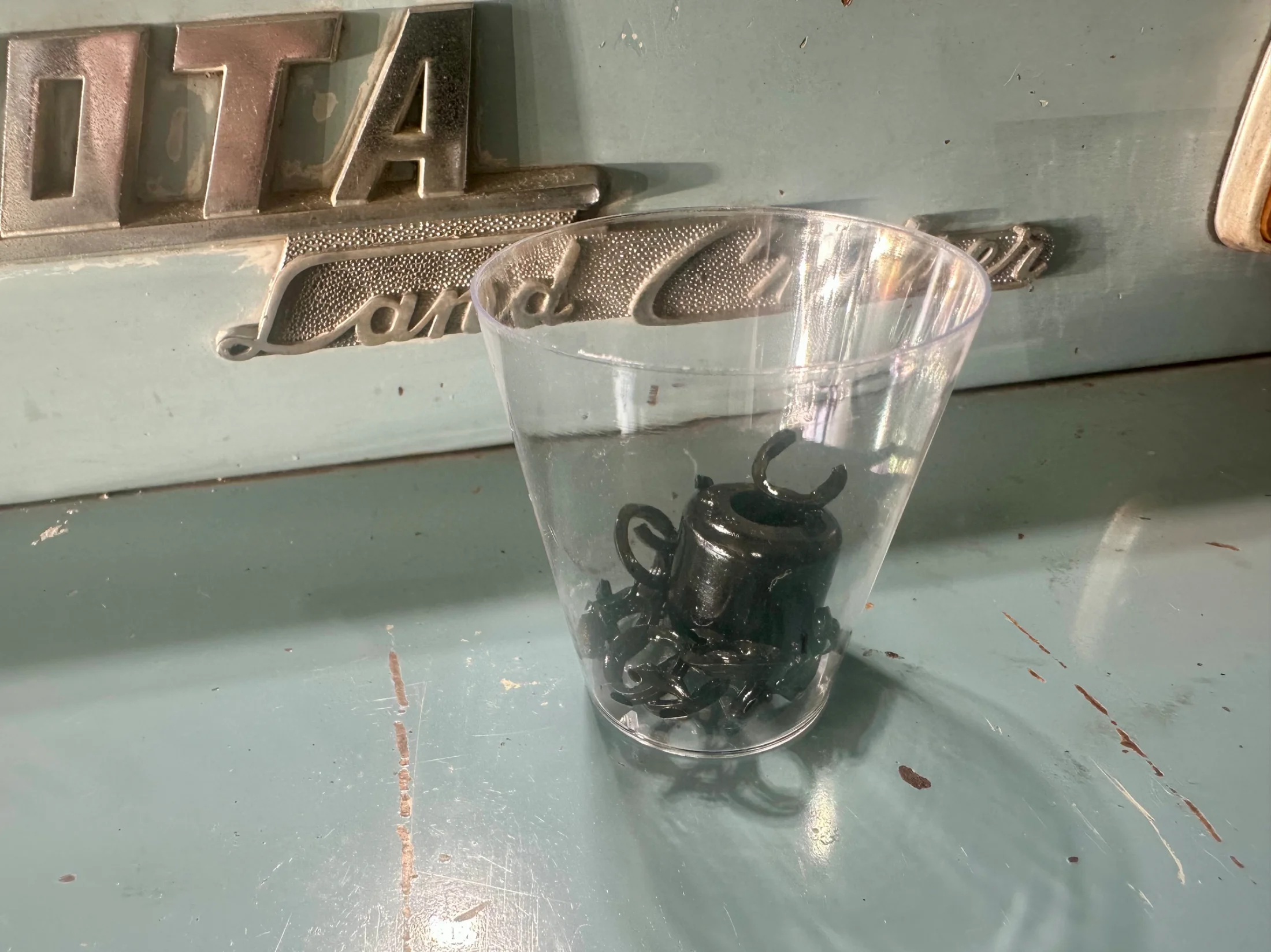

Must be… cylinders 1-3, only 1 valve seal. The rest just a tiny mangled O’ring.
All 12 seals are done, here’s what came out. 1 actual seal and 11 O’rings pretending to be seals. 🧐. Going to clean up the rocker assembly next, then reinstall.

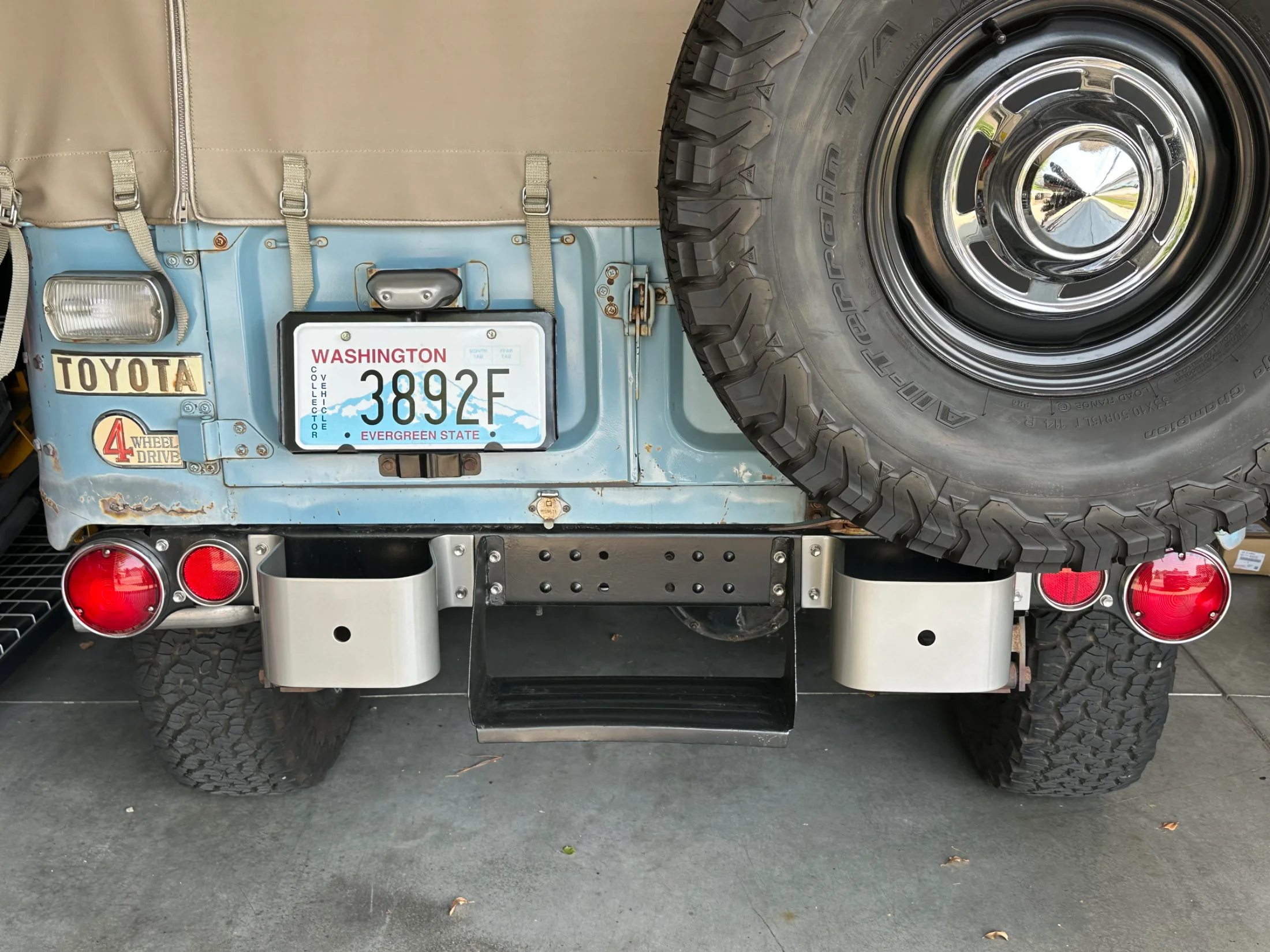

Bit the bullet and ordered a new front bumper and rear bumperette’s from the local Toyota dealer, next day delivery! Installed them today.

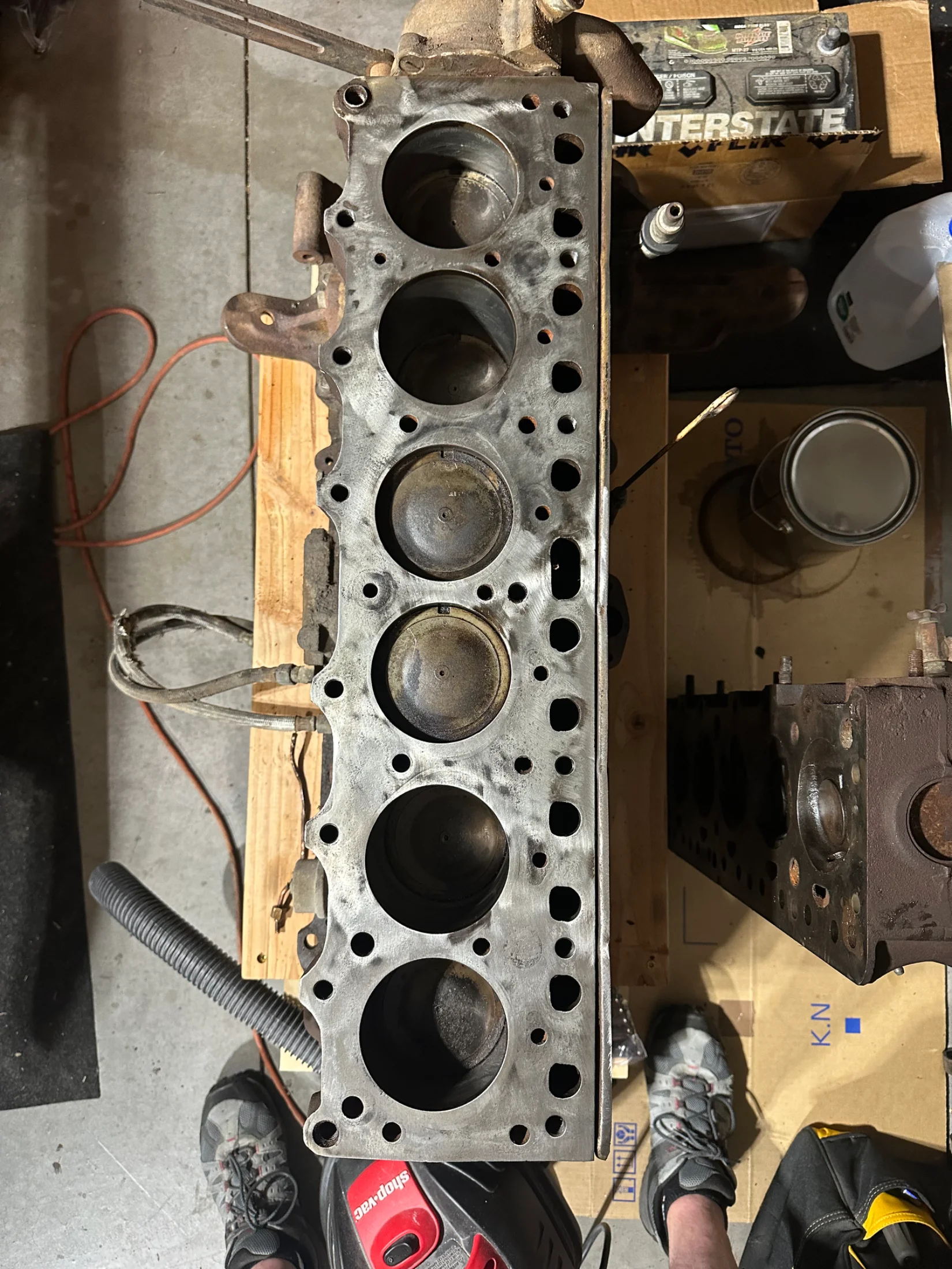

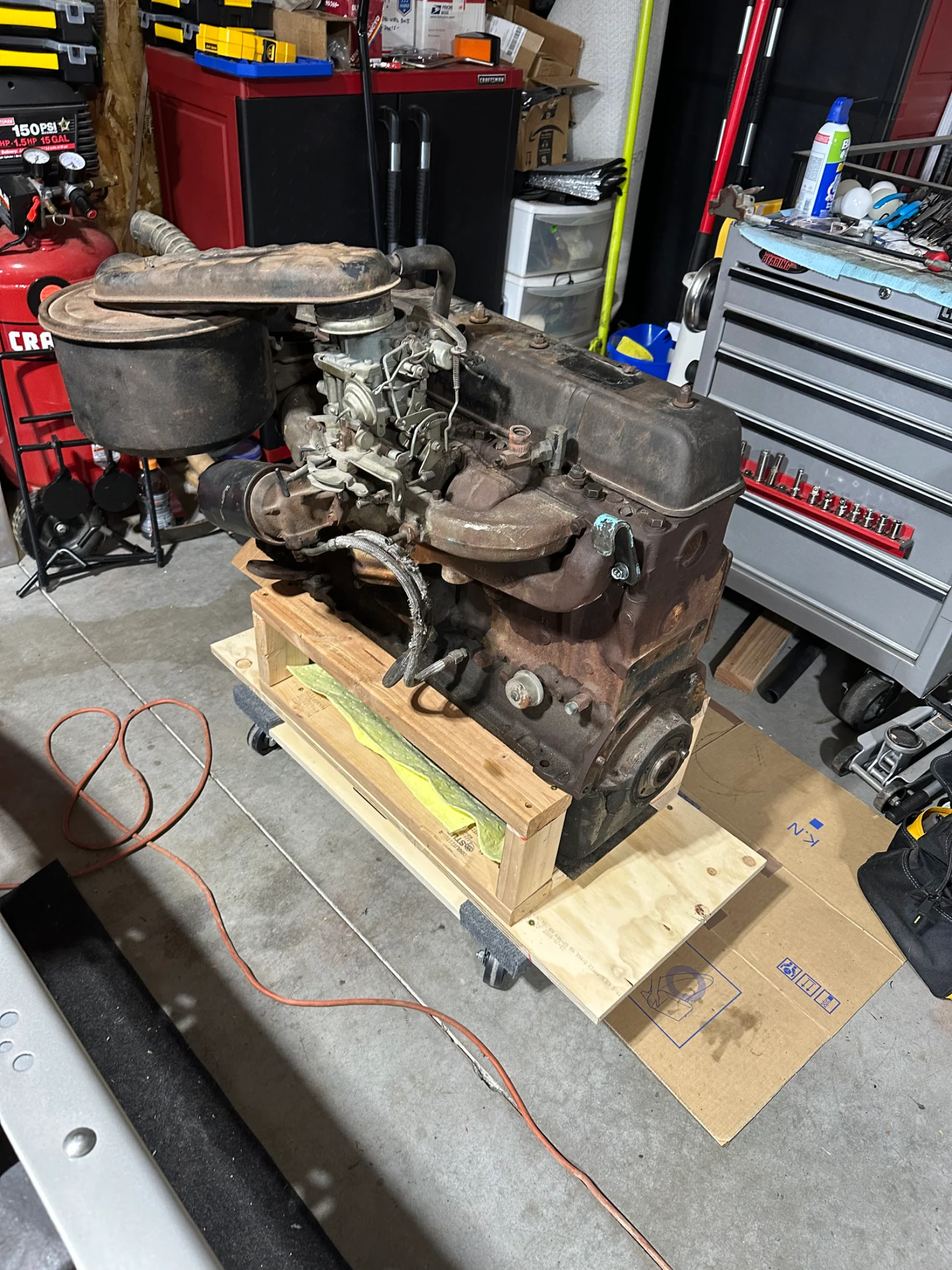

Guess I’ll drop this here… picked up a late ‘72 1F motor within 1000 serial numbers of old blue’s stock motor. For the price with an OEM Asian Carb it was a no brainier to have a spare block. I guess… 😂
According to the seller, it’s been sitting for 30+ years.
Wrestled it out of my truck and built a special dolly support stand to wheel it around the garage. Because I need more Cruiser junk in my tiny garage. 😂

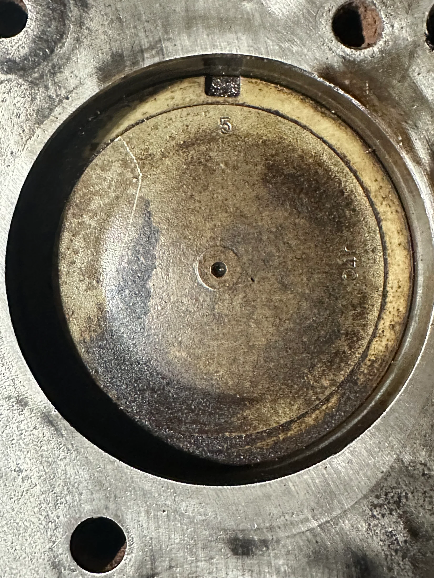

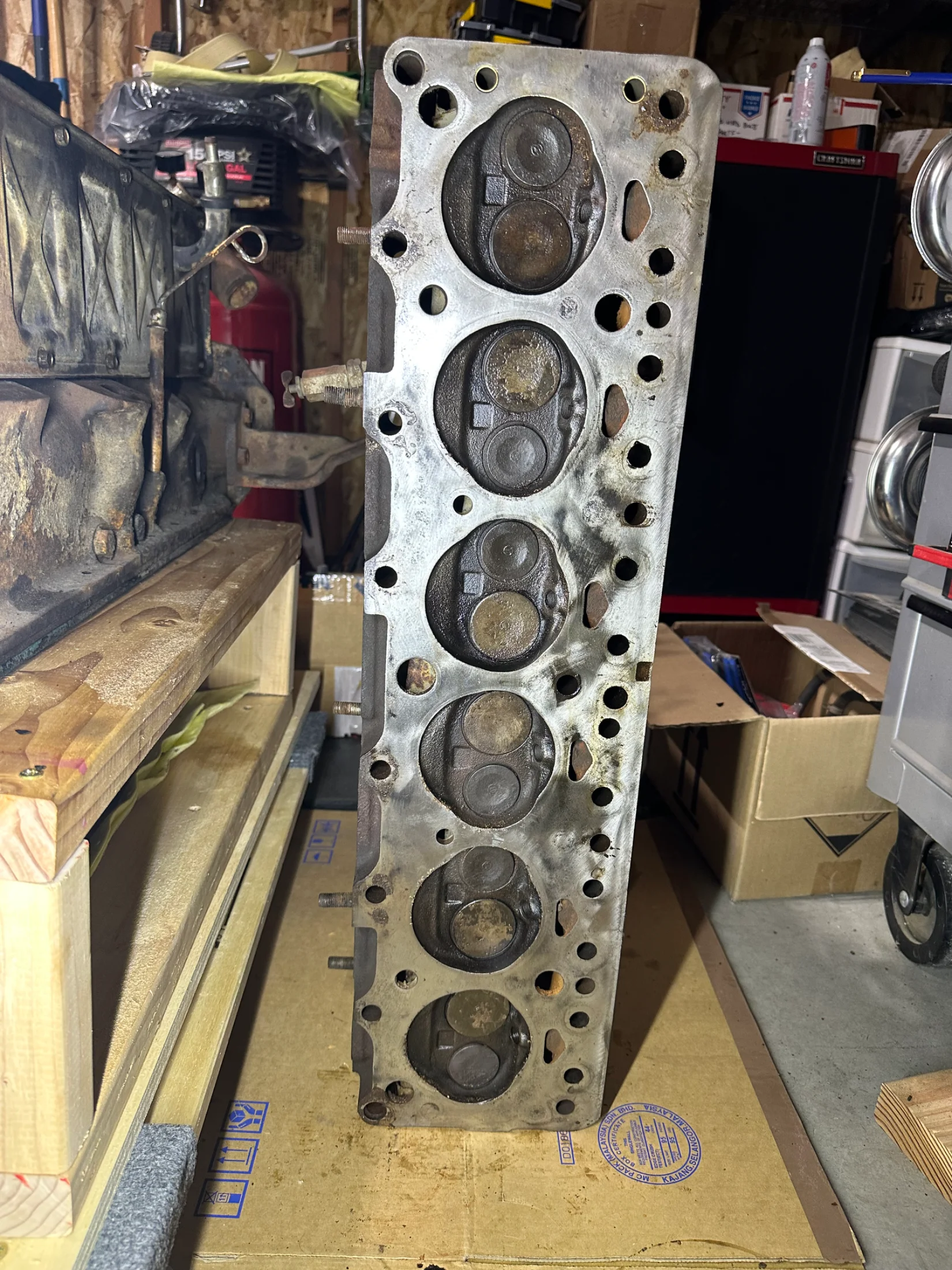

Pulled the head off tonight. Nothing looks out of whack.. cylinder walls looks good, not sure if these are OEM pistons. 🤔 .040. @Skreddy come by my house if you’re in south Spokane 😂
