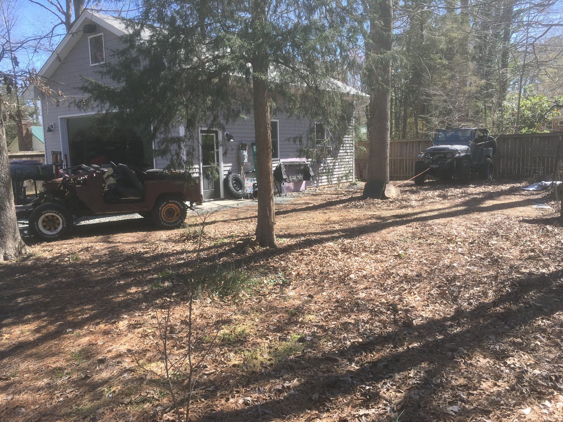

Are you like me in that your winch gets used around the house/shop more than for trail recovery? :lol:
That reminds me to make time today to mount the 8274 on the 40... Not sure what I'll use instead to keep the basement floor from blowing away, though. I wonder which of my neighbors I should call to help me with that? Maybe the new one.
Definitely the new neighbor. Break them in quick!
Also...extended my ‘winching when not wheeling’ streak to 2 days!
...and no, I did not drag it by the damage multiplier!
Keep it going...you'll catch up to my 40 in the "organic matter paint job" in about 10 years.

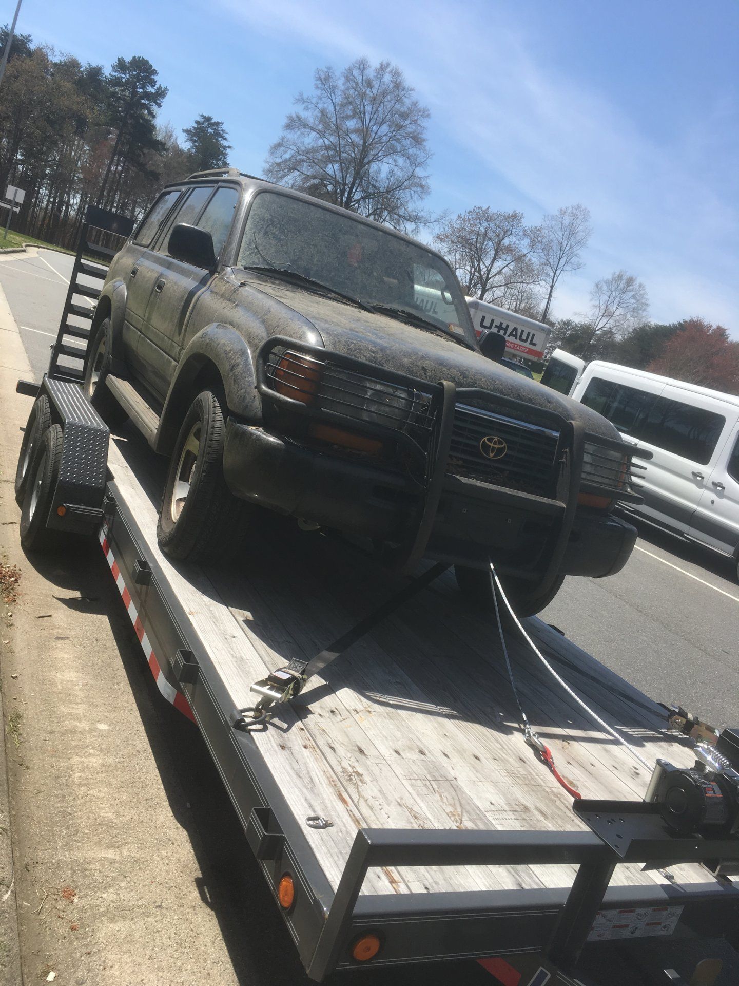

Brought the truck back to the shop from storage a couple weeks ago. Future driver getting acclimated.
Planning to swap in some 3fe exhaust manifolds in hopes of eliminating what I think is an exhaust leak...tic...tic..tic...
