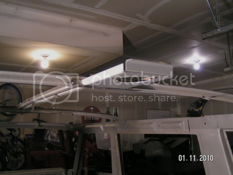

I took the interior light from Frank, cut it off, flipped it around, and put it above the cargo area in the rear. Relativly easy with the roof skin off. (I imagine this could be done with the roof on, and the headliner out)

I was thinking about your rear dome light idea - I am not sure if it will interfere with the headliner bows in the location right behind that rear roof support.
We were cahtting about it here: https://forum.ih8mud.com/fj55-class...ed-interior-dome-light-mount.html#post5423567
Just wanted to give you the FYI while I was thinking about this...
Jason,
I hope all is going well with this!
Yep, it sure will. Glad you pointed that out before I finished the roof. Should work just fine if I flip it around to the front side of the support. Easy enough, without the roof skin on.

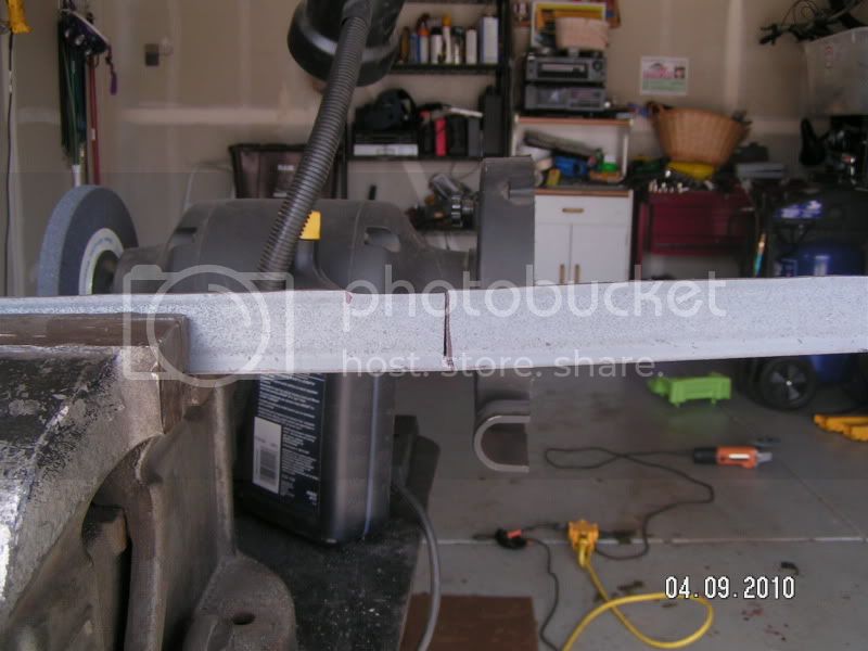

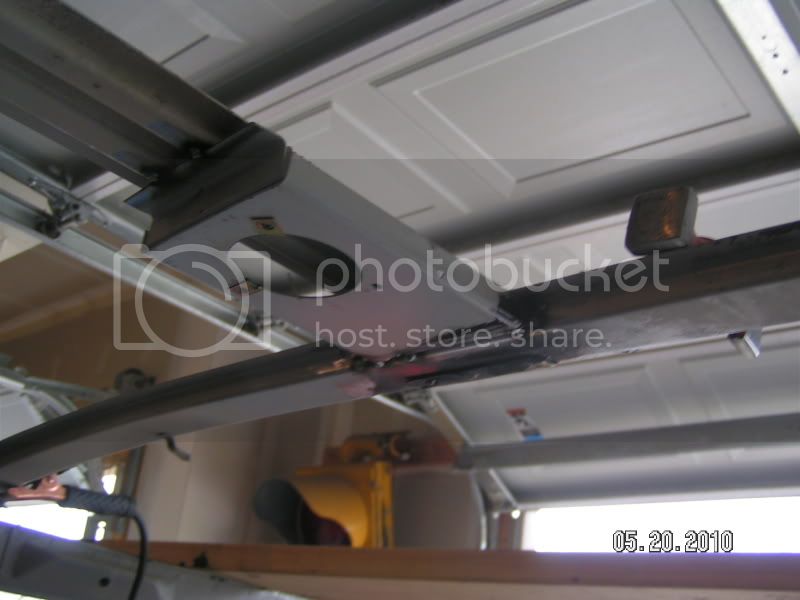

Amazing what a couple uninterupted hours of work can do....ladies and gentlemen, I present to you......ONE NEW ROOF RAIL!!!!! :bounce::clap::bounce:
A little wider, and way stronger than sheet metal, should hold one hefty load on the roof rack.
Now, a little how it got there.

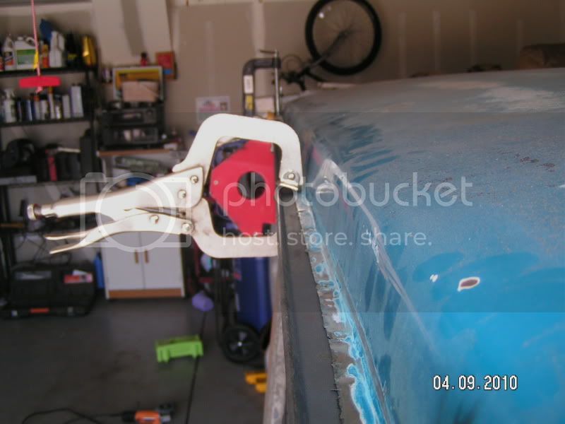

Lots of test fitting like this.

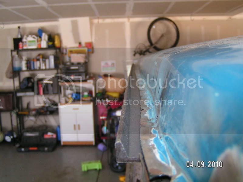

Mark areas that need to be ground down a bit, I shaped them around the B and C pillars, and at the front and back.
One cut, right at the B pillar to give it a bend at the front.

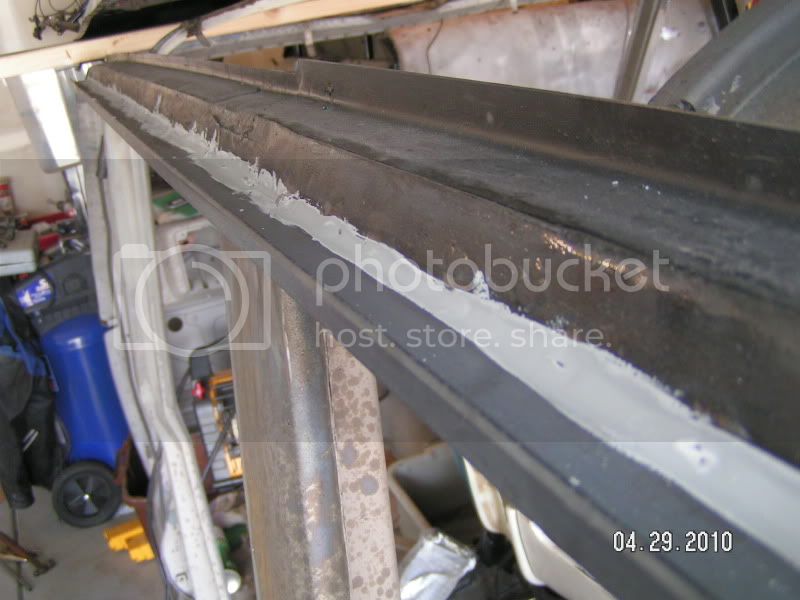

Marked where the spot welds on the roof skin will be, and ground through the POR-15, leaving as much as possible to delay the return of the most hated rust.

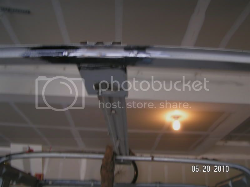

Clamped it back on, and tack welded it in place. Next step will be to lift the roof skin back off, and run a full bead down the top/inside of the new rail. That ought to hold it, and seal it up. Then, re-coat it with POR-15 inside, address the rear cargo light situation and repeat for the passenger side, and the roof is ready to button up. 3-4 months it should be good. (just kidding Elyse!)
after a week in mexico, celebrating my 40th birthday, I got back, expecting a good morning to get work done....but it is SNOWING?? But wait! It is Colorado. By noon it is 50 degrees and sunny. So I got some work done...
Welded the drivers roof rail on, and sealed it with metal patch (think wood putty, but for steel)

Oh, and I flipped the rear cargo light. (thanks again for catching that one TJ!) Should work fine now with the headliner.
