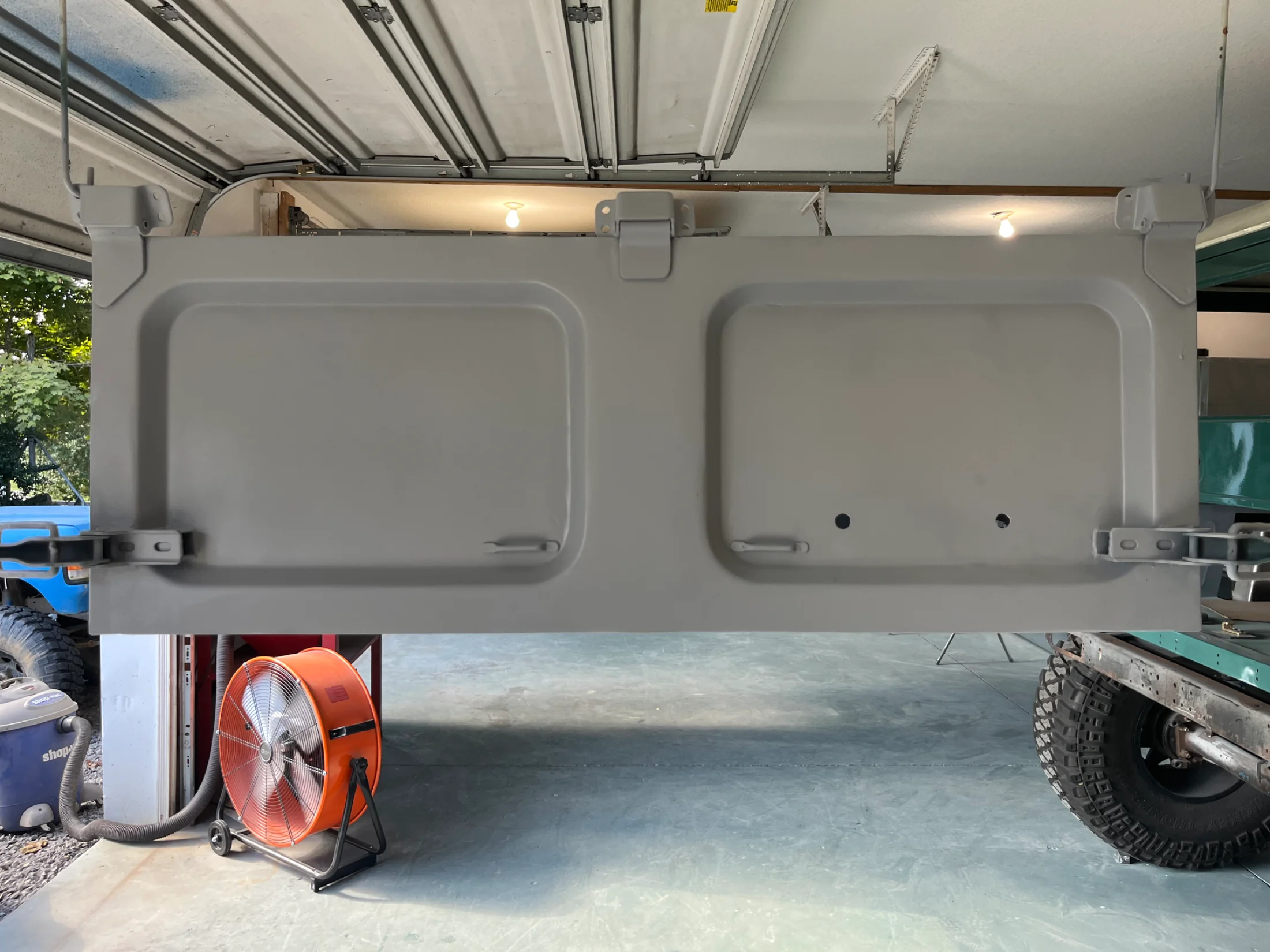

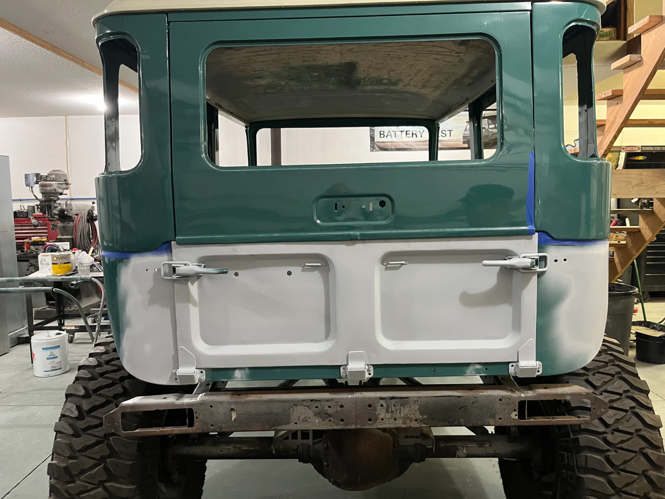

I assume you welded together a split tail gate and did that? Did you use the split hinges and modify?
Yes Sir.....it was the original barn doors and upper hatch. Welded a piece in the center to make it a wider piece and into a tailgate. Just moved the hinges and cut the one down that is pictured in the center to make it look normal. The latches are from a early model Fj45.
This is the same idea I have eventually on mine. Thanks for confirming it works
Started with an idea not knowing someone else had already proved it. Check at @matzell

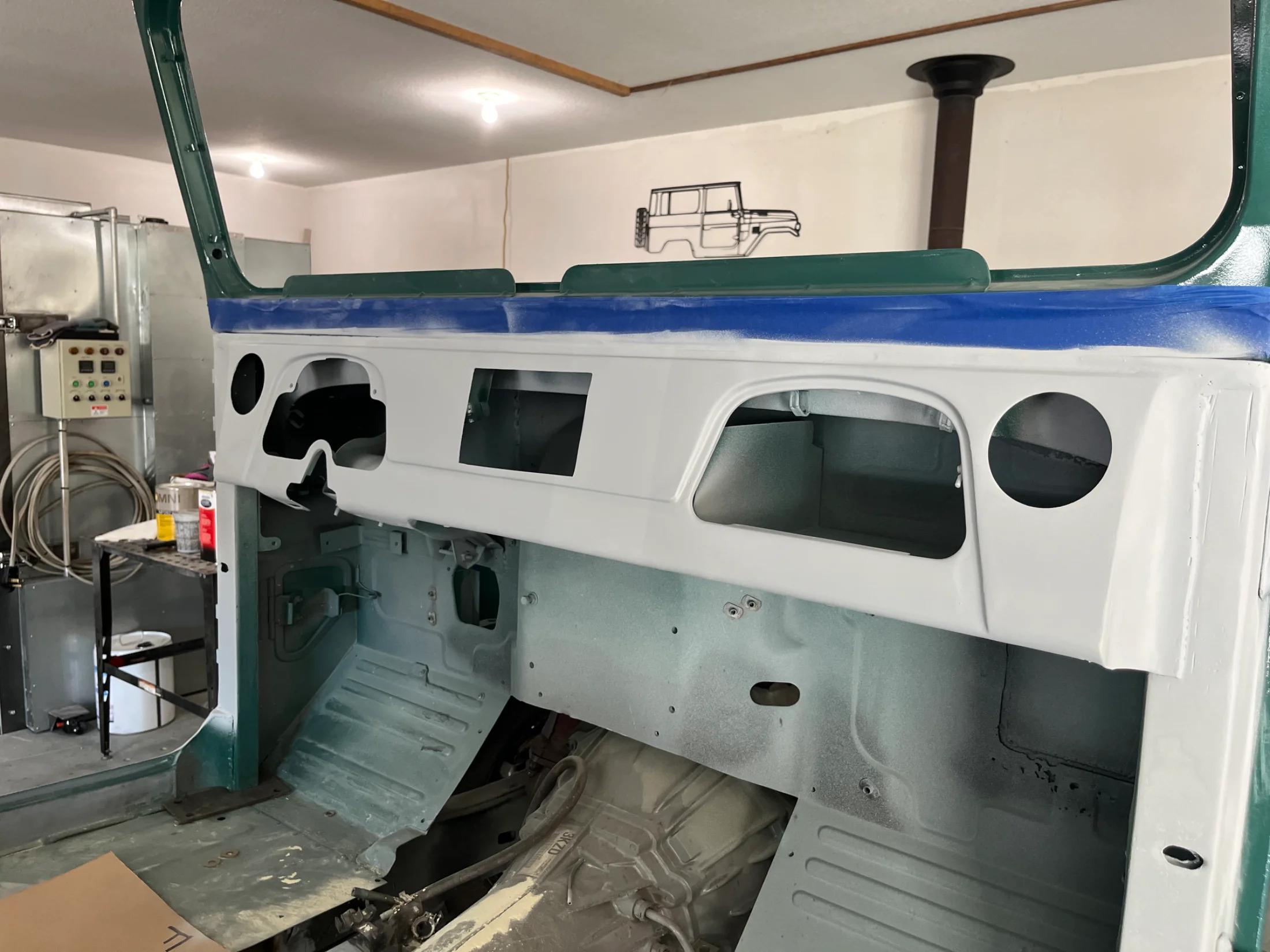

Decided to fill in the two center AC vent holes. I’ll be making a center console with two AC vents and a heater vent in each side of the console.
Tailgate has been body worked and put in primer
Decided to fill in the two center AC vent holes. I’ll be making a center console with two AC vents and a heater vent in each side of the console. View attachment 3987803
I think that you will like your vents on the outer edge of the dashboard. I only have the center vents and the center stays nice and cool but the outside is hot.

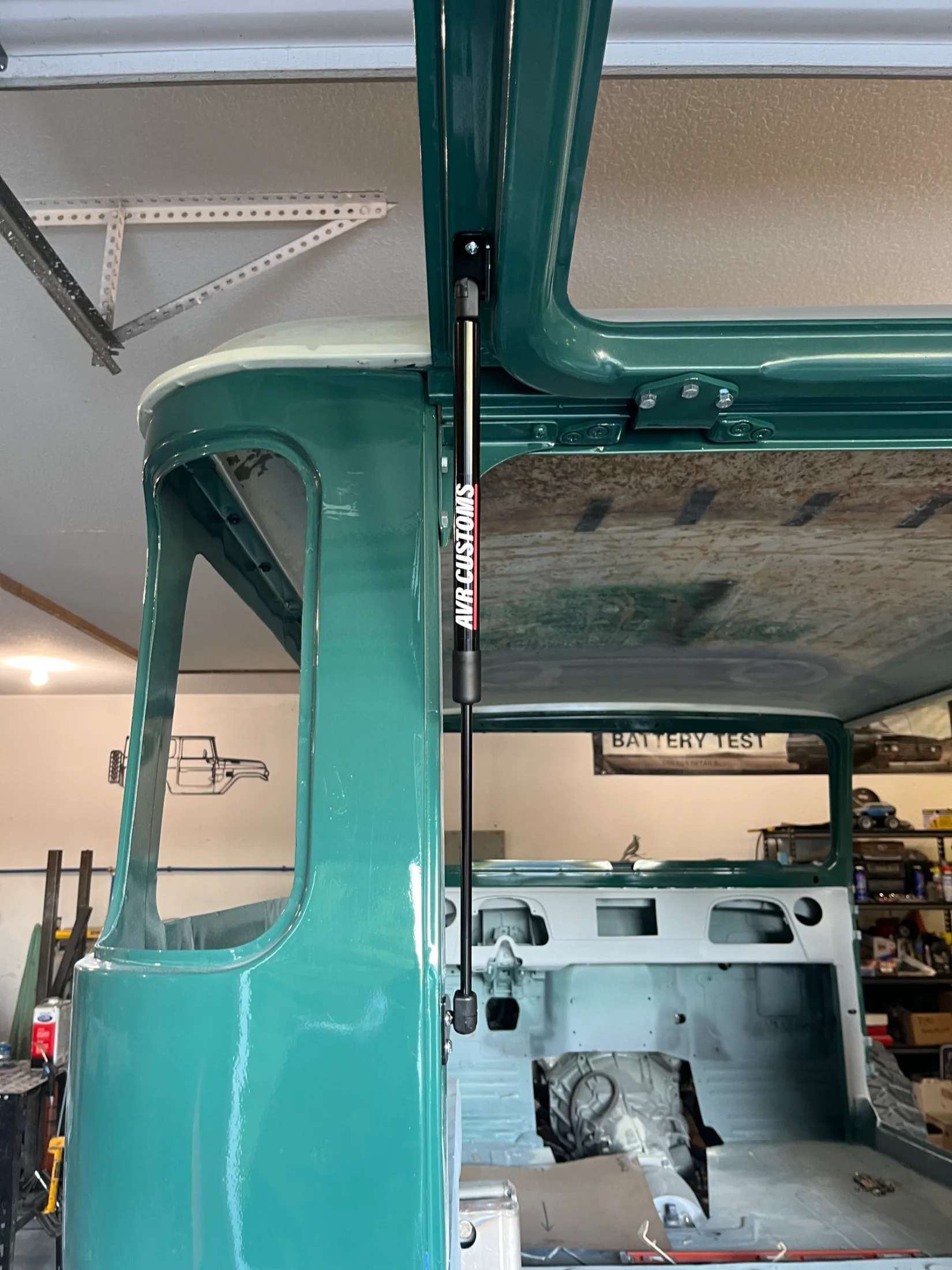

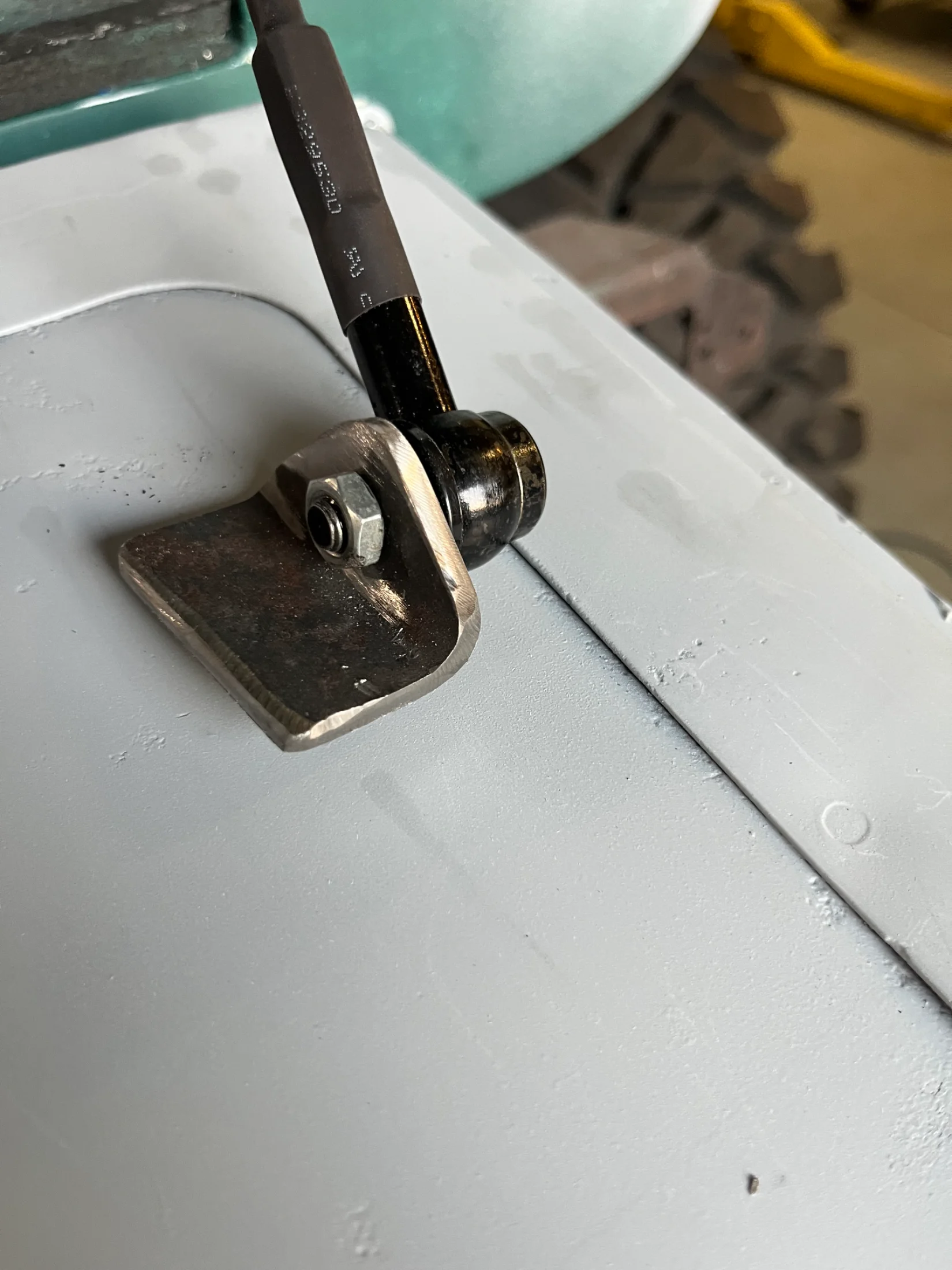

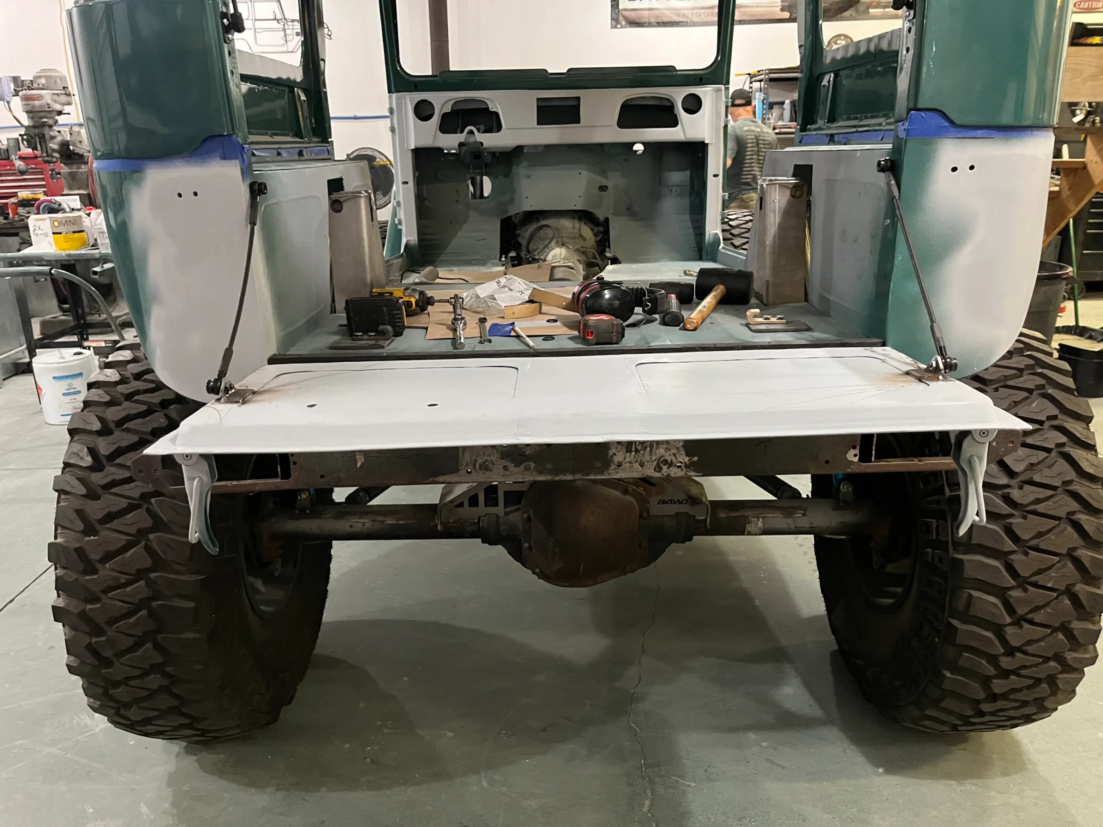

Thanks to @matzell and the “Lynchburg Lemonade” for the inspiration and part numbers for the lift gate cables. Made some mounts and got everything mounted up. Thanks again Rob.
Thanks goes out to Austin at AVR Customs for the awesome gas struts and new powder coated brackets. They work awesome
Looking Good ! Nice work.

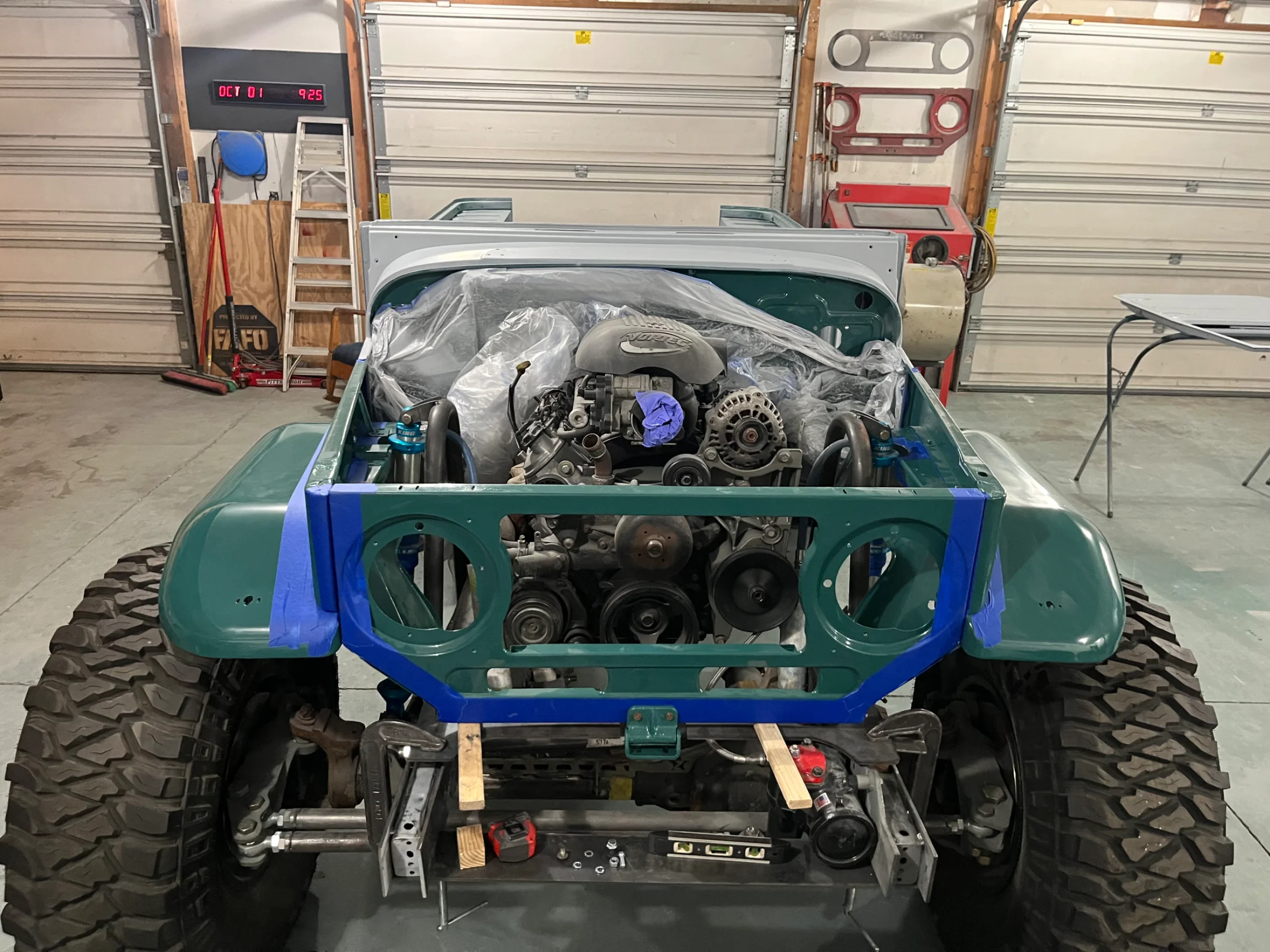

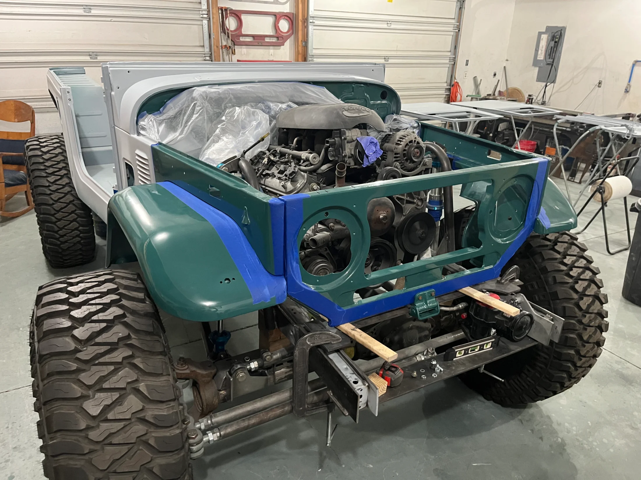

Not too much going on with the project. With the help of a friend, been working on the front end and making a crossmember for the grill.

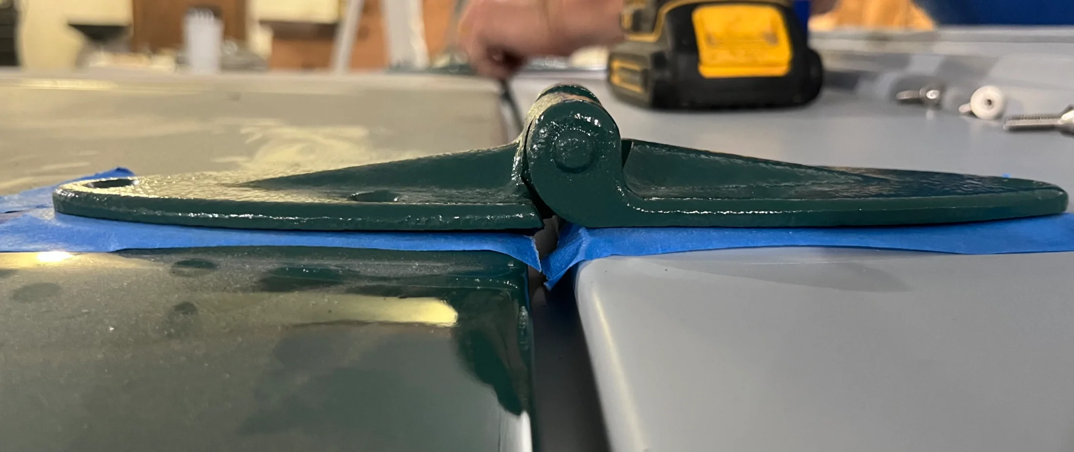

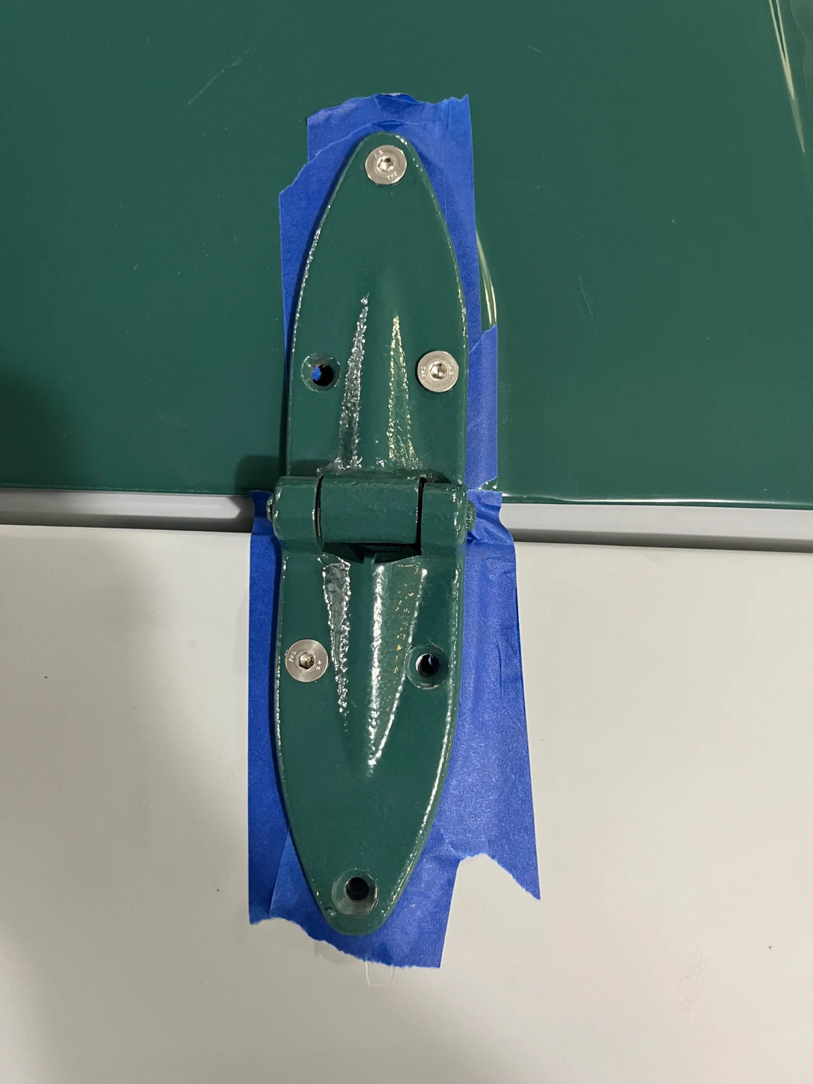

Which way is correct for the hood hinges? The grey area in the picture is the cowl. Also, is there a drivers side and passenger side hinge?
So if I understand, mine need to be turned around? Grey primer is firewall
