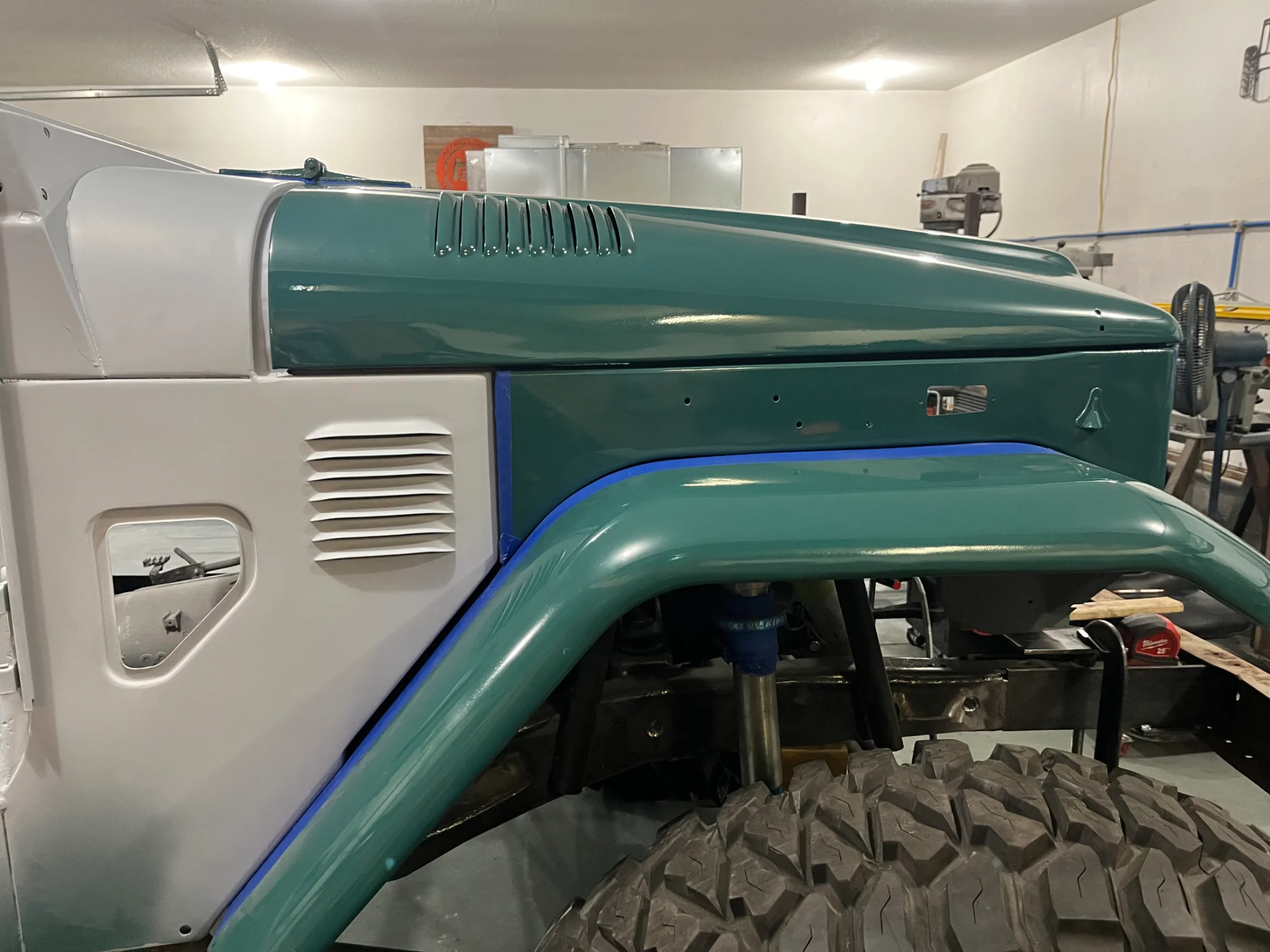

Blue, could you snap a pic of the gap in the side apron with that alignment of hood, bib, fenders ? I have resigned myself to the hood overhang. Sometins bent or my body mounts are not where they used to be from impact, frame twist, hard rocker smashes, etc....
Here you go
Thank you. Now what confuses me is that on mine , if I loosen everything and set where I would want it the gap there would be like 3/4 inch both sides.
Getting that to a place you are happy with is an accomplishment.

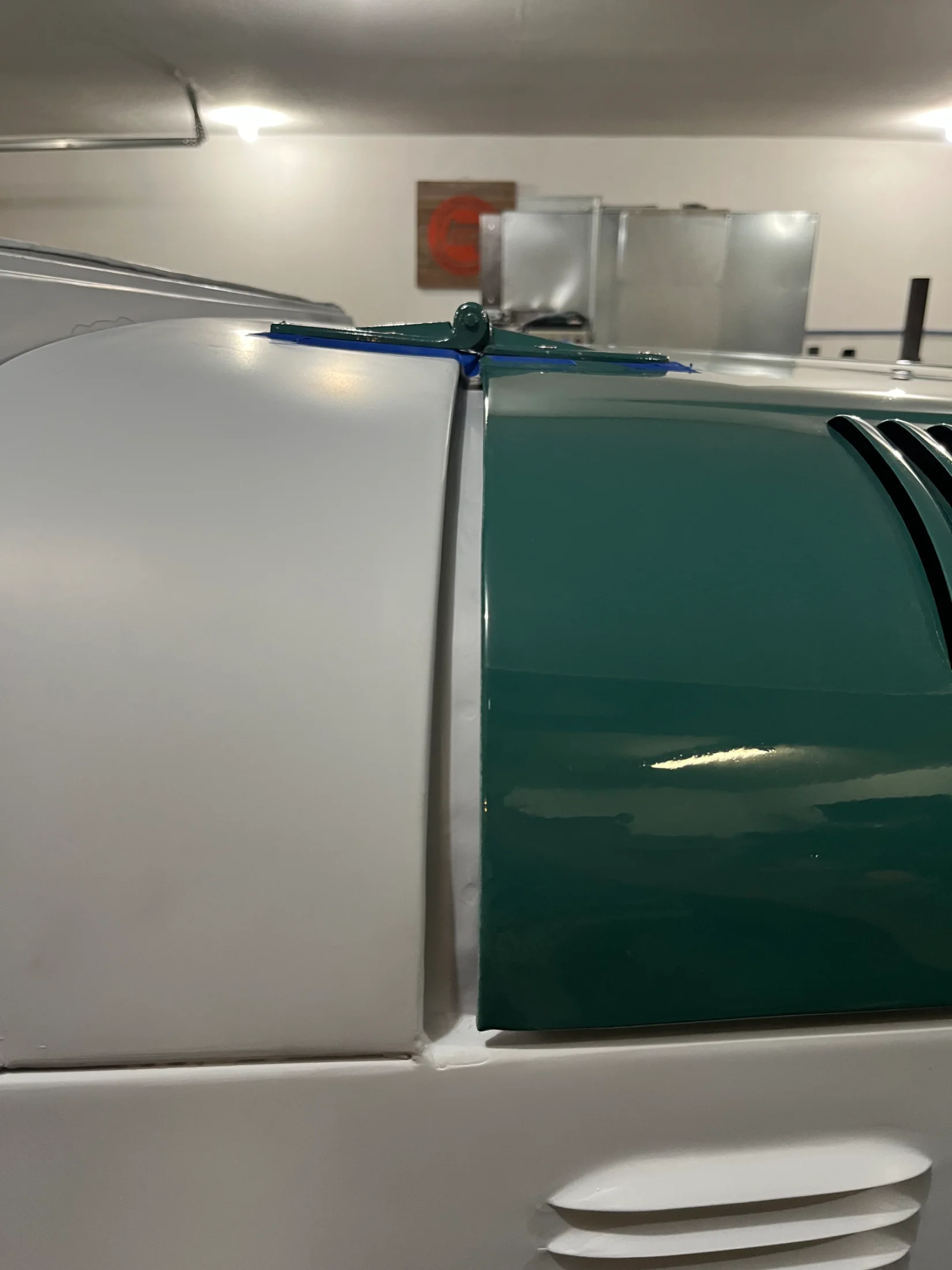

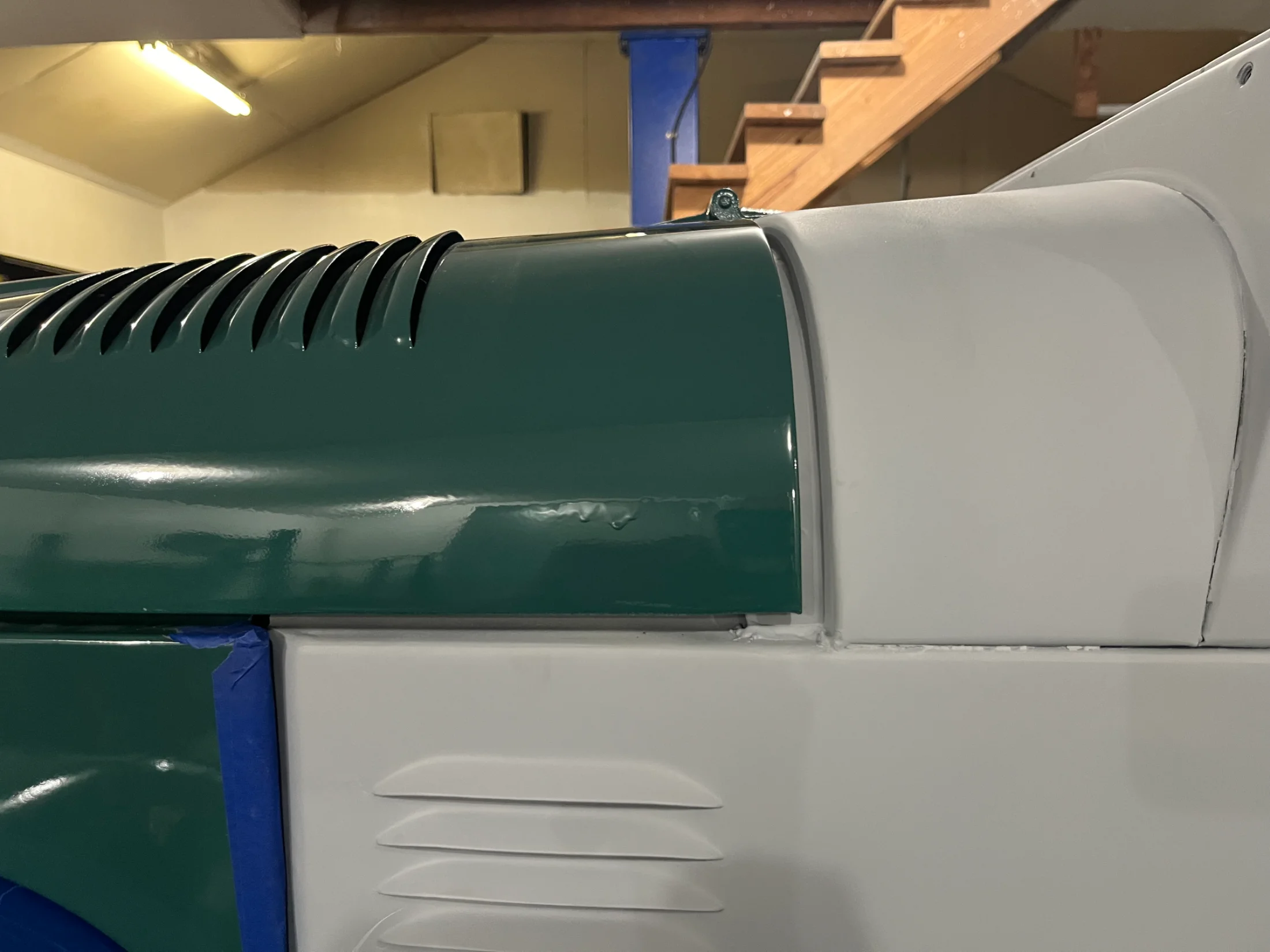

I'm happy with apron gaps and those are set by the fender and the front grill piece. The thing that I don't like is the hood to cowl. Seems like that would be set better from the factory. Once the hood hinges are on, there is no adjusting them.
Yeah, I saw that and was curious, IMO it's just what hood you got and how the cowl was set with that piece where the vent is which you get what you get.
Could add a bit to the hood, has the brace back along that edge so shouldnt warp, depends on how you like your gaps ?
I even checked on a 1978 Freeborn Red 40 sitting on the side of my garage. It has the same gap and is all factory. Crazy

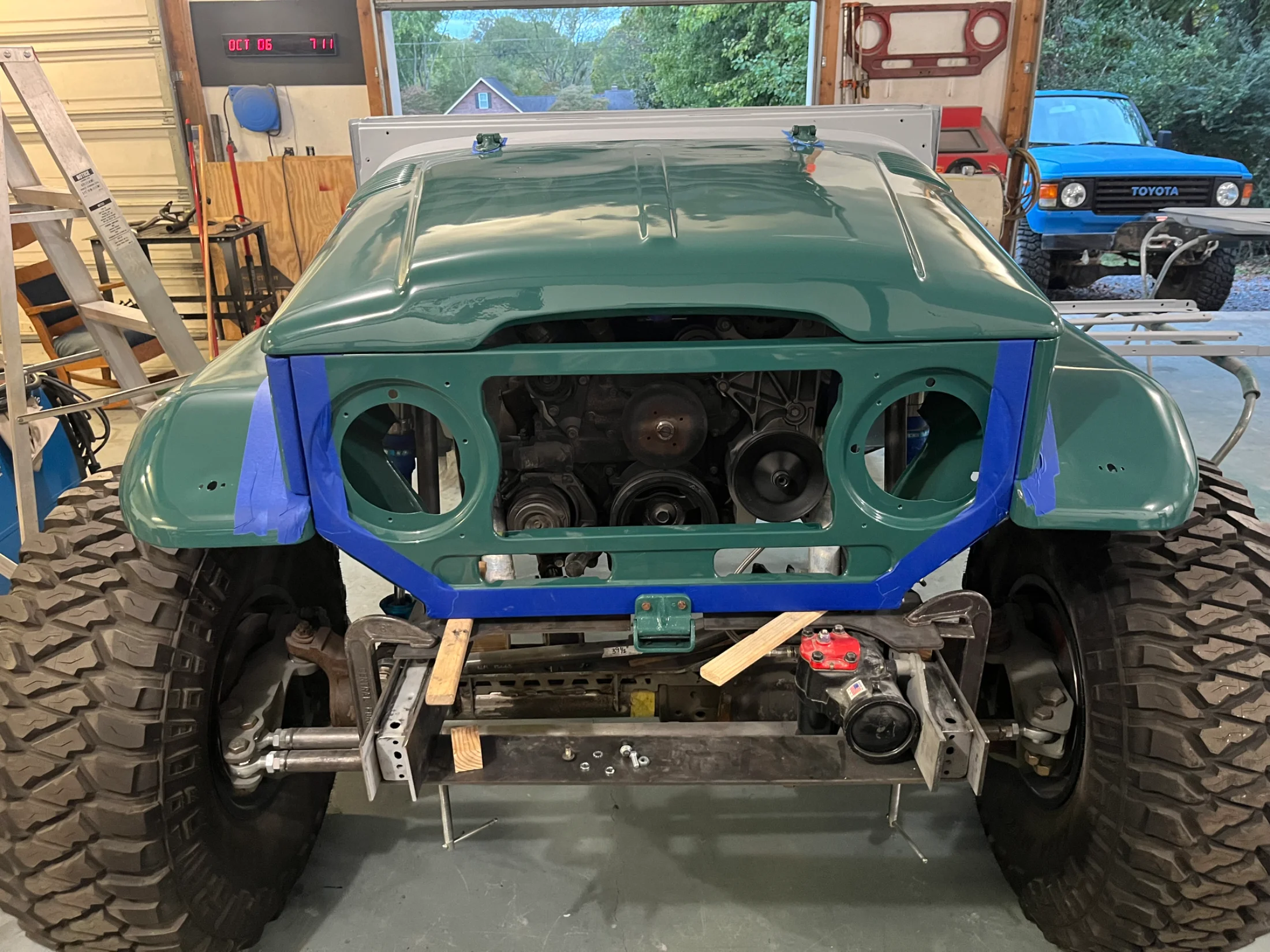

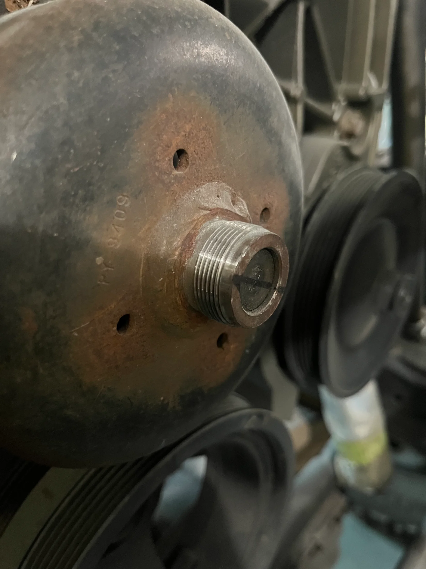

So we are mocking up the radiator housing and trying to figure out room for an electric fan. Also looking at the Vintage Air AC condenser kit. For those of you running a LS, what are you doing for water pump clearance? Can the snout of the factory water pump pulley be cut off? Should I go to an electric water pump for more clearance?
Gotcha ya….I’m all custom with the 4Runner frame and making a crossmember for the radiator housing. Vintage Air says the radiator housing needs to be moved back about 1 1/4”. So with the condenser, radiator housing, and an electric fan it all measures about 8.5”. That would put the electric fan into the snout of the water pump pulley. I really don’t want to move the engine back
I don’t know anything about LS, but I will share a mistake I made, this might help if you don’t have your radiator yet; when we were mocking up the radiator support and frame we stuck the OEM headlights and buckets in and decided that’s the width we had to work with, the way the OEM headlights stick back in the engine compartment. The City Racer headlights I ended up using were much lower profile to the rear, and had a pigtail, we could have gone wider with the radiator and possibly bigger fans.

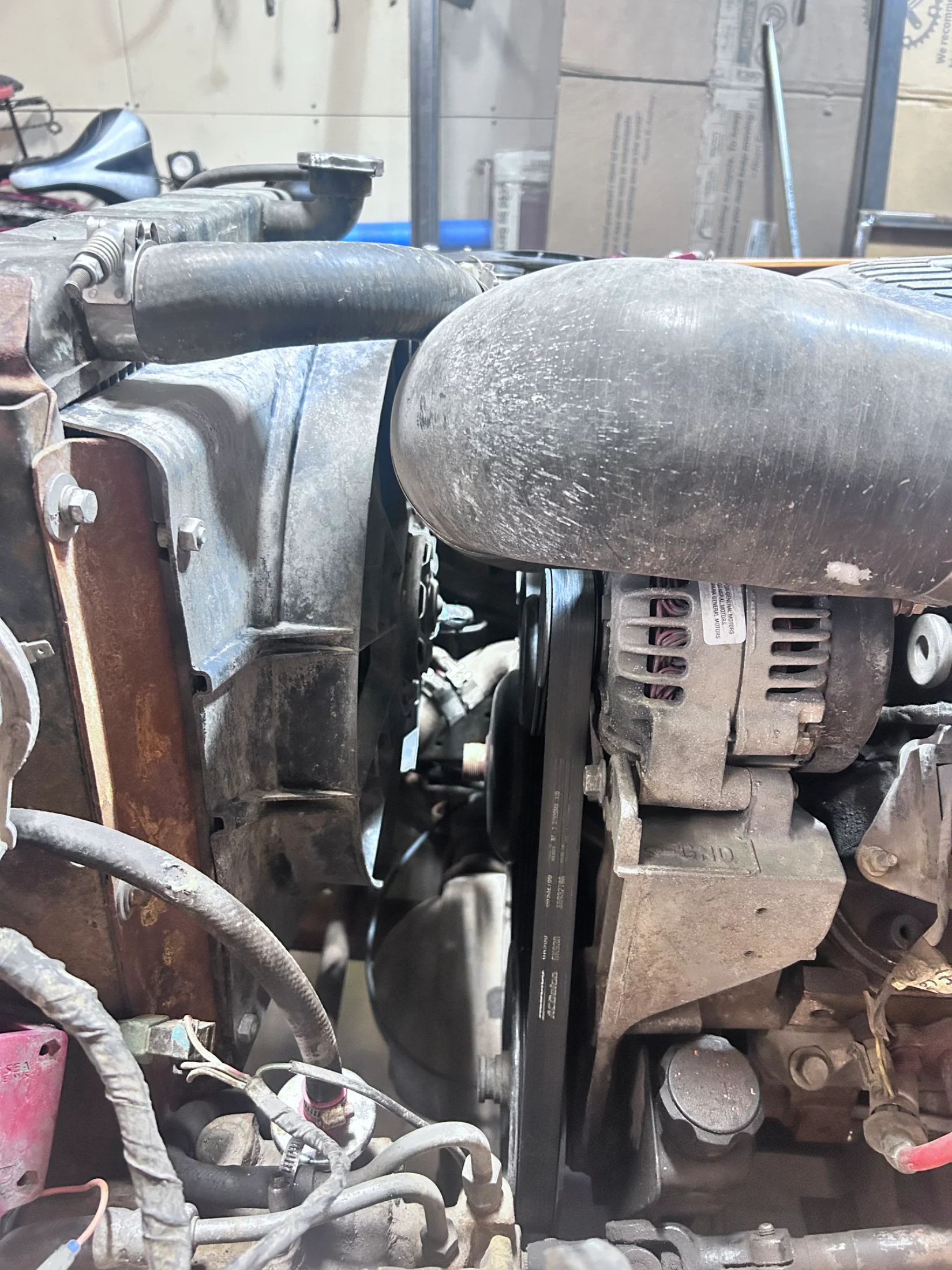

I have a stock 40 radiator in stock location, with a LS using stock gm clutch fan. By your pics engine location looks very close, I can measure from front of clutch to radiator and see whats left after the 1/25" for the Vintage cooler, might be plenty. You could also modify the radiator screen to fit the mesh part into bib so same effect from outside and you pick up like 3/4" right where you need it, I bet that mod would allow your elec fan too.
I’m in the Electric fan category. I run a Taurus fan on a stock radiator. The radiator is in the stock position. I really like this fan.
My engine is pretty far back. This is a result of using the old 350 mounts and LS adapters. when I was running the 350, the snout went just barely into the webbing for the fan. I had cut a relief into it and never had any trouble no matter how flex I got.
