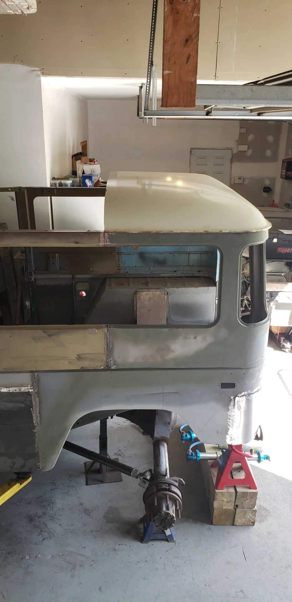

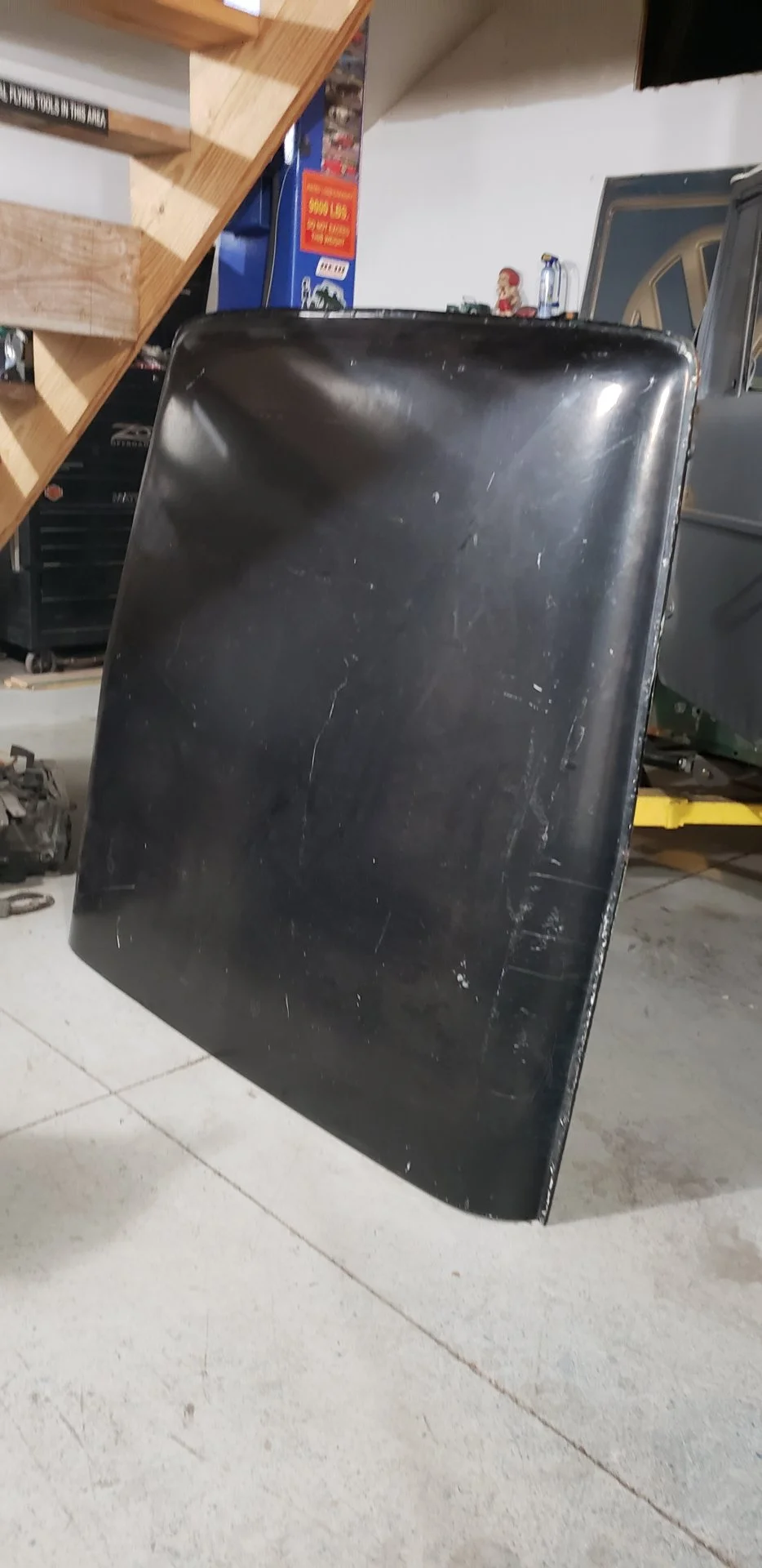

Thanks @matzell for the roof section

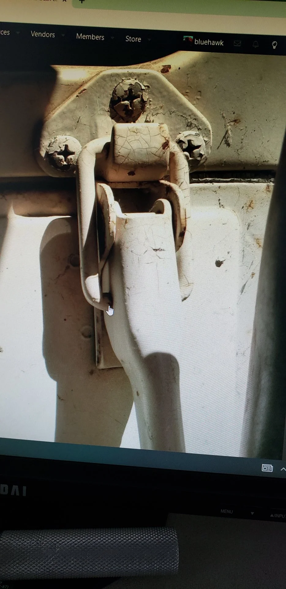

Looking for a set of the early model interior windshield latches

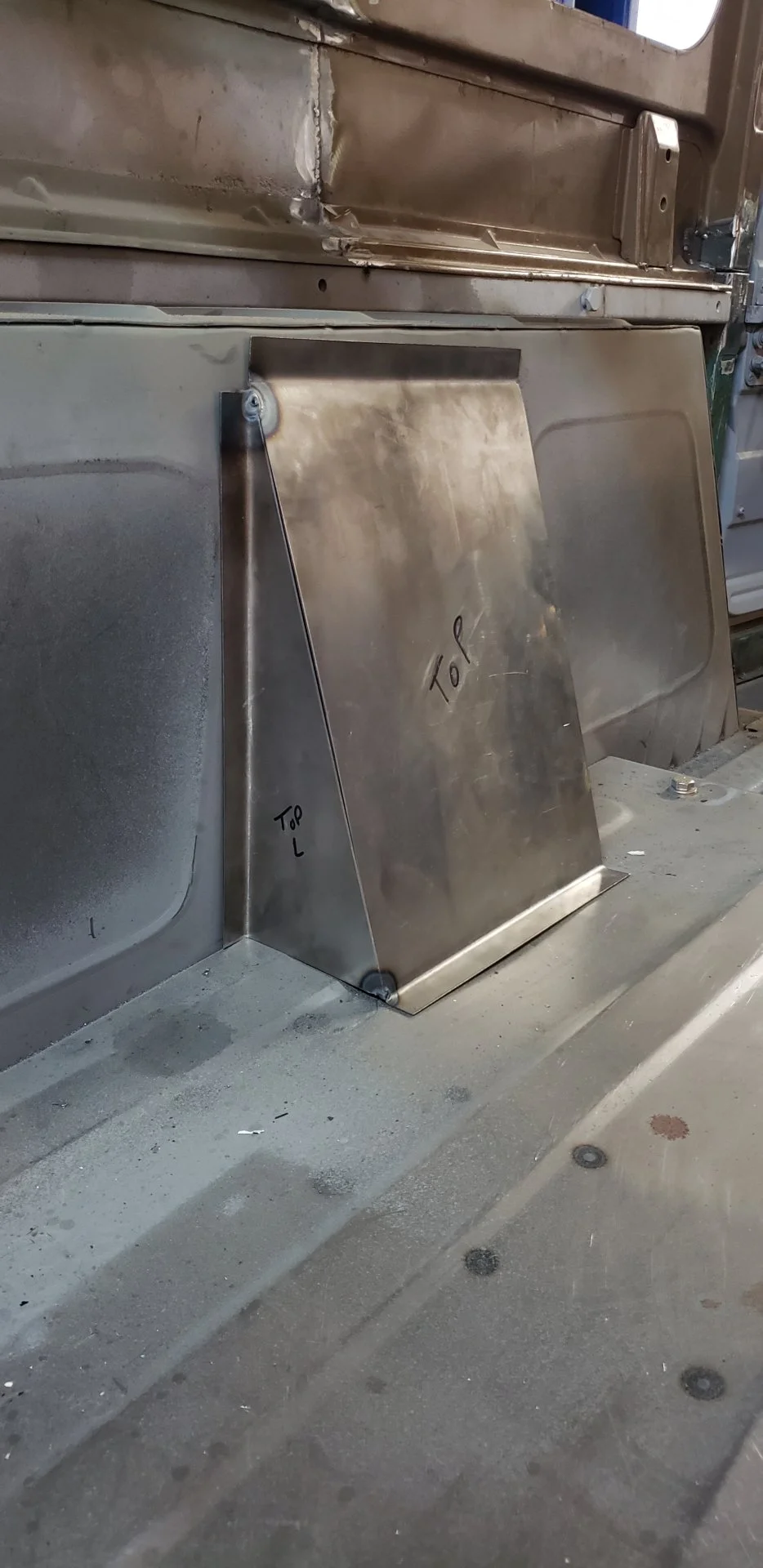

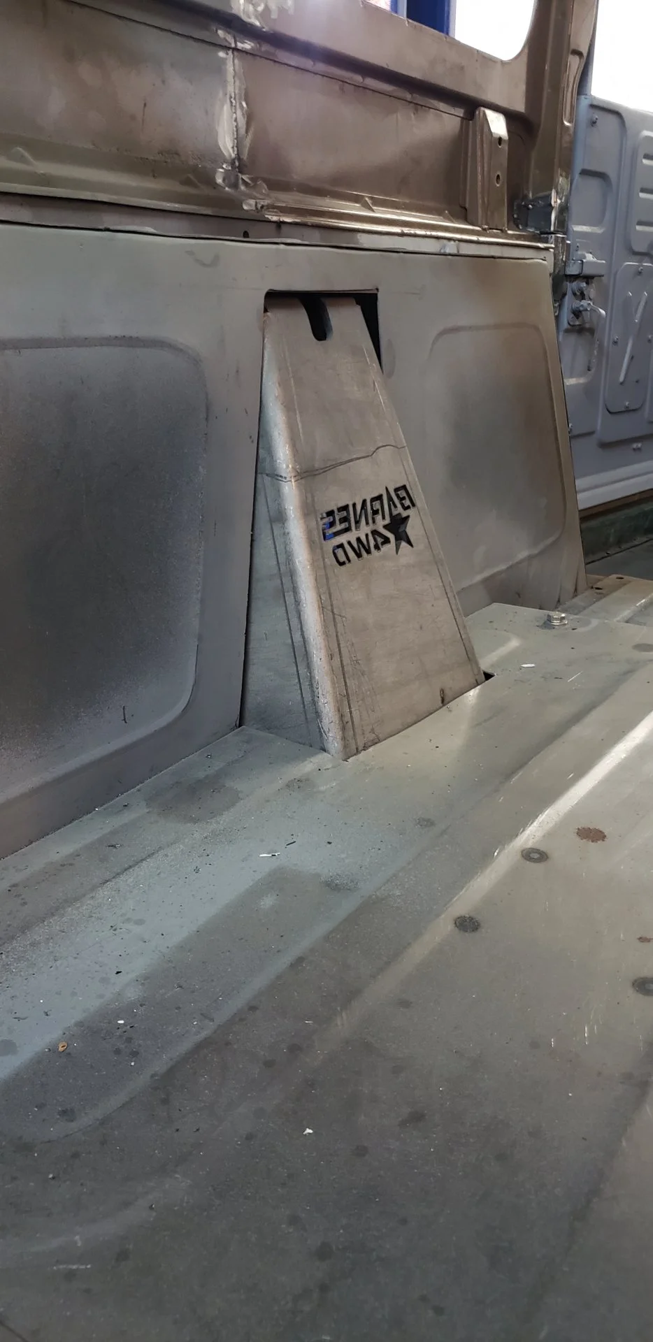

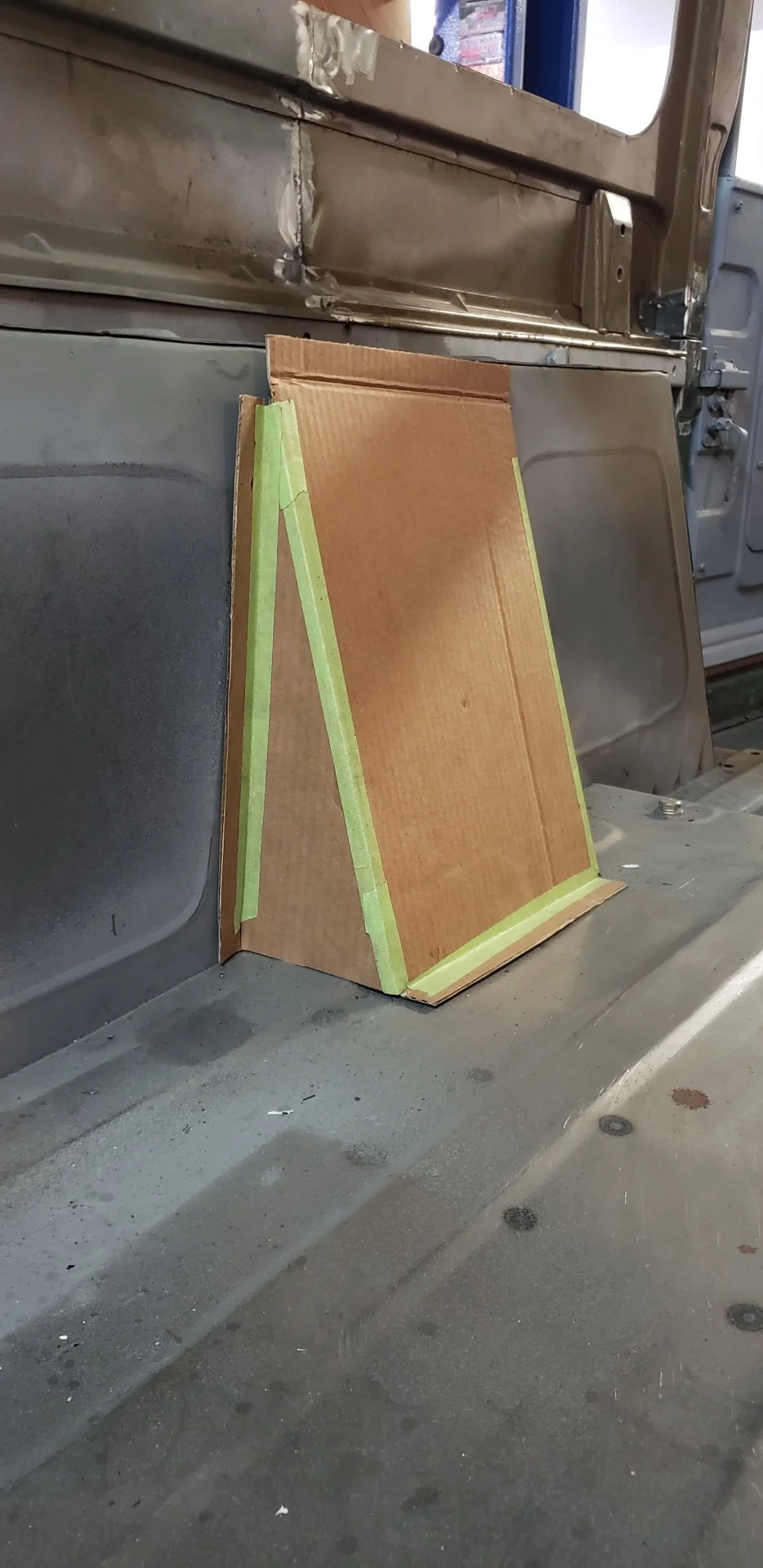

Little work this holiday weekend. Made some covers for the rear shock towers.
Just sitting in place for now. They will get welded in once final body work starts.

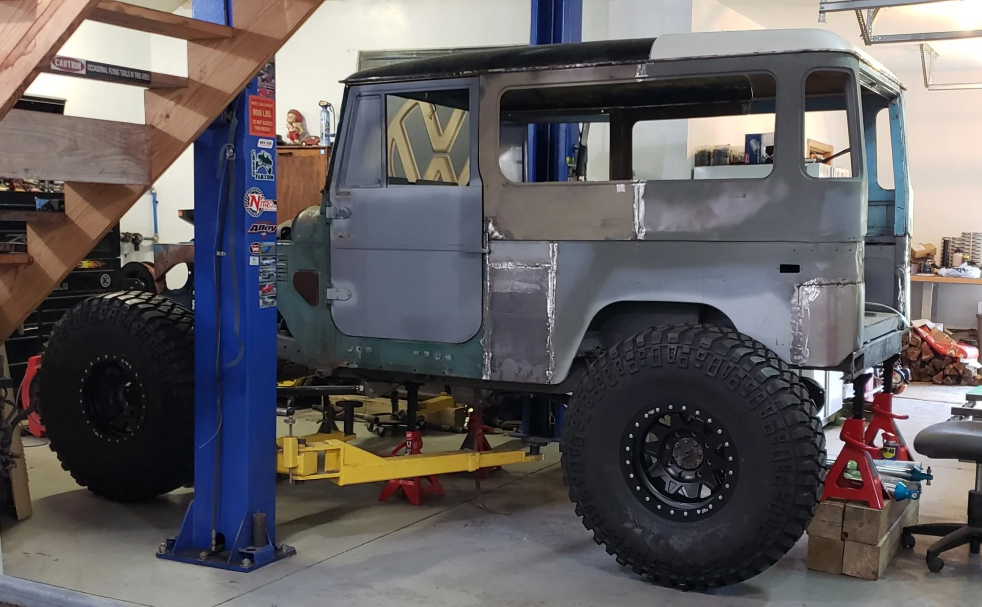

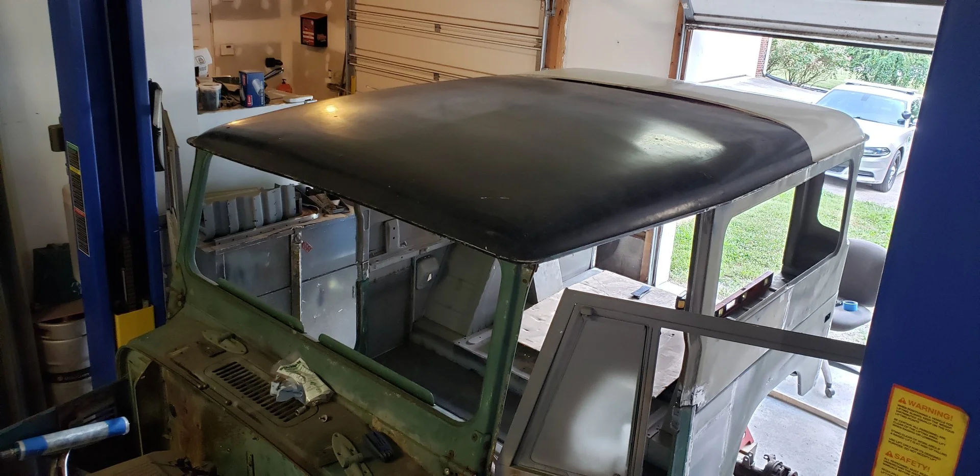

Took the top I got from @matzell and my sunroof top and made a super top

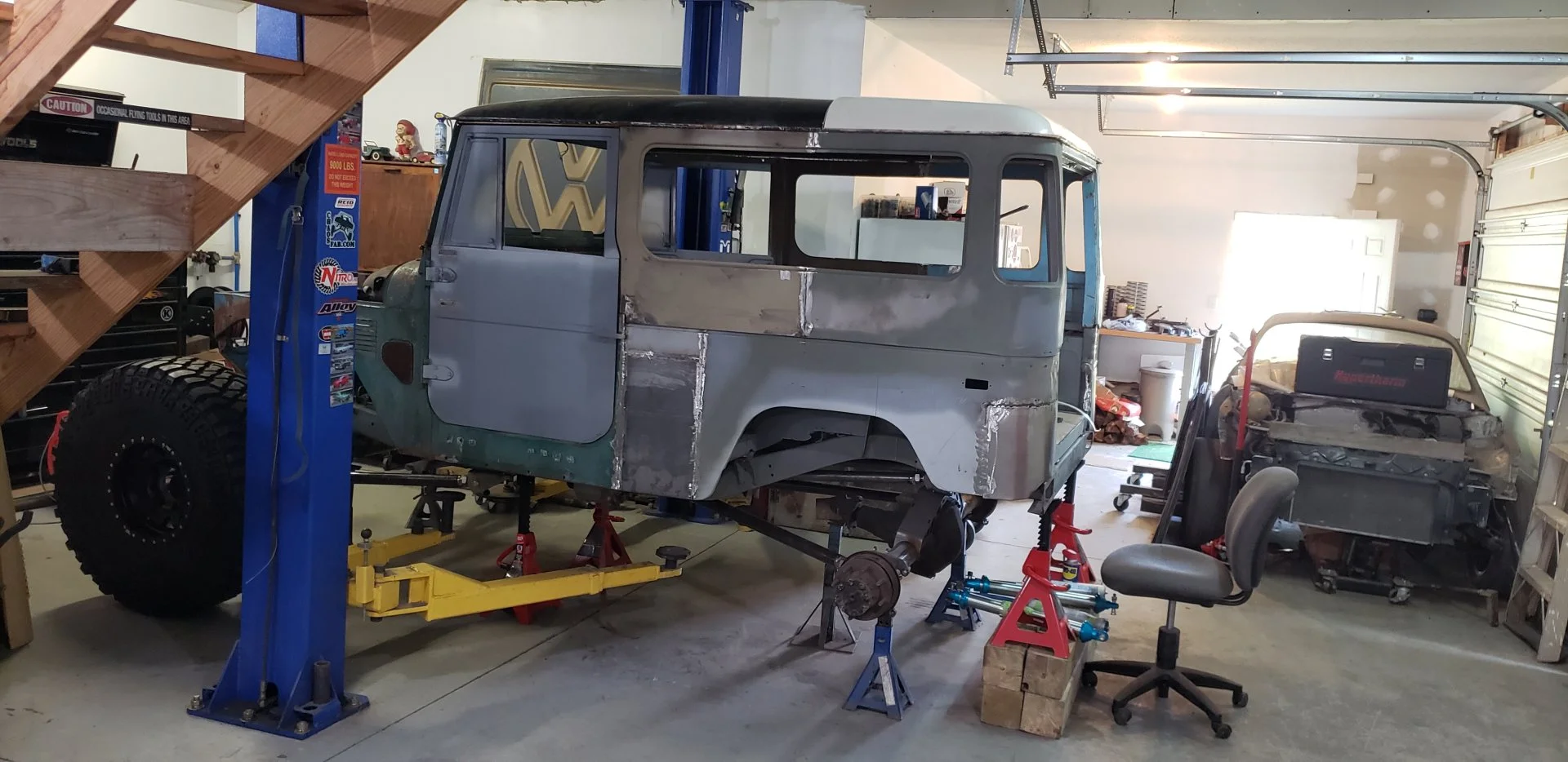

Had to sit some tires in place to see how she is gonna look. Gave me goose bumps
Gonna have to do some rear fender well trimming
Are those 40s

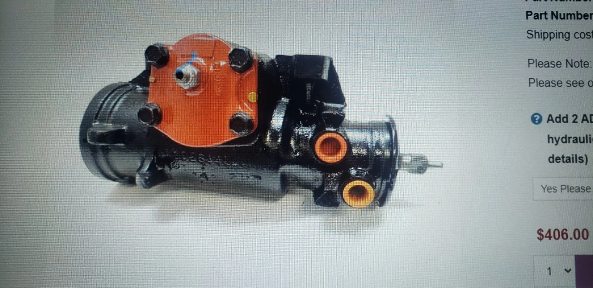

Trying to decide which power steering box to go with for doing my hydro assist.
Red head makes a good product

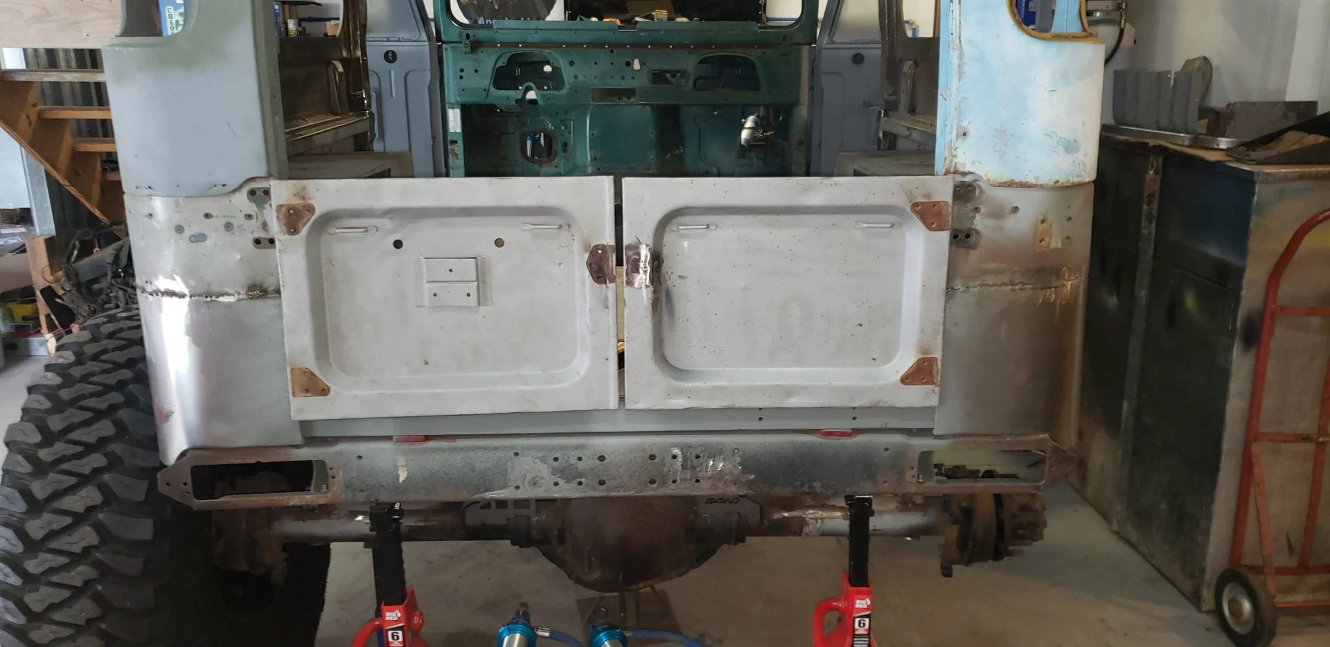

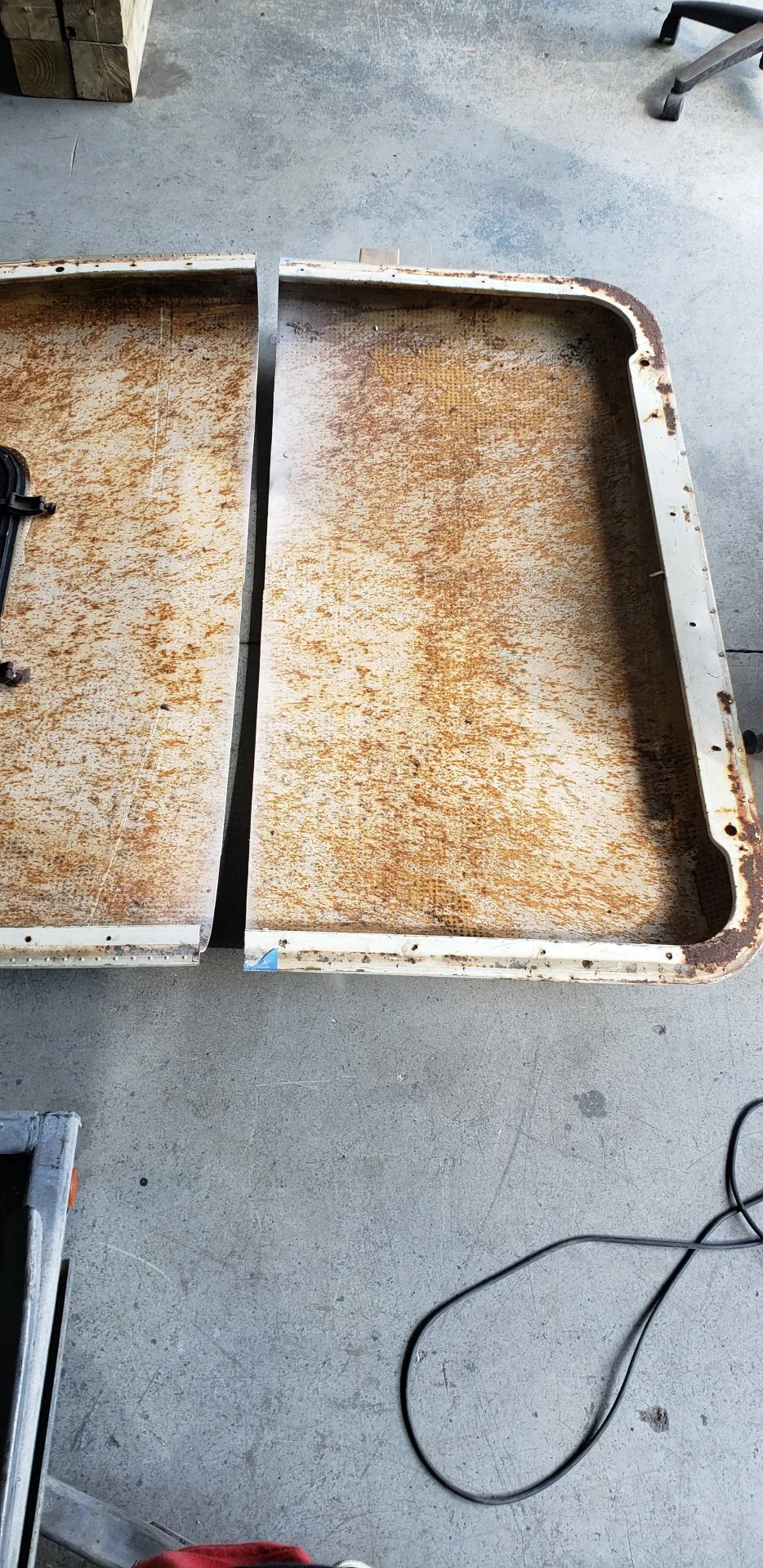

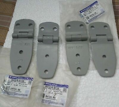

Thinking about making a drop down tailgate out of the two doors .
You got the skills to do it for sure. I have always hit the easy button and bought a used one. Last one I bought was $400 with latches but without hinges. I'd probably build the next one the way prices are creeping up! I much prefer a drop down tailgate to the barn doors to use as a platform off the rear of the truck. Take a look at Samurai door hinges, they are cheap and will function just the same as the expensive toyota hinges. Since you don't have factory hinge holes already, you can make anything work.
Check out my Lynchburg Lemonade build in the 40 section. I made one that works really good and listed part numbers for cables too. It will support me (260 lbs) also works great on the trail for making lunch.
@matzell thanks for the link. That is great information
