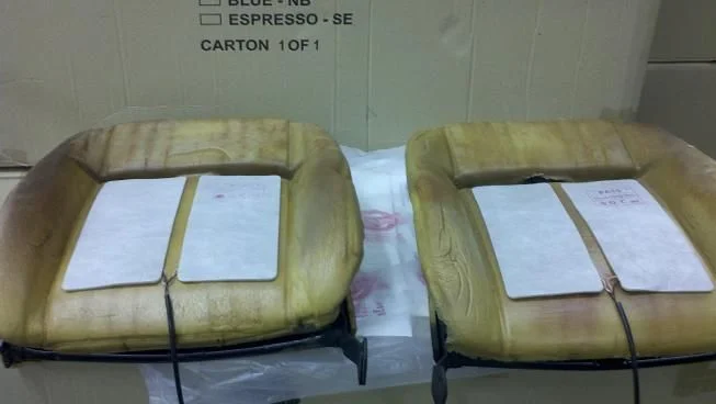

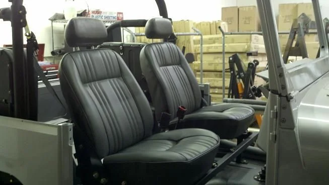

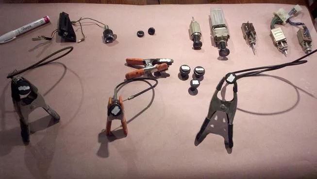

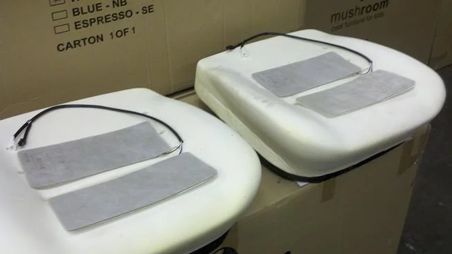

Reassembled the two front seats, with the addition to seat warmers and then bolted them down. Next I installed the seat warmers’ control buttons into the center console.

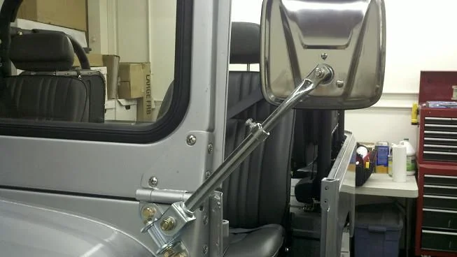

Day 152

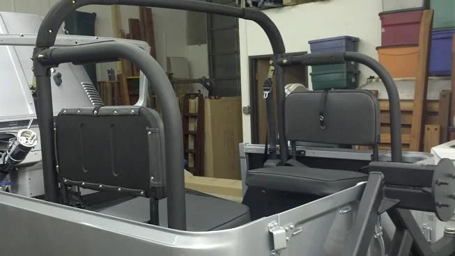

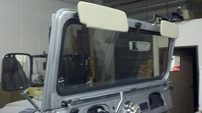

I installed the OEM glass and added a very light window tint. Next I mounted up the rearview mirrors (left, right and rear) along with some new visors.

@ singletrackjunkie, I bought them from Ebay from a Korean vender. They were the only ones that have a split design, so they will work with the factory interior. Just do a search on Ebay for “heated seats kits”, I tried to see what vender I purchased them from but I couldn’t find the name. Thanks for the support!

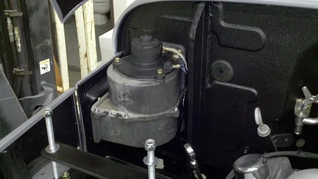

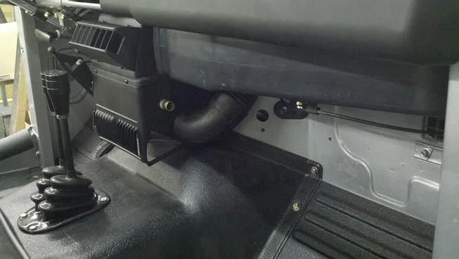

Days 153 & 154

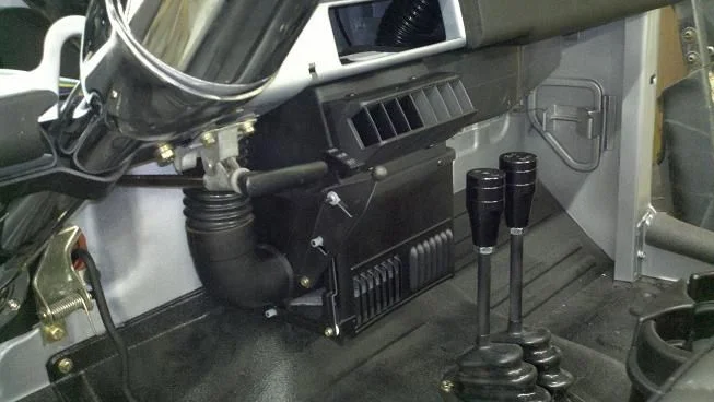

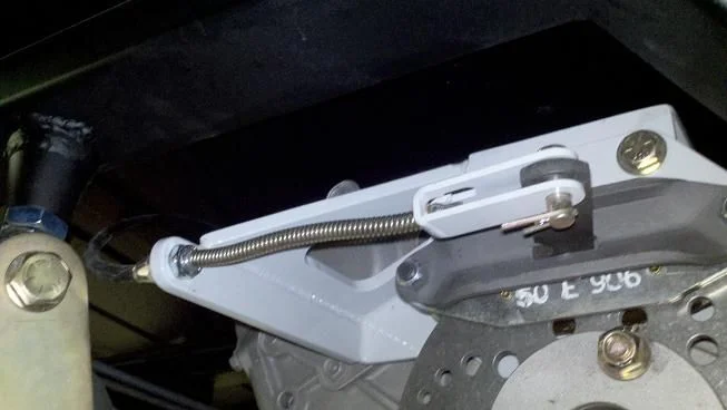

I restored the heater and fan and installed back into their homes. Next I plan on completing the disk E-Brake setup with the factory pull handle.

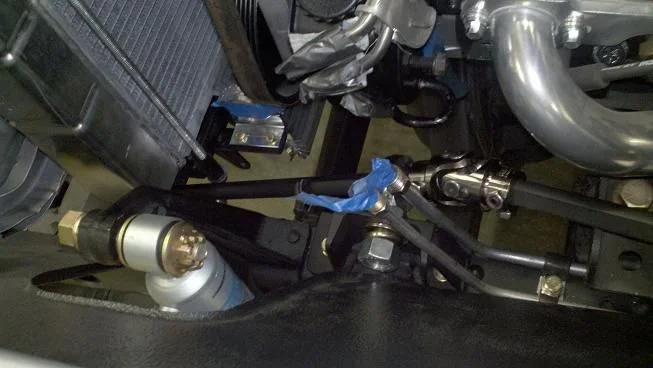

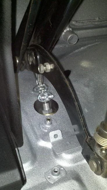

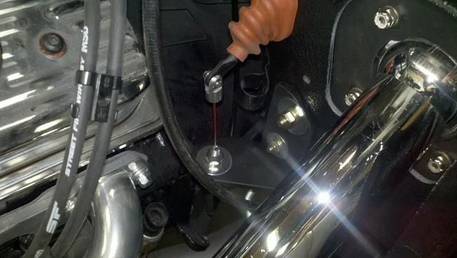

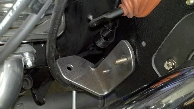

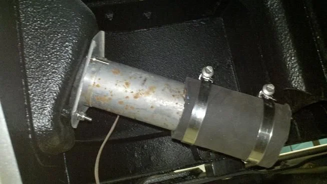

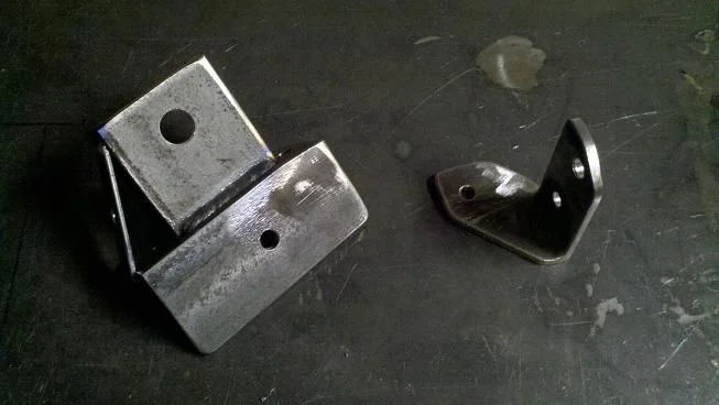

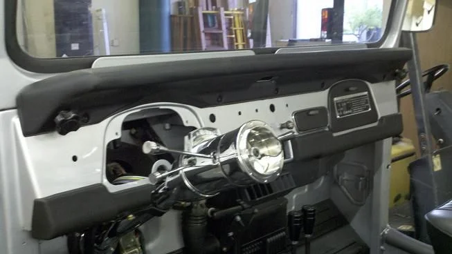

I wanted a way to keep the factory gas pedal and have it work with my TPI. So I created a bracket that would bolt to existing holes in the firewall. Then a fabricated another bracket for my steering path. I needed to add a third steering joint to clear the frame and headers. This bracket also uses all factory holes, no drilling on the frame.

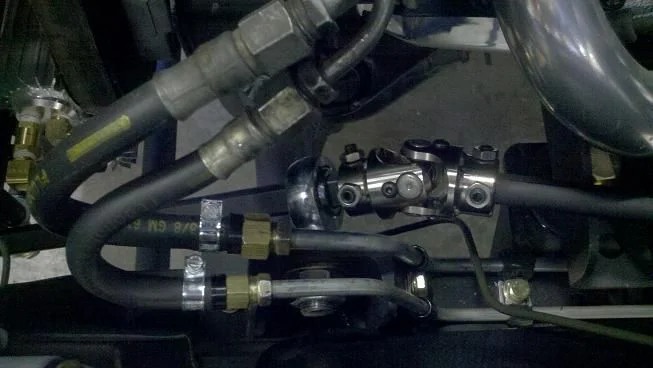

Day 158

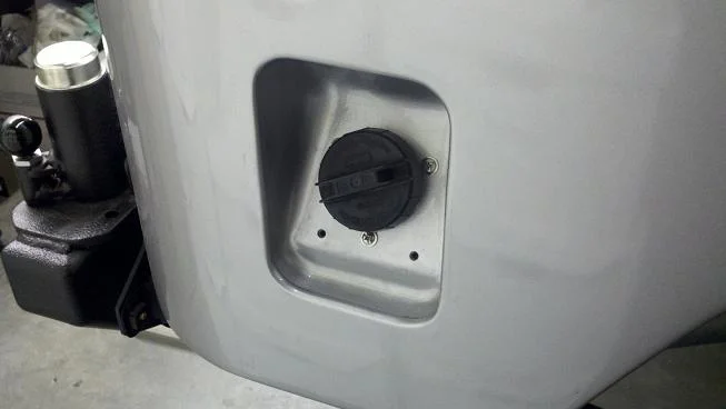

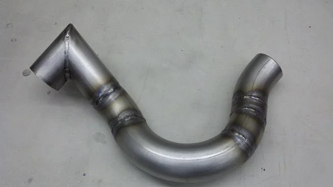

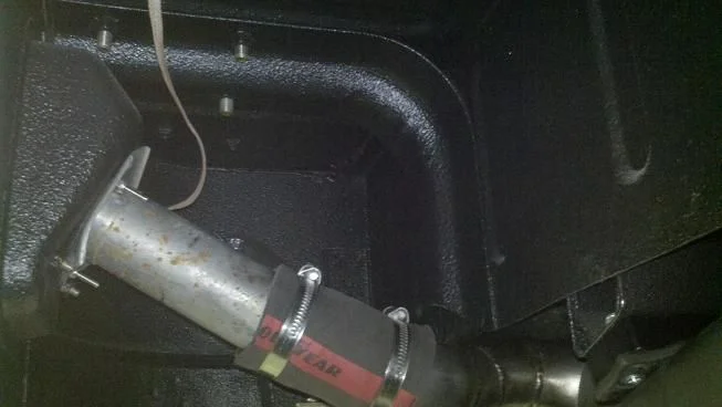

I finally finished the steering linkage with three joints, it still barely misses the frame, headers and radiator but, it works. Then I modified and installed the S10 filler neck and cap into the original gas door housing. Next on the list is the brake completion, with an upgraded mastery cylinder and booster.

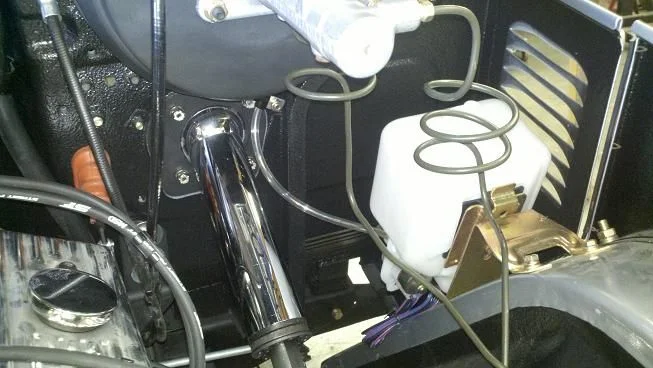

Days 159 - 161

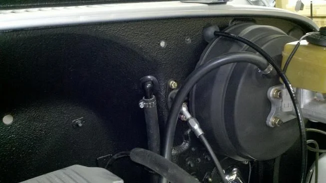

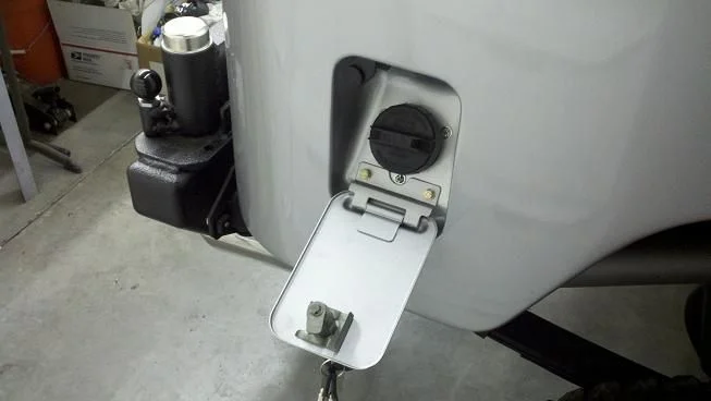

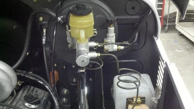

I completed the gas filler neck (what a contraption!) and connected it to the tank, then installed the gas cap door along with the lock and backstop. Next I completed the brakes by adding / restoring a 90’s 4rummer master cylinder with booster. Bent all new lines and connected them to a proportioning valve.
