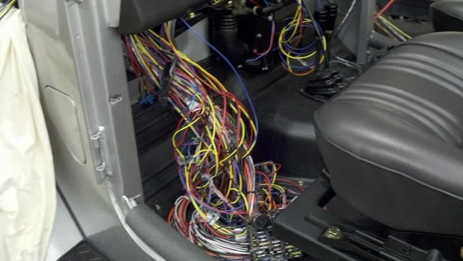

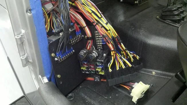

I finally started the wiring with 2 painless wire harnesses, what a mess! I bent a piece of abs to hold the fuse box and computer that will be mounted to the firewall using existing factory bolt holes.

Can you say more wiring and more wiring, I don’t think it is ever going to end. I added a speed sensor to the mix for the 700R4. This is the only way to get the lockout feature of my transmission to work correctly at high speeds.

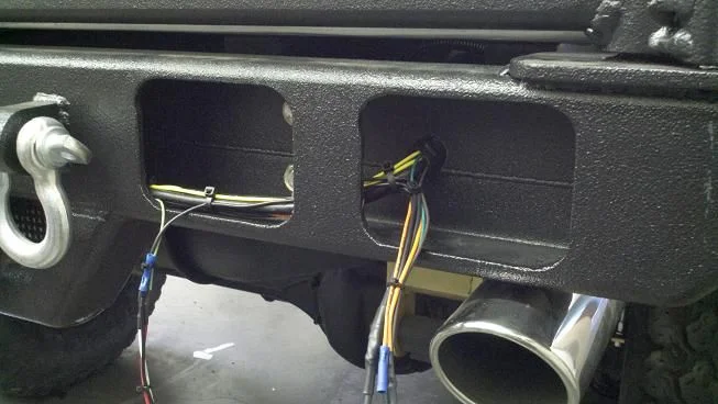

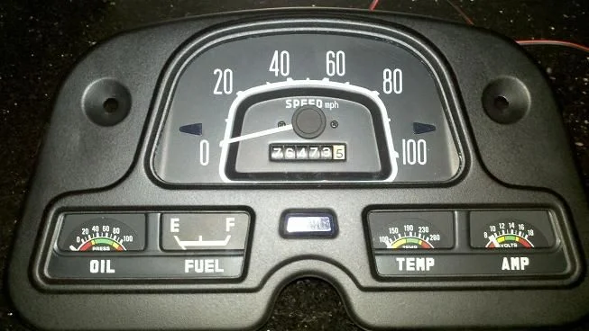

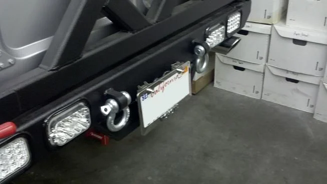

Next I replaced all the green colored lenses with clear acrylic glass. I plan on not using a single regular light bulb and want to use all LEDs. This will ensure a great look and brighter output. Then I upgraded all my gauges to all electrical, except for the speedometer (I will keep this original).

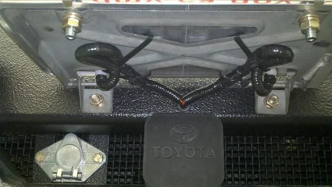

I finished up wiring the front turn signals and headlights. Then I installed my custom rear CV drive shaft. Its about 16.5 inches long and the CV I can rebuild. I originally tried using a CV from the front of a FJ60 and found out that it was about ½ inches to long and didn’t have as much flex as what I have now.
