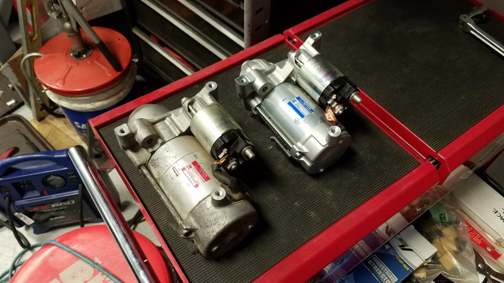

FYI:
  • Manufacturer:Toyota
  • Part Number:28100-0S050
  • Part:Starter
  • Replaces:28100-0S010, 28100-0S011, 28100-38040, 28100-38041, 28100-38080
Fits all 2011-2017 Land Cruiser, Sequoia and Tundra 5.7L
From: Starter - Toyota (28100-0S050)
HTH
Hopefully the new part resolves whatever starter/solenoid issues have been occurring.

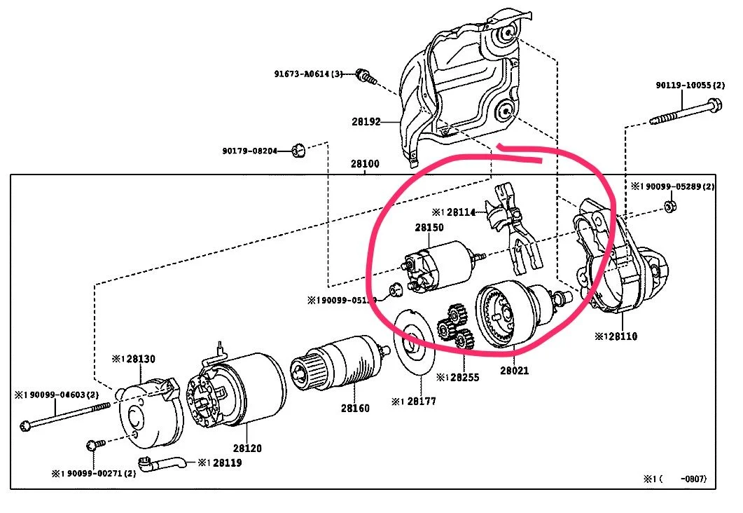

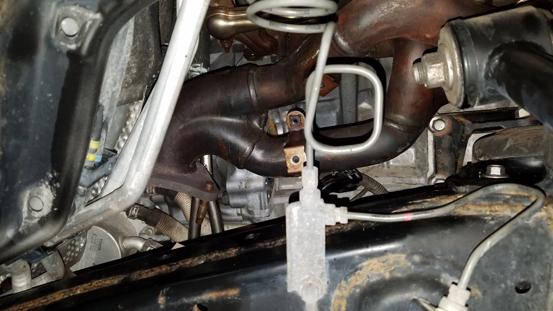

Is solenoid relocation a viable option? Maybe it could be relocated somewhere easily accessible in the engine bay so in a pinch it could be easily swapped, or at least bypassed easily? I struggle to understand why manufacturers have moved to a combined starter/solenoid assembly over the years.
No, they use the solenoid both for power switching but also for engagement of the drive gear so relocation is a no go.
As for the starter, 28100-38040 & 28100-38041 supercede to the 28100-0S050
Does that apply to the 2008-2009 as well?
The solenoid works that way for all 200's

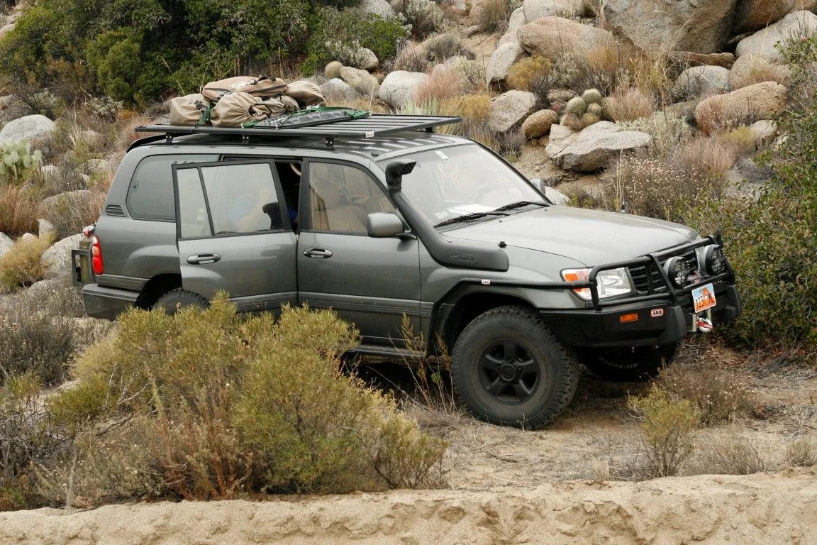

Hey Kurt, I'm thinking of making some protection rails like the ARB ones you have. I thought I remember you saying a real world experience where they saved the side of a truck one time. Would you mind telling the story and do you think there is a benefit to them in wooded trails?
One time... more like dozens of times. I've had them on Cruisers for over 15 years now, my 40, 100 and 200. I'll likely have them on my 61 soon too. In addition we had them on the Expeditions7 fleet as they traveled on 7 continents. I can't think of a single situation more memorable than one at the moment but I can think of quite a few instances where downed trees, thick brush or rocks were kept away from the fenders. That isn't to say each case would have resulted in fender damage and perhaps there is a case or two where there wouldn't have been any contact without the bars in the way. I'm not the worlds biggest fan at how they look BUT I am a huge fan of the protection they offer.
