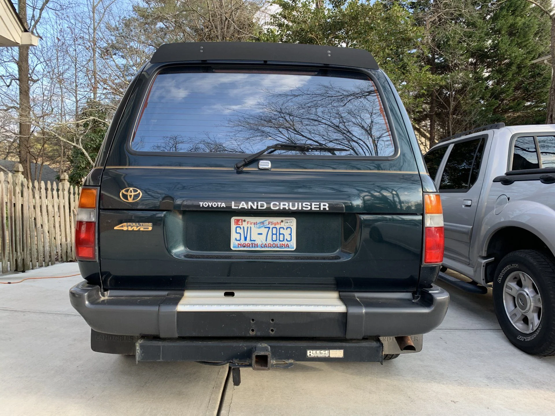

I’ll have some better pictures, probably today... of the interior and exterior.
In anticipation of receiving this non-running FJZ80, we knew that one of the first purchases was going to be a new battery. So on Wednesday, I picked up an Interstate 27A sized lead acid battery from Costco and had it ready on Day 1.
We did a walk around, checked the fluids, replaced the battery, and gave her a turn to see if she would run, and to our surprise (not really surprised, because it’s a TLC), she started right up. No smoke out of the exhaust, no ticking of the valves, just a little smoke burning off of the headers (I’m assuming it’s done some leaking over the last 3 years). We then added some water to the radiator and found our first (or presumably many deferred maintenance items) issue... water was leaking out of the plastic/metal seem on top of the radiator.

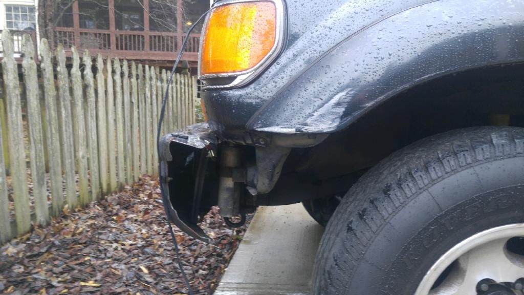

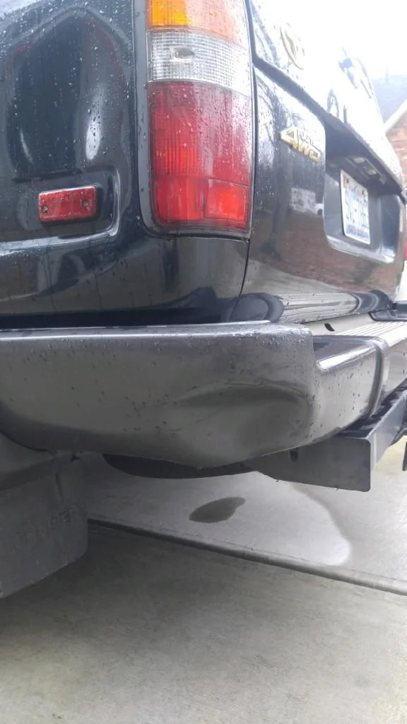

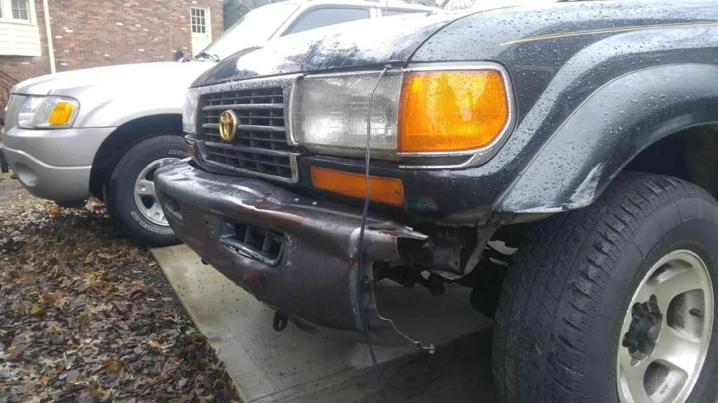

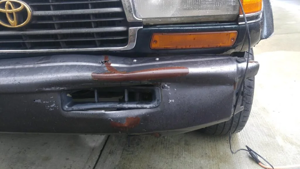

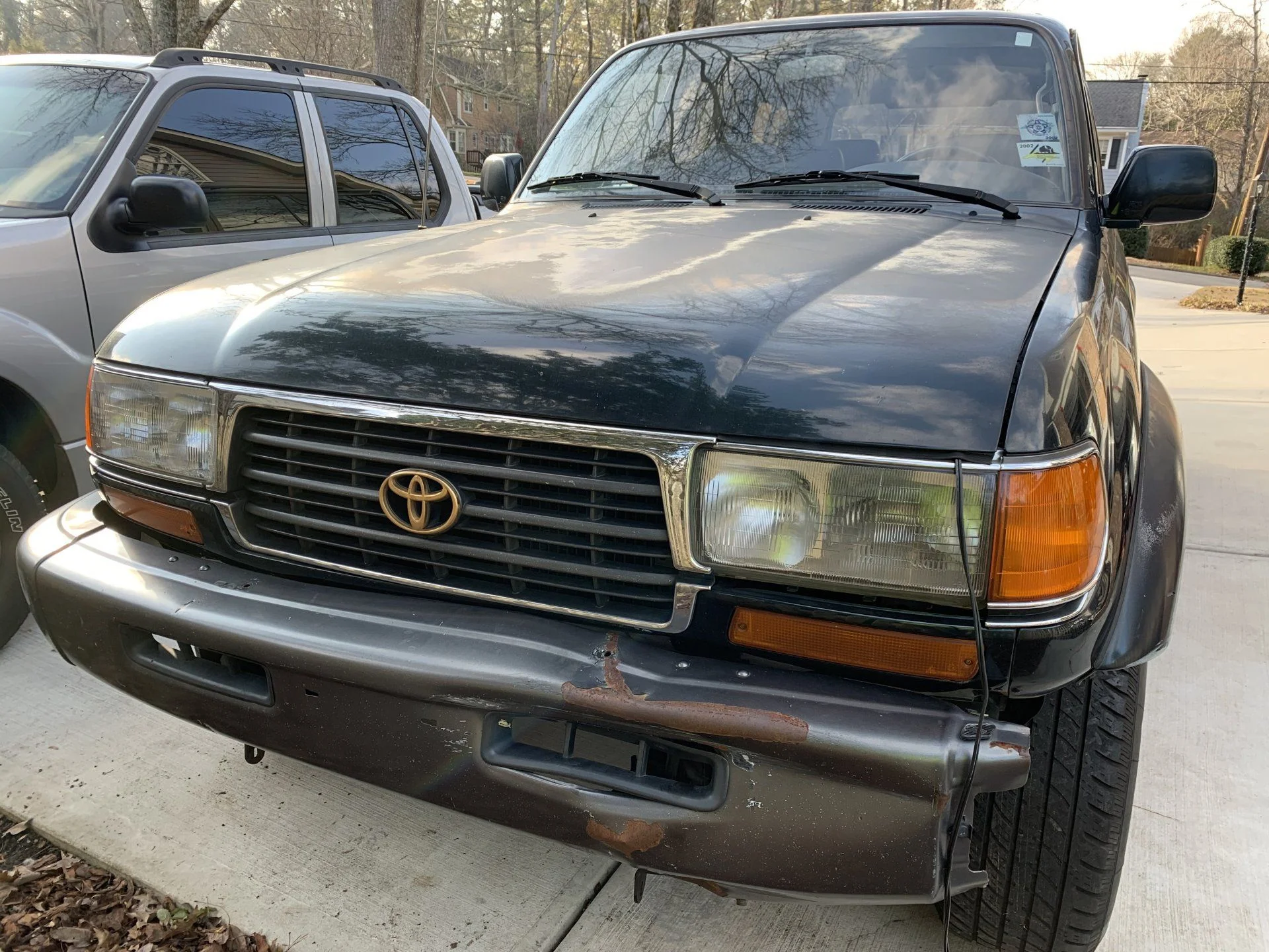

After noting a few other items a first parts list was born. Also a few pictures of some of the cosmetic stuff that’ll need attention.

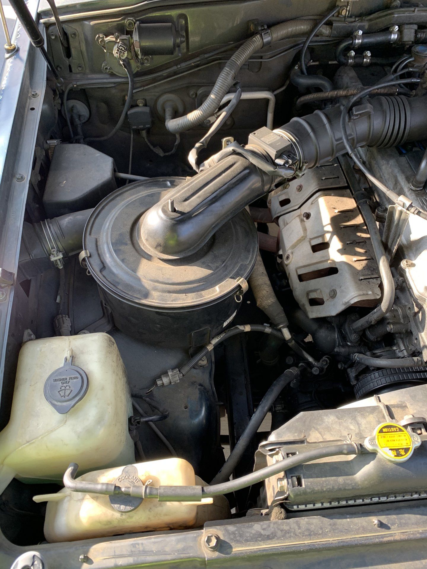

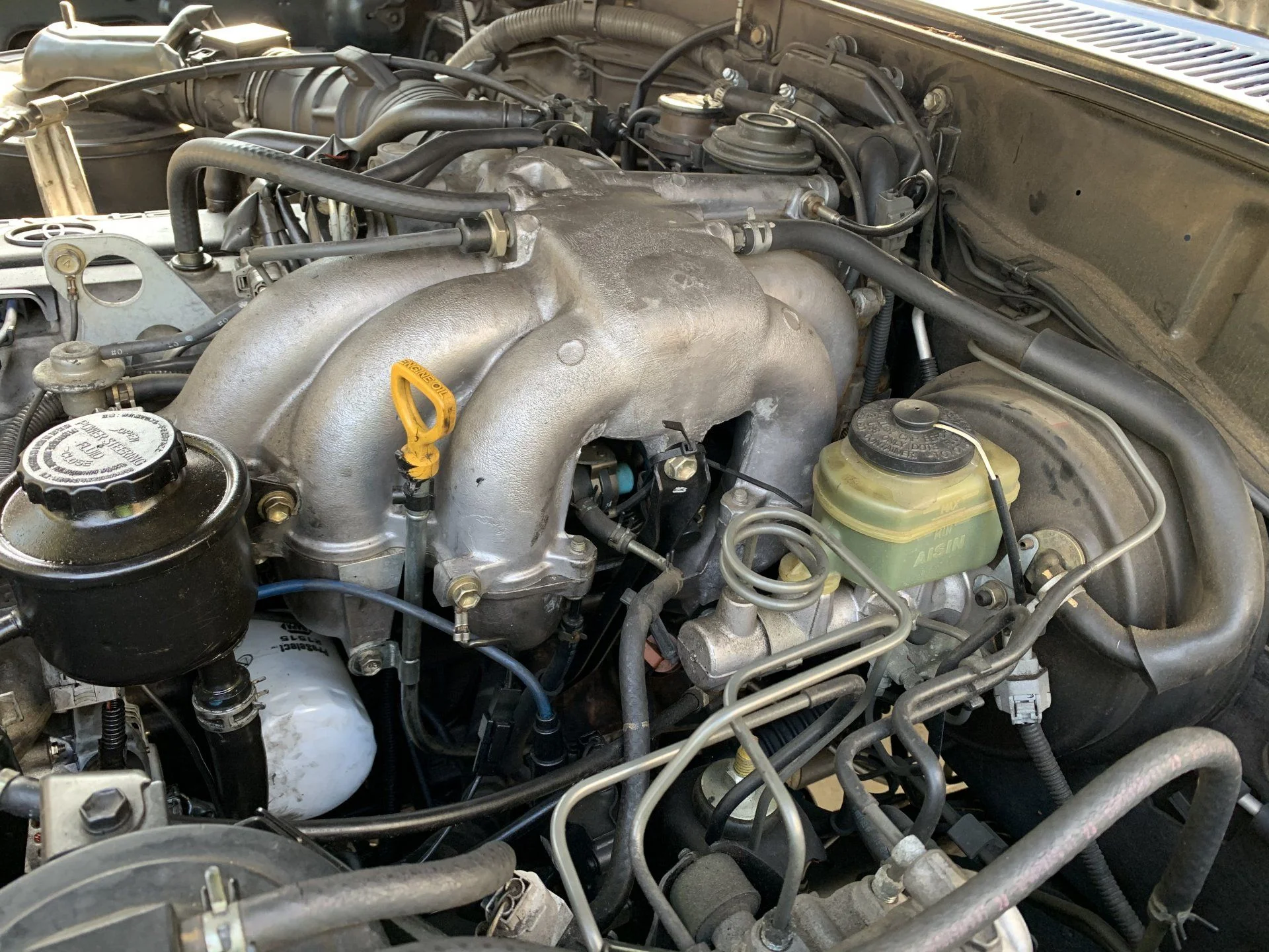

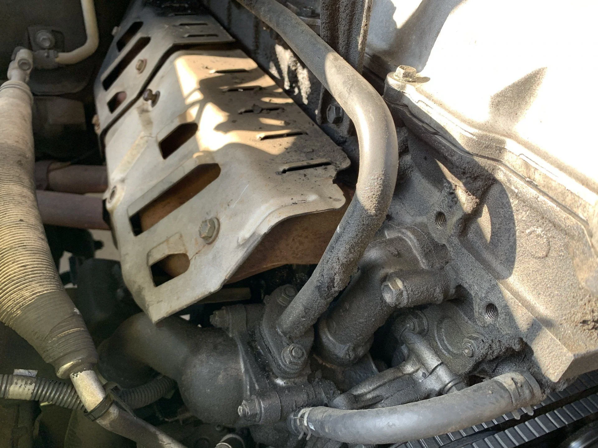

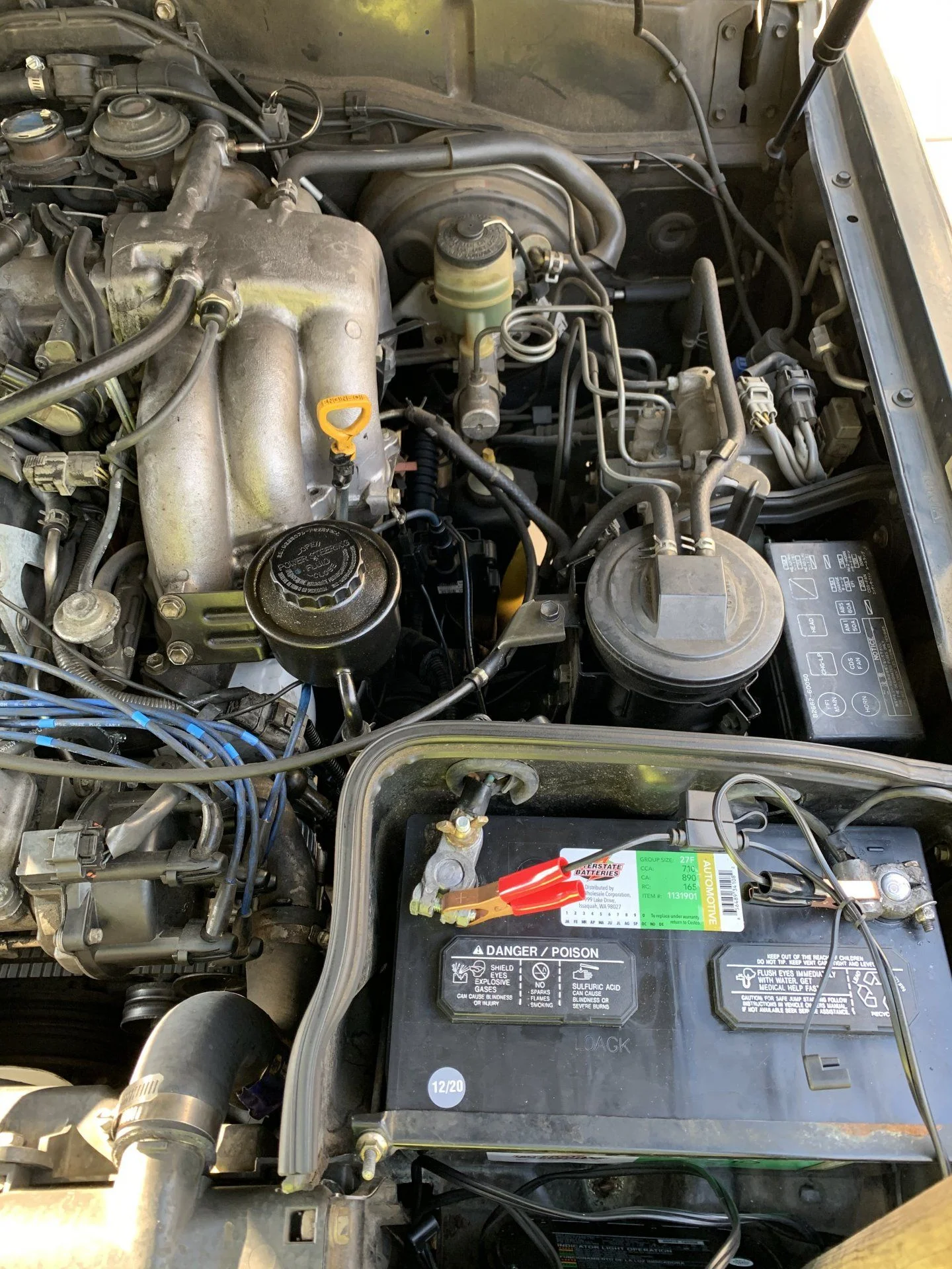

Here’s some Day 1 Engine pics... What do you see? We’re starting with getting the cooling system back in working order by replacing the parts listed above (radiator, thermostat, radiator hoses, water pump, temp sensor, radiator cap...

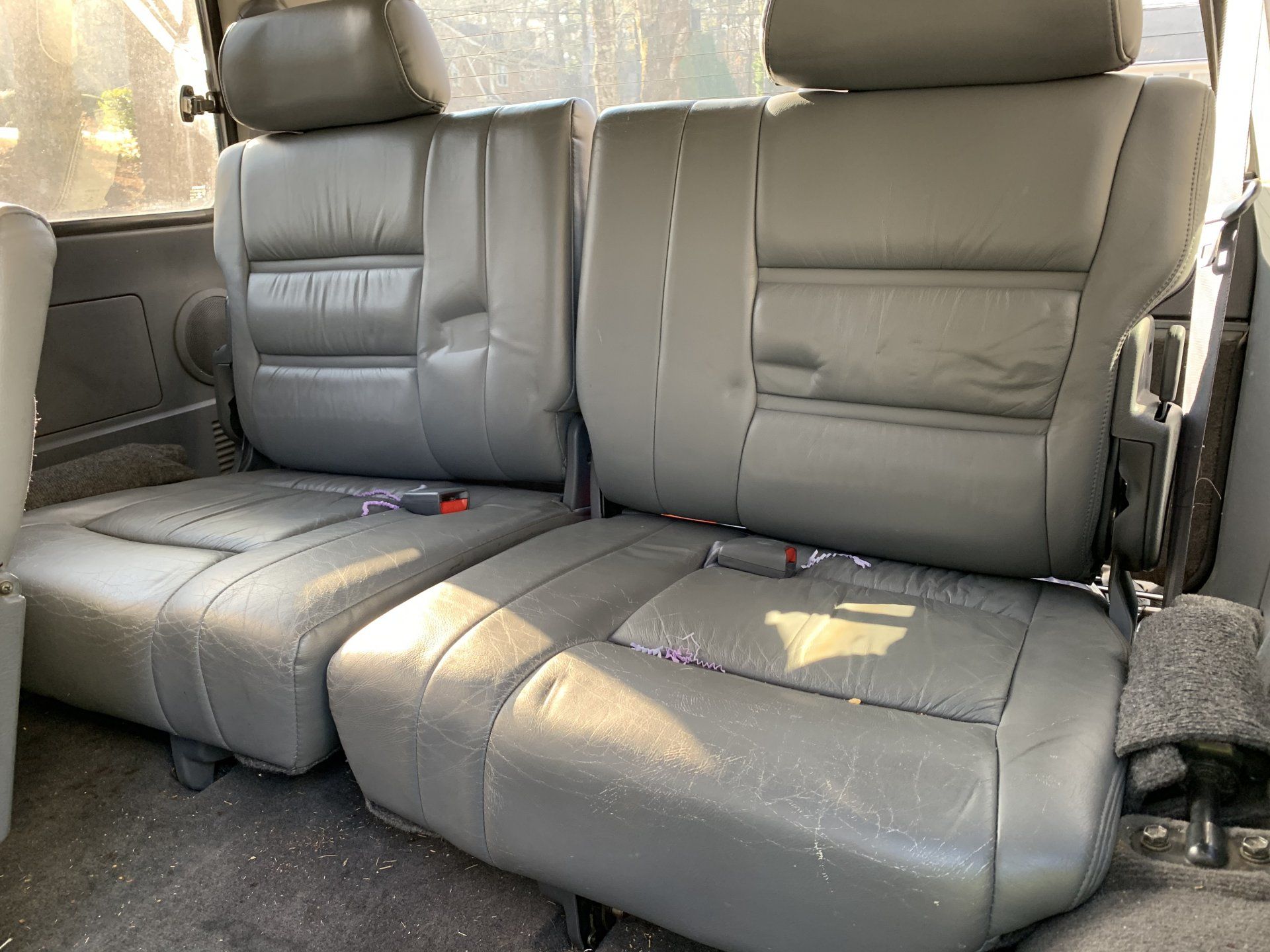

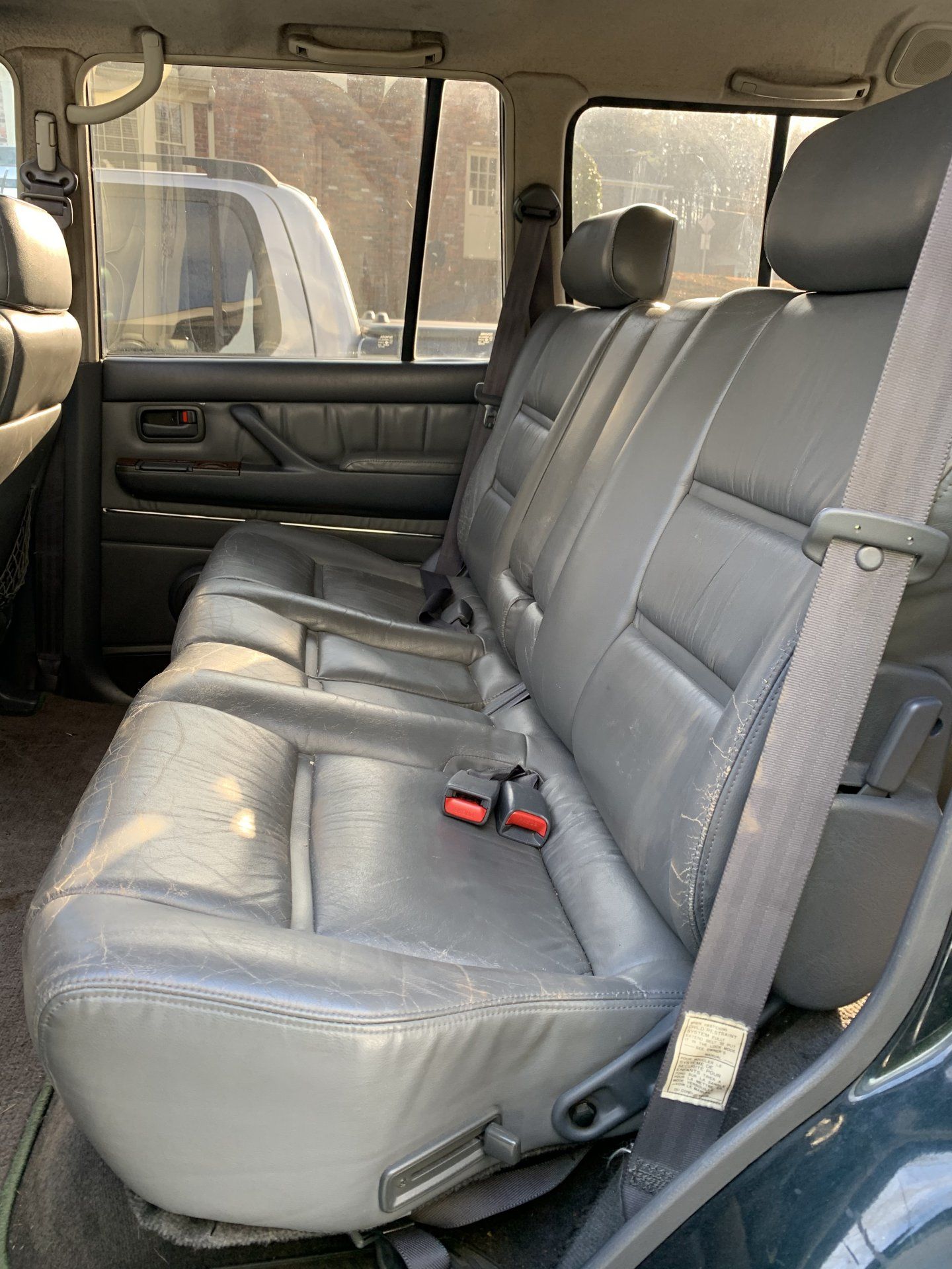

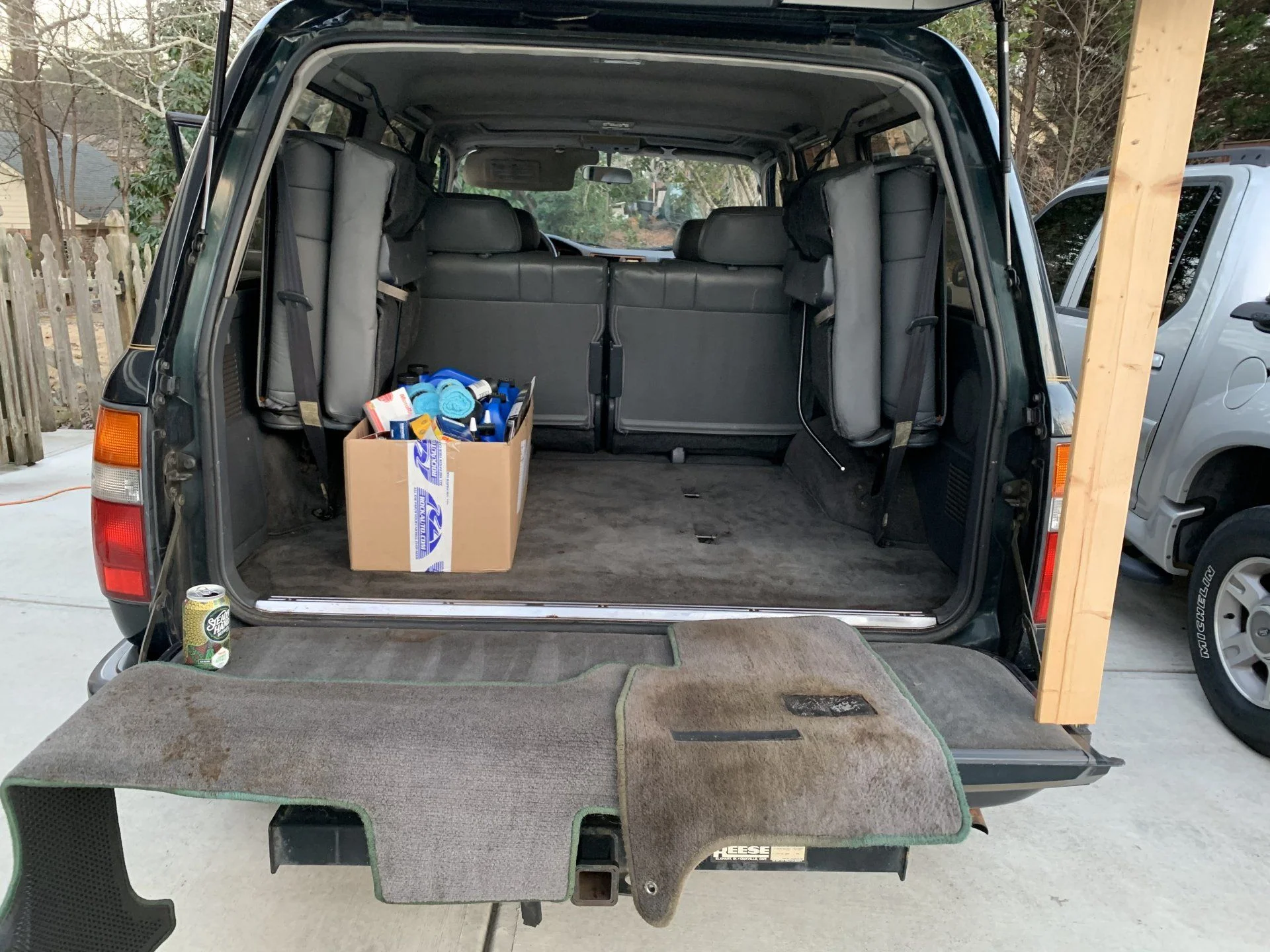

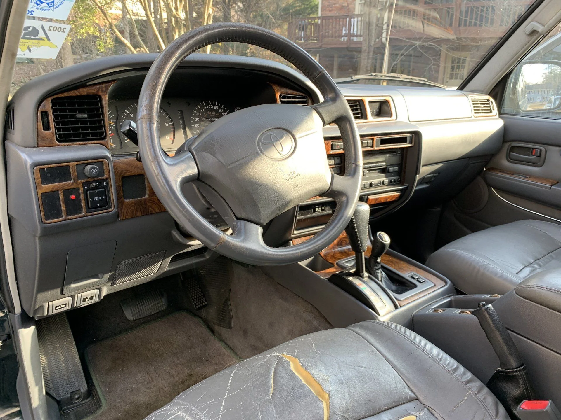

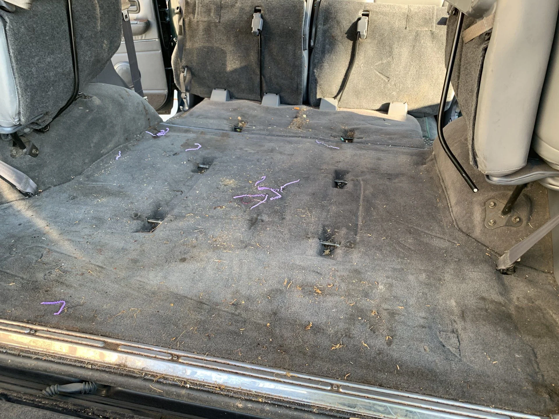

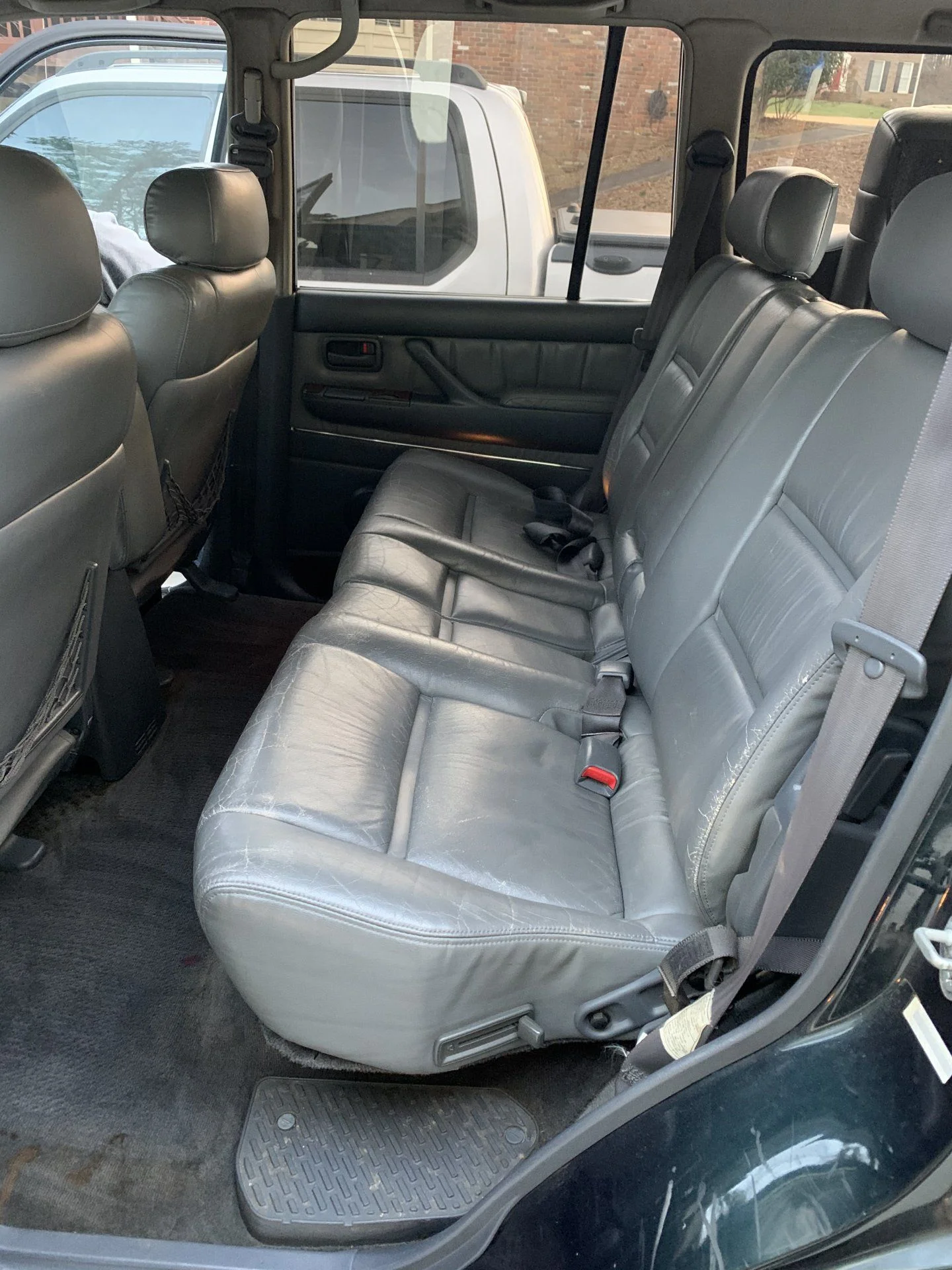

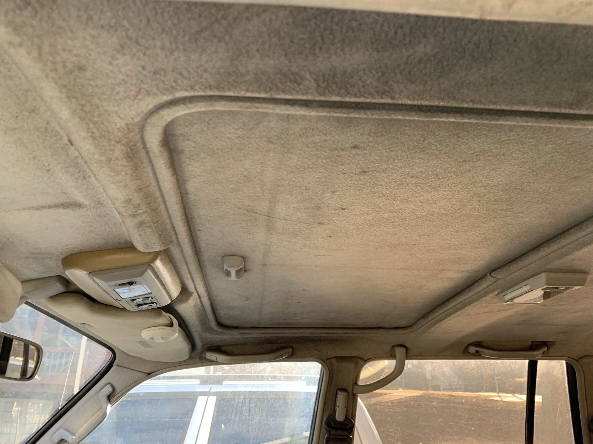

And some dirty interior pics... contemplating replacing the leather on the seats from a local upholster shop, and buying new carpet/jute and installing that ourselves. Obviously the driver’s seat has seen its better days. Also, I’ve read through the thread about removing the wood trim, and that is definitely on the list... lastly a very good cleaning of the headlines and every other nastiness is definitely in order...

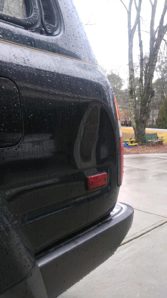

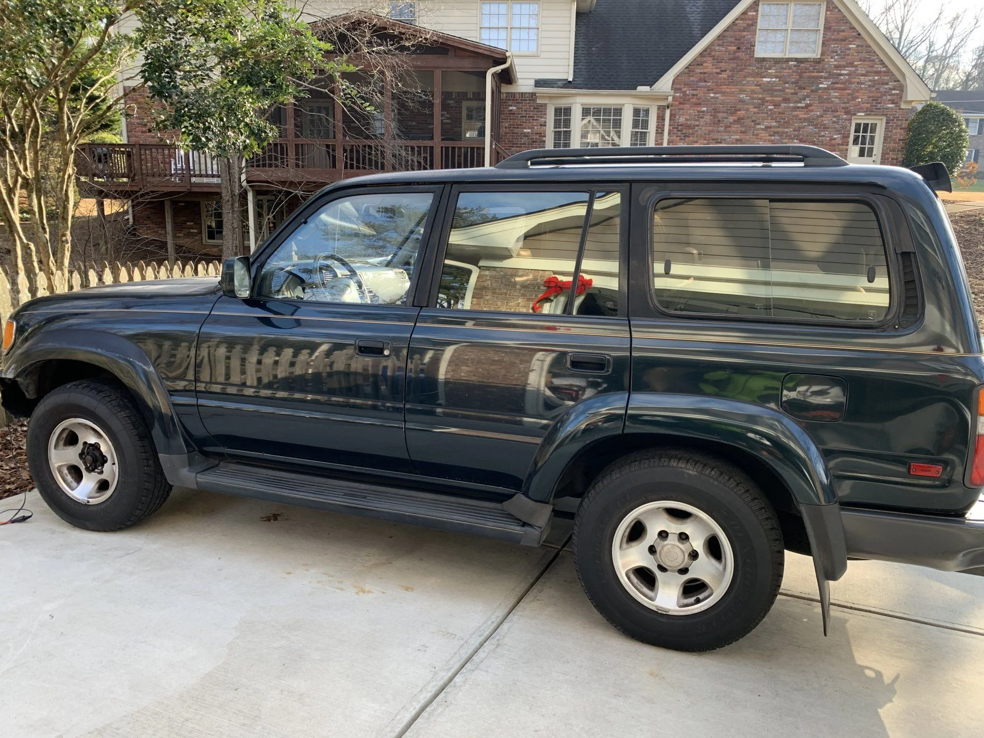

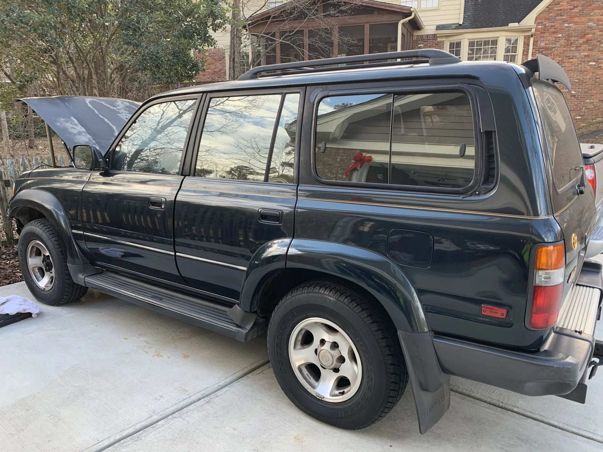

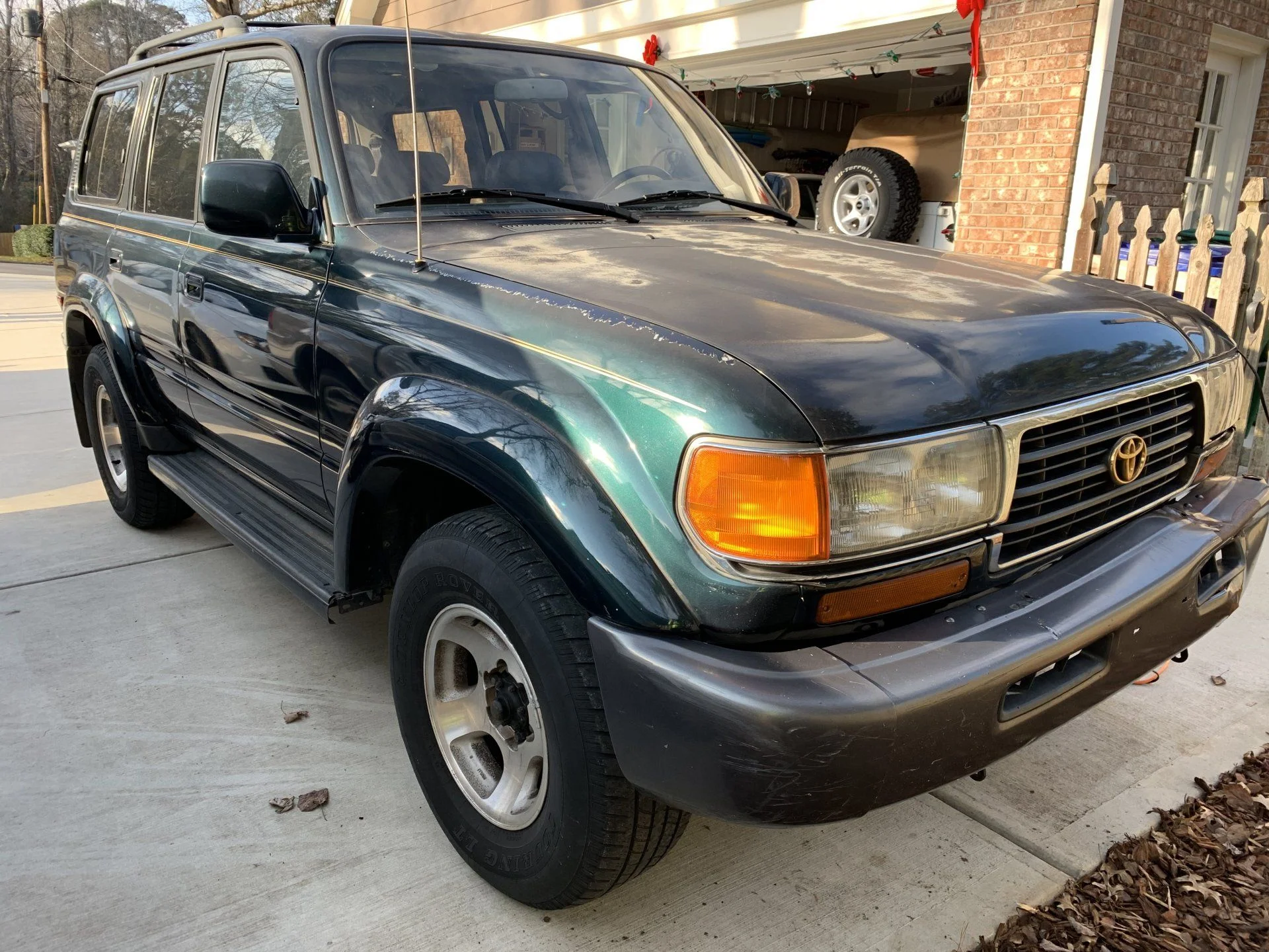

Some extra Misc exterior pictures...

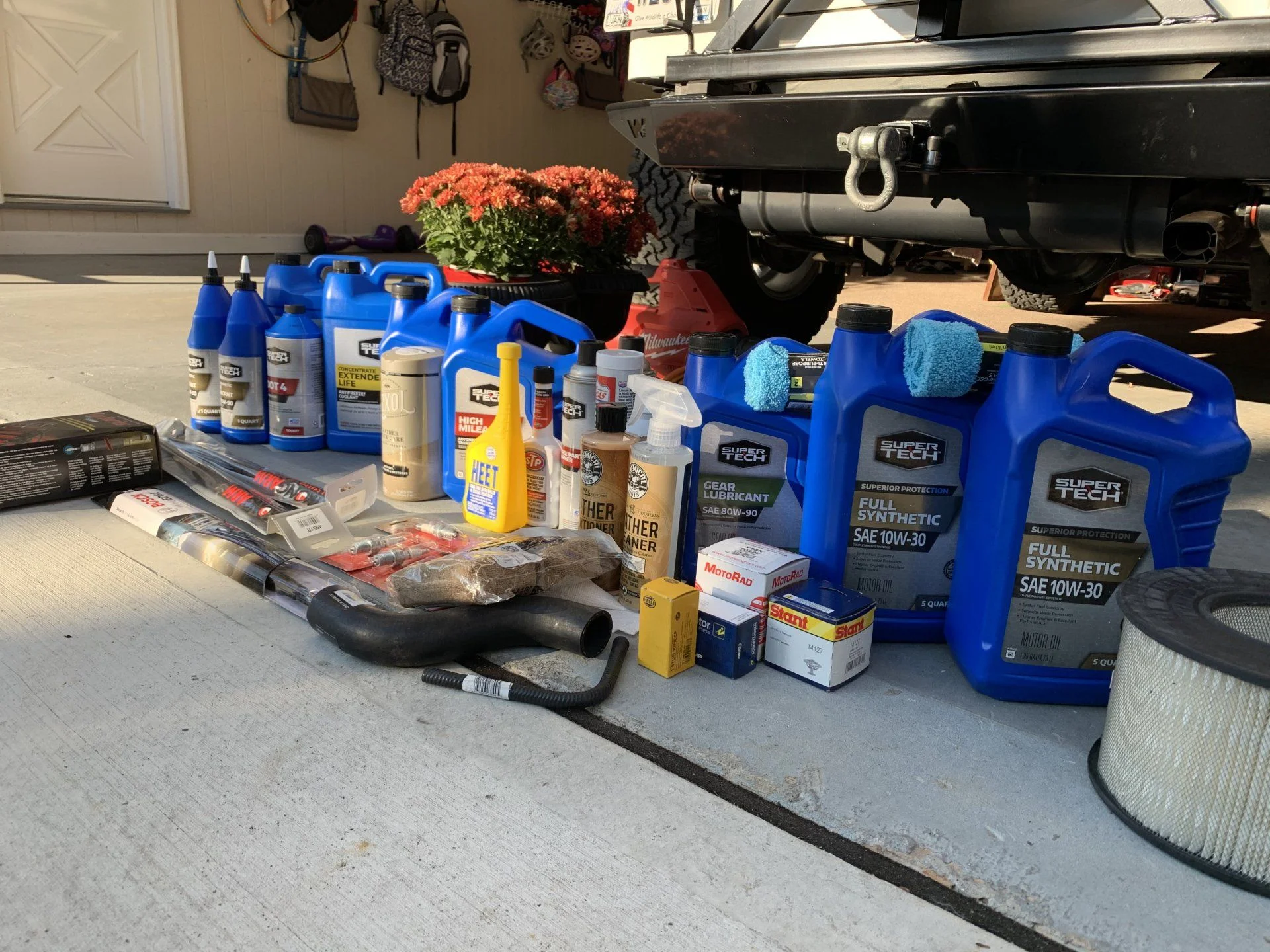

Late start today. Blame it on Fedex... we were supposed to get 2 packages from Rock Auto and only got one (both were originally scheduled to be delivered yesterday). We’ll plan better next time. Also we got a lot of fluids for baselining, and I know for the purists, maybe we should be using something besides wal-marts brands, but I’m OK with it. In the end what got done this afternoon? Vacuuming the interior completely, replaced the hood struts, and drank a delicious beer. More to come.

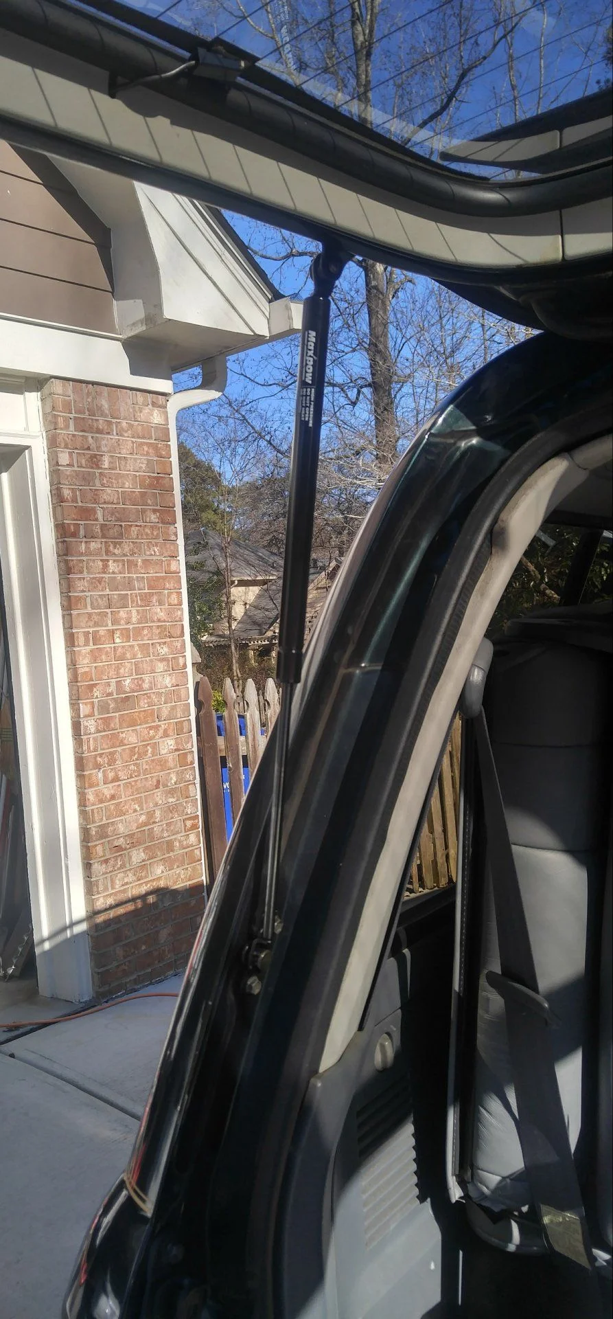

Some updates... First... the easy stuff. All of the 4 gas struts that hold the hood and rear lift gate are installed. Baby Steps...

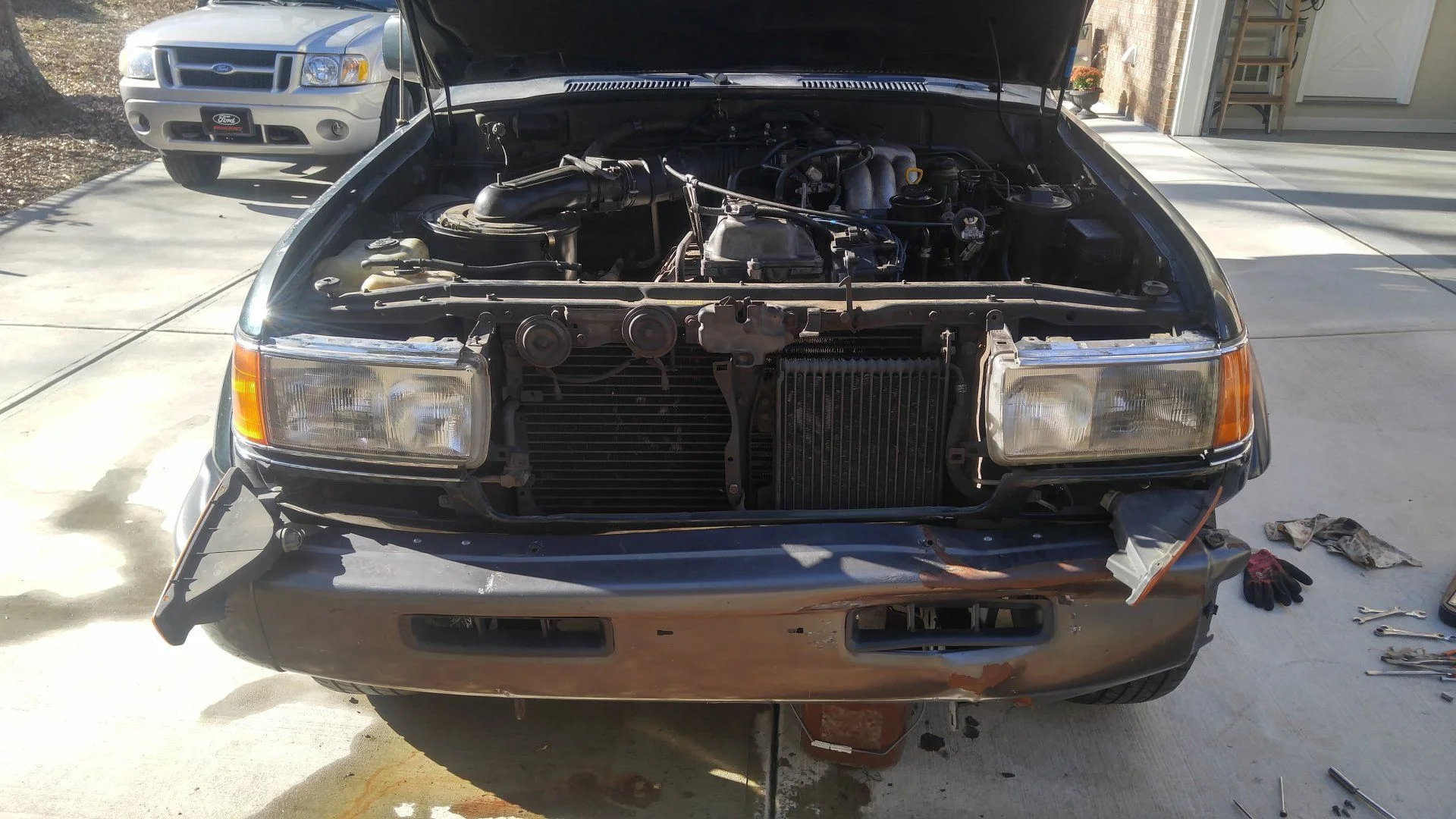

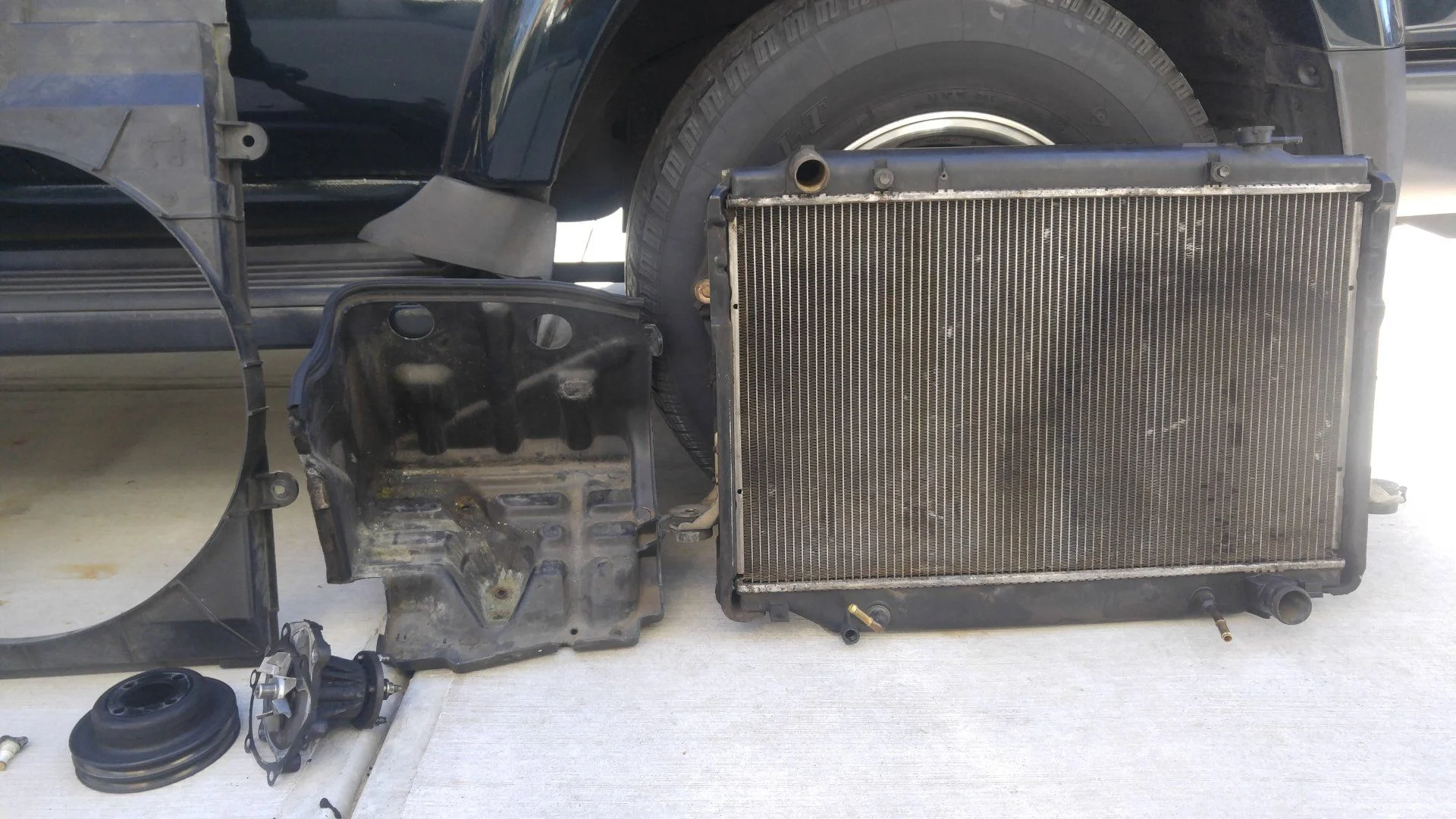

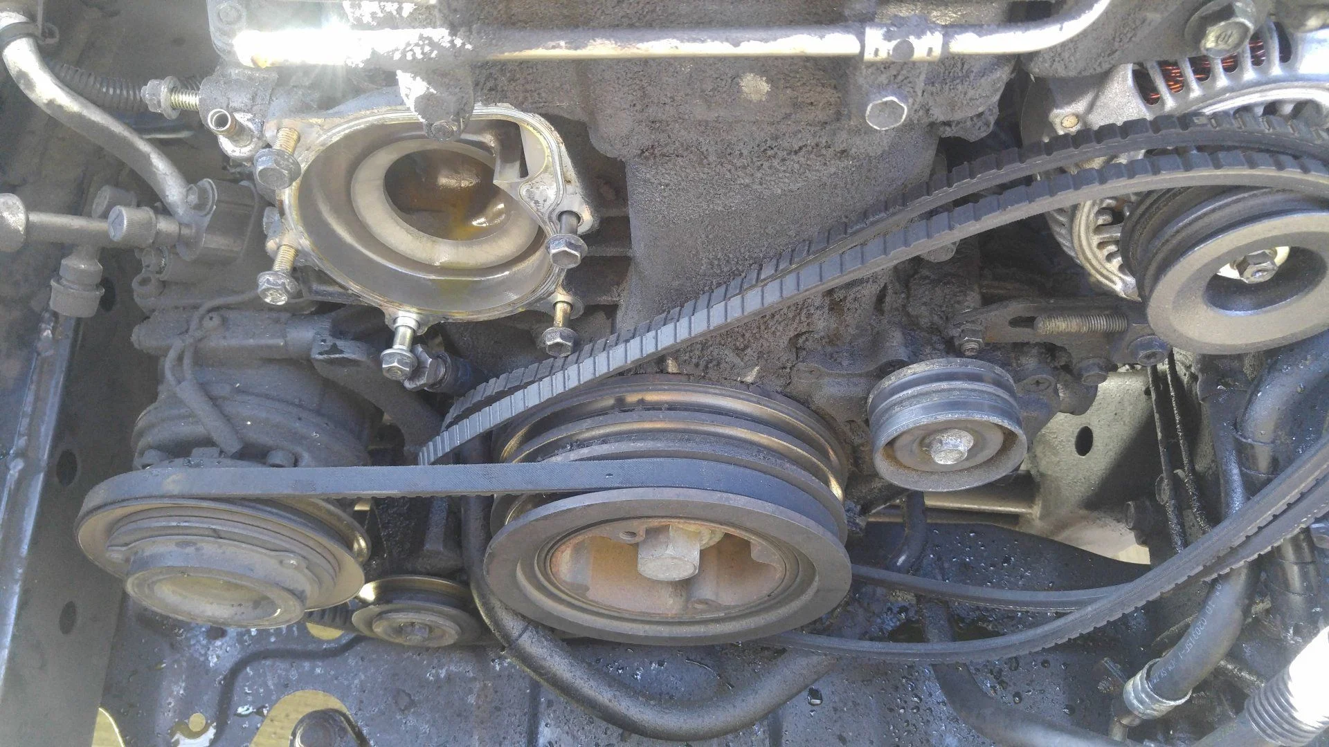

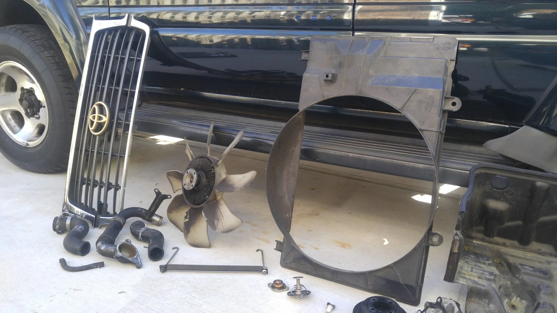

And now the deconstruction part... so far, just trying to hold back on fixing/replacing everything that we see. Have to keep in mind that the first goal is to get her running/cooling properly so we can figure out what needs attention next. So with that, most of the cooling system is OUT.
