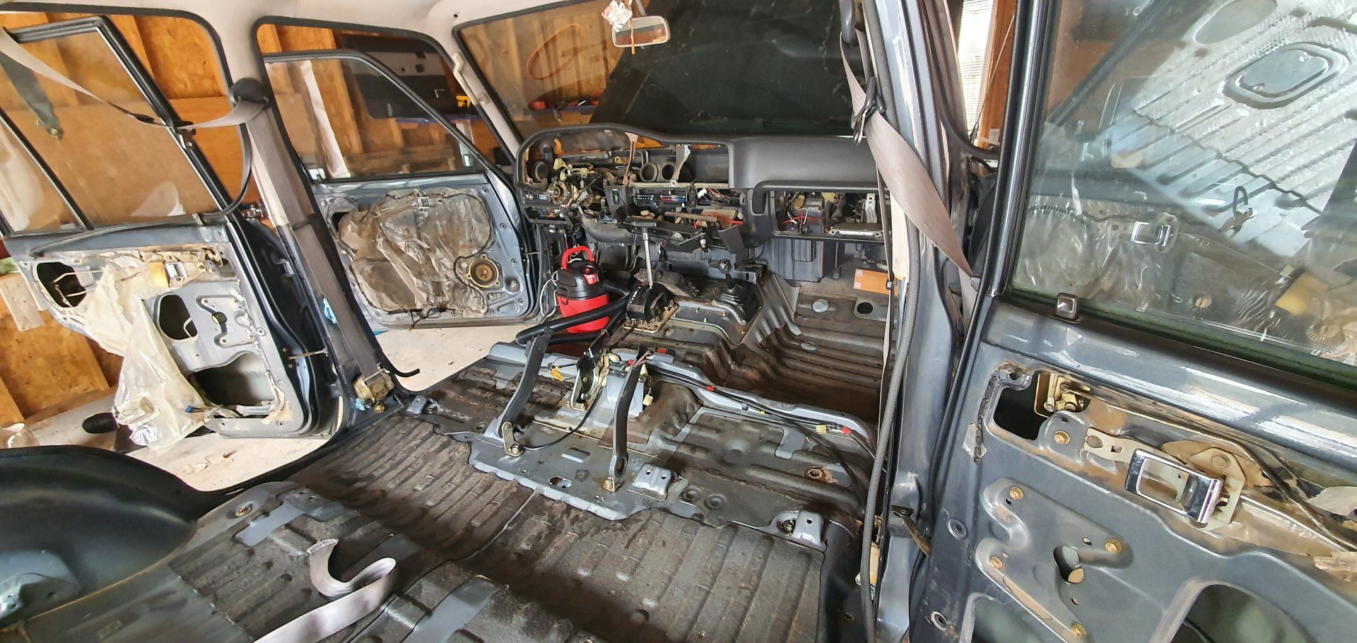

I'm still cleaning, taking apart, preparing for sound proofing.
Debating taking off the interior roof liner... mine is in great shape and don't wanna mess it up. I do know I've had mice in there though and at least some sound deadening up there would help.

No need to remove the original sound material. Clean well and lay over the top of it. Also no need to wallpaper every square inch of your truck with that sh*t, the overkill of sound deadener application on this site is crazy. Think about trapped moisture under all that stuff with no way to breathe.
Thank you! The point of sound deadener is to change or reduce resonant frequencies of panels. Toyota's thick tar mat does just that, and so do aftermarket versions. Use 'em all, but pay attention (as mentioned) to areas (perhaps near door seals) where water can get trapped under it. A bigger problem in wet climates and with un-garaged vehicles.
I forget what the % of coverage should be for the tar mat/Dynamat/quietcrap type deadeners but it’s not much relative to a given panel. I did my inner doors and used 3 separate smaller patches on top, middle, and bottom door sections...doors sound like a bank vault. And there’s lots of open sheet metal left to “breathe”, no seams, no trapped air pockets to sweat, etc.
I read 10% coverage in large areas for Dynamat.
The doors of my 1976 FJ55 sounded like a oil drum when you slammed them (the sheet metal rang like a bell), and I stuck a 10"x10" piece of ice-and-water shield (roofing material) in the middle of the unsupported front door skin, and after that, the doors shut with a nice 'clunk'. Ice and water shield is the poor man's Dynamat - and hey, I had some in my barn that was paid for, as it were.

I know weight is what dampens the most sounds. I'm not so worried about the cargo area floor, but I'll slap some on the cargo side paneling inside and whatever sounds super hollow, tin can. I'm not gonna line the whole cruiser for sure...
I'm keeping the factory deadening in there and mostly put some heavy closed-cell foam sound deadening mats on the floor and the aluminum stuff in the doors, firewall.

Endless death valley dust in there......

I'm about to put in sound deadening myself. I noticed that I get a lot of noise from the tranny tunnel and rear wheel wells. I'll likely go overboard in those areas and on the firewall. It might not hurt to put some foam on the inside of the door cards or on the vapor barrier and rear quarter boards. I haven't found any stories of the sound deadener wicking moisture, but use your common sense. It's essentially ice and water shield so might actually prevent rust in some areas. Definitely wanna put some on the rear quarters but thinking maybe some under the hood as I'm appalled at the noise from closing it. I'm sure I'll still hear all those LandCruiser sounds anyhow, but reducing the tinny resonance is the goal. Thinking I may put a few patches of it in the tailgate as well.
If your hood sounds like a junkyard when you close it, check the glue joints between the inner and outer hood (behind the fabric hood silencer pad). Mine had mostly failed on my FJ62 and my FJ55. In both cases, I used polyurethane sealer/adhesive (the PL product line from Home Depot) and massively glued the inner and outer hoods back together. To 'clamp' the hood, I closed the hood on some 2x4s on end, to put pressure on the inner hood to hold the inner and outer panels together. The weight of the hood trying to close itself was enough to compress the panels together.
When all done, the hood was much less flexible/floppy when opened, and quieter when slammed.
