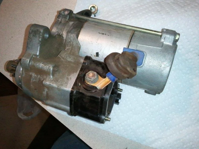

Not sure if this has been posted or done, but here is a tip if the starter won't kick over and you need to get the truck moving... Only tool needed is a horseshoe stake or similar pipe/lug wrench...
I was on vacation when our starter went on our 1998 LX470 (160K miles). I knew exactly what it was as I previously changed out the starter in our 1999 LC. I did not have the time, tools or ambition to the 4 hr job. From prior experience with bad starters a tap with a hammer could do the trick, but kind of difficult to get the hammer past the intake. My solution was to remove the plastic cover (2 bolts and 2 nuts) to expose the intake. Sure enough you can see the starter between the intake risers on the passenger side. Using the tools at hand at the lake cottage, an iron horseshoe stake easily fit through the two risers, a lite tap and the wife fired it up. Kept it running until home.
