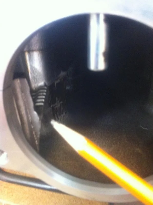

While the intake manifold is removed, has anyone taken the opportunity to grind-off the flashing just inside of where the throttle body attaches?
I know it ain't port&polish, but seems a no-brainer...

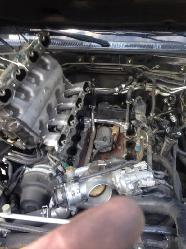

Chris, great writeup. A week or so ago I used this writeup to change the contacts on a '99 Cruiser...I took some pics if anyone is curious.
I took several pics of the sides of the engine before removing the intake. It really wasn't near as hard as I thought, and connecting all the hoses was not tough at all to figure out even without ever looking at these pictures. One thing I think that was left out of the writeup was disconnecting the electrical clips off from each injector, they just unclip, I had to use pliers since I couldn't get on them good enough with my fingers. The ends of the intake are what has the studs, so each side has the studs on the ends and 3 bolts in the middle like Chris mentioned. You will definetly want a magnetic picker-upper tool to fetch those nuts/bolt and also for putting them back in. I found out if you put a bolt/nut into the socket, then hold the magnetic thing right beside it, you can slide both down and get it started perfectly, that saved TONS of time.
The gaskets on each side (visible with the intake removed) are reusable, I was going to buy new ones, but CDan said they do not even replace them at the dealership so we just left them. You see the pile of leaves in there, we shop-vac'd all that out, and cleaned all the dirt from around the intake ports. I disconnected the incoming fuel line like Chris, by far the easiest way I think, you have to somewhat snake the hose out and back in, but very easy, take 10-15 seconds maybe.
The bolts for the actual starter are a PITA to get to. Well like Chris said the left one is not hard, but the right one is. For the right one I used a 3/8" ratchet, 3" extention and 14mm deep socket, reach back there pushing the wire bundles aside and slip the socket through the bundle (just the socket and extention, easiest IMO to not have the ratchet handle on here), wiggle that around until you're on the bolt. My socket never really got on it all that good, I think I was partially hitting on something else but I was on it enough. Also there are the bellhousing bolts slightly further down, so if you're really confused (we were) you may be trying on those, which are 17mm and therefore the 14mm feels to small, well then you're on the wrong bolt. Once the two starter bolts are removed you can move it slightly, enough to disconnect the incoming power wire (12mm wrench), you have to roll the starter a bit to the left, which is a pain, very little room to work in there. Then just unclip the other wire (small one from the ignition) and the whole thing should come out.
The starter contacts are functionally idential to a 80. Interesting the new contacts came with a little paper piece, I didn't know where that went, there was nothing like that at all in the factory ones, so I didn't put it in.
When putting it all back in you have to hold several things out of the way to drop the intake back on, somewhat of a pain but not bad with two people. We cleaned the throttle body a bit while it was disconnected (never removed it, just push it off to the side), it was very dirty, a ring of gunk around it and the intake was very dirty too, but we didn't want to deal with pulling that apart. I'm not sure what would make that so dirty, I was thinking bad gas, but no gas hits this, this is all just air, so I guess just dirty air. (This vehicle had about 85K miles in these pictures)
Throw everything back on, take a look at these pics if you get confused about what went where, but it really wasn't to bad.

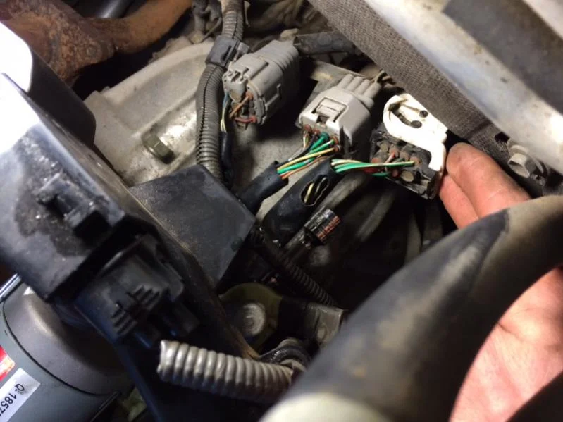

1. The tough to remove starter bolt is not too bad to get to if you do the following: Disconnect the black (driver's side) cable harness going to the tranny (it has the white rotating locking bar on it). Next disconnect the gray cable next to the black one you just disconnected from the sheetmetal it is snapped into which sits on top of the tranny--simply pull it toward the radiator. This will give you enough room to use a 3/8" 14mm deep socket connected to a 3/8" to 1/2" adapter socket connected to a 1/2" ratchet. You will now have plenty of leverage and can easily grab the ratchet handle.

The post above about moving the wiring harness on the tranny to access the DS starter bolt is the ticket. This made removal very easy, no problems at all. The hardest part was finding a place to sit/stand/kneel in the engine bay without breaking stuff!

Here's a photo of the relatively easy access to DS starter bolt with that wiring hardness disconnected and pushed out of the way. I used a standard socket, 3" extension and locking flex head ratchet.
