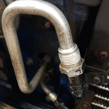

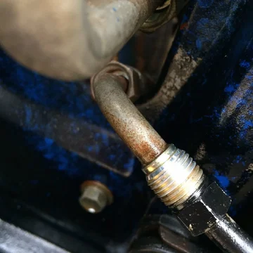

Correct me if I'm wrong, but the hard line hoses that go to the Trans cooler should disconnect here >> IMG_3028.webpIMG_3027.webp
I ask because these suckers won't move. they're frozen together. I've soaked them in PB for the last couple hours, even tried heating them with a heat gun. Nothin.

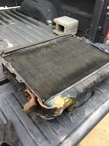

How the last person attached the Radiator makes it so I have to get the trans cooler out of the way to fully disconnect the raid bolts from the frame.
I got an impact gun from HF, so after I get the raid out of the way hopefully I'll get this sucker off.
Update: I got the two pipes separated. Nothing a little blow torch couldn't handle. Pulled the trans cooler out, and the raid. Plenty of room for the impact gun, but it still didn't budge. i blow torched it, hit it with a hammer, and still it hasn't moved. I'm gonna see if I can borrow a bigger impact wrench from a friend and see where that gets me.
