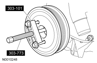

I like this design of puller for the harmonic balancer
