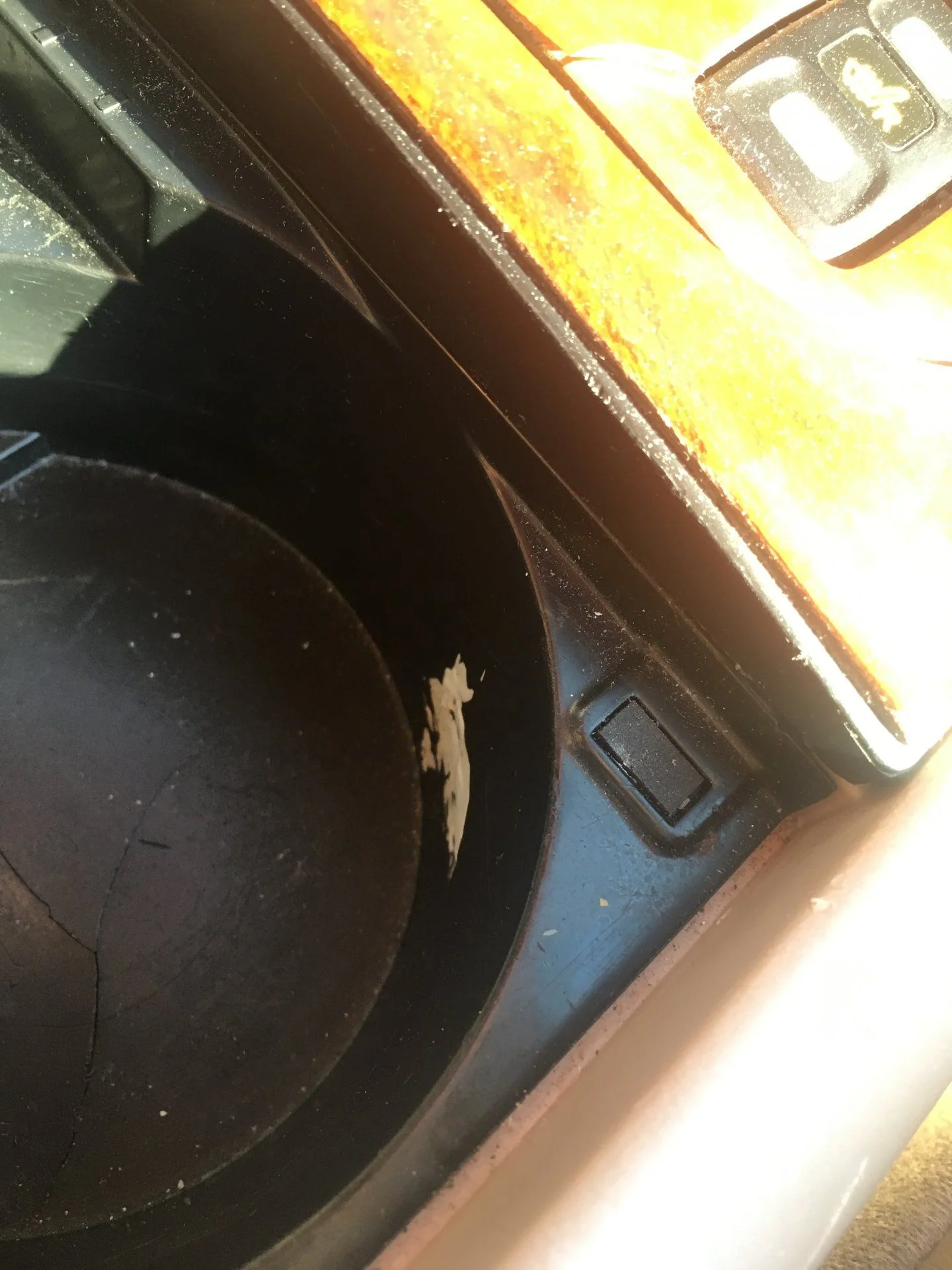

I wasn't trying to attack the area you are describing at first because I had an idea that ended up working well. See images! Basically, I liked the "period" look of the 6 CD changer lid and felt like it was part of the character of the lid, so I removed the whole unit, gutted the CD player and installed the bluetooth module in it. I know others have installed the module out of sight, but I liked having it handy for its USB and Aux In ports. I velcroed it to the inside of the steel box so that its removable. In the future I may fill the void space in the box with a black foam but we will see. Also, the BT45-TOY said I need a CAS-TLC cable for my 2002 100 series LC but I did not. Just FYI....
