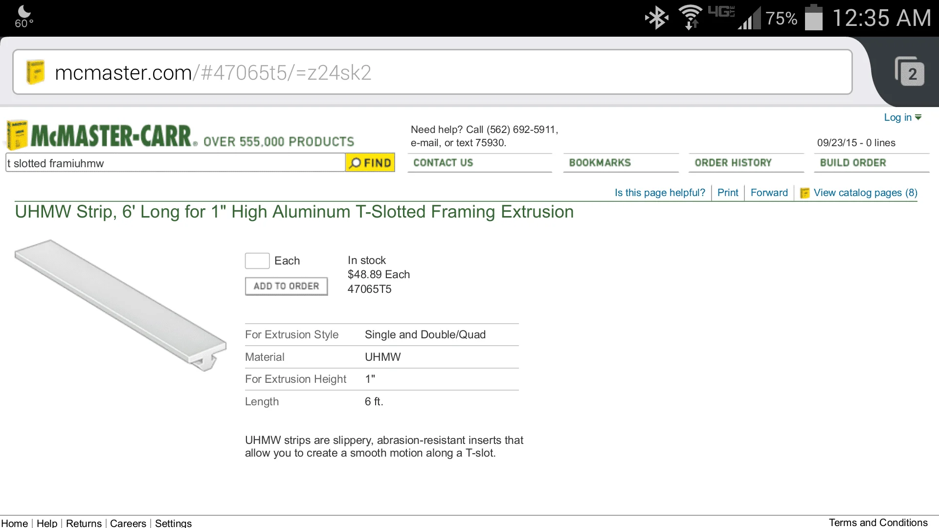

Mcmaster makes a uhmw strip for t-slotted rails ... A little pricier but made to fit this type of application: http://www.mcmaster.com/#47065t5/=z24sk2

I have just over 3500 miles on mine, fully loaded with a roof top tent and two awnings. Nothing has loosened. I don't carry a boat but why not just remove the rear crossbar, slide a piece of black pvc pipe over it and reinstall? Or, you could use the t-slot to mount a boat trailer roller with a couple of "L" brackets.
