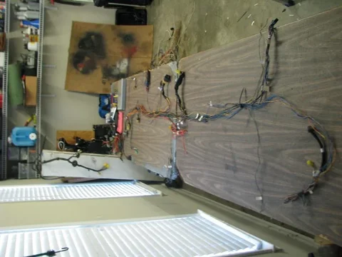

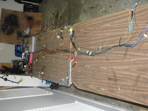

Went from this:

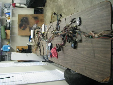

To this:

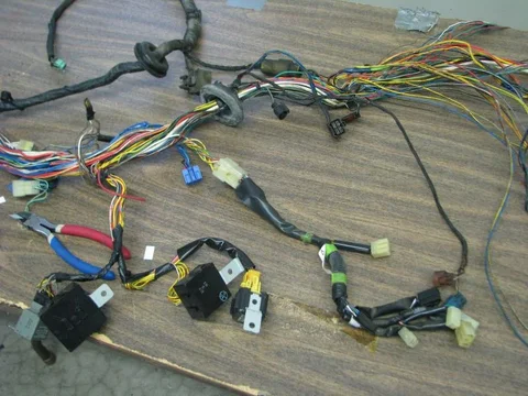

Now I just have to do some wrapping and figure out the Neutral Safety switch, ignition wiring and grafting it to the 40's painless harness. The head should be off the FJ62 by the end of the week and to the machine shop soon.
Impressive work! I am always amazed by someone who can work on a wiring harness....I was too worried on my vortec and subbed it out for the standalone engine/tranny witing
Fortunately, there are a lot of people smarter than me who have documented their experiences regarding this swap. It is by far the most daunting task on this endeavor. It took about 5hrs total working time over 2 days to get it to this stage. It was slow going at first just because I had to familiarize myself with the harness itself, compare it to the schematics and digest it all before going back to the harness. Comprehending how everything was interlinked and what was truly unnecessary became elementary after awhile.. Towards the end, it really started to flow and went quite quickly.
If I had to build one again, it would probably only take a few hours, including stripping off the wrapping.
I am excited that it will require only a handful of splices into my existing wiring to make it work.

I've spent the last 3 hours tonight going over my painless wiring manual (previously rewired the truck with emissions) and figuring out the wiring for direct feed power requirements, extra fuses (2) and ignition relay I will need to adapt the FJ40 ignition to run the 3FE.

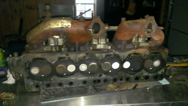

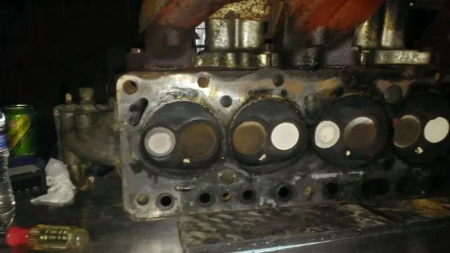

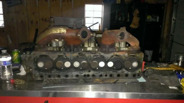

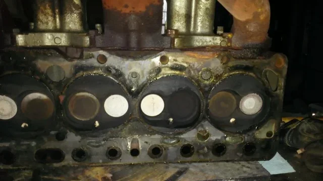

Pulled the head today. I'm not quite sure what I'm looking at as far as the condition of the valves based on their appearance. Overall, the head looks good with no visible cracks, it is not warped and it does not appear as if the head gasket blew anywhere and all pistons looked OK, if not a little sooty. Yes, those white dots at the 6 o'clock position are the spark plugs. They are all caked with deposits.
For those that are familiar with valves, how do these look? I see an interesting pattern on the intake valves of # 2, 3 and 4 at the 11 to 1 o'clock positions. #'s 1 and 6 intake look the best to me. What's up with the exhaust valves? Some are uniformly white and the coloring varies on others.
Pic of the whole head:
Pic of cylinders 1-4, a closer look at the "polished"pattern on the intake valves.
Pic of cylinders 3-6 #5 intake is extra sooty.

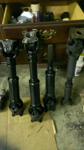

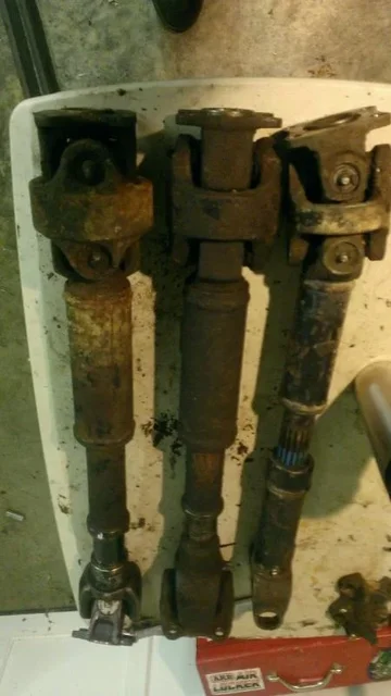

Got my drive shafts sorted
I will be prepared the next time I bust up a drive shaft.
Before:
From left to right: '85 4Runner hi-angle, '84 FJ60 front, Tom Woods custom
After:
From left to right: FJ60, 4 Runner, Charleton's spare FJ60 shaft, Tom Woods
I figured I'd pretty it up for you Charleton;)

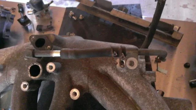

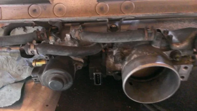

Also, got some of the 3FE parts dismantled for clean-up and media blasting.
I'll be taking the head in for machining and chevy valve install.
The intake manifold and throttle body are a mess.
The interior of the intake and throttle body are caked with oil. I think I'll need to install an oil separator between the PCV and intake to limit the amount of oil blowing into the intake.
