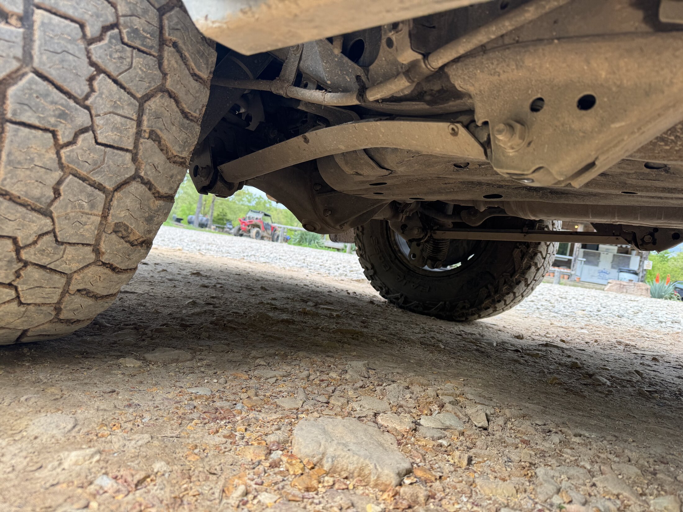

Wow!” That’s impressive. Those guards have stopped my banana LCAs or maybe I’m picking lines better. @turbo8 , seen this from anyone else?

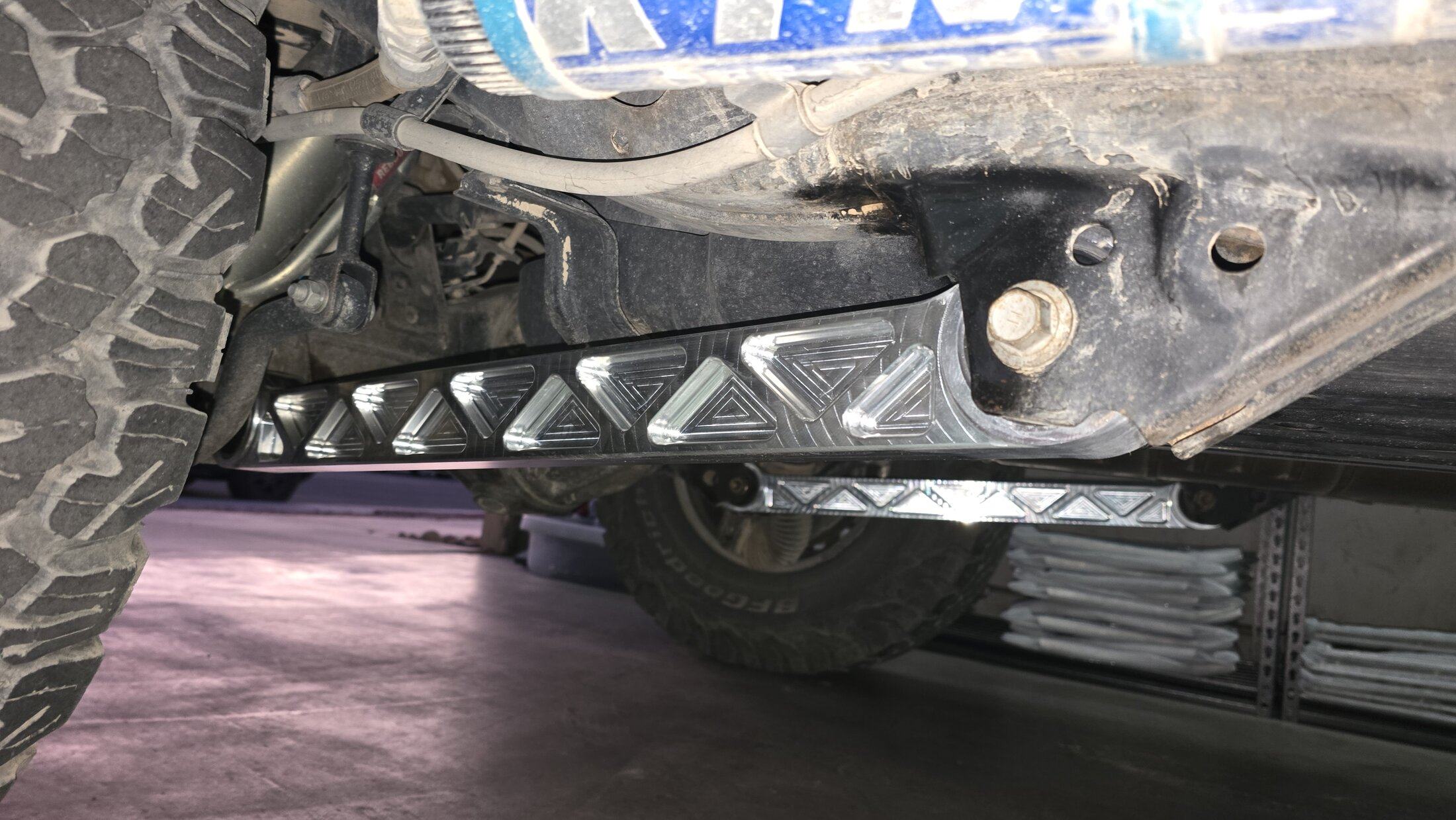

Yeah, I have seen it happen on 2 other members 200's. The braces can only do so much before everything buckles. I talked about it after @prharper and @TN LX570 bent their control arms here and here
I made some stronger billet arms for mine but recommend the ones from Superior Engineering.

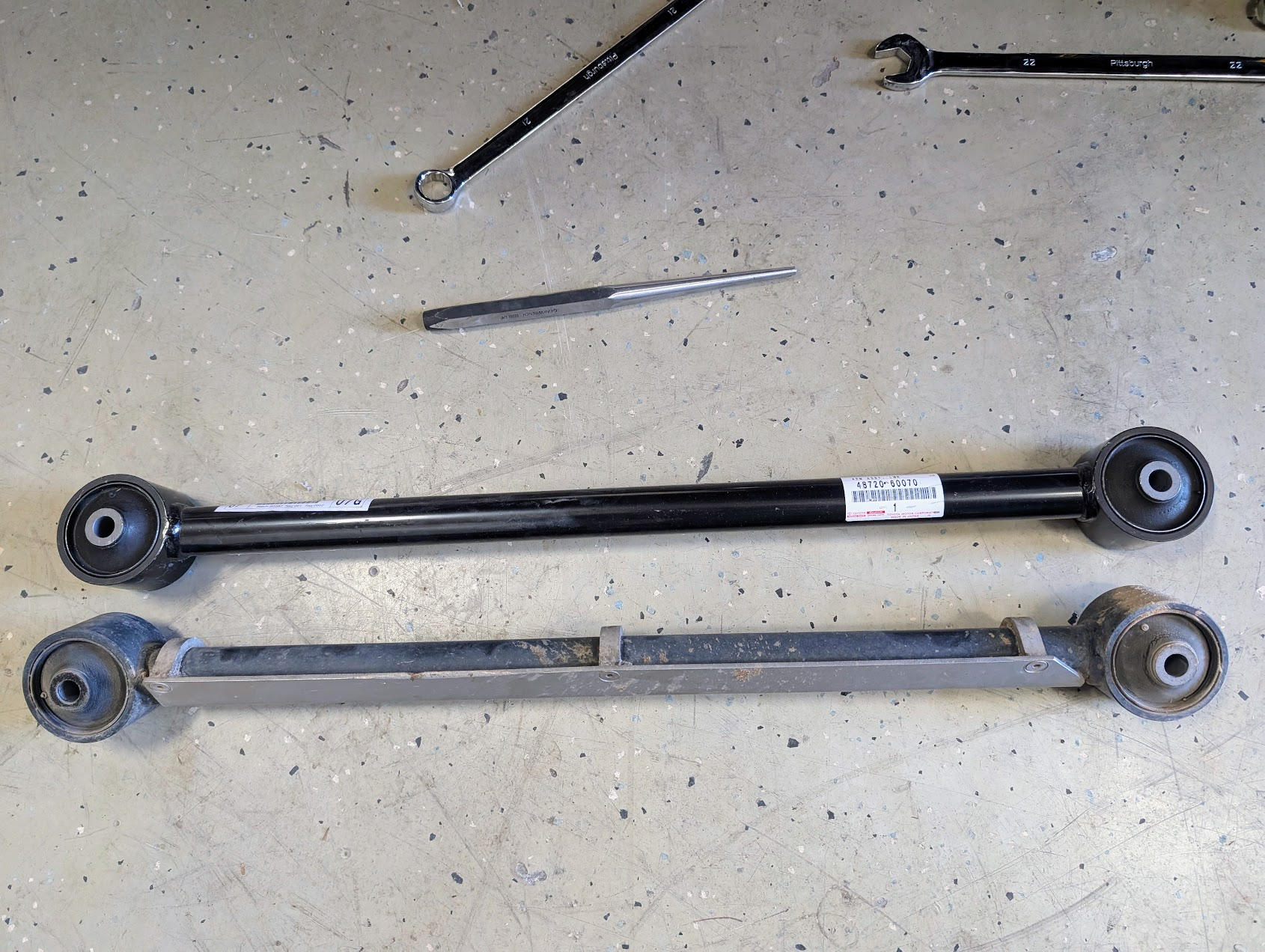

Thanks, I’ll probably just order a new one and replace the bent one. Assuming you can still source from Toyota.
It’s on daily duty but not traveling far this week.
Absolutely can. Part number 48720-60070
