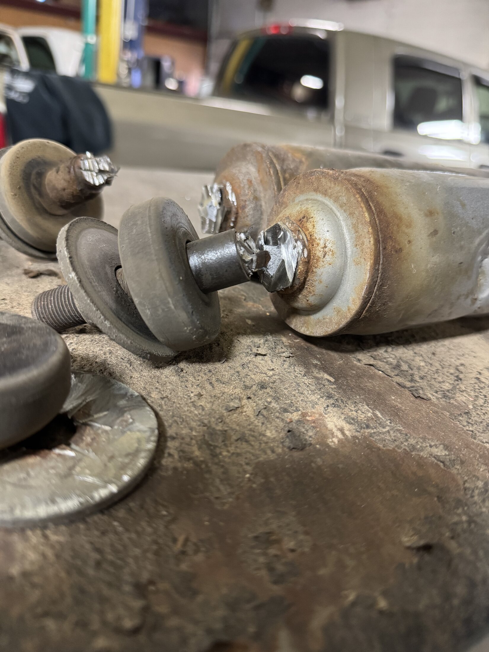

Installed the rear Dobinsons shocks. Ended up having to cut the old ones off. They were overdue for replacement, zero spring back and way easy to push in. They served their life span.

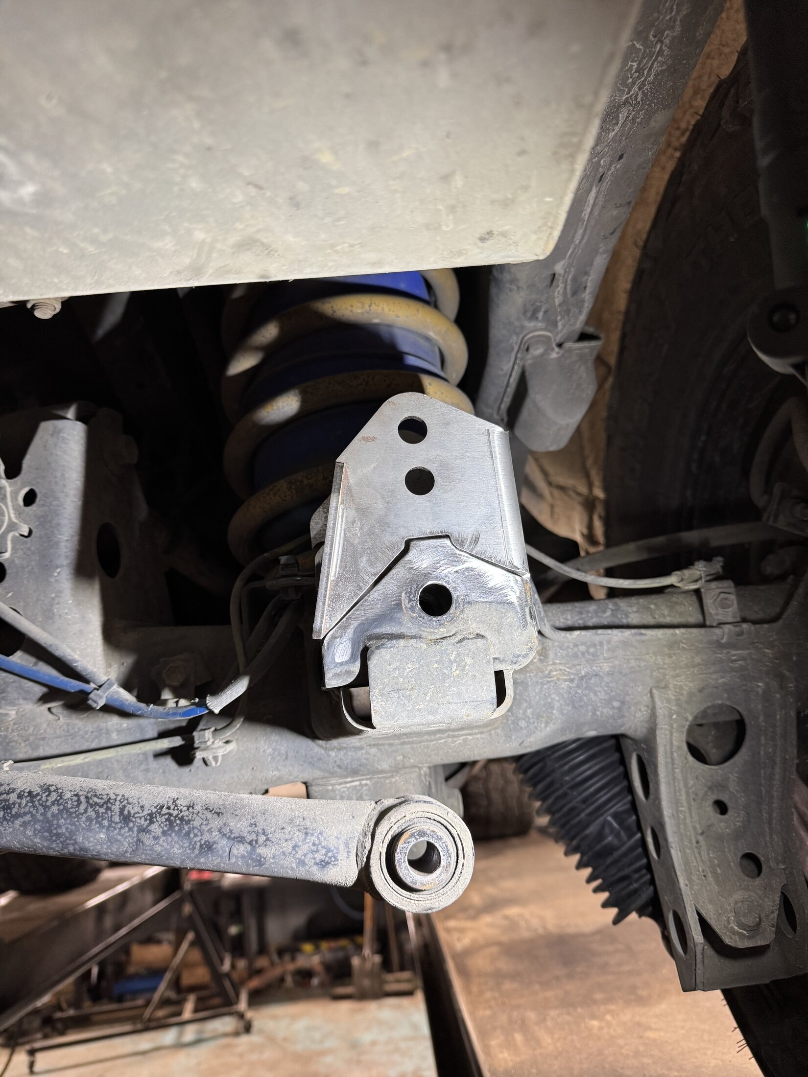

Installed the pan hard correction kit I picked up off a forum member a while back.

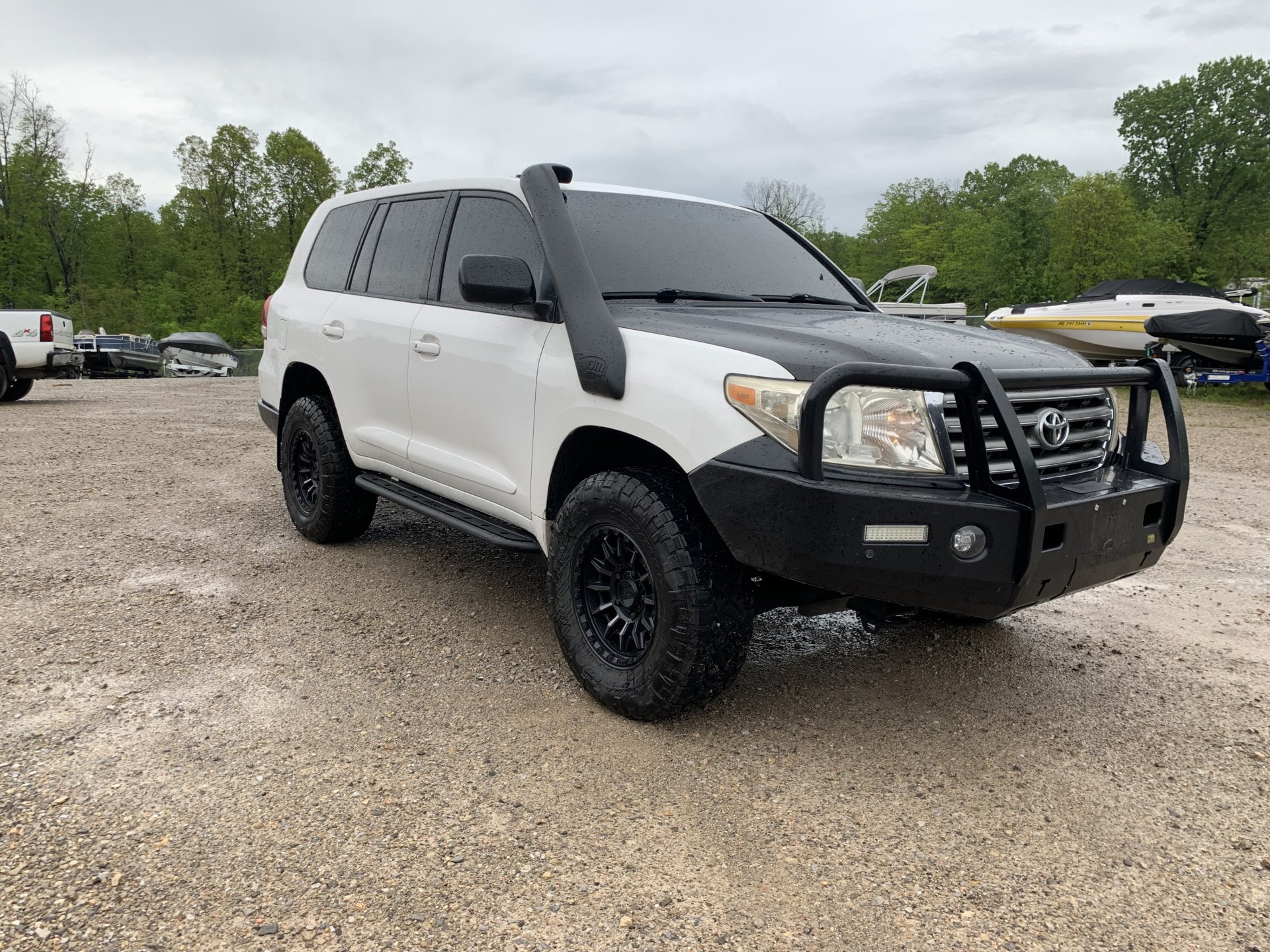

If it was white you wouldn’t even know it was there.
It’s honestly perfect for this build.
If it was a wheeler that might be a different story.
They’re are extremely hard to find!

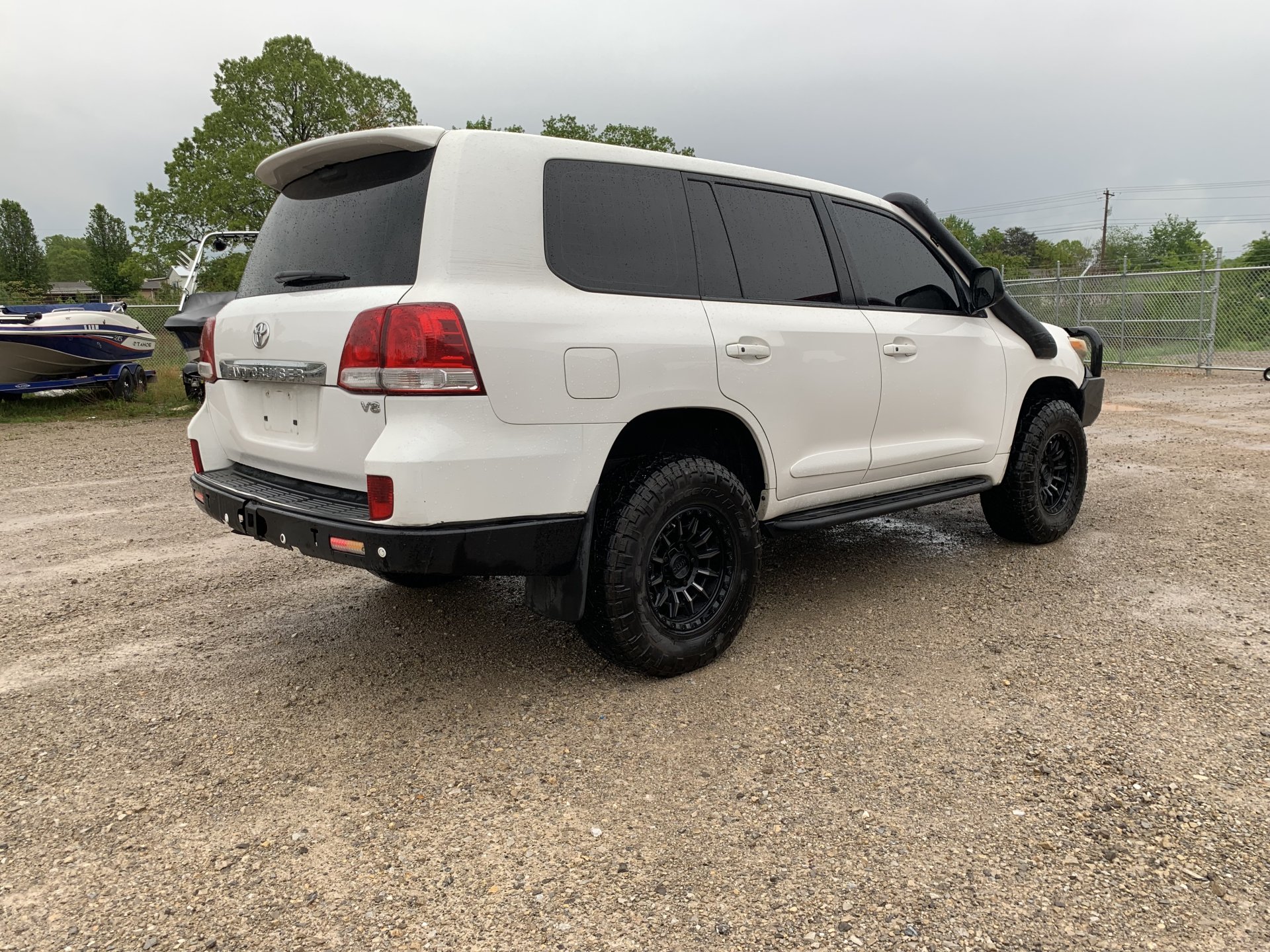

The 200 retired from full time mom duty a couple weeks ago when we picked up a 2008 Limited Sequioa 5.7 4x4
Bolted the pro wheels and 295 Duratrac RT off my tundra on it and had the windows tinted.
The 200 is still our favorite Toyota.

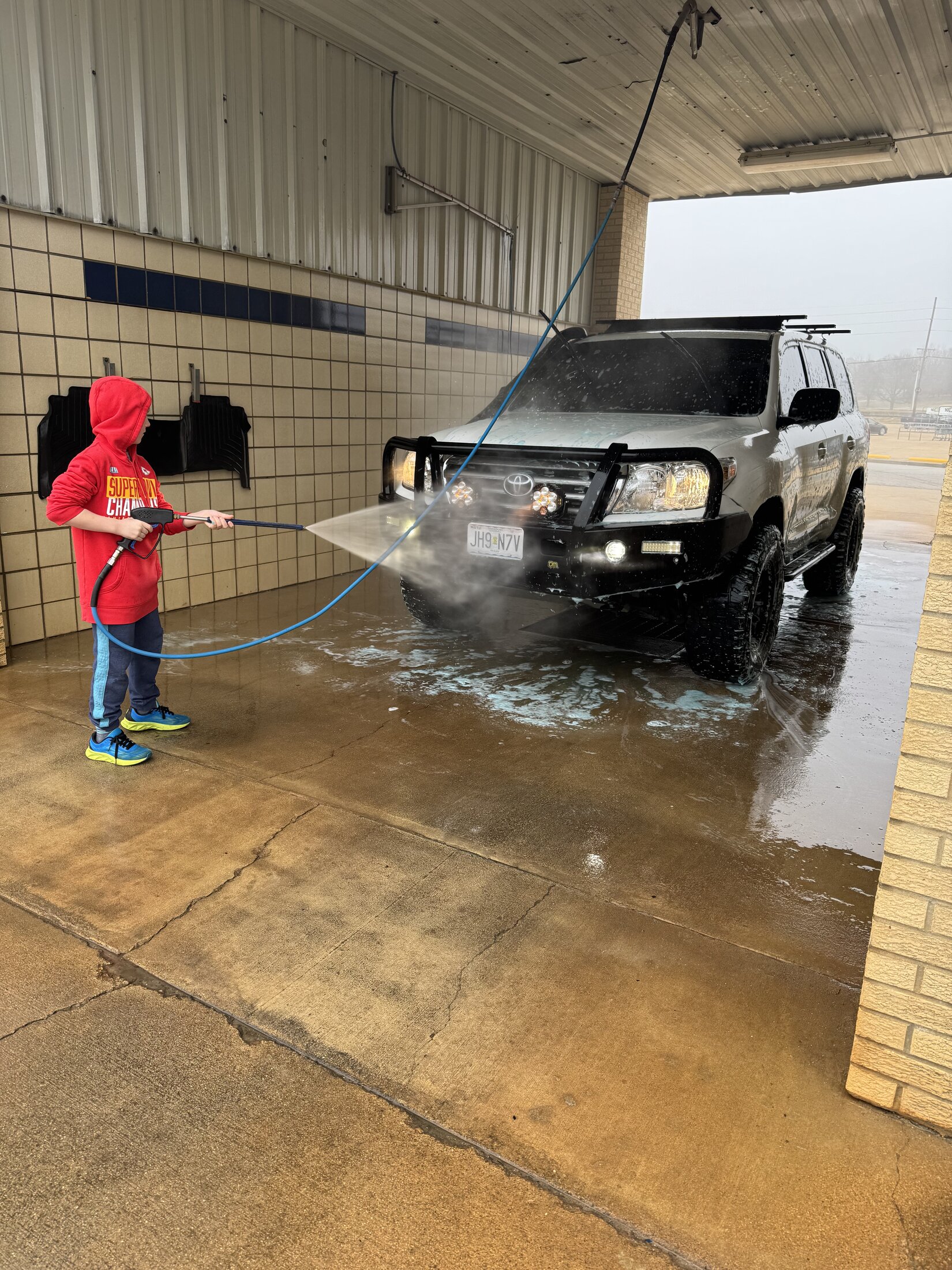

Our newest addition is due this week so I detailed, fueled up, and threw some spray ceramic on the white whale. Loaded up the hospital bags and the car seats. It’s patiently waiting and ready.
