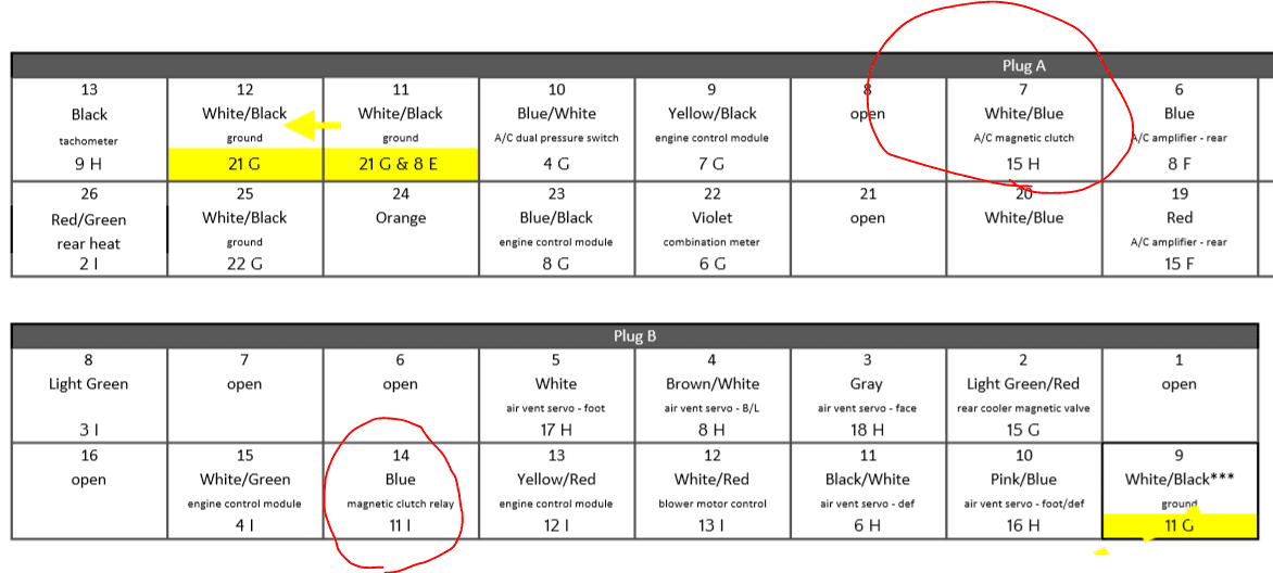

Ok. I'm about at the end of my rope here. Still no A/C.
I picked up a power probe which has been super helpful, here's what I've done so far.
-Checked/replaced all fuses
-Ebay HVAC ontrols are clean
-All wires have good continuity across my connections
-All grounds check good
-All wires are matched to same color wires and were done one at a time
-C12 (yellow/green) is listed as a ground, but mine wasn't. I grounded it. No change.
-Swapped my D12 and D13 to ensure I hadn't mixed them up. They were right.
Controls
-Hazards/CDL check good
-Bottom row of buttons checks good but are sluggish compared to the old Nav ones
-Temp dial works, defog works
-Ambient air temp shows blank. Redid the connection, it checks good. No change.
-All others in the middle HVAC specific area are inop. Some kick on and light up like when defog is pressed, but all are unresponsive to press.
At this point it's looking similar to @erwall's situation starting back at #317.
So next moves will be:
-Check continuity between spliced connectors and where they are in the PCB inside the controls?
-Buy another set of controls with a return policy for sanity check?
...am I missing anything obvious? I've been splitting this up among other work so I can maintain the slightest bit of patience. This is absolutely killing me.

Check continuity from mag clutch signal wire(s) (at the new soldered in plug) to the relay? Test the relay with that power probe and work back to the signal.
Was having the same issue. I started another thread. Start the truck, turn AC On. Trigger the cluch on AC, if that's all that's missing then do the above. I was missing 1 of the 2, yeah, TWO Mag Clutch signal wires.
Awesome, thanks. I'll give that a shot. I just read thru your thread, I'll give it a shot Thurs. Only question I have is when you say there are 2 Mag Clutch signal wires, are you refering the two I circled? Or are you saying there's a total of 3, and that two need to go into A7?

Aight, after a short hiatus to get my sanity back, made some progress with trouble shooting this morning.
Bypassed my AC mag clutch/sensor connections and it seems that they may have been the culprits. Got about half of previously dead buttons to function. My last remaining possibly incorrect connection is the C12 Y/G "Ground" that I swapped to an actual ground because it clearly isn't ground. The pinout is clearly mislabeled. I may dig into the diagrams to figure out what it is. Or maybe not. Who knows at this point. lol But it ain't ground in my rig.
After reading more and messing with the buttons today I'm going to take the controls back apart and clean them. When yall originally said to clean it, I took it apart and it looked brand new, so I reassembled. After some more youtubing it became obvious to me that "cleaning" these HVAC controls involves "cleaning" the button contacts with a solution like Deoxit. I've got some of that arriving today, hopefully that works for me.
