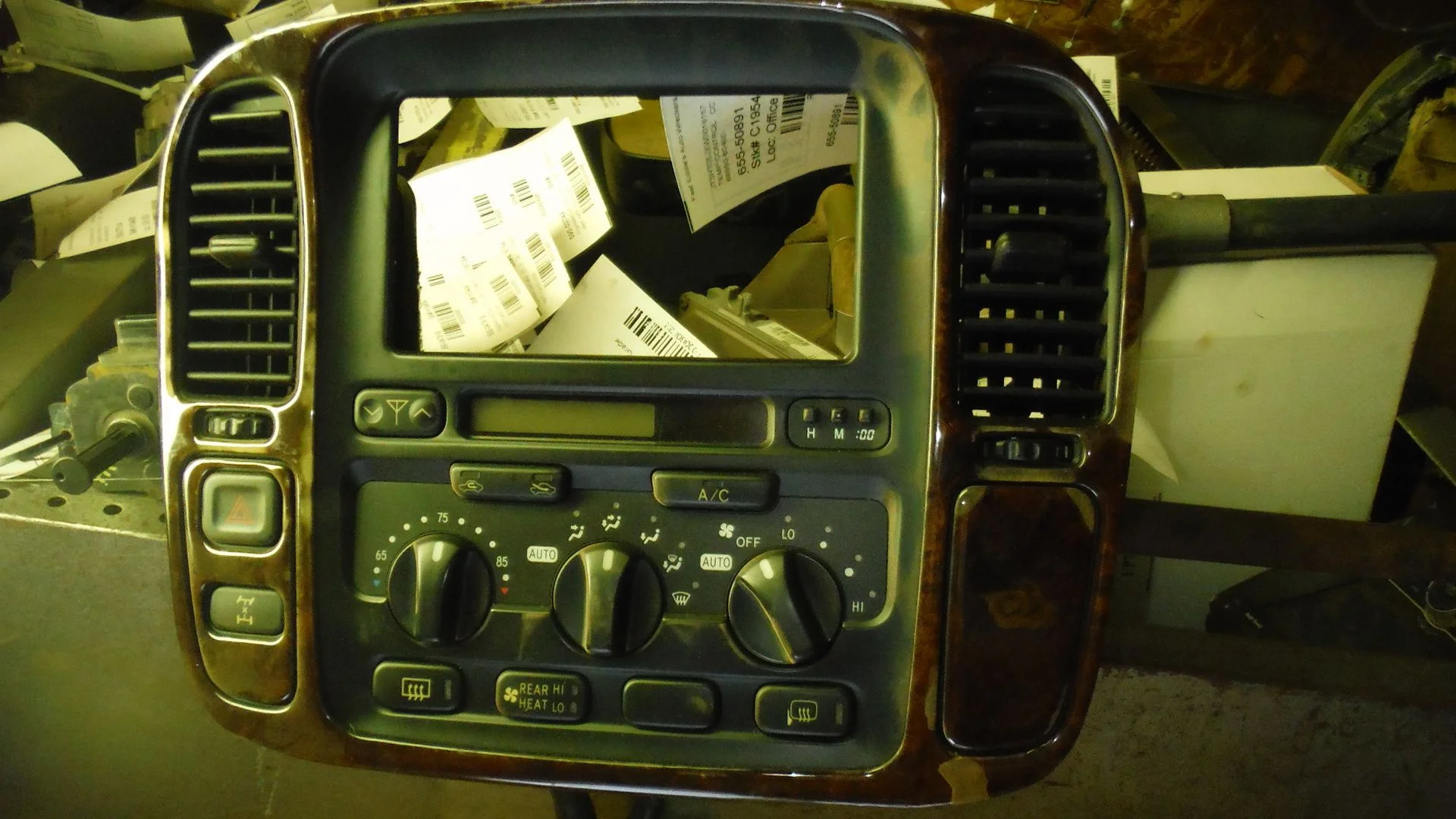

So I investigated this last night. On the Non-Nav system, the clock is separated from the "row of buttons" by the 3 knobs.
On the Nav version, the clock is just above the "row of buttons". I pulled apart the Nav version and it has the row of buttons and clock all on one board. The non Nav version has the switches and clock separated, so 2 different boards. So unfortunately the clocks are not swapable. I was hoping it was because I found a Non Nav bezel with a cracked clock and was hoping to fix it. But that isn't going to work, so the search continues.
My bad. I only looked at the Non NAV bezel. Didn't think to look at NAV bezel. I "assumed" they were the same. Could some soldering or desoldering do the trick?
