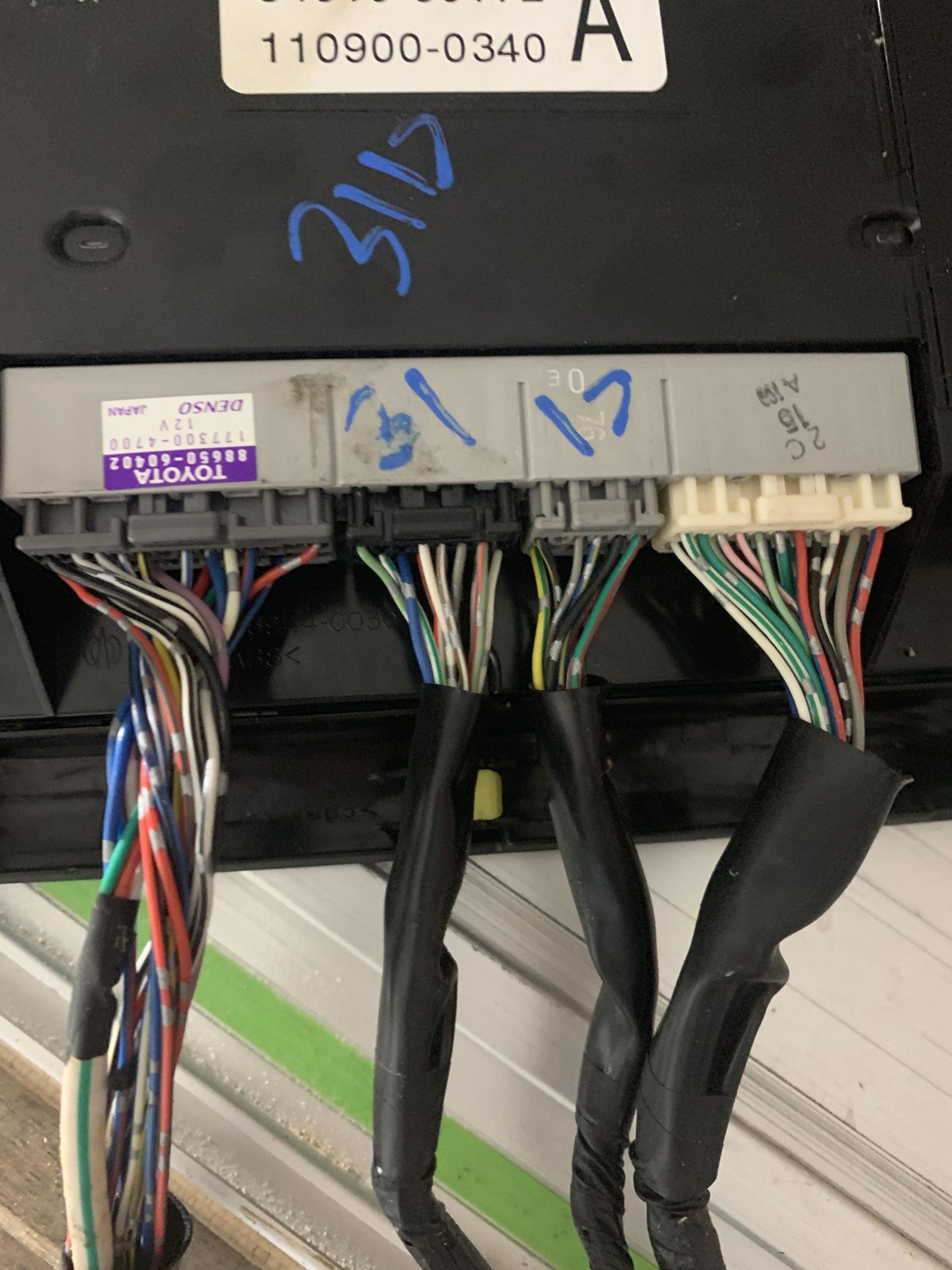

I found and bought this Lexus AC digital controller for under $300 on eBay. Others were $500 and $600, so I think I got a pretty good deal. I browsed the parting-out section of this forum but could not find the same AC digital controller.
Next, I need to order a Metra 70-8113 harness, solder seal wire connectors, heat shrink tubing, a double din stereo head unit, and speakers.

Worked from 11-6 today at a snails pace and got it done, everything is working but the compressor isn't kicking on. Calling it for now, I breezed through but didn't see this issue, maybe I missed it.
Looking at the Map is it B-15/I-11 "Magnetic Clutch Relay" ?

B14/I11 connection looks ok, AC light flashes, looks like i need to check my relay and AC charge.
