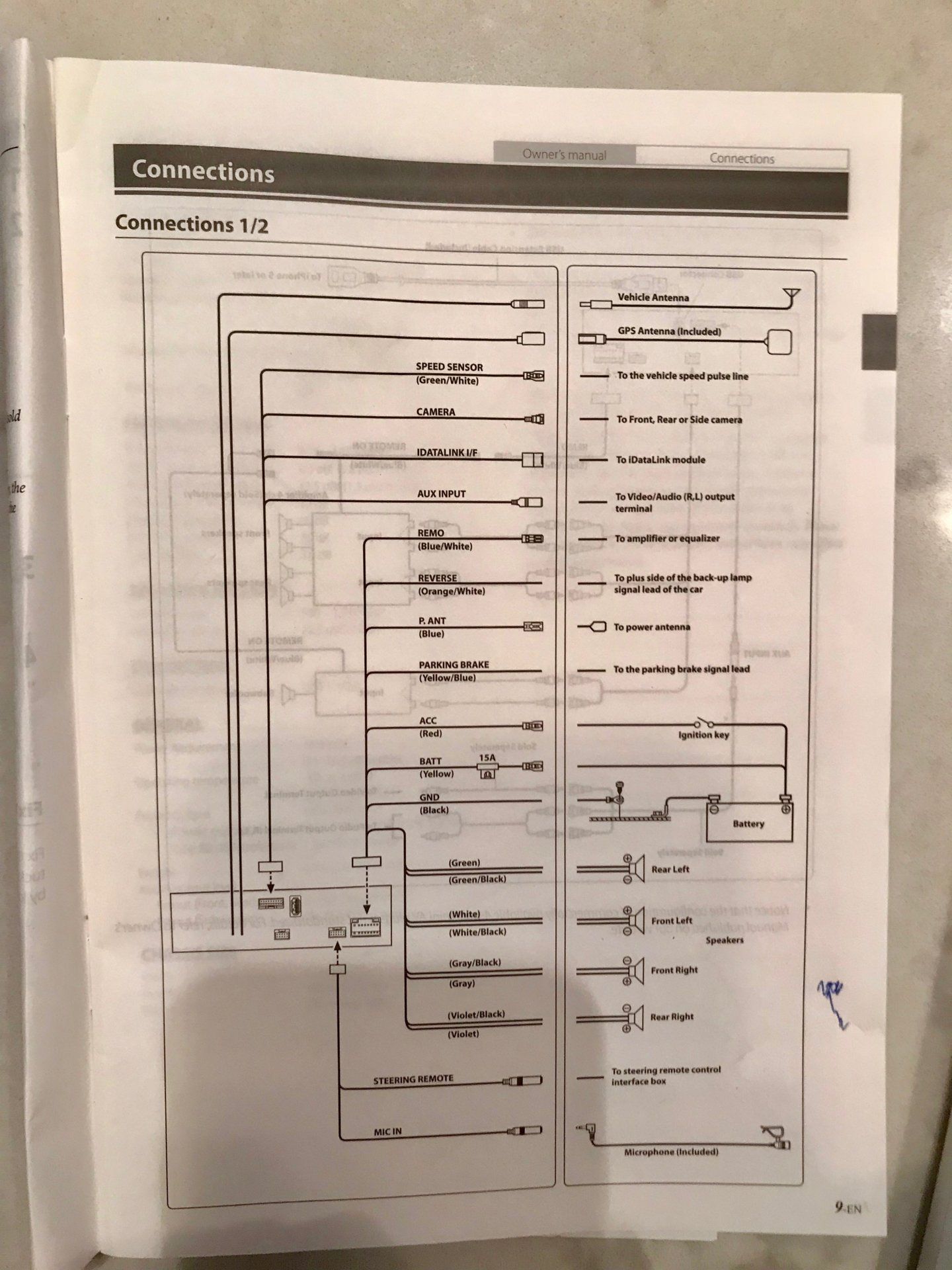

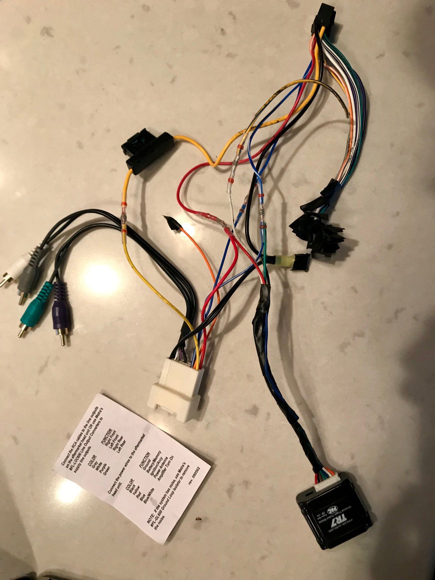

I just installed an Alpine ILX-107 with Apple Carplay using the Metra 70-8113 harness adapter that is recommened (rca outs for speakers). It powers up as it should, everything seems to be working but there is zero sound, not even the whining/hissing noise that some complain about with an aftermarket radio which makes me think the factory amp isn't powering on.
I have blue/white amplifier turn on connected as well as the amp ground to the main ground ( I even wired it directly to the frame initially no change). I also have a parking brake bypass installed which is working as it should.
