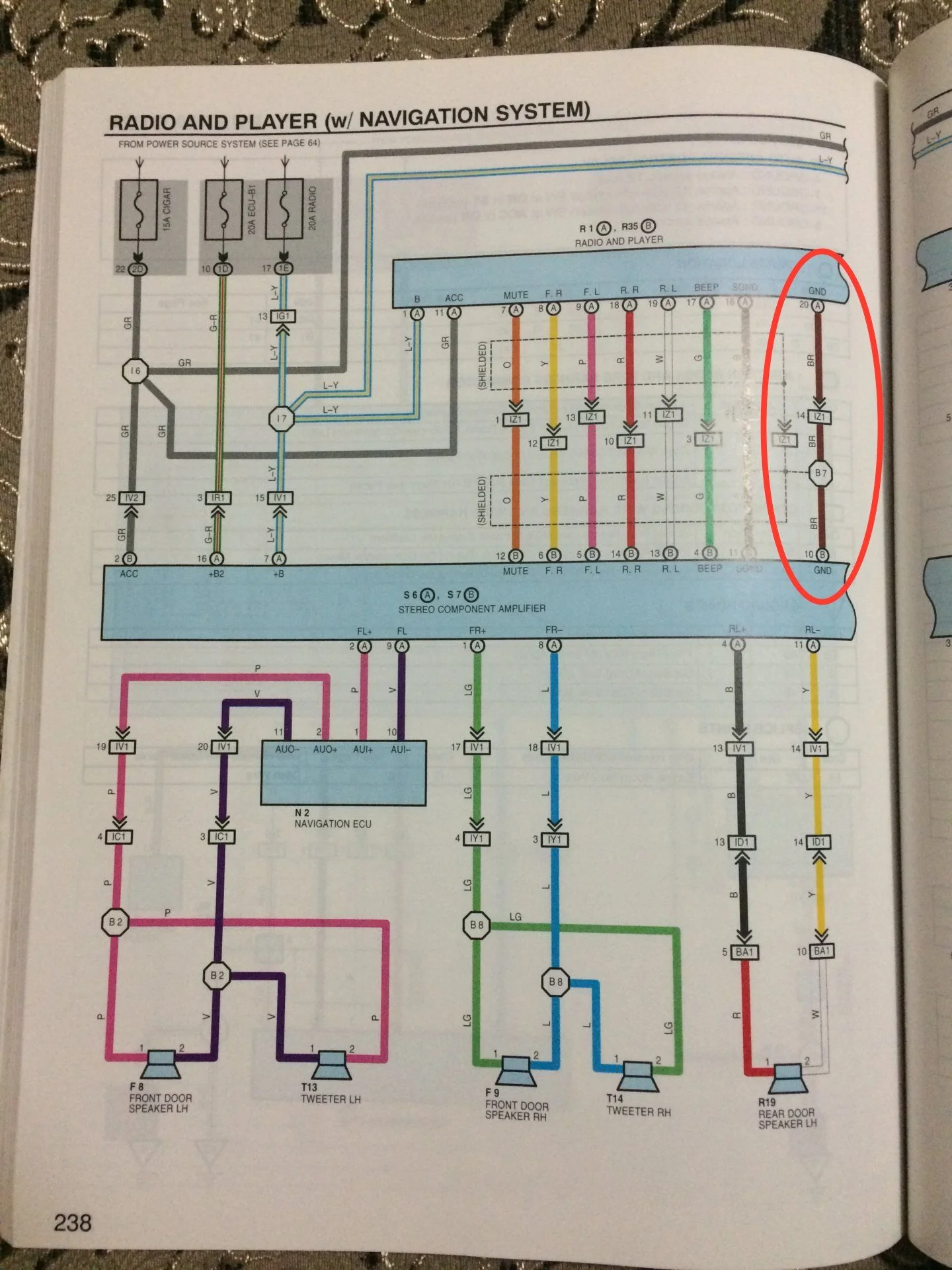

Amp replacement went great. My aftermarket radio worked with the factory amp, but I had issues with it after I did the replacement. The issue was my radio ground. Important thing to remember here is that the radio's ground is through the amp wiring harness. So in addition to the speakers you'll need to ground the radio via a wire in the harness under the passenger seat. Once I figured that out everything worked great.
I mention this in the video description. Also, the diagram for ALL of this has already been posted.

Is this the ground from the radio

Is this the radio ground (red oval) you needed to land when you replaced the factory amp?

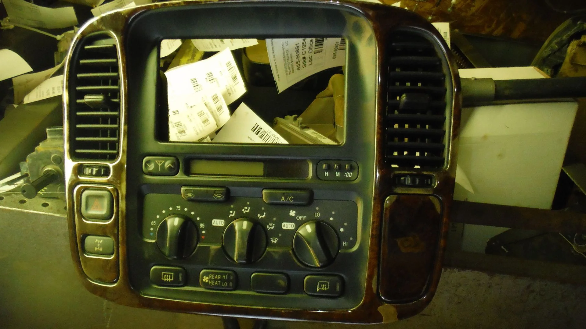

Shoboat - Here's a question for you and for anyone else - I'm looking at your bezel and noticed that your rear heat button is hi/low. Does this match your stock bezel "rear" button? I thought I had read earlier that these buttons not matching lead to some trouble. I'm asking for you in case this is true, but also because I have seen a few bezels like yours pictured (wood trim, three knob, and rear hi/low) that I have not considered for my nav delete because my rear button is not Hi/Lo - it is just "rear". Can anyone confirm that these buttons need to match, or confirm that it doesn't matter?

@chogunn I sourced a different bezel that matched my existing buttons (no hi/lo) because I didn't want to run into any problems that appears as though others have had....

Yes that is how I remember it. You will also need to ground your new head unit because the old unit got its ground from the amp. It is real easy

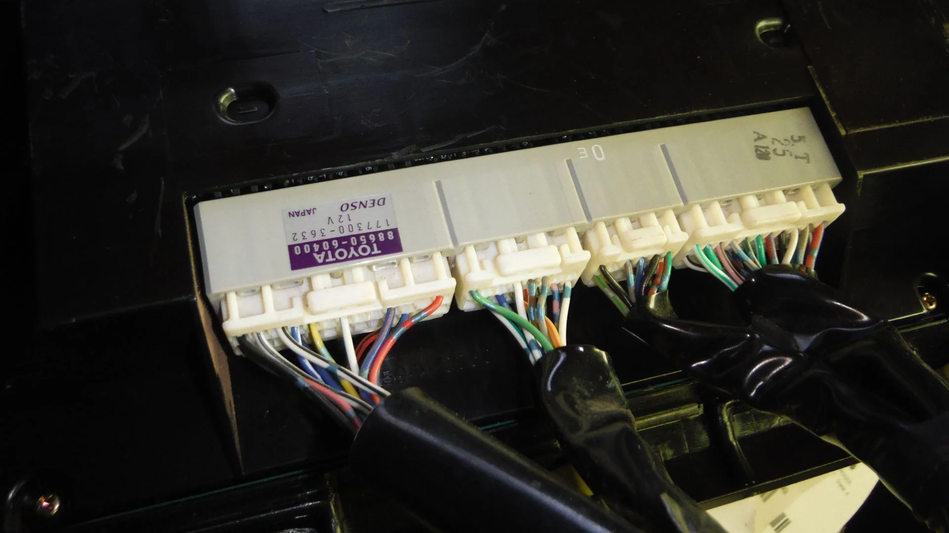

Recently did this nav delete using an LX controller. It works, kind of. All the bottom buttons seem to work, as do the hazards and center diff lock. I can change the temp and it adjusts temp and foot/vents/defrost appropriately but will not change fan speed. I can't get the auto button to turn on or do anything. Also can't change the fan speed or adjust the mix using the mode button. I've checked all fuses and grounds. Any idea which wire does the manual mode change? Also, I'm guessing the fan speed is the ante up and ante down connections? Any help very appreciated, having some anxiety about all the cutting, etc and it not working as it should.
ANT up and DOWN is probably for the power antenna. Do you know for sure that controller works? According to the info on here it should be plug and play.
Ah, I'm sure you're right. No, I don't know for sure that it works, bought it from a yard. Just wondering if I should be looking at any specific wires/connections for issues?
