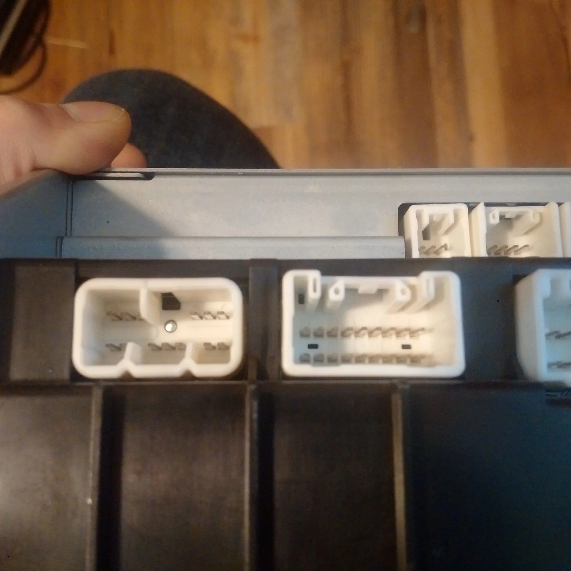

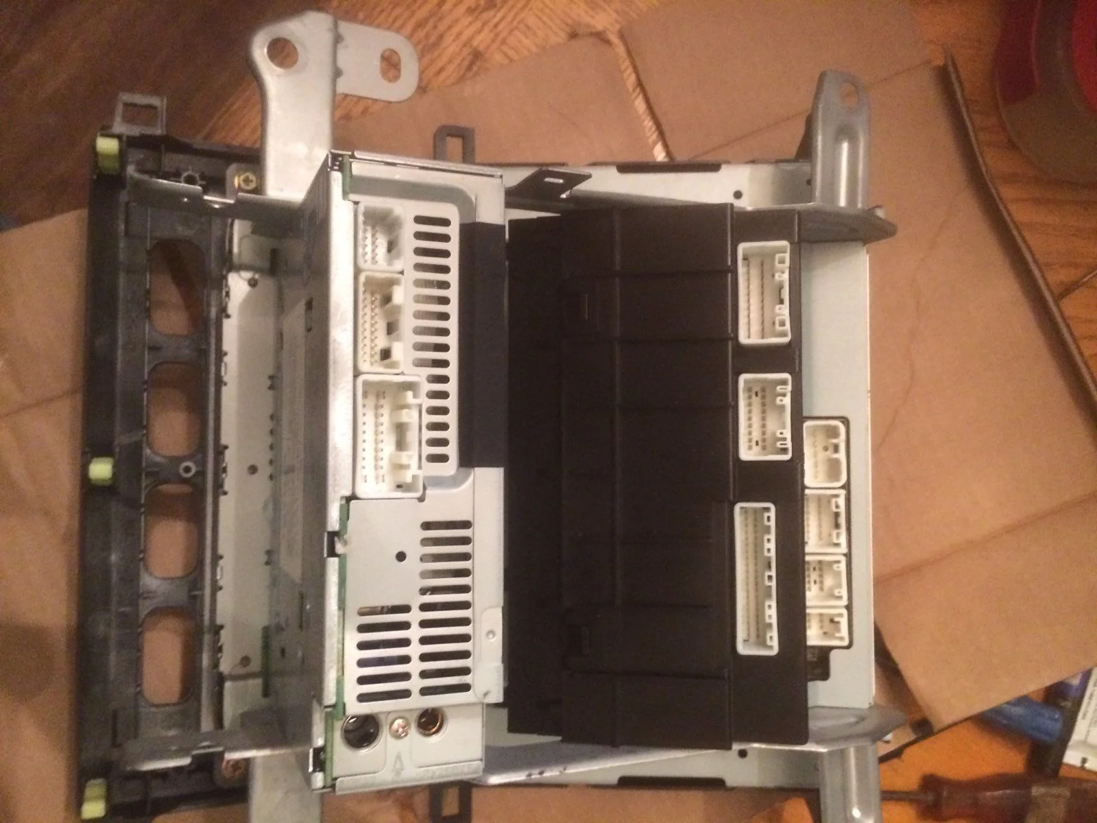

I don't know how, but I have a 2003 with nav that has these connectors on the back of the screen, but the regular 2003+ AC amp and stereo.
this is weird.
I'm searching for pins outs of those four screen connectors to match up with post 2003 screen. (m5)

He has the new dash. But the rear looks like this
I found some of the pinouts in question. Should we post on the post 2003 thread so we dont confuse the two?
they're reversed, aren't they. Well.... idk. can you post the pdf to 2002 nav, those 4 connectors?
I asked because this is the pre 2003 conversation and I thought maybe someone could post the 2002 PDF of the screen connectors. Or would you prefer I ask a 2004 owner?
Just so you know, the 2003 screen connectors are the same as the 2002.
