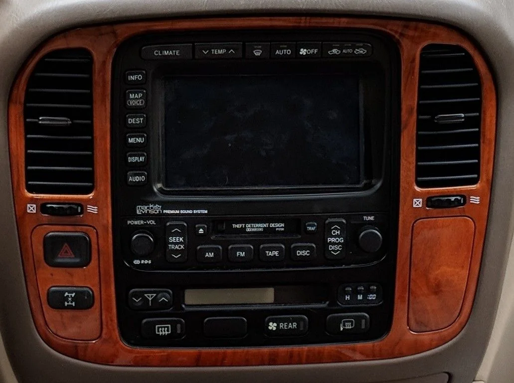

The LX did not come with the 3 knob controller when not equipped with navigation. It came with a digital display. The OP on this thread has not been online in awhile and has not updated his photos. Here is some I grabbed off the net. The following photo is from an 02. Notice the cassette and radio? This is what was removed.
The non-nav LX was equipped like this. You can see the LX had a digital display that is different than the navigation digital display.
If you purchase an LX you can find the digital controller like the OP used or a 3 knob from the LC. The difference is the digital LX controller/bezel will require a trim kit like the OP used. So to do a navigation delete you will need to either purchase one of the controllers from Ebay or a scrap yard.
