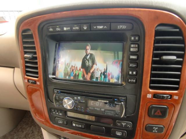

subbed for same question...found this pic on the net and got excited; this thread has already helped me a bunch. hopefully we can find a solution!

Interesting photo solved the audio problem but not the antiquated Nav and crappy climate control.
I know, right?! at least I would be able to play cd's and have an aux jack with this...some a****** has my cd disk drive that used to be under the armrest and i don't want to pay the $,$$$ for a new stock one
