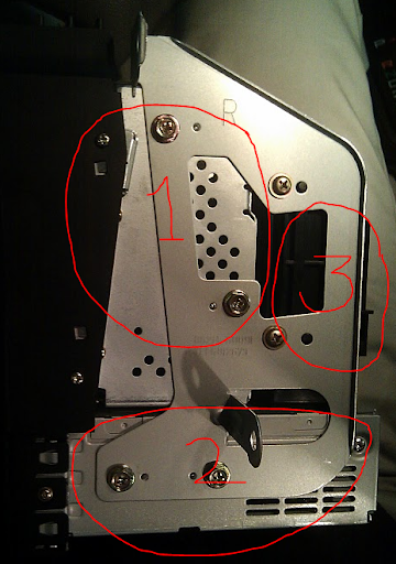

Once I got the unit out, I noticed that it was split into 3 components:
1-MFP (Multi-Function Panel)
2-Physical audio controls
3-A black plastic box behind the MFP
It also looks like the rows of connections might correspond to grouped functionality.
EDIT 2/17/11 - Looks like the black box on the back of the MFD is part of climate control - (88650B AMPLIFIER ASSY, AIRCONDITIONER 88650-60590 2000.08-2002.08 UZJ100)
A-MFP (Multi-Function Panel)?
B-A/C Amplifier Assembly --- (verified)
C-To Amp (left) and CD/DVD Changer (right) ---(verified)
NOTE: NOT SURE ABOUT THE BACK BUT IT DOES APPEAR TO FOLLOW A GROUPING PATTERN OF SOME SORT.

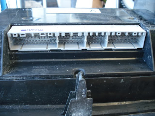

There is a 98-02 dash trim panel with climate control knobs on E-bay right now. Here are the pics I scraped. Now all I have to do is figure out if there is a chance that the wiring will work:

I am also thinking that it will be easier with the Lexus controls as they are a little newer. From looking at the connectors from the (older) unit on eBay, I can't make a good educated guess on how it would plug in to my harness.

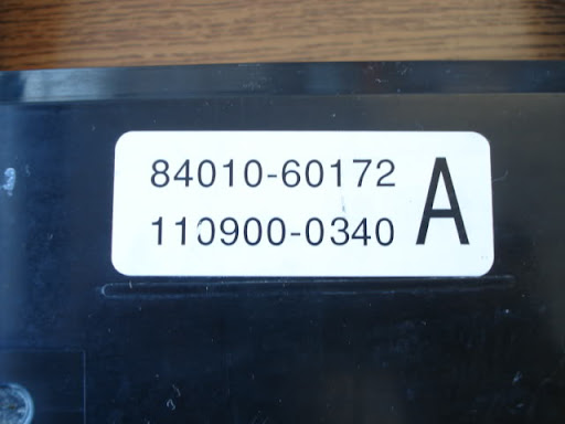

Looking forward to it! After we get a good look at the connections and detailed pics of the pinouts, I will have to find a wiring diagram for this model of control panel. Can you also get detailed pics of the part number information?

Here is a better picture of the pinouts from a 98-00 climate control panel. I also got some part number information for this piece:
Part #’s:
Off Climate Control # 88650-60400 & Denso#177300-3632
Off Back of Climate Control#84010-60170 & 110900-0072 A
OEM#84013-60010 (Panel, Upper Finish)
