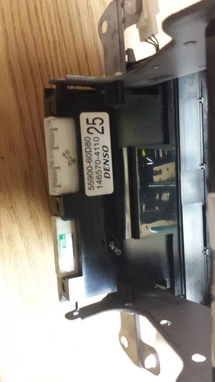

I'm changing the stereo in my 06 again.
Figured you fellas might want the part number for the climate control.
