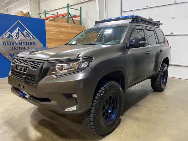

Just realized this thread doesn't have any pics of the install...
More over here:
More over here:
That looks amazing!
More over here:
Does the rear glass still pop (open) up?
