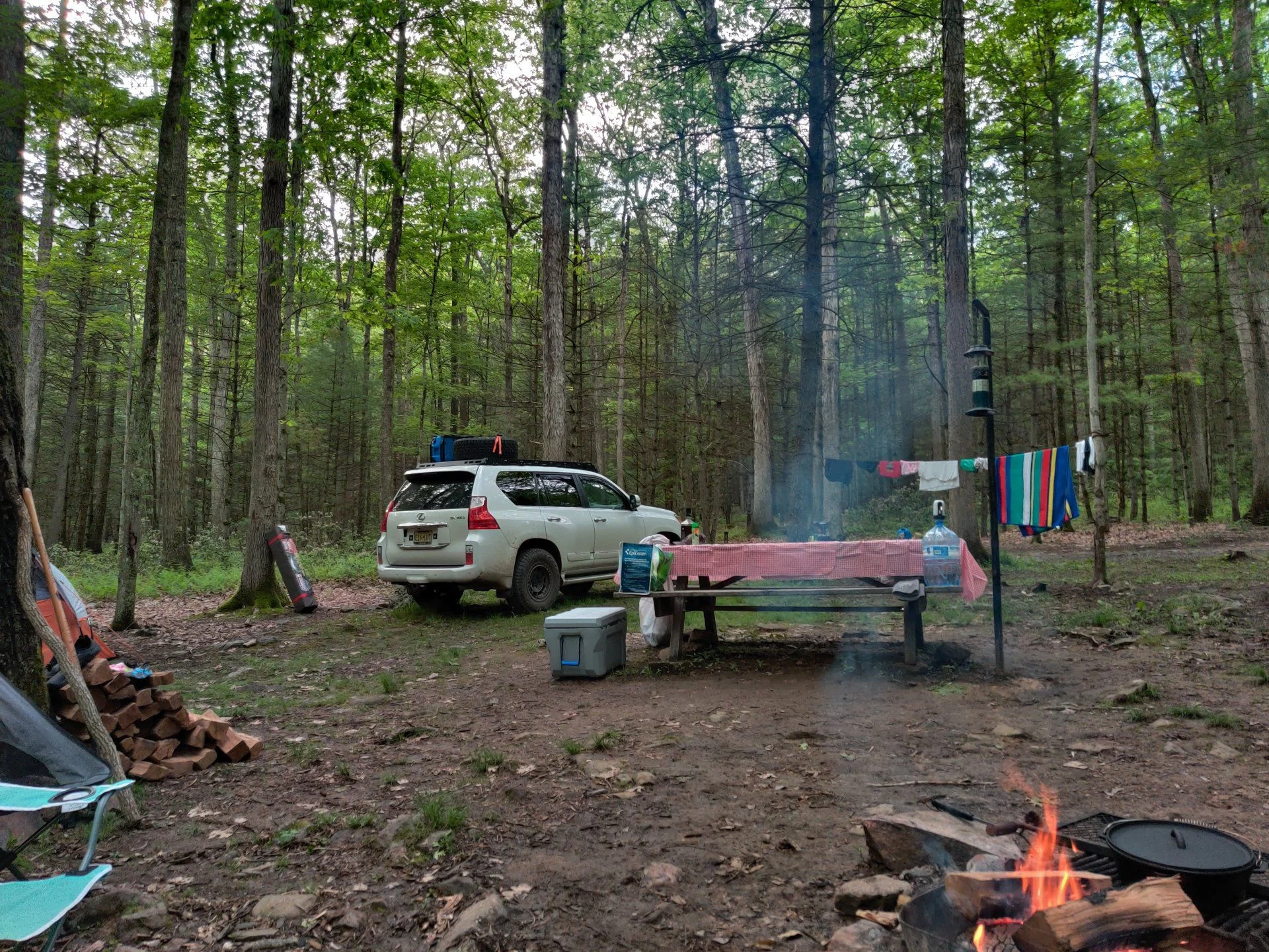

Been running the spare on the roof for a while. Other than getting turned away from parking garages, no issues.
I too was worried about the CG, but it turns out the GX is such a boat that shifting the weight up top doesn't have much effect.
