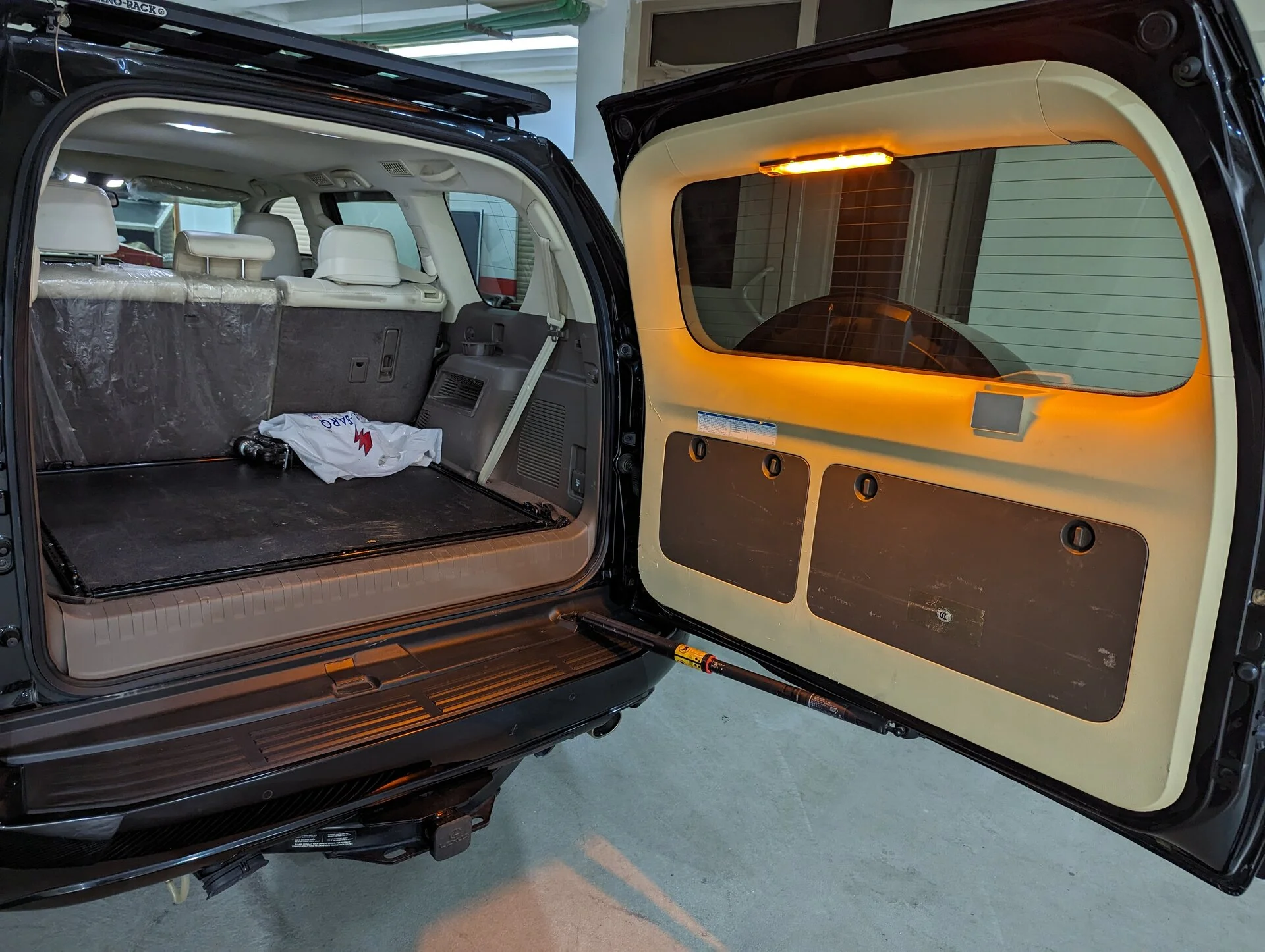

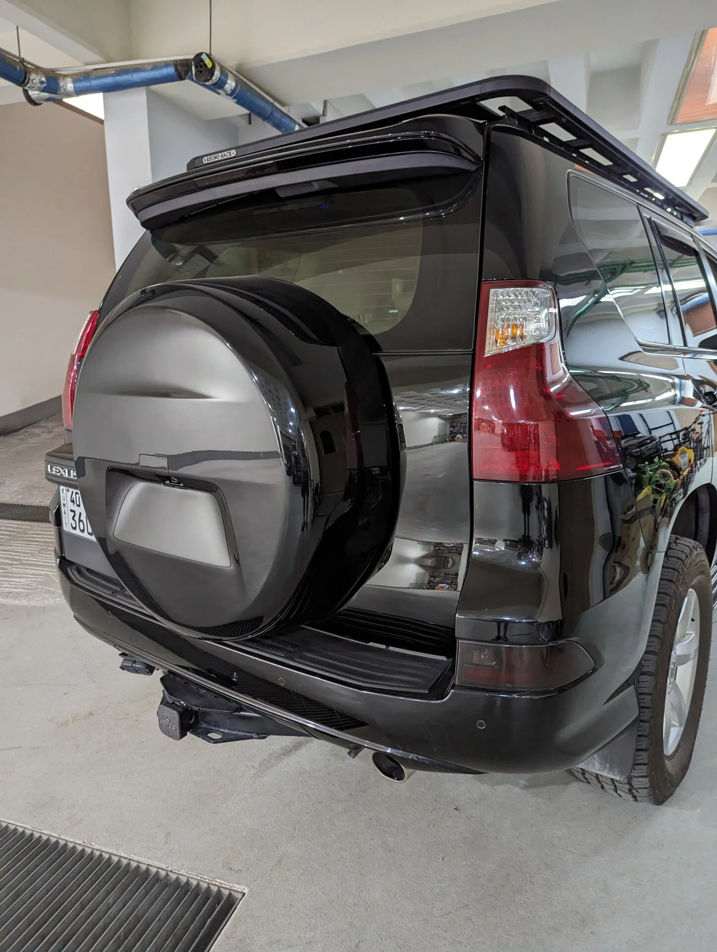

Im new in here , and im from kuwait , i did change my gx460 door to prado.
And it was easy conversation ,after i painted the door , it took less than 6 hours to swap the door.
I bought the door complete from junkyard with glass tire carrier spare tire cover , R camera. It cost me around $1000.
I own bodyshop , so i only paid for painting material.
Its direct fit no modification needed , even the wires for lock , camera and brake light plugged directly.

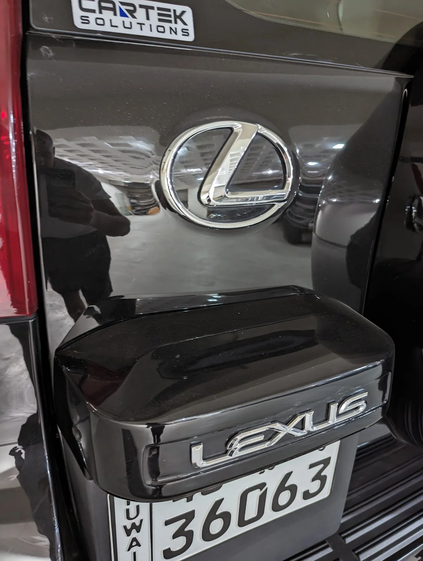

I used the lexus emblems from the original door.
The only difference is:
The Prado letter in the door handle ( i cut it with grinder and weld plastic sheet with my plastic welding machine thin i stick lexus letters emblem)
The Prado rear door glass is not openable.
I used hard in desert i don't have any issue my tire size is 33'. And i feel its the maximum tire size you can hang there without any issue.
Here is some photo

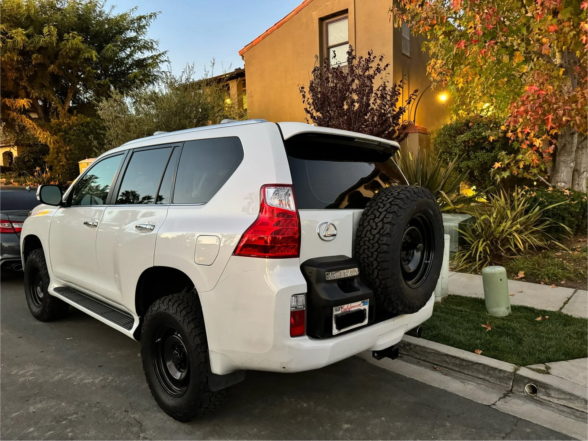

I’ve been up to some stuff. Bought the Chinese door. Still finishing it up.
What do you think of the quality of the door materials? The Toyota/Lexus steel is way thinner than what I‘m accustomed to with German or British vehicles so if it were to get thinner I’d be concerned.
Ok, how do you feel the qua
Door quality seems high. Its got the toyota pearl paint and it is so close to the GX pearl that I am not going to bother painting it - most of it is covered anyway.
The accessories have less quality.
The wheel mount and the wiper motor mount are particularly low quality. I am going to replace those. The window is fair quality - obviously not OEM. The outside plastic for the license plate and door handle is fair quality - but doesn't fit just right. Will probably also replace that with OEM. Lastly, the interior panels I haven't tested but I was warned that those don't fit right either.
All in all for less than 1k shipped its a pretty good deal. The bare door painted in pearl is probably worth that. The other parts can be swapped out with OEM parts fairly easy if anything bothers you.
Does take some time to lengthen some of the wire harnesses to reach the new mounting points. Will post a finished product soon.

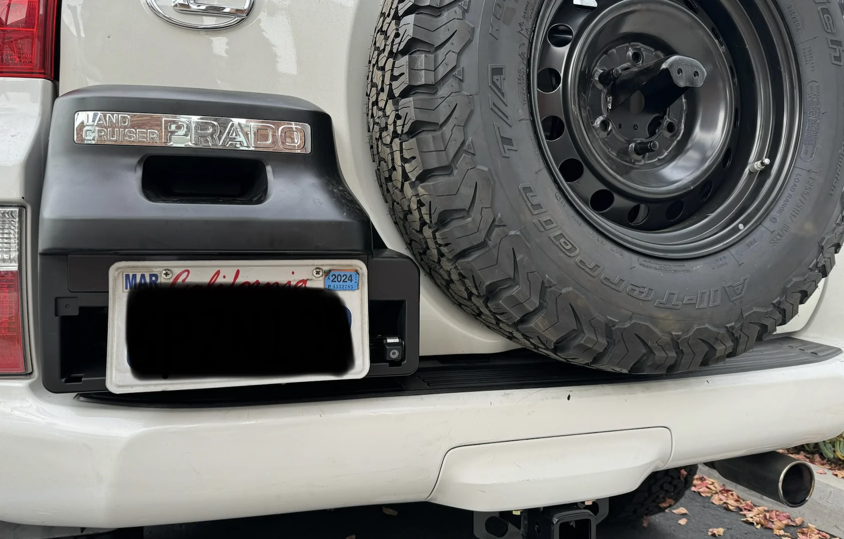

Working out great.
Did a 1000 miles in Baja and beat it up without much of an issue.
1. I had to add KAON shims to the lower hinge in order to better align the door with the weight of the spare tire.
Door Hinge Shims to suit Prado 120, 150 & FJ Cruiser - https://www.kaon.com.au/door-hinge-shims-spacer-to-suit-prado-120-150-fj-c

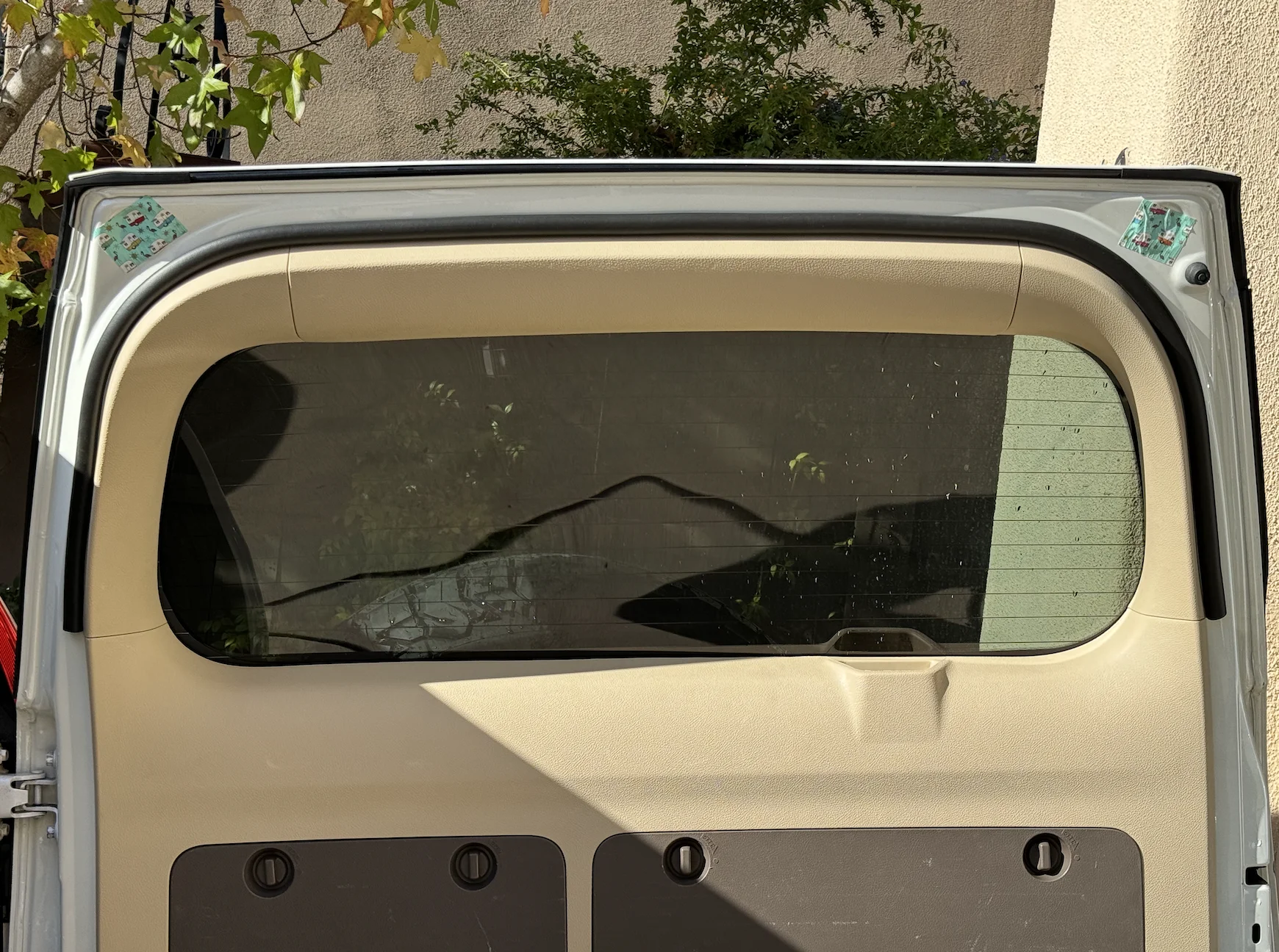

2. Used weatherstripping to seal the door better (see stripping on the top of the door here
3. Bought these circular hole plugs so I could remove the duct tape seen in the picture above
4. Added a child lock cover here on the door to cover another hole not seen in the USA door
5. Relocated the camera to the license plate bracket - works great here with some double sided tape
6. Baja
