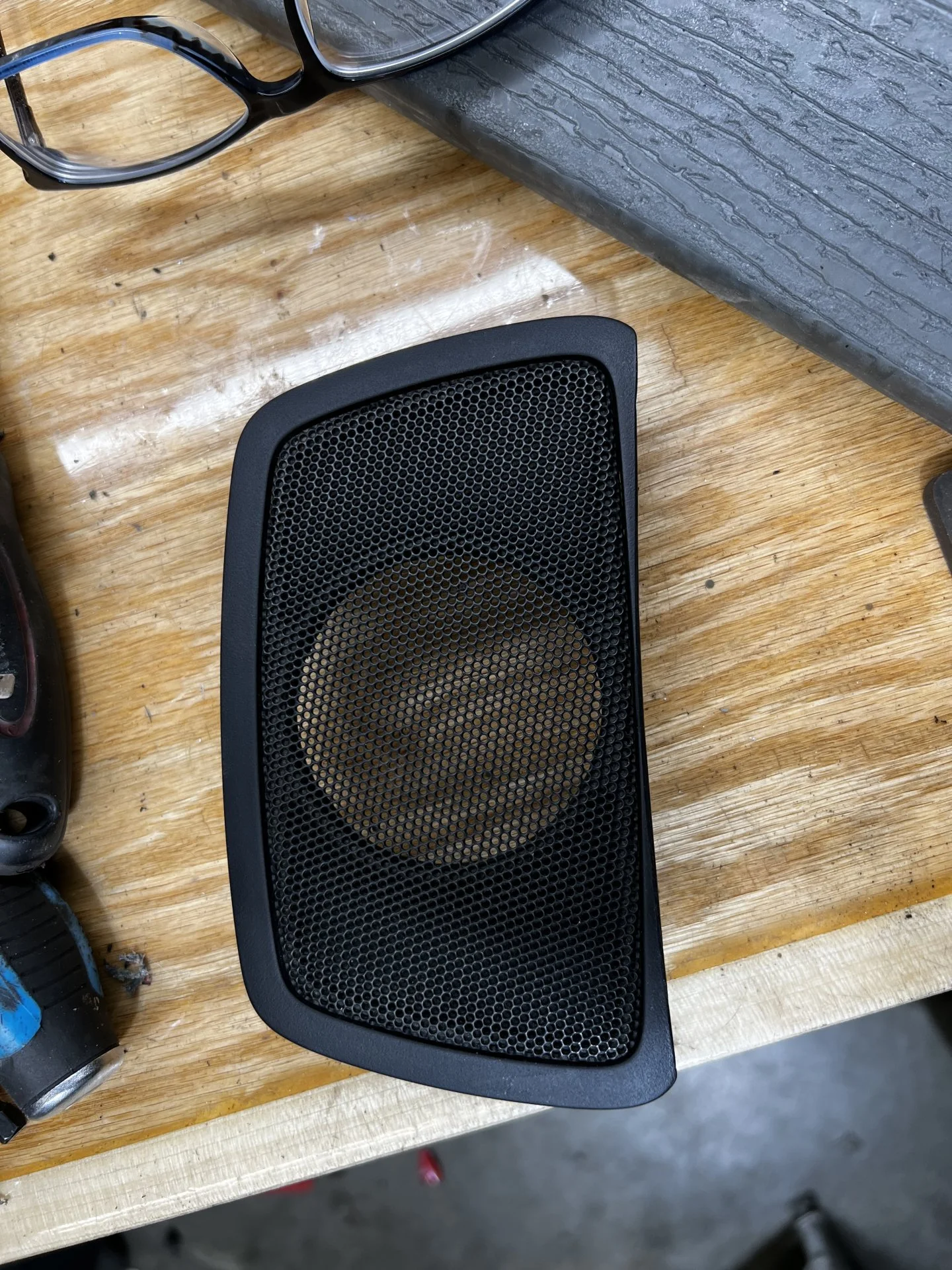

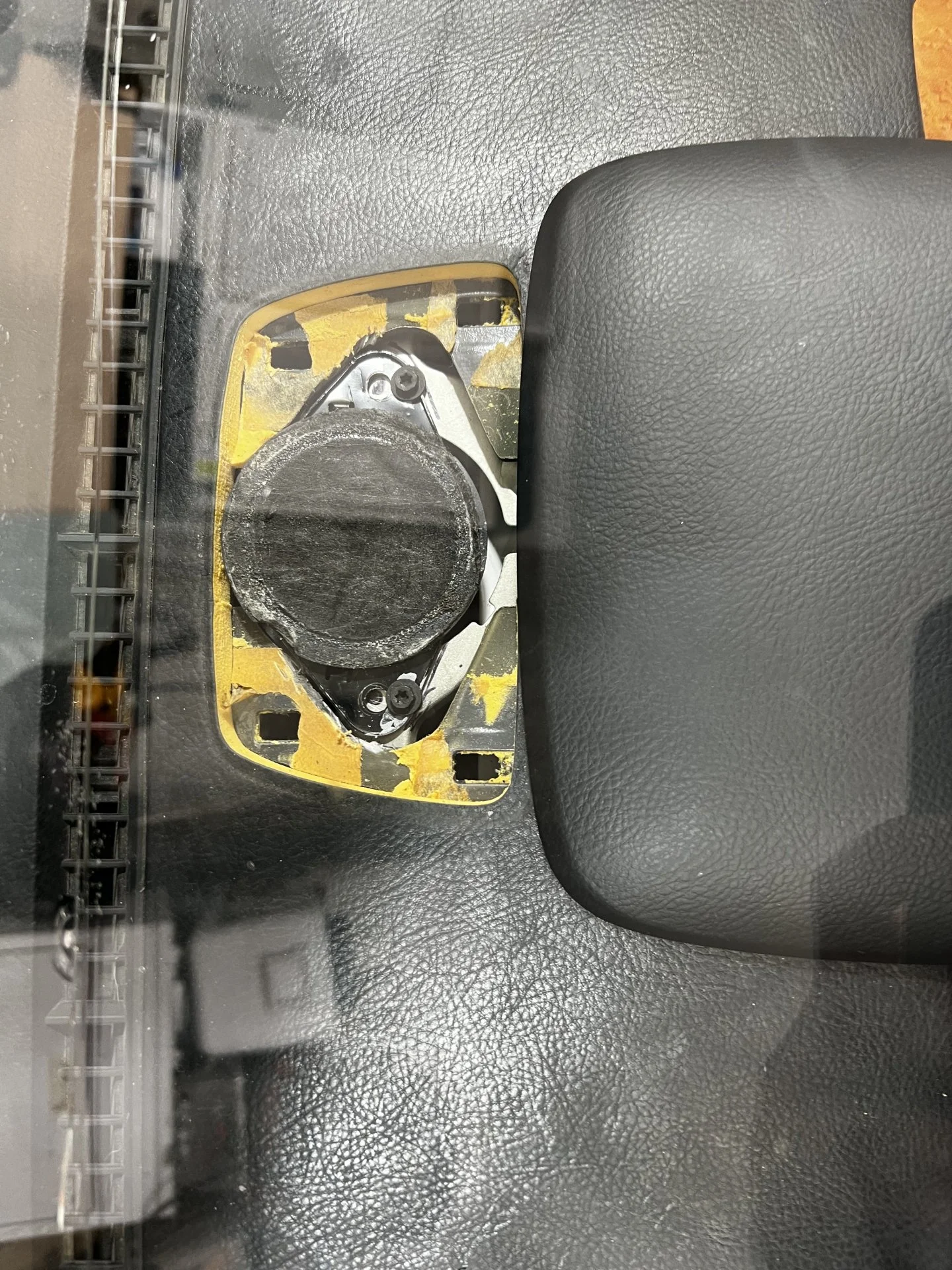

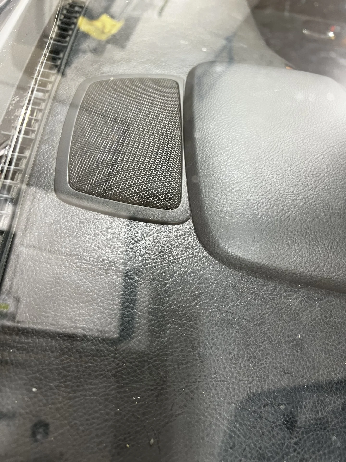

Center speaker mod. Technically you can still use the factory spk by drilling holes close to the edge. But, there is a problem. Due to magnetic field by speaker magnet, cluster compass would not work.

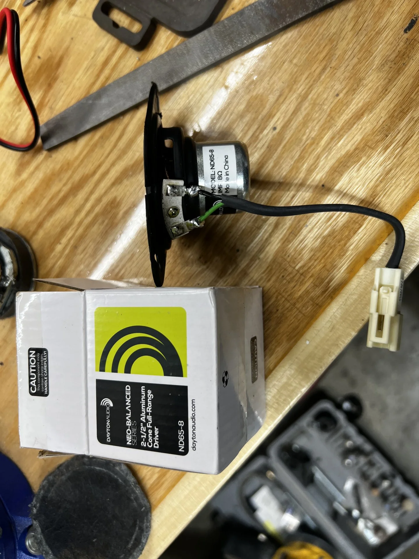

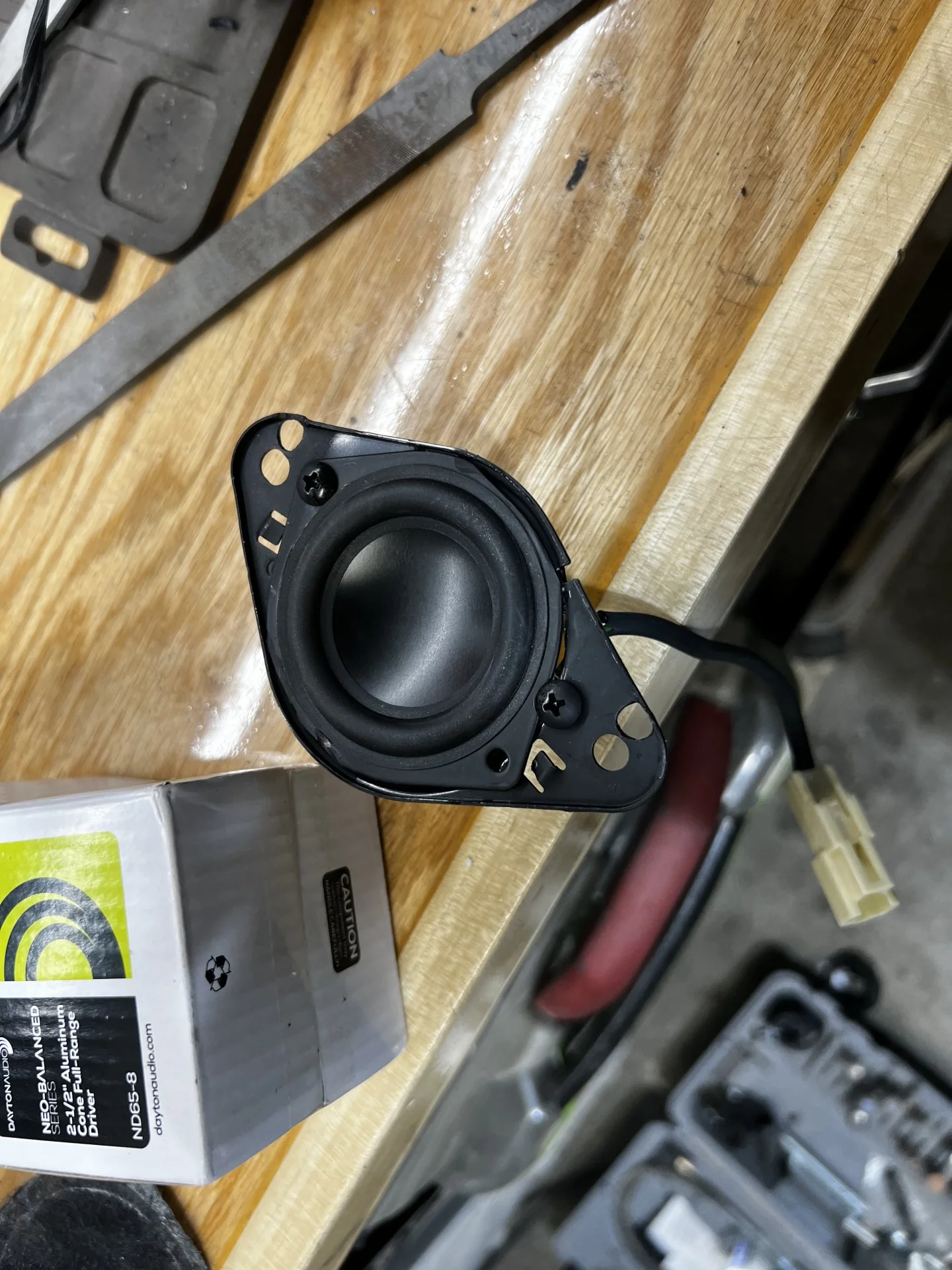

I ordered a 2.5” shielded 8ohm speaker from Amazon. Hope it’ll prevent magnetism.
The magnetic shielded 2.5” speaker setup works perfectly and does not interfere with cluster gauge compass. Surprisingly it’s an 8ohm speaker and fits into old speaker bracket. There was some careful cutting and soldering… not prettiest job but functional. I could have easily made the bracket out of ABS plastic but I decided metal is better for hot dash area.

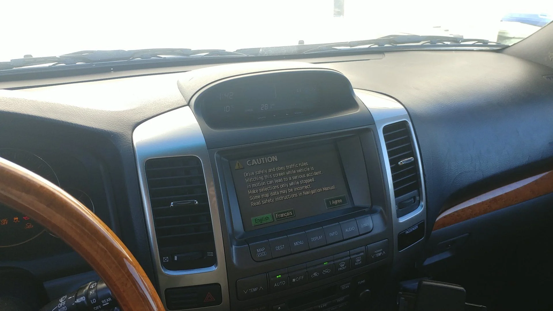

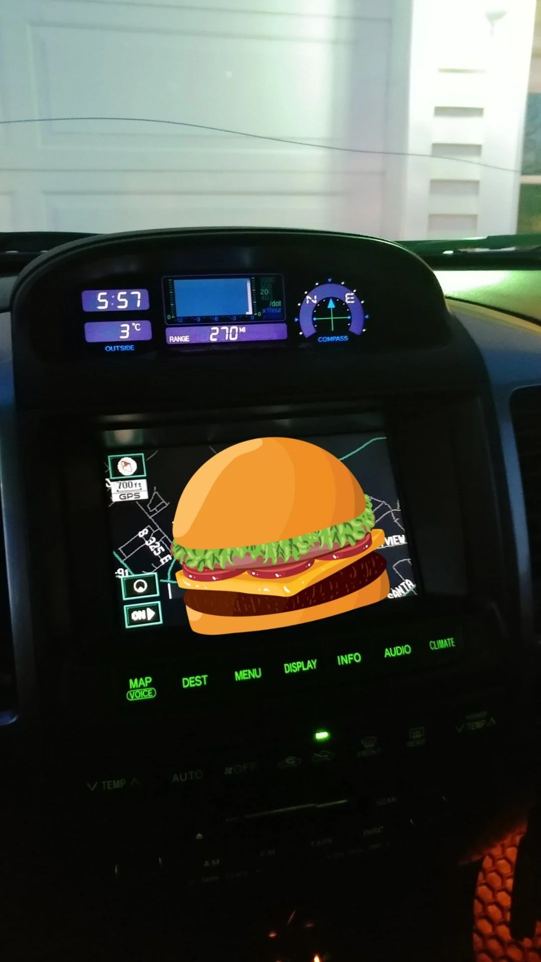

A better look at the display:
I may have mixed up the Tesla screen conversion and your work. Is that your OEM screen? Is so, what did you do to make it look more modern?
