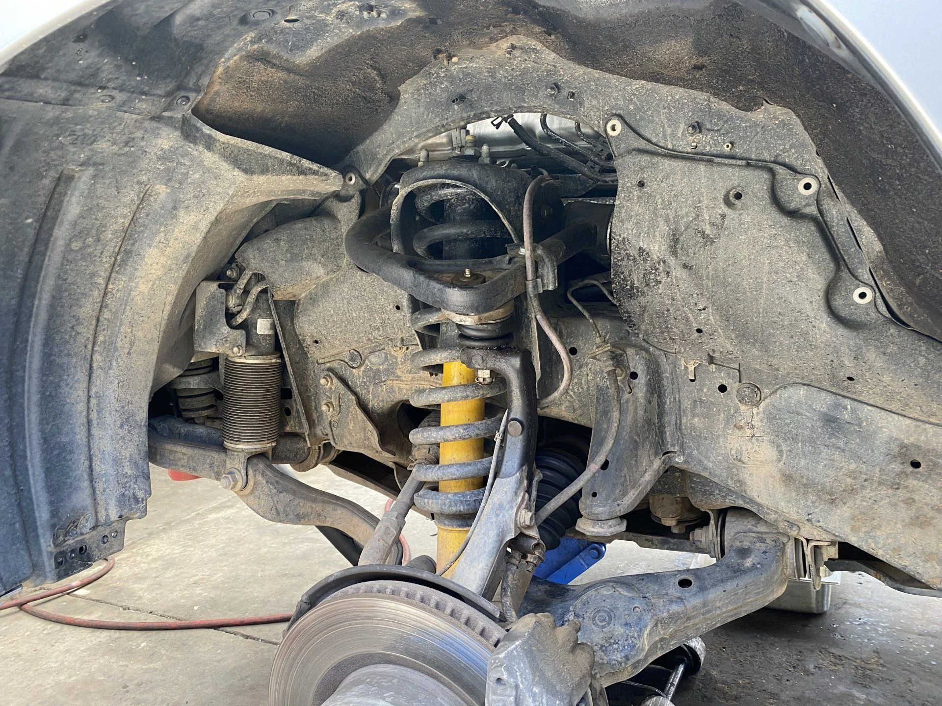

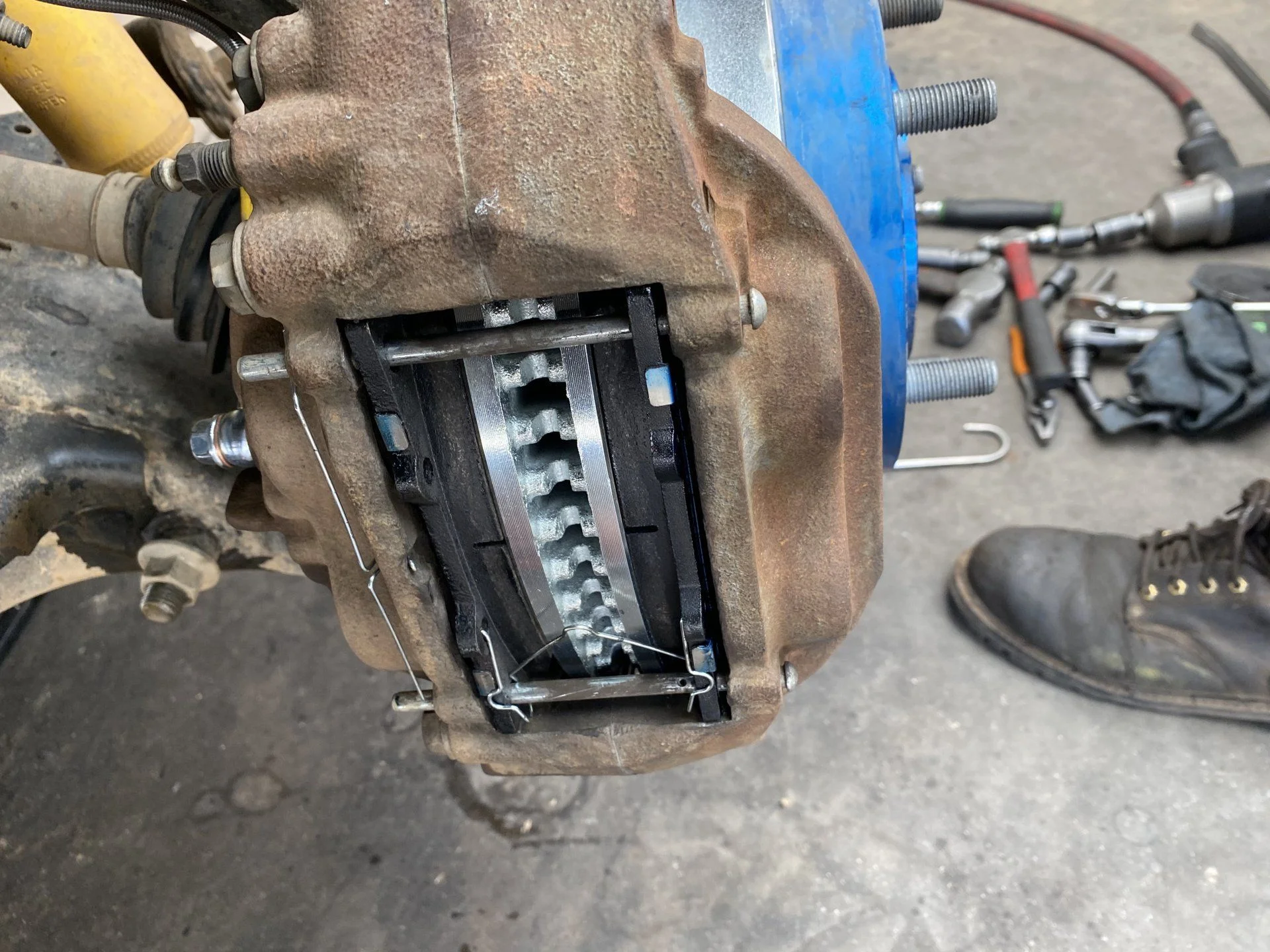

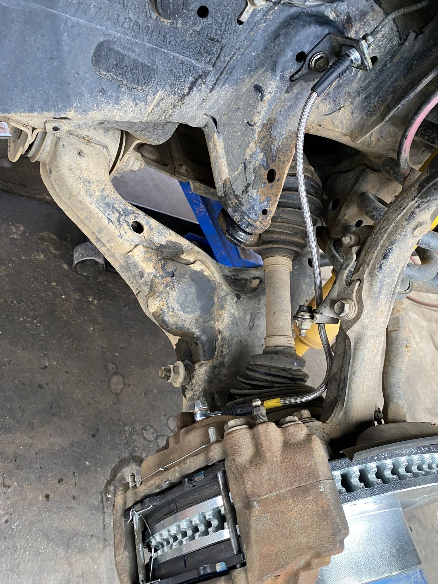

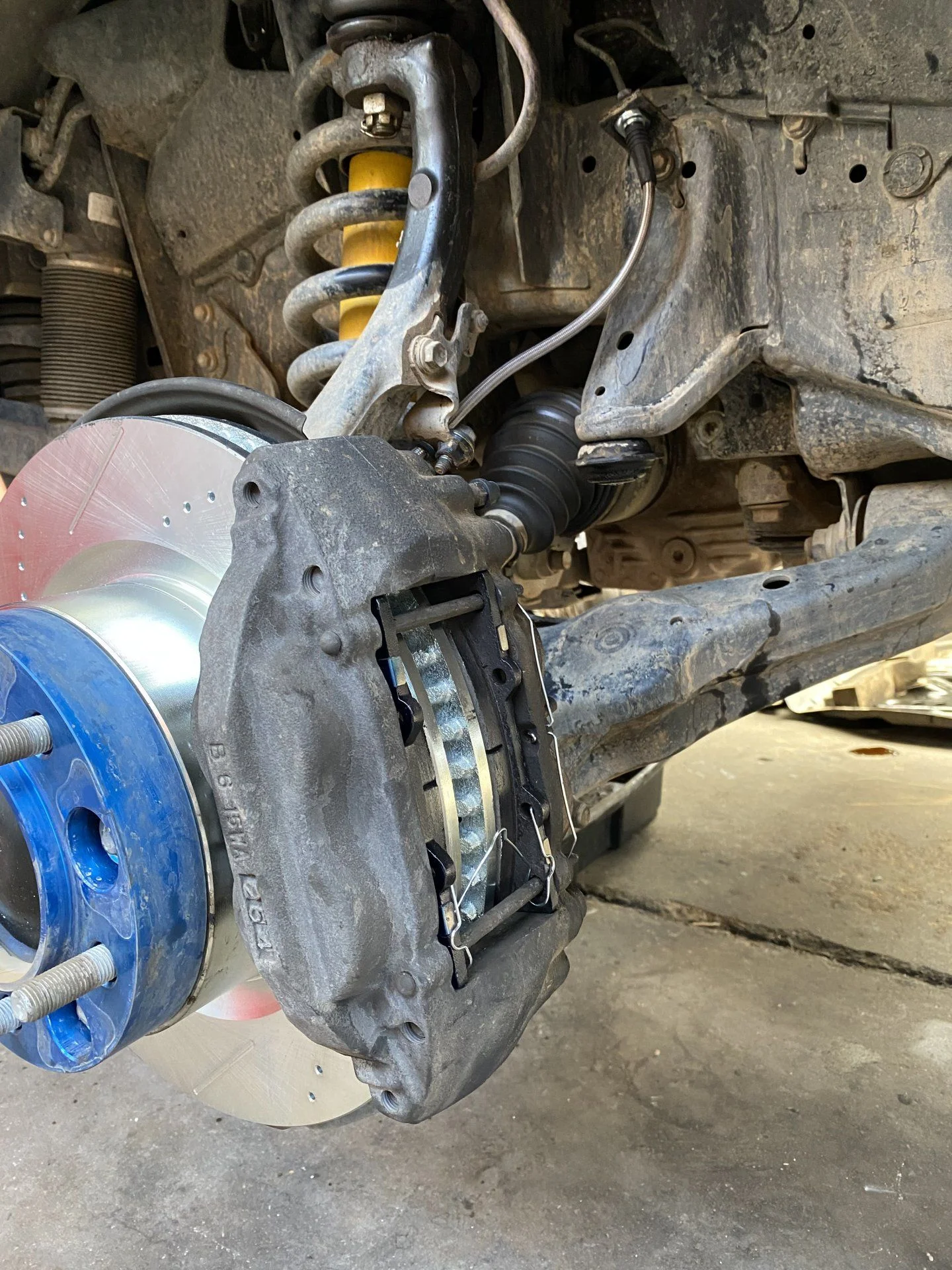

So I got the Brakes and lines installed just before I left. This was delayed because I had to stalk a UPS driver to track down the rear brakes after picking up the front brakes at the UPS distribution center. What an ordeal.
Pads/rotors are SOOOOO easy to change on these, I was amazed. The rear inner brake lines were a little challenging but but bad. The brakes work great, but I haven't noticed a big change is the pedal feel. I was hoping for a bit firmer pedal.

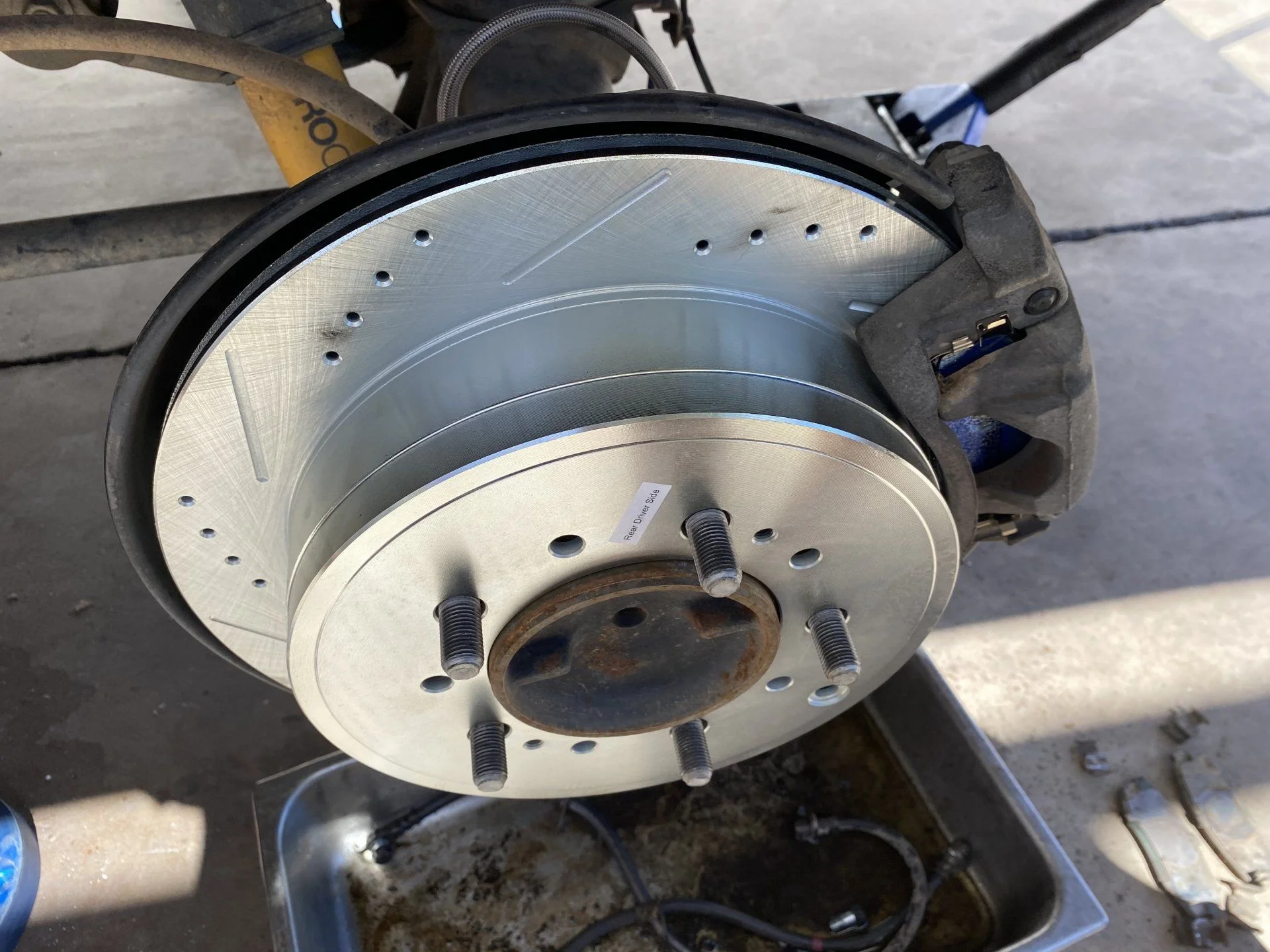

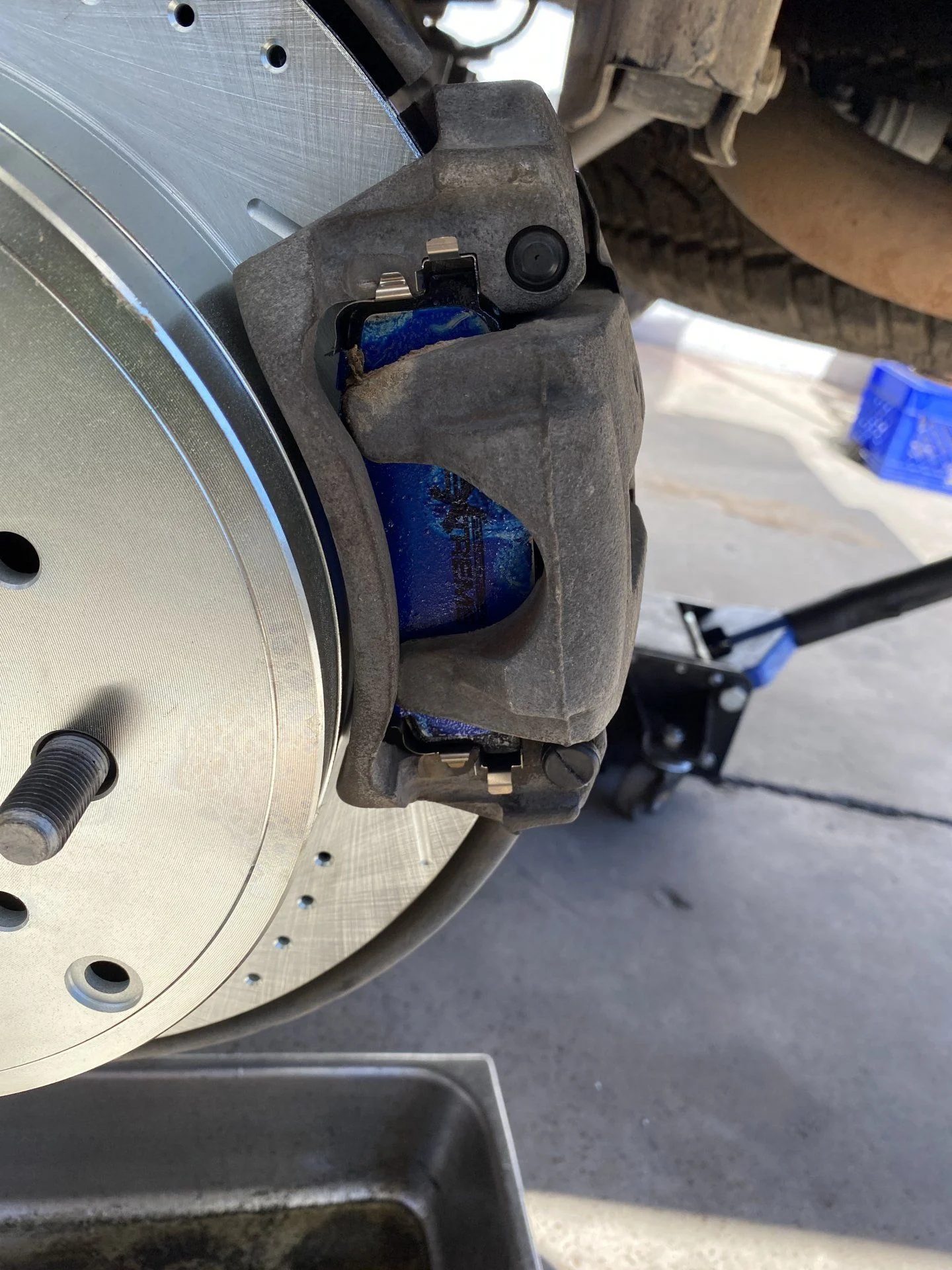

Did you have any issues with the rears? I had mine installed and the rears rubbed the backing plates so bad I couldn’t use the rear rotors at all. The front is fine and I really like how it feels. Waiting on Power Stop to get back to me. Thinking maybe they sent me the wrong rotors.

No problems with the rears. The whole thing went smoothly except for the rear inner brake lines. The lengths didn't match OEM, so it was confusing. Beyond that, the whole brake job was smooth.
