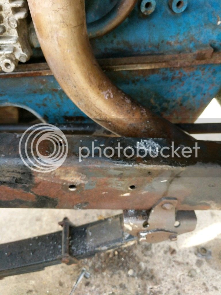

The hardest part of the conversion was removing the old manual gearbox mount. My best advice is to use a grinder or cutoff wheel to shave the rivets down flush. Then use a center punch to start a hole and drill with smaller to larger bits until you can use a punch to get them out. BFH and a pry bar. I had to clearance the firewall a little for the steering column as well. Just used the Dremel and a chisel. From start to finish, it took me about a full day, but I had to stop and entertain my 2 year old when she got tired of scrubbing parts. LOL

I just started my Sagin conversion yesterday after gathering all the parts. I would agree the hardest part was getting the old mount off. I drilled a small hole about half way down the rivet, then cut off the rivet head with a angle grinder. Then I used a cheap punch and a bfh to punch them out. If you cut off the rivet head first you may not know where to drill the hole.
