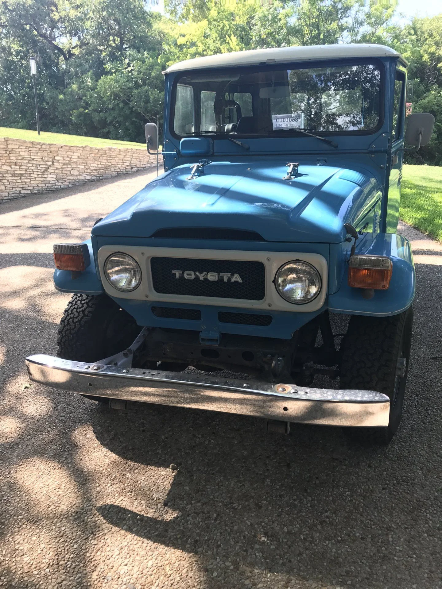

^^ Do you have fat tires or more stock? Makes a huge difference. Got a picture?

Yeah, I’m not running larger tires, but I’d love to be able to parallel park without building new muscles. :)
