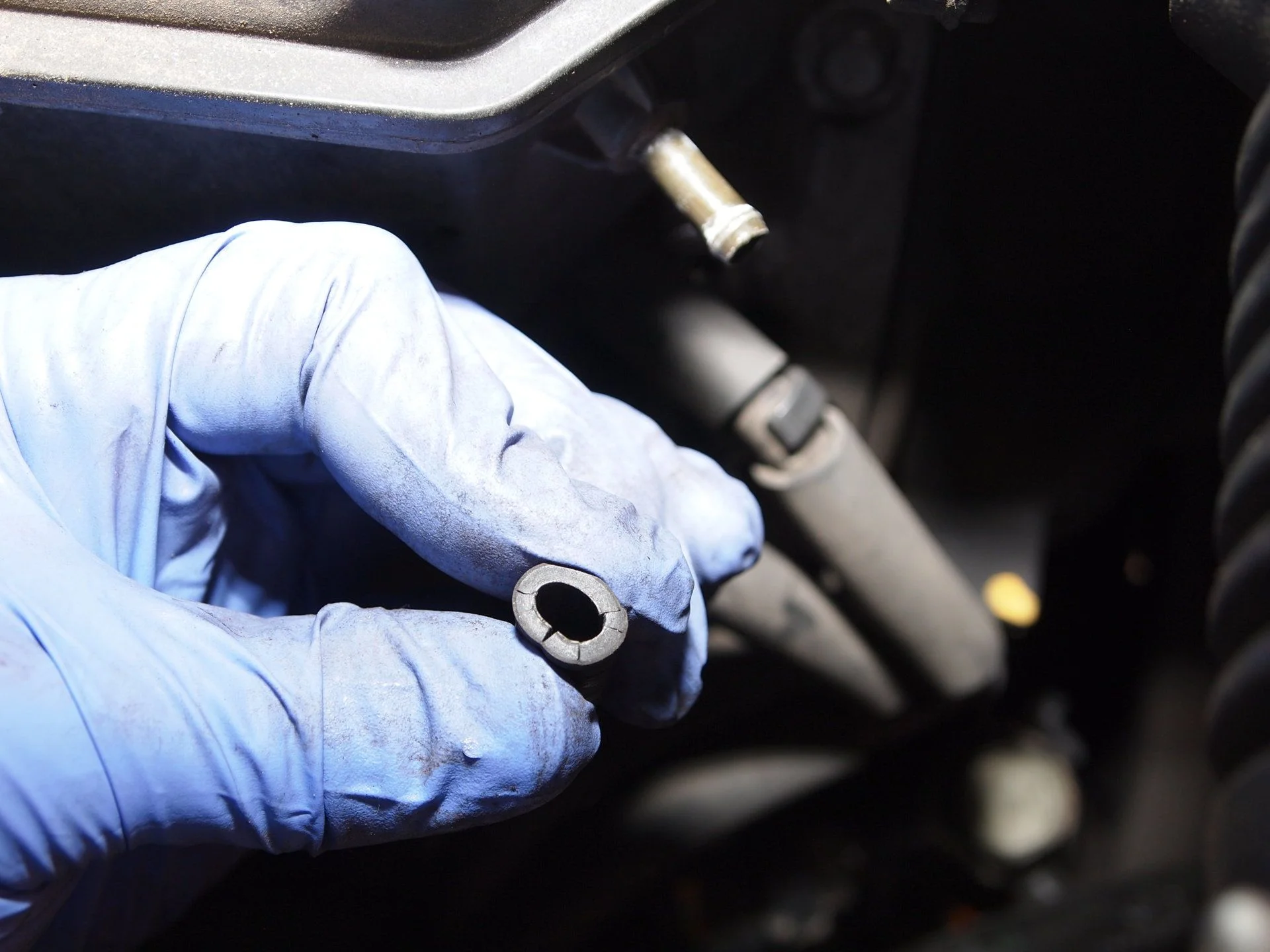

Vacuum lines bad or disconnected.

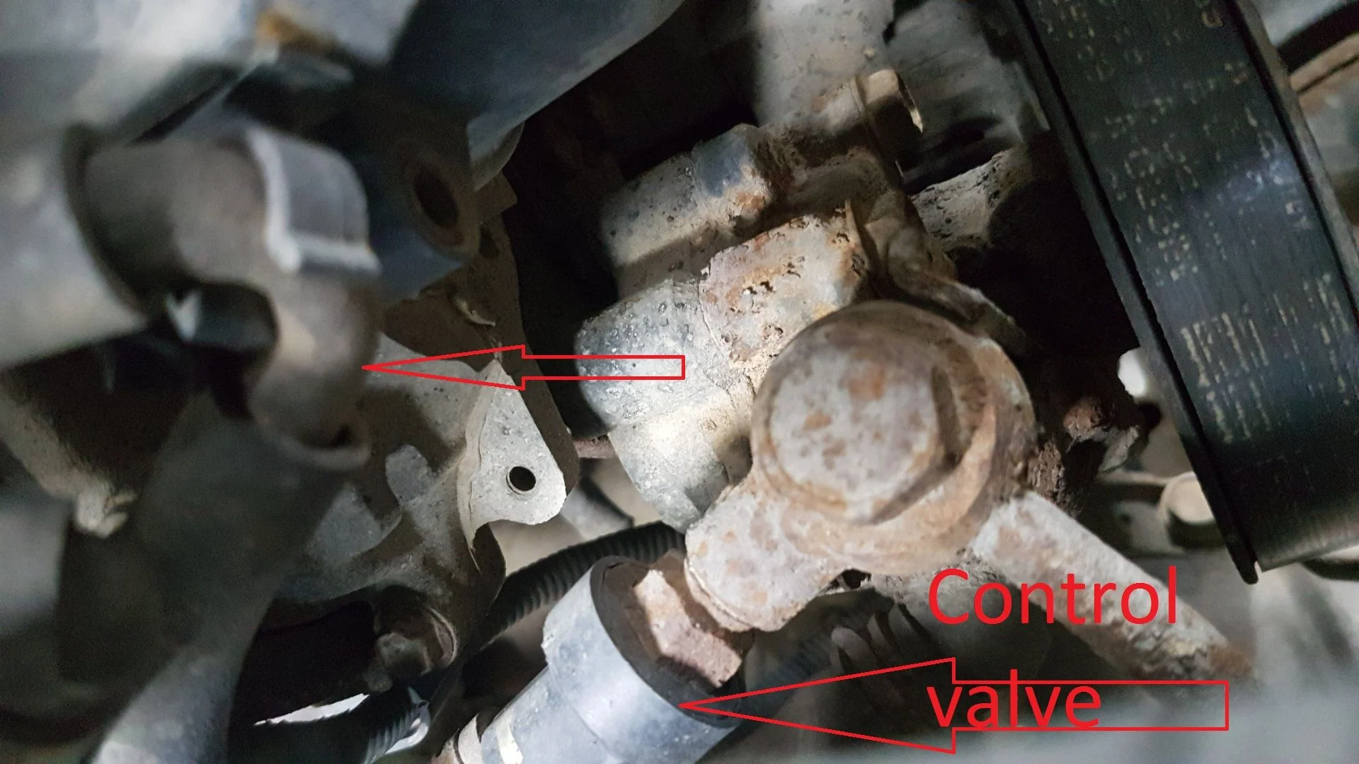

I looked under the bonnet to check the 1pin connector but I cannot find it from the top.I have also attached a photo. Or is it connected from the bottom?

If we are talking about vacum lines? Can you be please more specific so that I have the idea where to look ? Od do you mean vacumm lines in general?

Double vacuum line coming off the control valve:
