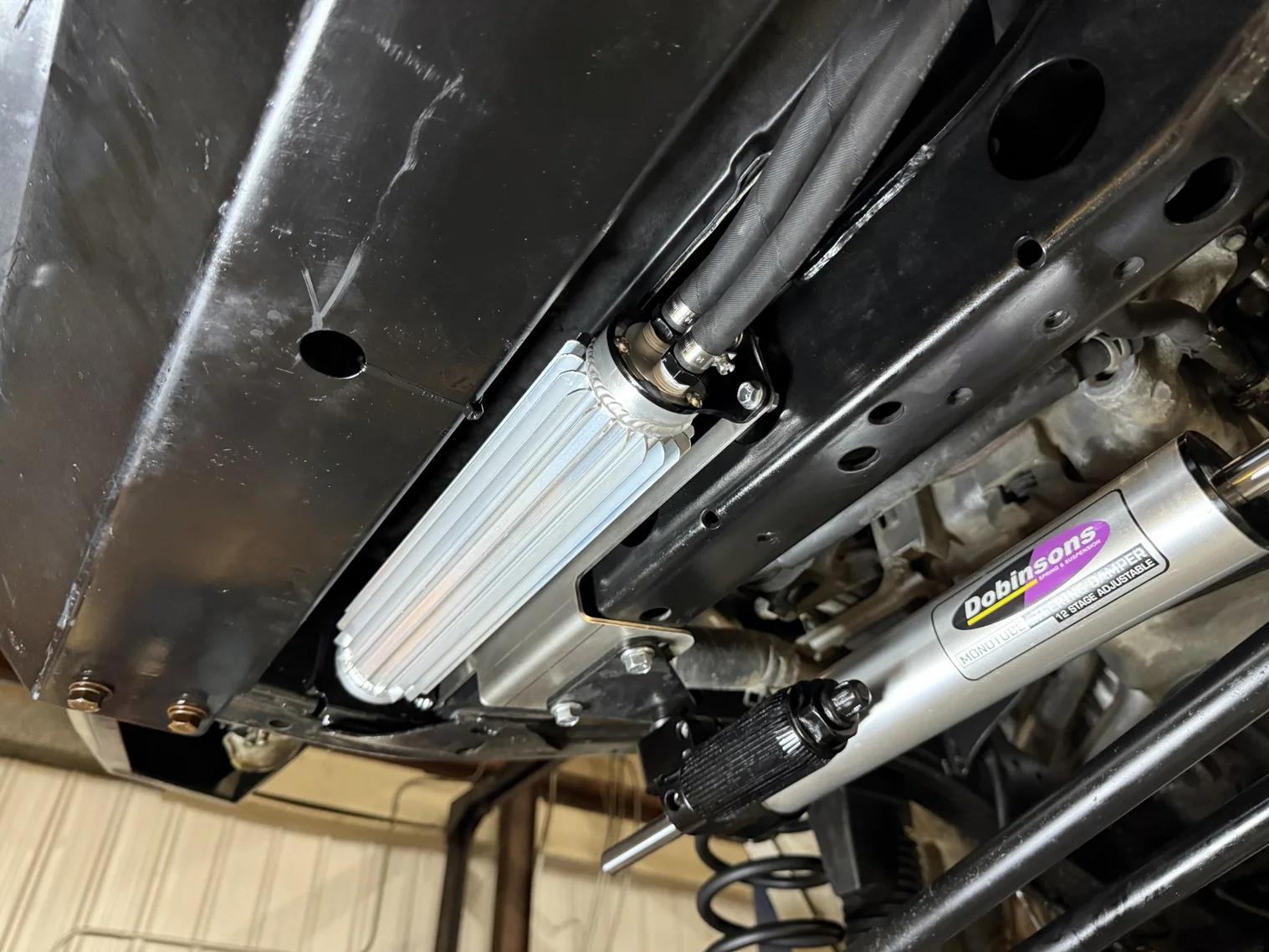

When my old radiator expired I salvaged the trans cooler element from its bottom tank for the paper clip on mine when it gives up the ghost.
It can serve the same purpose as the paper clip - just need to make a mount for it which wouldnt be too difficult
looks just like the one below
