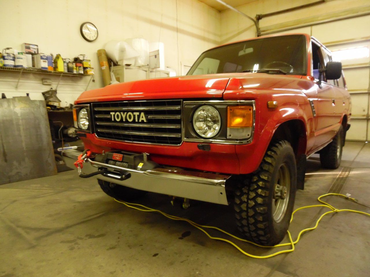

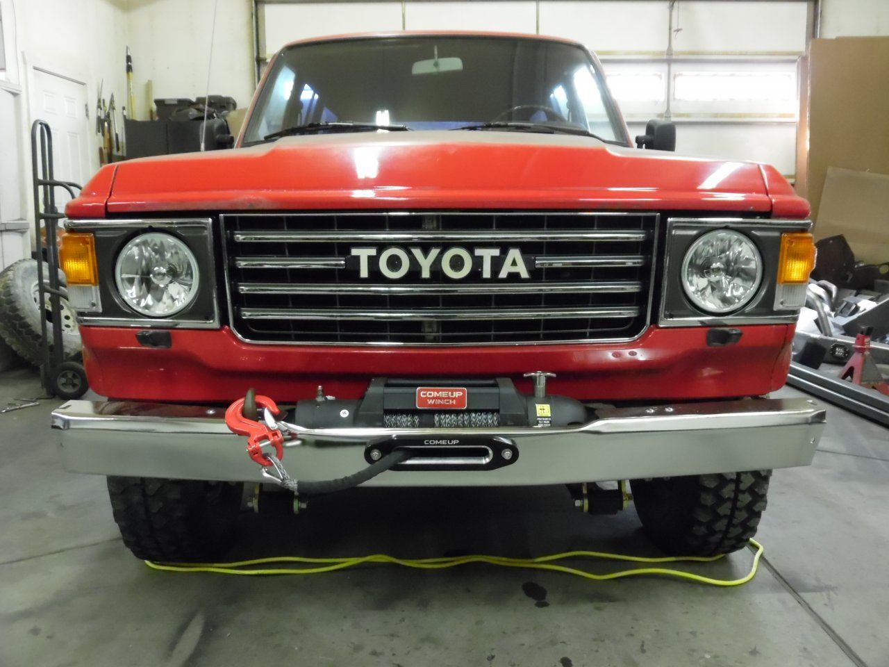

View attachment 1198230 View attachment 1198231 View attachment 1198232
Excuse the dumb question, but I'm trying to figure out what happens to the bumper if the winch cable starts rubbing on the fairlead while under load? Wouldnt that possibly bend the bumper as the fairlead is bolted onto it?
I am just used to seeing fairleads on stout bullbars whereby if the cable is pulling sideways, the strength of the bullbar is such that it doesnt fold aeound the area of the fairlead.
The set up is brilliant, so definitely want to replicate it for my 62.

No dumb questions. I'm not worried about that one bit for my application. If you go this route you can always run a inner vertical plate off the main horizontal winch plate. Then bolt the fairlead, bumper face, and vertical plate together to beef things up.

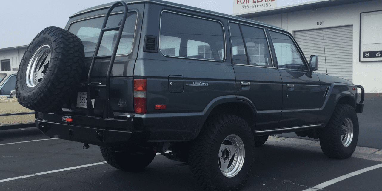

The custom rear I built for @MBurroughs was stolen along with his truck the day after he got it back from the powder coater and installed it.
If anyone sees this rig, please contact Mike and the local authorities. If you can't get a hold of Mike please PM or call me and I will do all I can to help with the recovery of his rig.
