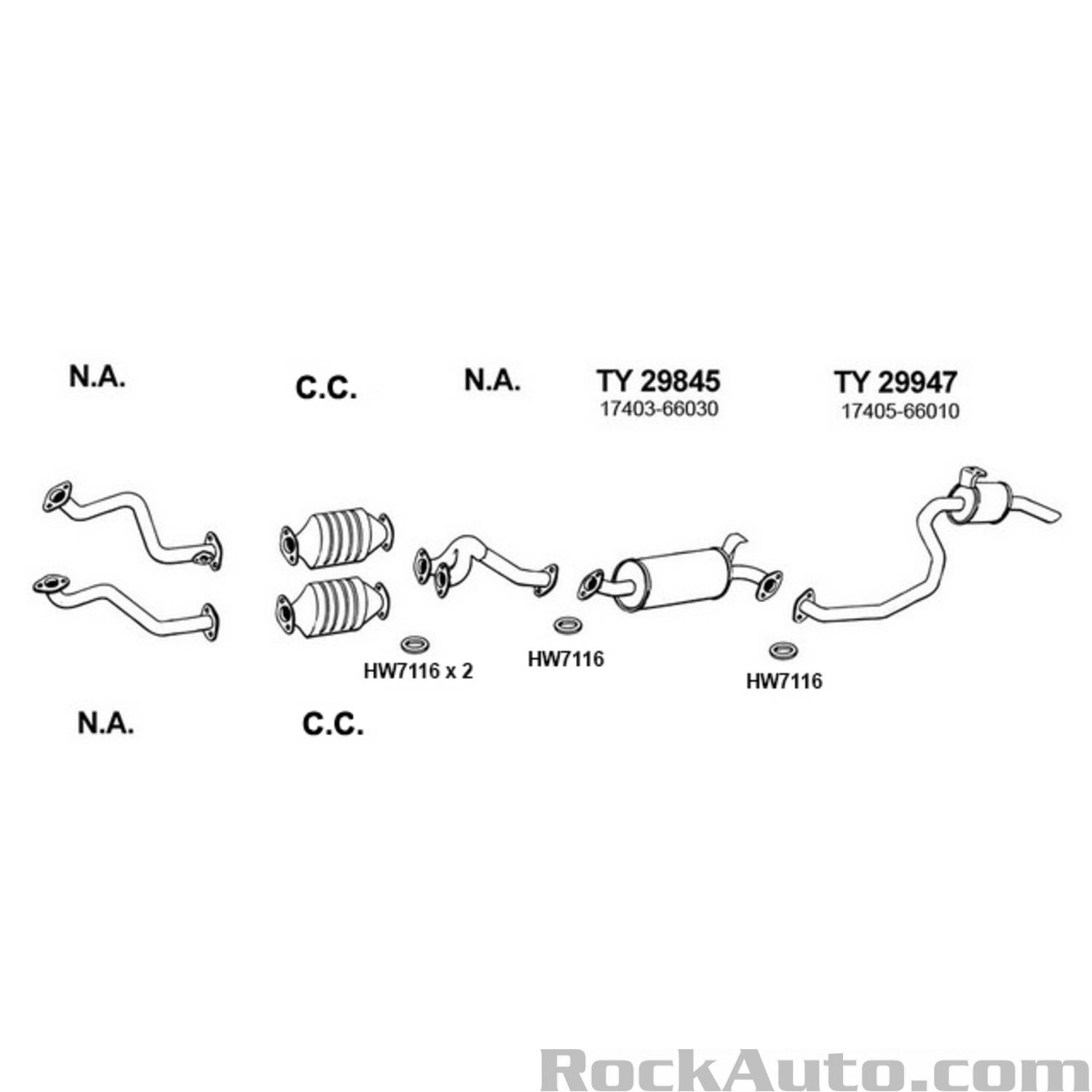

so, yea i am basically just switching to the later style, i decided to just get ansa factory fit pipes for the back.
The magnaflow y pipe according to this forum is a direct fit to the exhaust manifolds, but like mentioned earlier, you will need to pull your PAIR system and use its inlet fittings for the O2 sensors.
mid 95 and later uses a y pipe that joints before the two cats, which are in line with an o2 fore and aft of them.
94 and earlier has the two pipes from each manifold, each with their own o2, and own cat, and a union after the cat.
Since 94 does not have an aft o2 i dont see a reason to buy the second cat, so i'll just put a straight pipe there.

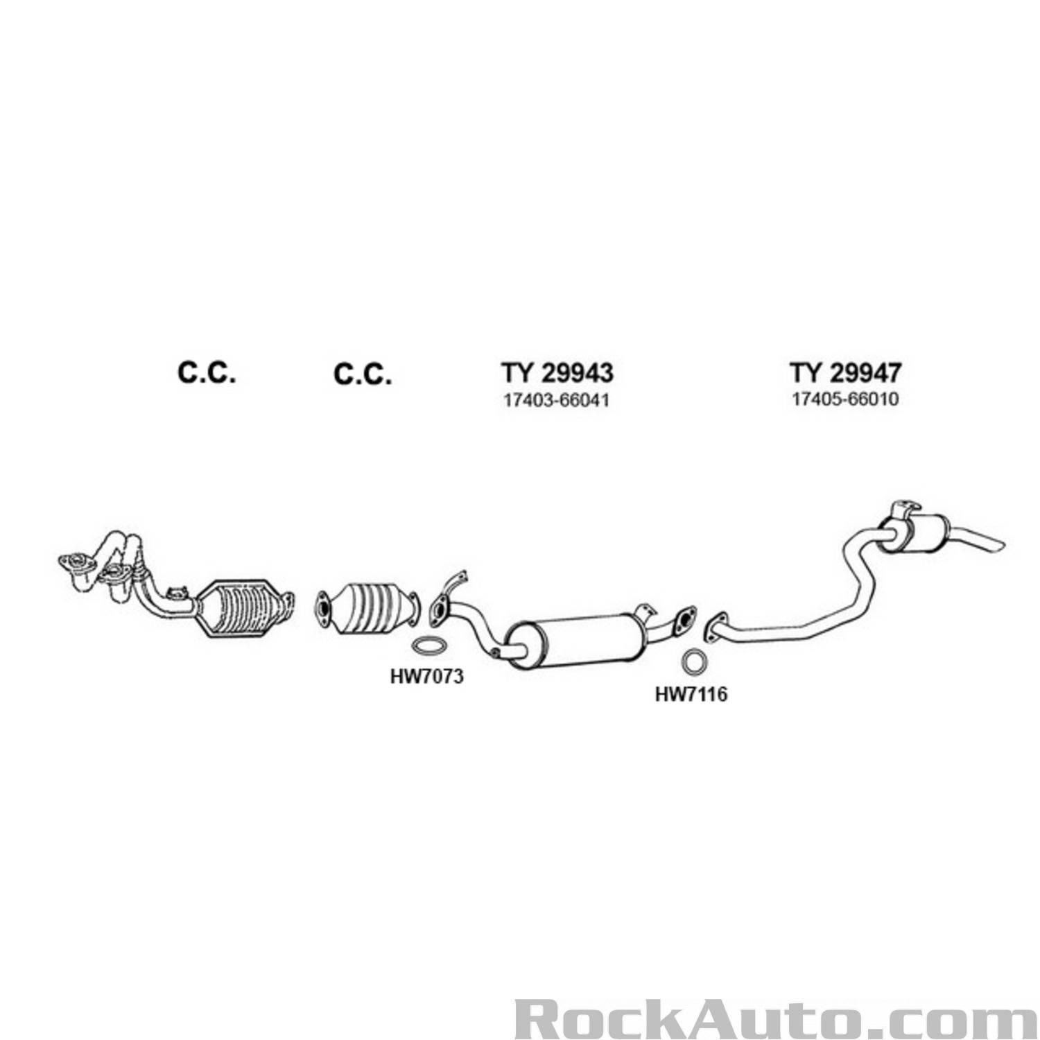

and then ANSA TY29943, which i will cut the inlet flange off of and add and extension pipe in, in the spot of the second cat on a 97.
and then ANSA TY29947
the gasket numbers are :
ansa hw7073 and hw7116
early style like our 94s
late style
the 02 bungs will need plugged or welded, and mounts probably are not a direct swap.
