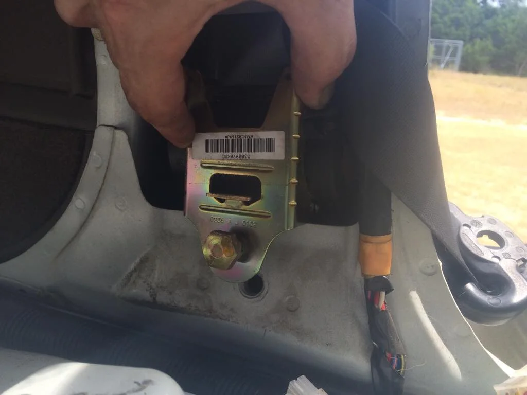

I am not certain but the LR belts may be able to be used. I didn't grab the belts when I got the seats but I noticed the end of the belt bolts to the seat of the LR and the on the 80 it bolts to the bottom of the B pillar. I will have to look next time I'm at the yard to see if the LR belts can be taken off the B pillar and put in the same location on the 80. The bolts are the same size from what I can tell.
My 97 buckle receptacle is to short and angled differently to replace the one on the LR seat. My yard charged $7 per seat for the belts even though I only took the buckle receptacle which was attached to the seat. Should have grabbed the whole thing.
@Mr Cimarron the female portion of the 80 series belt bolts to the seat, not the B pillar.

Yes the female bolts to the seat. The other end of the belt (anchor side) bolts to the b pillar floor on and 80. The LR goes through B pillar like the 80 but then bolts to the seat.

Since the LR female is attached to seat just use the anchor the other side of the belt to the 80 location instead of the seat. Exact same anchor system.

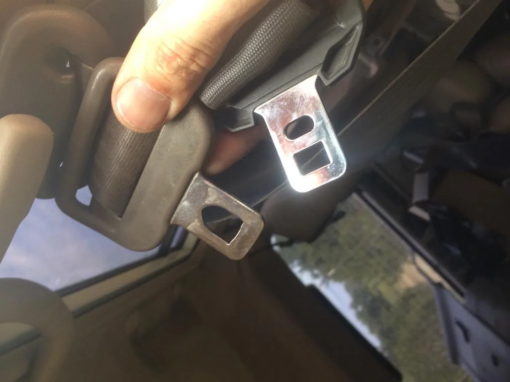

I went to the junkyard and pulled a belt from a Freelander this morning. I was hoping the reel from it would bolt the same way as the 80. No go there. I think a adapter could easily be made to use the LR seatbelt. The other option would be to cut the 80 belt at the anchor and slip on the LR buckle then have the anchor sewn back on by a professional. This would make it possible to leave the LR female end alone.
I also found plenty of Toyotas from the late 90's that used the same buckle as the 80. Problem is their female end is the same as the 80.
Buckle differences.

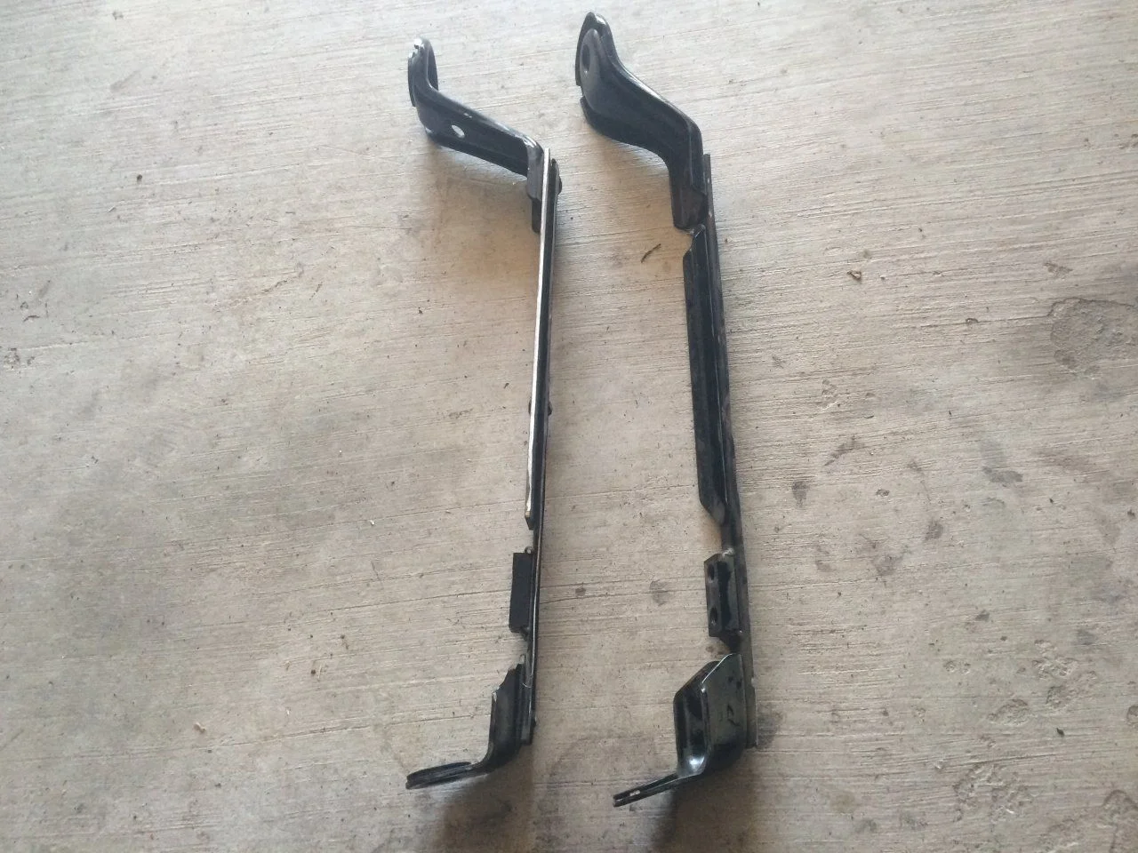

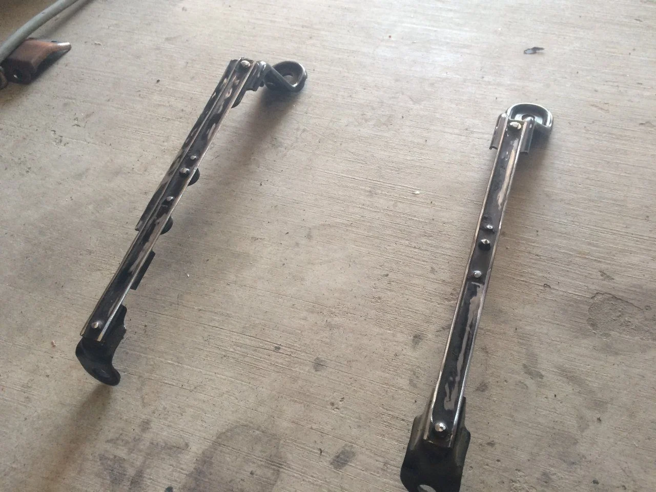

Hacked up my spare seats today to get the feat/bracket off. Went through 3 cutoff wheels and most of the afternoon to do it along with cutting off the feet from the LR seats.
Test fit seat in the parts rig. This is sitting about 1-2" higher than it will be. Had some boards under it so it would sit on the LC brackets.
My plan is to use some flat stock to weld to the LC brackets to add the 1" on each side to line up with the LR seats. I also need to figure out how far the LR seat moves forward and reverse before bolting together. Once I know this is doable with the drivers seat I will then copy the process of the passenger seat.
