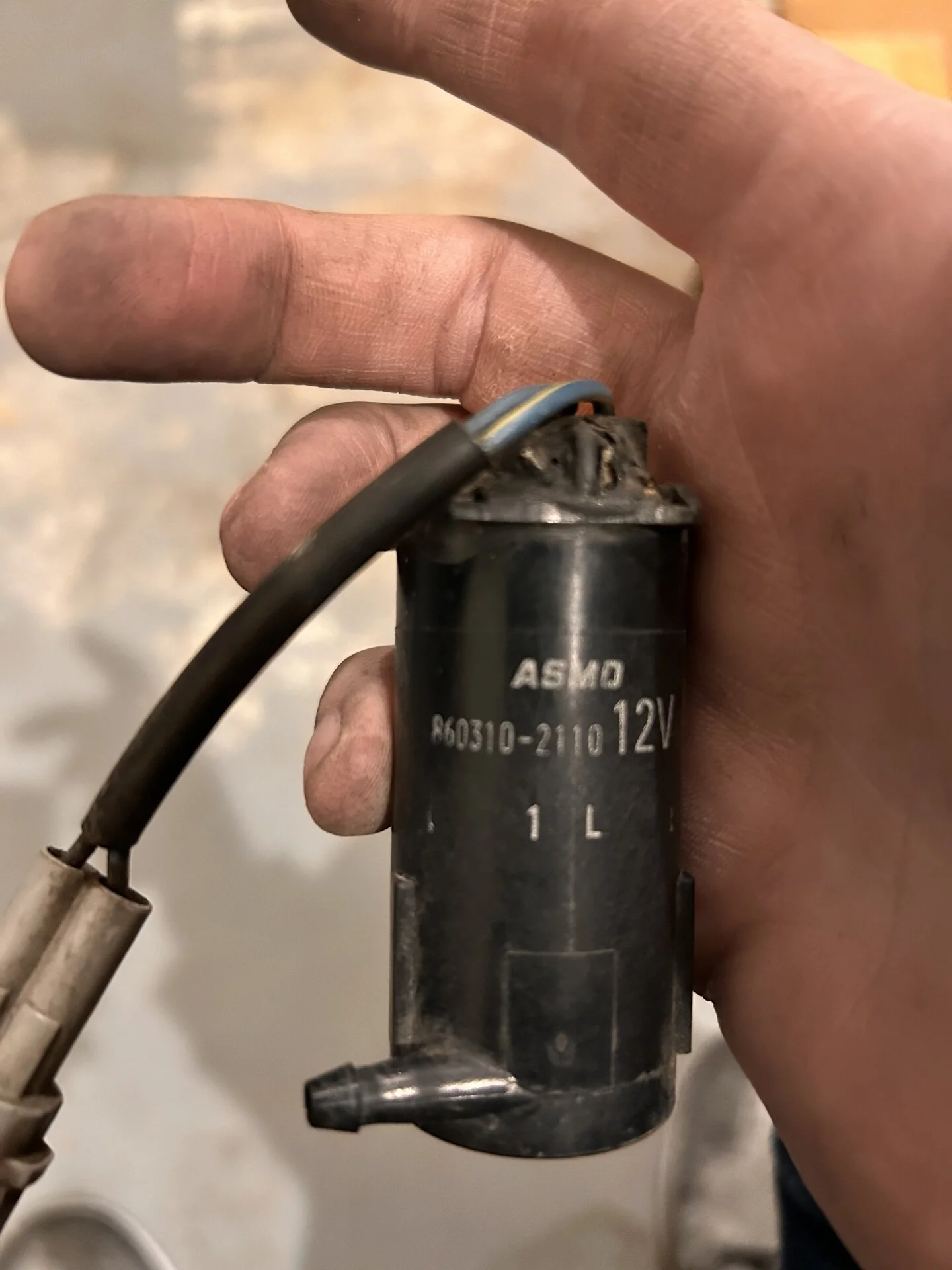

Does anyone know if it is possible to buy just the plug for the washer pump 85330-50020/? I have a 1991 in NA, Gas. Replacing nozzles and pumps to hopefully get some way to clean my window after like 5 years of throwing water on it while driving. For some reason, one of my pumps is different and wired into the pump with a connector mid line about 8 inches away. I probably also need to figure out the wire type.
Additionally, looking at the diagrams, its looks like the front washer pump is not supposed to have a filter (mine does not though it may be added after- mine currently is a 860310-2110 by ASMO)

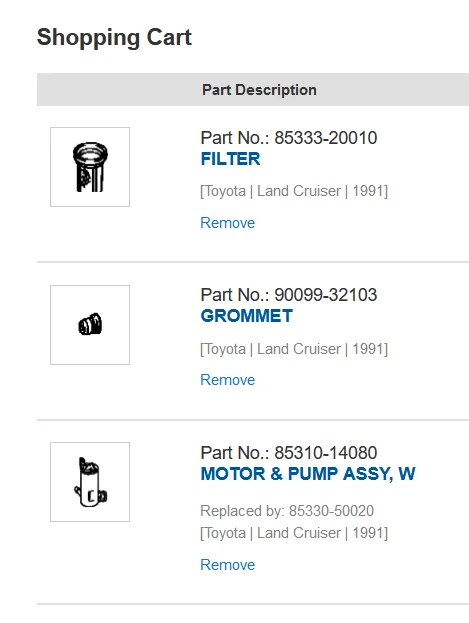

This is what I'm ordering:

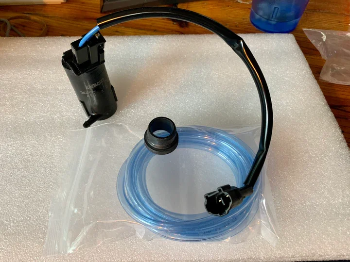

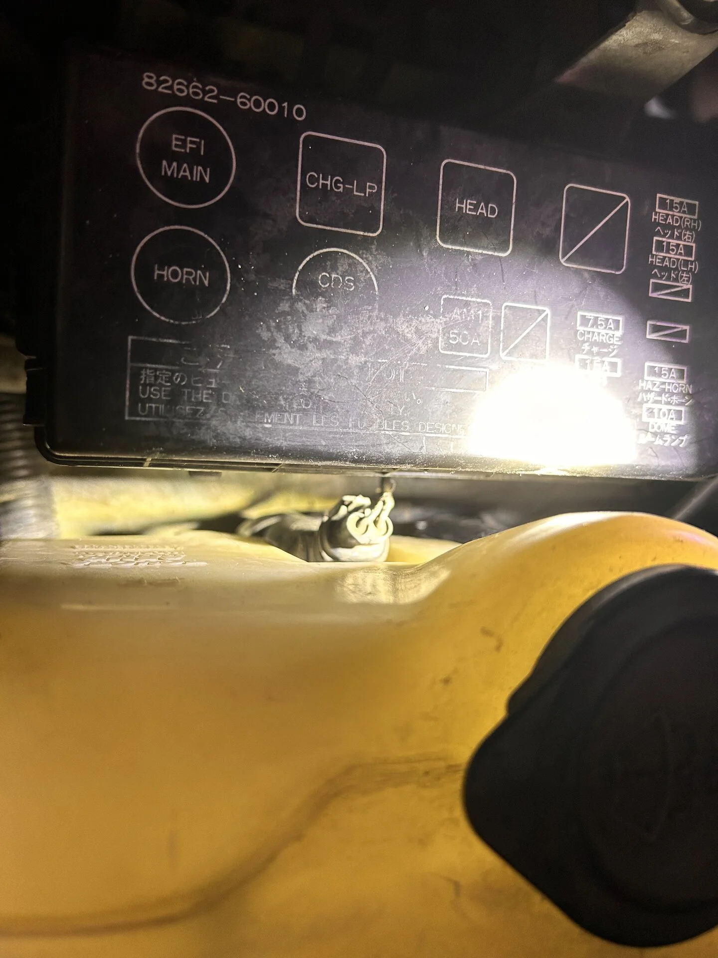

This is the front pump above

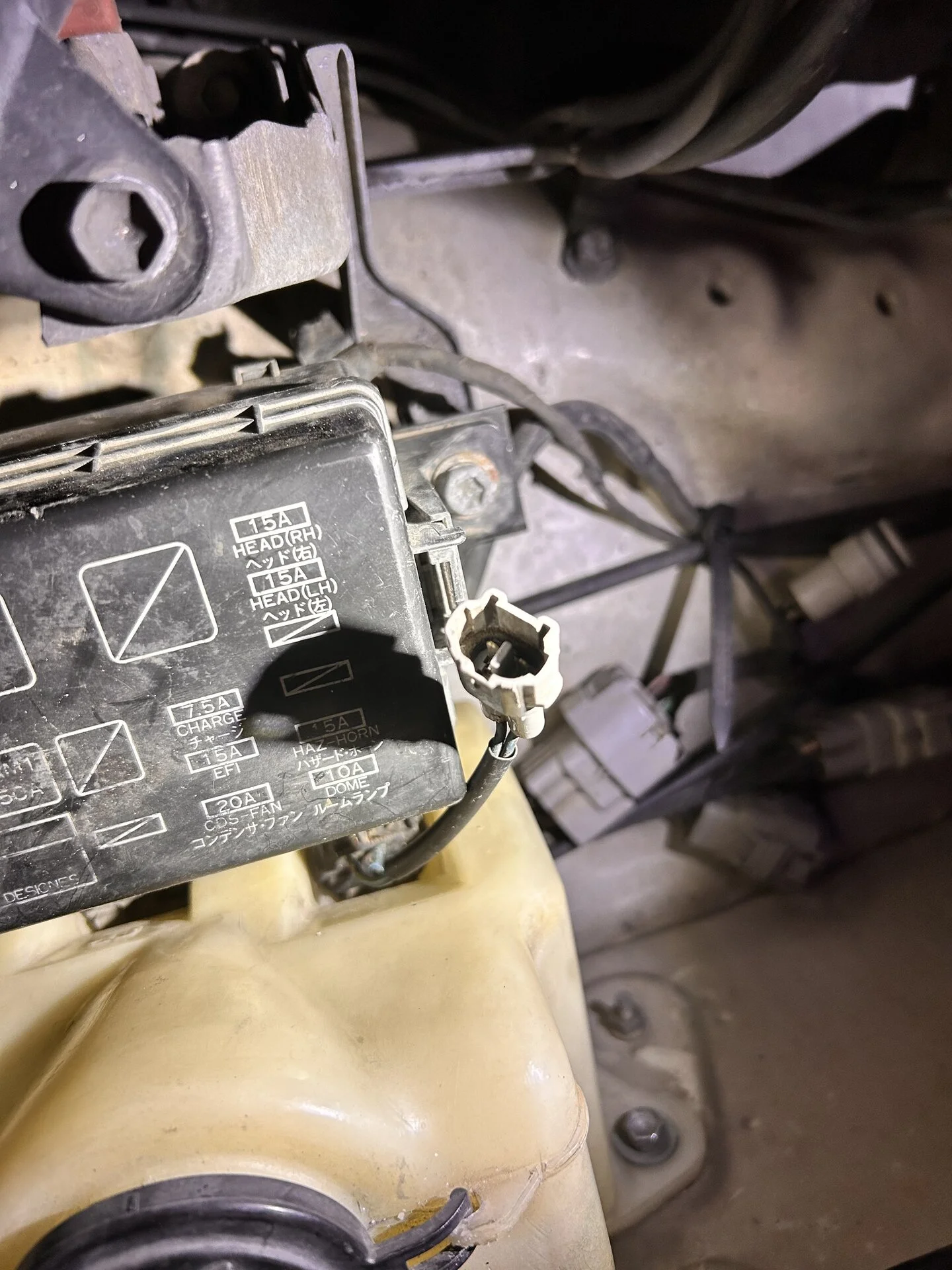

Front pump connector (I know I should have taken more photos while out)
Bad photo of the rear pump but seems to be correct for the pump most people use in most 80s including the fj and fzj (the plug on the harness side is what I would like to find and buy)

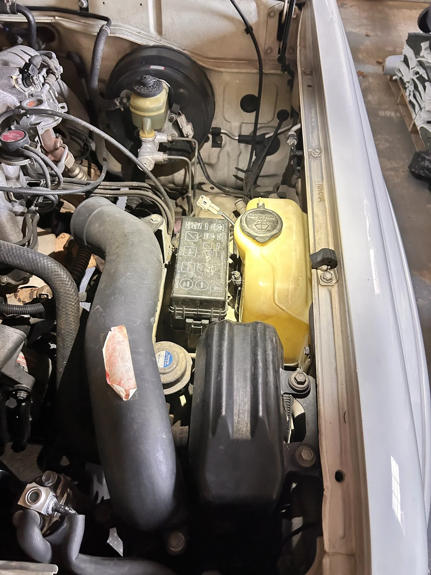

My washer reservoir is in good shape but damn that additional reservoir in the fender sucks to work on.

Hey! That looks right. Does this one also have the “bladder” in the fender bs? Posted some bad photos above
There should be a part number, very small, printed on the connector itself, usually located on the backside (side that the wires go into). The only way to see them is to clean off the connector (use Electronics cleaner, never Carb cleaner or Acetone on rubber/plastic parts) then take close up photos to look for the number.

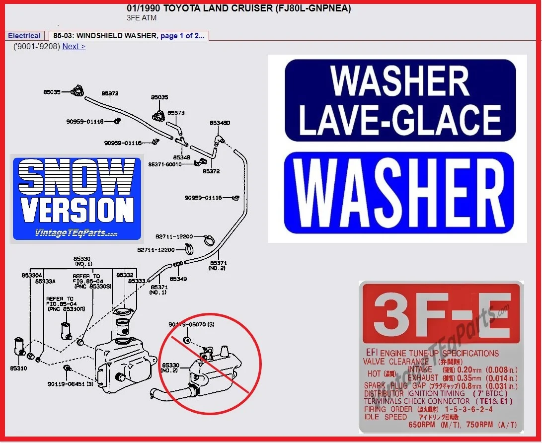

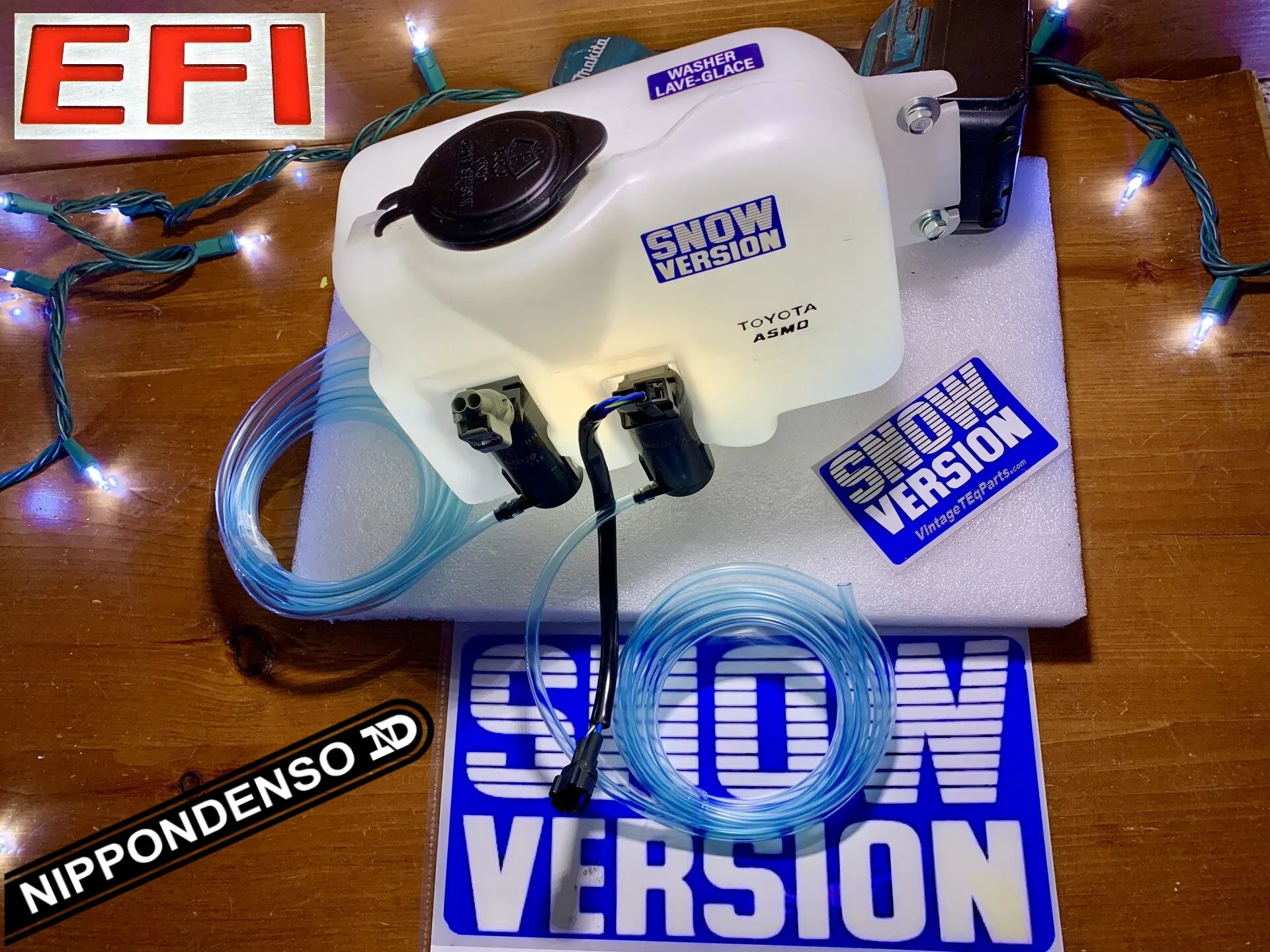

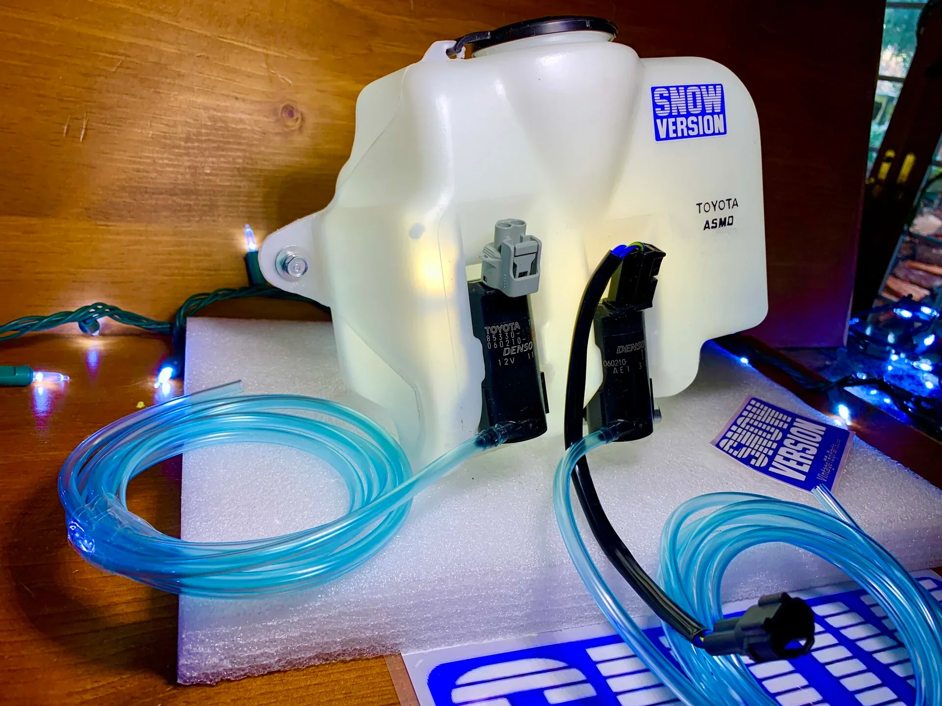

the USA spec. often defective and worn out dated bladder bag is NLA / disc. \
FJ80 3FE washer bottle , does NOT utilize a bladder ,
- however ........
- for those that DARE to cheat fate ?
- the BOSS for you to use a HOLE saw , and retrofit some oldd-azz 30+ year old parts that no longer exist , can be done , but that is YOU choice and NOT recommended in any way here ,,,,fyi
- oh ? maybe i forgot to mention , this NEW updated JAPAN spec. washer bottle , SNOW VERSION , is a unique oversized fluid capacity , oversized ....
- it fits usa spec. FJ80 3FE perfectly , so the larger overall washer fluid holding ability in
Liters , more then makes up for a bladder bag ...

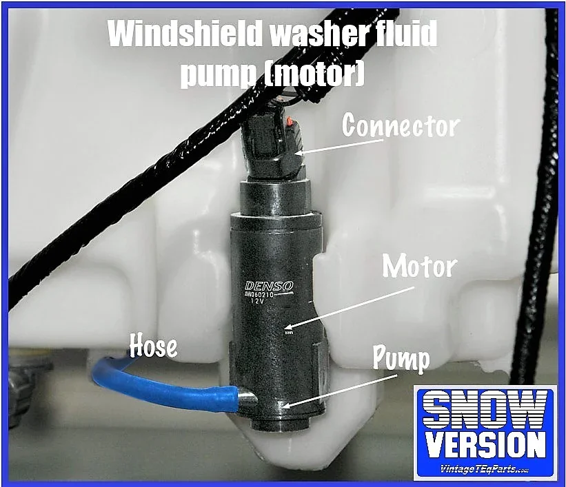

- BOTH OEM washer pumps are nothing sold here in north america , rather non-usa cold-spec. HDJ81 12V pumps , super high pressure / super high volume .....
- as far as ID a connector on a 1991-1993 FJ80 ? TOYOTA did not introduce the numbering system fully in these years , also TOYOTA connector housings come bare , just a plastic shell , NO seals or NO terminals ........fyi
- a photo of the back , ? excellent feedback , it WILL be done .......thanks :D
- THIS IS THE WAY ....

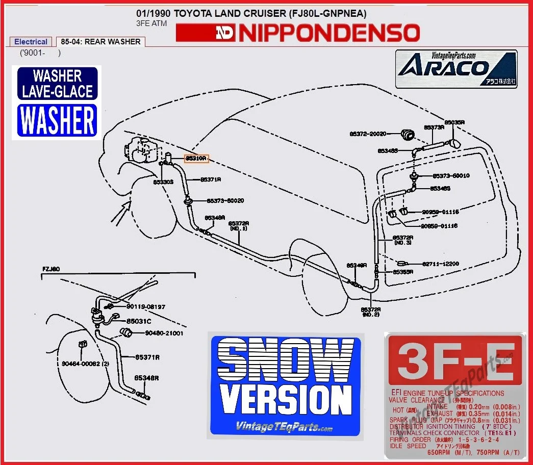

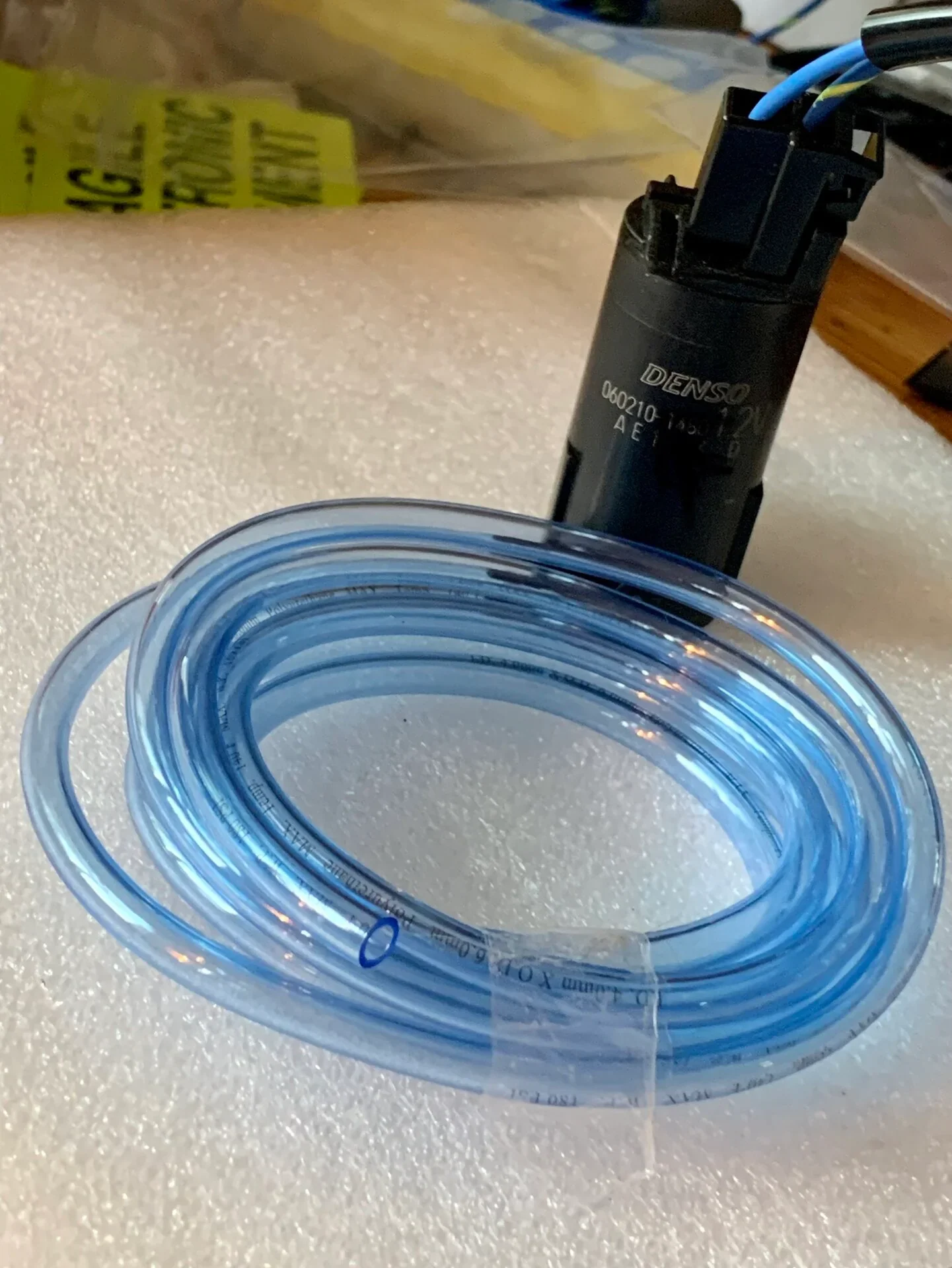

- i have personally test fit the entire FJ80 3F-E SNOW VERSION system you just scooped up from my family run store , i had ZERO fitment issues of any kind , and there are ZERO mods ......
- one detail i did miss in all my pics , in addition to the back side , is the fact you also get / is included the FEMALE HARNESS side Connector PLUG & extra terminals too , to refresh it is KEY here , for the rear washer pump assy / one with pigtail ASMO part # 860310-2110 toyota part # 85340-60040
- i have had no negative feedback in any way , on the dozen or so full kits i have mailed out since day 1 , maybe another member can post there's install pics here , and provide any related feedback they like on this topic .....
- in the meantime , please review the TECH. REEL short below , make darn sure to click and turn on the speaker icon , and turn your device sound volume to the highest level .....for best results 🔊
