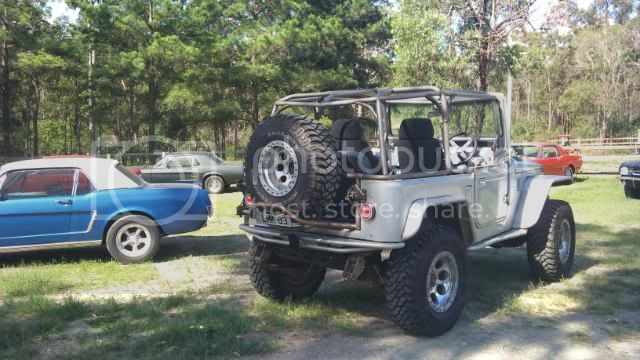

Would love to see a build thread on your chop, looks great, very functional!
No build thread. Took a 66 FJ45 that was incomplete in boxes and mixed in parts from a 40, a 55, and a 60.
Used this forum as a guide for each part.
My work is not finely finished.
If there’s something in particular you wanted to see I could post it if not redundant to better posts.
66 FJ66 cab and frame sandblasted,
Triple epoxy primed
monstaliner to floor/firewall both sides
New windshield
New corner windows
New rear slider
78 FJ40
Wiring harness, refitted/deleted smog
Windshield frame with wipers on bottom
New Racer wiper motor
Rebuilt Transmission/Transfer&ebrake
78 firewall grafted in on drivers side for Racer brake booster
81 FJ60
2F engine/new OEMpower steering-pump 50amp alternator -
complete rebuild/head- shaved .030. Valve grind
de-smog w JimC idler
Intake under carb built up alum weld
Modern double circuit power brakes
New clutch system
New aluminum radiator / hoses
Weep hole in head tapped & plugged
Exhaust stainless flex joints/resonator
78 small cap electronic dizzy
Oil pressure warning light
Steering
Column-
fj55 inner w u joint,78 fj40outer tube
Intermediate shaft to box from inside fj60 column (is collapsible)
Fj60 power steering box & Pittman
Steering column inset towards cluster 1”
FJ60 axles complete rebuild w ARB Air lockers 4:10 ratio
Kept rear ebrake, handbrake behind seat
Alcan 4” lift 55 Springs, 1” added to shackle ends, 500 lb extra load custom
New greasable pins/longer shackles
New custom driveshafts
Original seat raised 2”
Tranny shifter altered to clear safe
Odyssey battery
Roll bar to frame/Gr 8 1/2” bolts
Trailer hitch 7way/4way plugs
LED taillights
Racer LED headlights
Monstaliner inner roof
New 3way Humvee seatbelts
Racer Fuji carb
Mitsubishi dropside mini truckbed
Subframe made to tie-into frame and roll bar
4Plus side boards
6 degree pinion angle shims
Schwab measured 3.4 degree positive caster
