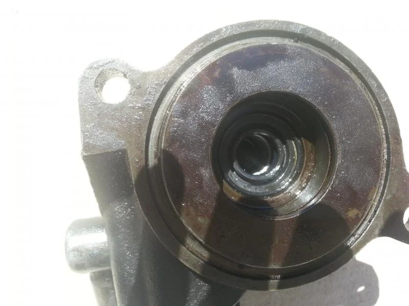

this part solved. This is the missing O-ring that sometimes people miss. I was one of them. It's about the size of a half-dollar. The old O-ring fell apart when I did find it and pulled it out.
I was confused as to where it went at first. It is in the first plate, on the back side, and sits in a groove. When you pull the plate out, flip it over and you'll see it on the inside wall.
The second picture just shows where I thought it might go. It does not go there.
This picture shows the O-ring sitting on the plate. It goes on the other side of that plate.

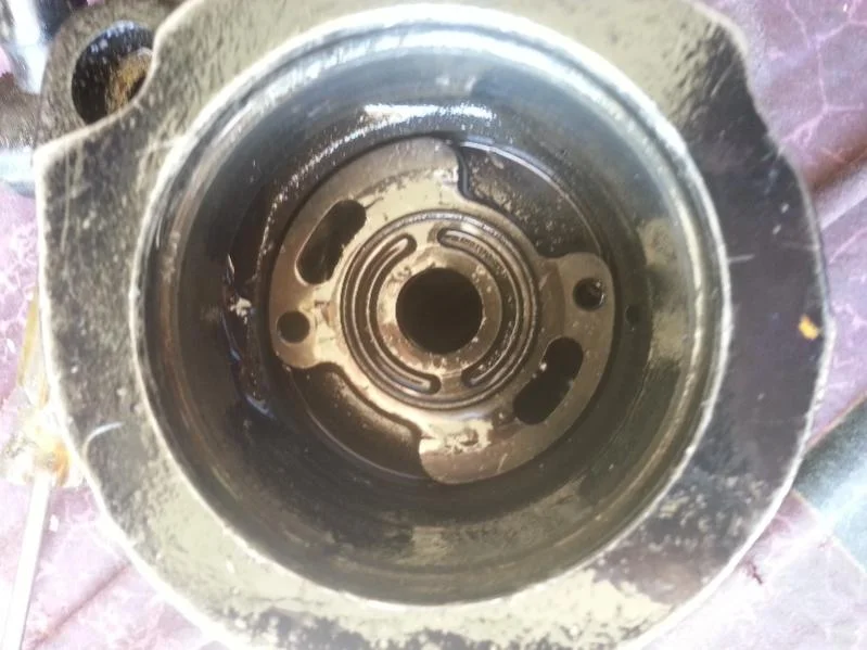

Noticed the inside of the pump showed signs of wear. Grooves were worn and there were some sharp edges on the plate above the vanes that didn't look like it was machined that way. Also found a hair line fracture in the groove where the "missing O-ring" was. It was enough that the metal was lifted causing a larger groove in that area.
On mine, the o-ring was "inside" a bore, in a groove. Since it was rock hard, it was hard to see for sure as it was flattened out. Where most of the o-rings are on the outside, this one was inside. I.e., you would need to be standing inside the pump to see it, which you probably can't do. I used a dental pick to get it out.
When you find it, you'll say "damn, that's the one everyone misses".
I'm not 100% sure, but I think it's the 2nd from smallest sized one in the pic. The smallest one I think went on the tube that is held on by one bolt at the bottom of the pump.

EDIT: Found a pic that might have where that o-ring hides... I think it's at the bottom of the hole in the pic. Try looking there. You can barely see the edge of it in the picture. Again, I'm not sure this is it, but it's on an inside bore like that.

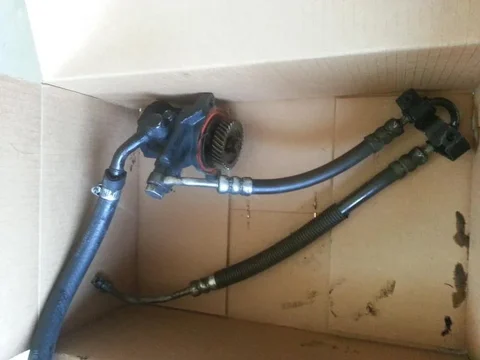

different pump/ same problem
I sourced a pump from a guy I know parting a LC out. I had nicked the gear and it was ticking a little otherwise I would have just got a new pump but his was cheap and came with the gear (and the high pressure line which was a gates replacement)
I debated on whether to tear it apart and use the O-rings from my pump since I just bought the rebuild kit and new bearing.

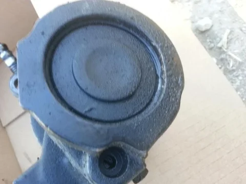

The back of the pump also shows some seepage and I'm not sure how bad it will be when it's on.
I decided to just bolt it up to eliminate any possibilities that I'm putting the pump together incorrectly. The less steps the better at this point and I can always go back and use the O-rings later. I just need to get it on the road.
