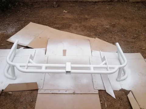

I've had some inquires about my new pink bumper from TG and the paint process I used. When I started this little project I was hoping to find this sort of info on the forum and wasn't able to find what I was looking for, especially for painting such a bright and unusual color without having to purchase a spray gun. Before I started, since the bumper comes with no coating, I wiped it down with acetone.
I used the Rust-Oleum Professional Aluminum Primer below. I bought and used 3 cans of this to have two full coats of primer. I had to use the Aluminum version since this was the only white primer they carried at Lowes.
Between each coat of primer and top coat I used this fine grit sand paper and allowed at least 2 hours between each primer coat and 4-6 for turning the bumper over.
With 2 coats of primer
And the top coat of automotive paint which I had custom mixed at Napa Auto Paint store location below. They have about 1000 automotive colors that can be blended into any custom color and they will put it into a spray can at about $25 a can. No spray gun needed! I needed exactly two cans to completely cover the bumper with two coats of PINK. Between each coat I waited about 4-6 hours and 12 hours before turning it over.

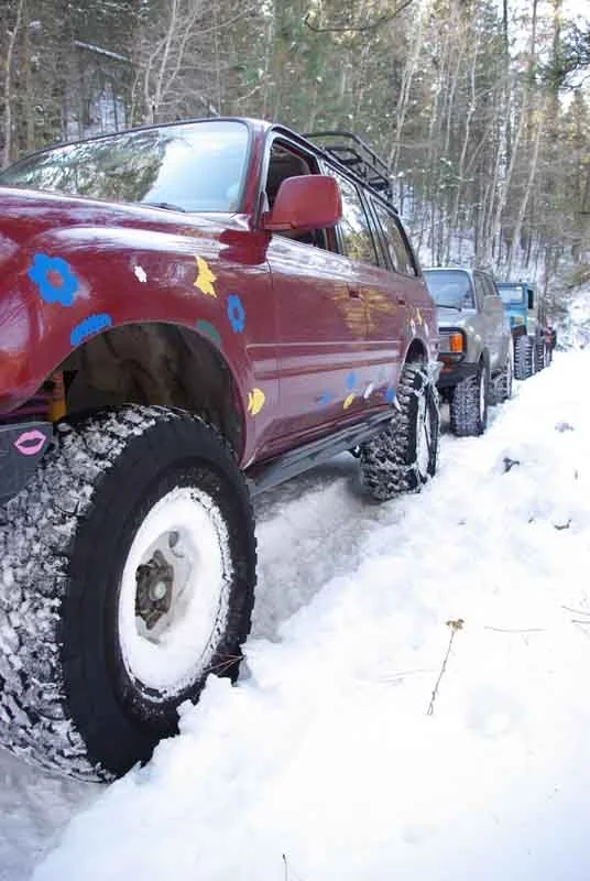

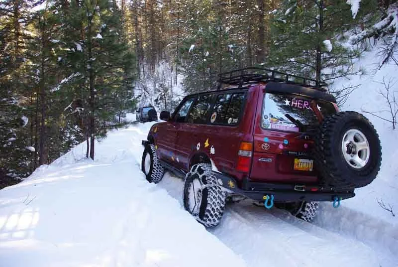

Cruiserdan's wife. She has similar, unorthodox methods (colors/decorations) as you. Not saying it's bad, jut different from most of the boring stuff everyone else does.
Who's Stickers?
attachment.php
attachment.php
attachment.php
I know there are more current pics of her psycho-delic 80 out there, but I can't find them. I thought she posted up some of her painting silliness.
