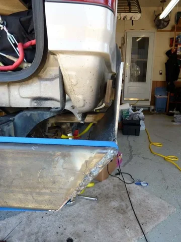

So here we are with the bend complete, one thing I forgot to mention is you really have to think in 3 dimension and backwards as well because if you lay the template down the wrong way, you end up cutting the groove on the wrong side.
Sorry not to show the welded up back side, I blew threw in one area and had to carefully, fix it filling it in. Looks OK.
next, as mentioned I figured out how to hold it in place, duh... using a strap, worked like a charm. I did have to place a clamp at the bottom as it tended to drop a bit when I ratcheted down on it
next, welded up. I will cut off about 3/4" on bottom and about 1-2 inches in to match it up real nice.
Question to all, what should I do about the top of the side, leave it or add a small piece at a 90 degree angle to the side plate. Problem is , I wanted to leave some room for any body flex.
the plan is to put my mud flaps back on if every thing works out.... cannot have any unnecessary stone chips in my nice new shiny bumper
next steps. finish fabing other pieces, weld on, remove bumper, strip, etch and paint. I should be done in time for Durhamtown....
Looking good PG. Might want to think about a little reinforcement, something that ties the side plates into the frame so it wont collapse if hit from the side.

I reinforced with 2x2 x 3/16" at the front if you look closely at the last picture. I will probably put a few small gussets here and there. Got 2 more pieces cut out tonight (brrrrrr!) and will gear up for the final drill out of the left corner of the bumper to take the spindle which will sit in a tube of schedule 80? tube which I will weld to the frame. I am getting done and need to think about priming and painting. Also need to lay my hands on some more pipe to build the kick outs and weld them in.

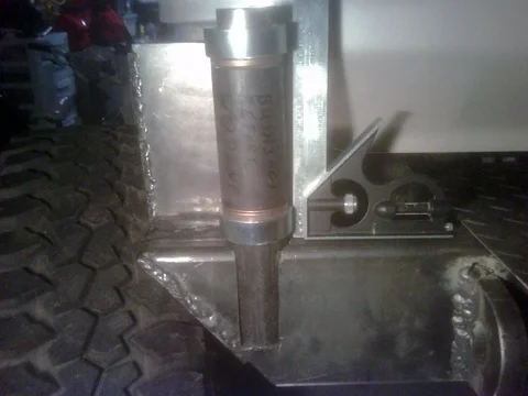

So not much done on truck other than welding in the hitch and drilling out the spindle on the bumper and cutting and bending & welding in the small back plates on bumper. They turned out nicely after a bit of grinding and :bang:. I will be sleeving it and welding to sleeve and then weld the sleeve to the bumper.
Here is my status, we are a bit off as it has to be perfectly parallel.IMG00123-20100301-2202.webp
Weld the right side first, the weld may pull it plumb. Let it cool and weld the other side and you should be good to go.
Looks good :beer:.
excellent idea, still need to do some filing on left side

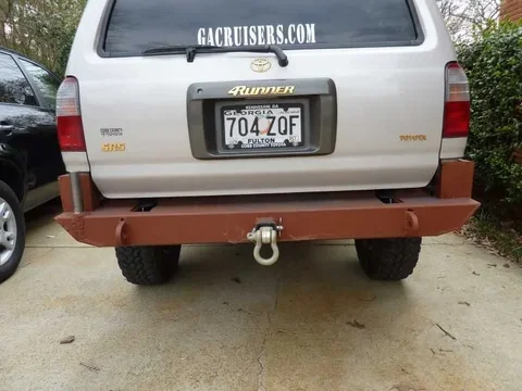

Well folks, unfortunately I missed durhamtown, got bumper on, but had some minor fit issues that put me too late to meet up at 10am.
Got bumper on and here are some pics.
Have to figure out something for the hitch, ie attach chains to. Am thinking from back side to minimize loss of departure angle
back
side, ok am just a bit off on being parallel to body lines. opps....

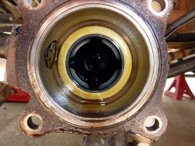

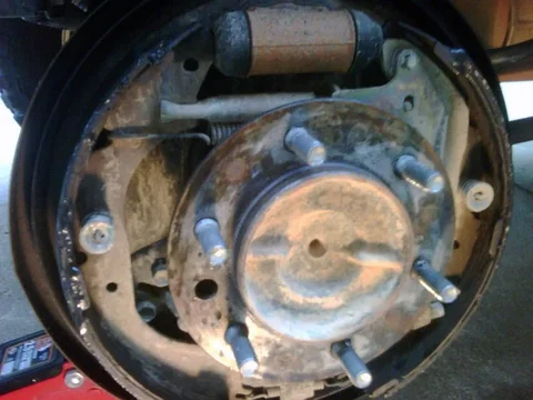

Here is what they looked like
here is the problem, looks ok to me

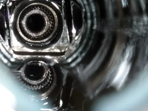

got off the axle and here is a rare look into the tube

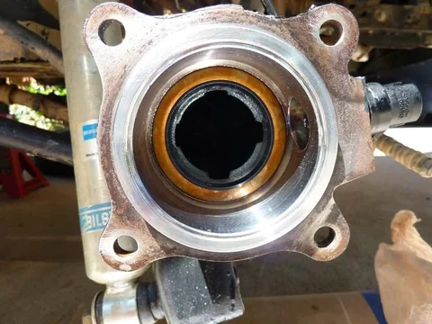

So I ordered parts and got the bearing pressed off and replaced.
I did not replace the skid rotors as the place I took them to made a device to save them (otherwise they get cut off). not shown, but they look like a gear.
Here is the left side getting ready to pull the seal.
at the 3o'clock position is the ABS sensor
Seal removed and ABS sensor backed out

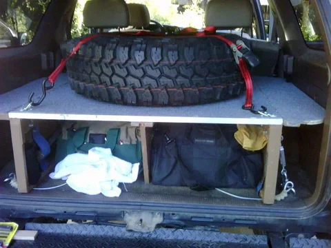

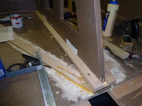

did a lot of reading on drawer system and decided to make one without pullouts and a center divider that is removable.
I liked Nick's as it was simple and functional and was similar to one I was thinking of...
had to do a lot of finess work to get it in.
I used 7/16s plywood, next time I would spend the extra money and get furniture grade plywood.
in truck.
This way I can configure my storage boxes however I decide.
Its a bit high, but I can stuff my wheel under there if I need to till I finish my tire mount.
let us say that a sander really hides a lot of sins
I like the storage compartments, you will enjoy them....they are a little high, but as long as you can see out the back you should be fine, plus you can fit more stuff underneath them...
Yours look better than mine :meh:

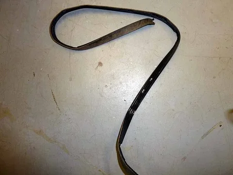

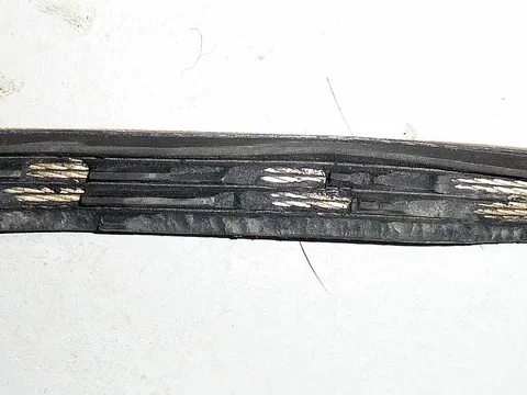

First up was the repair of my AC belt.
Stupid me thought it was the PS belt, and I searched high and low to the cause of my woes as it was grinding and whining and smoking over a short Xmas day drive.
But lo and behold... upon closer inspection I saw a belt at the bottom of the engine and was wondering why it looked like my AC belt was missing and saw it was my AC belt.
D@mn... now I need a new AC compressor $$1100 repair at dealer and about $150 used for just compressor.
I looked a bit closer and checked the idler pulley and it was frozen solid.
So off to the PC and yotatech Mud and I confirmed it was the idler pulley.
