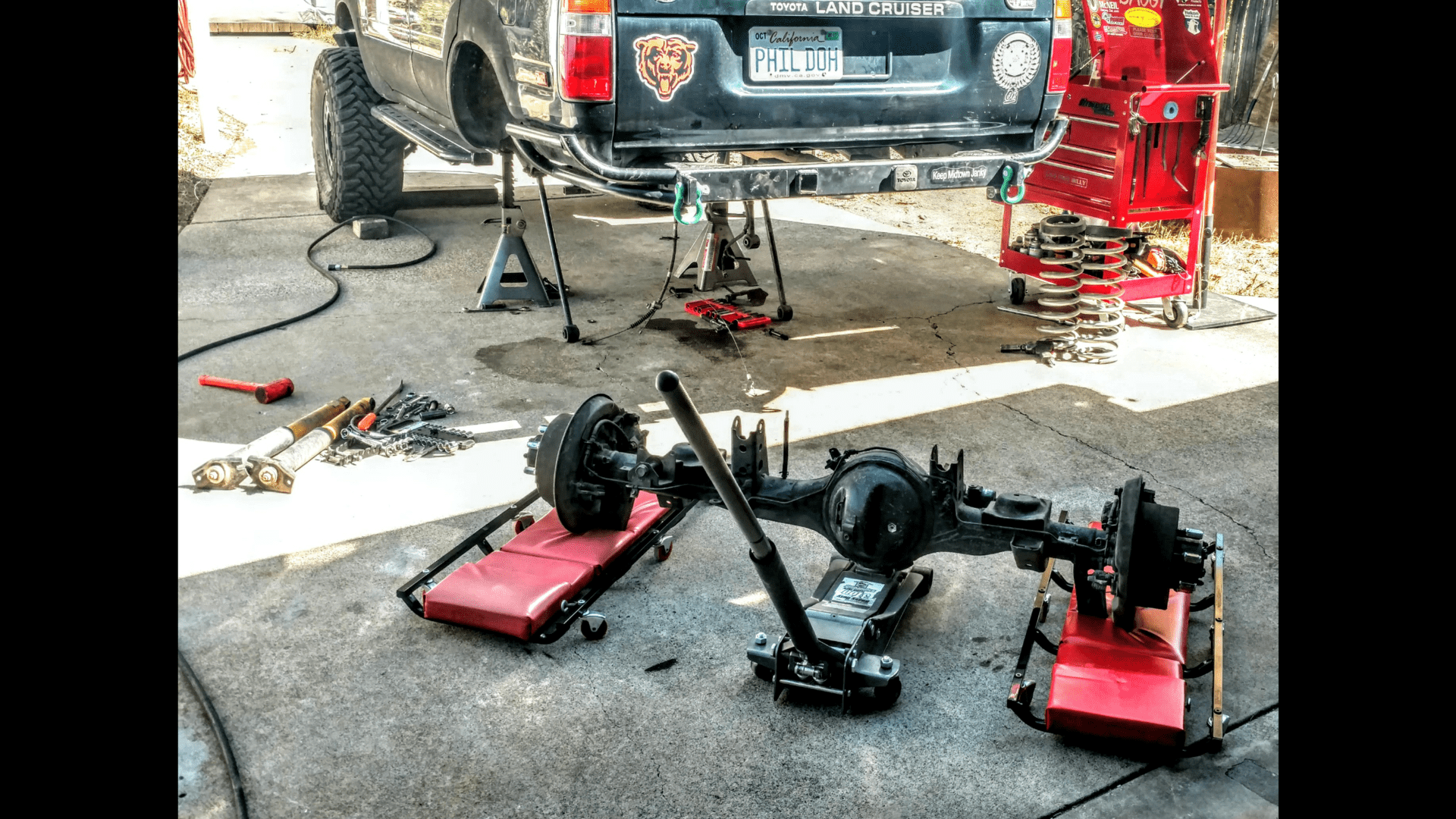

Finally picked up some springs this week. Slowly coming together...
I need to pick up new bushings (slider pad thingamajigs) as the ones on here are pretty rough. Then I need some weld washers for the other ideas I got going, and then the cutting can commence!
So... Making some progress. With my leg being an anchor and keeping me from working 8+hrs a day, and the weekly heat waves we've had in CA are slowing down my work ability far too much. Here's some recent stuff...
Rear end out.
Removing links and dropping the tank
All brackets cut off the housing
lower link brackets and panhard bracket removed, tank removed.
And how she sits as of this afternoon
The spring and shackle hangers are tacked in place so I could hang the springs. Tomorrow I will do some heavier tacks (I only have a 110 might welder), build a cradle support to lift the housing evenly (offset pumpkin(PITA)), and then be able to put the weight on the springs so I can set the pinion angle +1°. I also need to set the side to side location on the perches as this last image was just to get the housing under the rig and I was done for the day, so that's why the side to side position is not even/mismatched. So far everything is going smoothly, the link brackets we're a big pain to cut out, the panhard was easy, and I'm leaving the upper link mounts for now which I'll remove them when it's all ready for final assembly. The metal shavings from the grinder and spatter from the torch we're getting to me, I needed a break. I put a decent amount of weight on the springs with a floor jack and the shackle angle is pretty good, around 20-25° not fully lifted up. Since the center section is offset I didn't want to load it too much, as well as only tacked in, I avoided any problems. It was rad to see the "creeper joints" starting to work (if you didn't know, the shackle hangers have a Johnny Joint built in that helps the spring/shackle pivot with articulation). And the angle at hanging is -10° from vertical, so with weight and at full droop they should hit 30° or so which is close to their limit for the geometry. Yeah, I'm liking it so far. I'll try and take more pictures as the steps go by, the last thing I'm thinking about when I can't see from the sweat in my eyes is pulling out my phone for photo op's. I apologise for not being more thorough as I'd like to be, again my leg is my ultimate anchor just dragging me down. I got a bunch done today, and tomorrow actually I'm going to Tahoe to beat the heat (104° Sat/105° Sun). I'll b back at it Sunday morning bright n early. Cheers! :beer::rofl:
