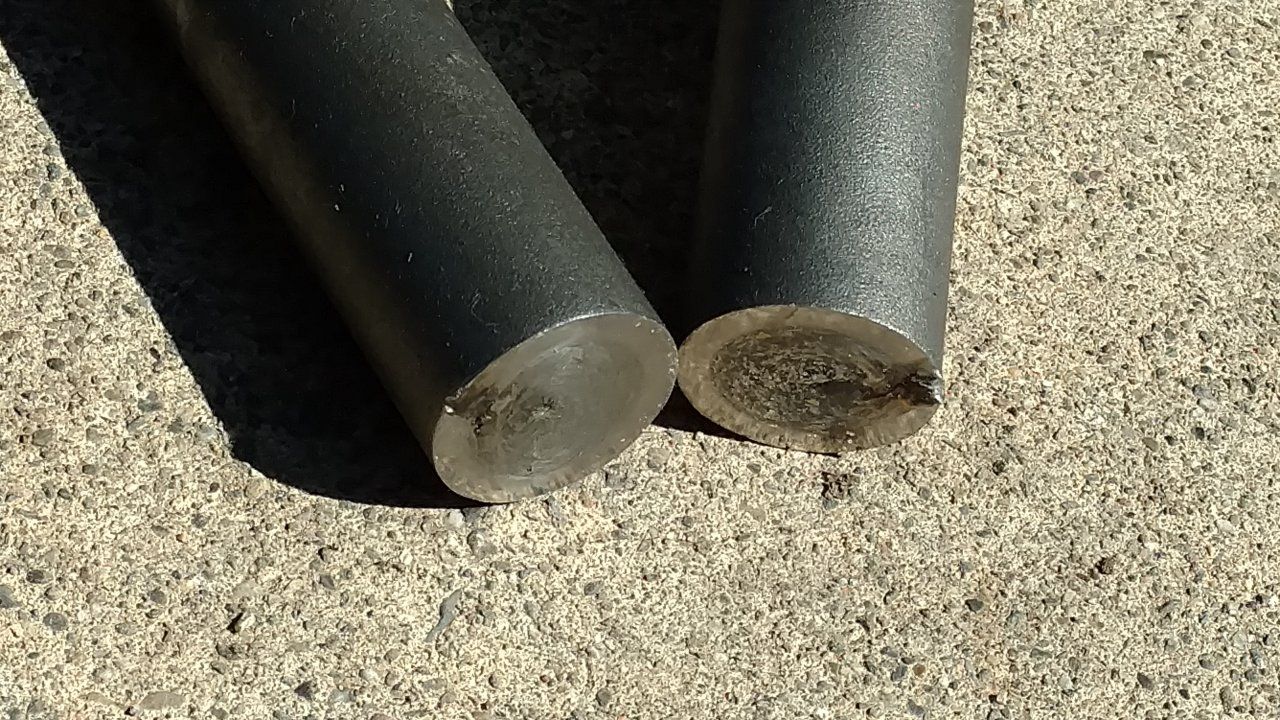

Im looking to replace my rear axle with chromolly.. If @Phildoh don't want them, i will take them for sure as soon as you want..

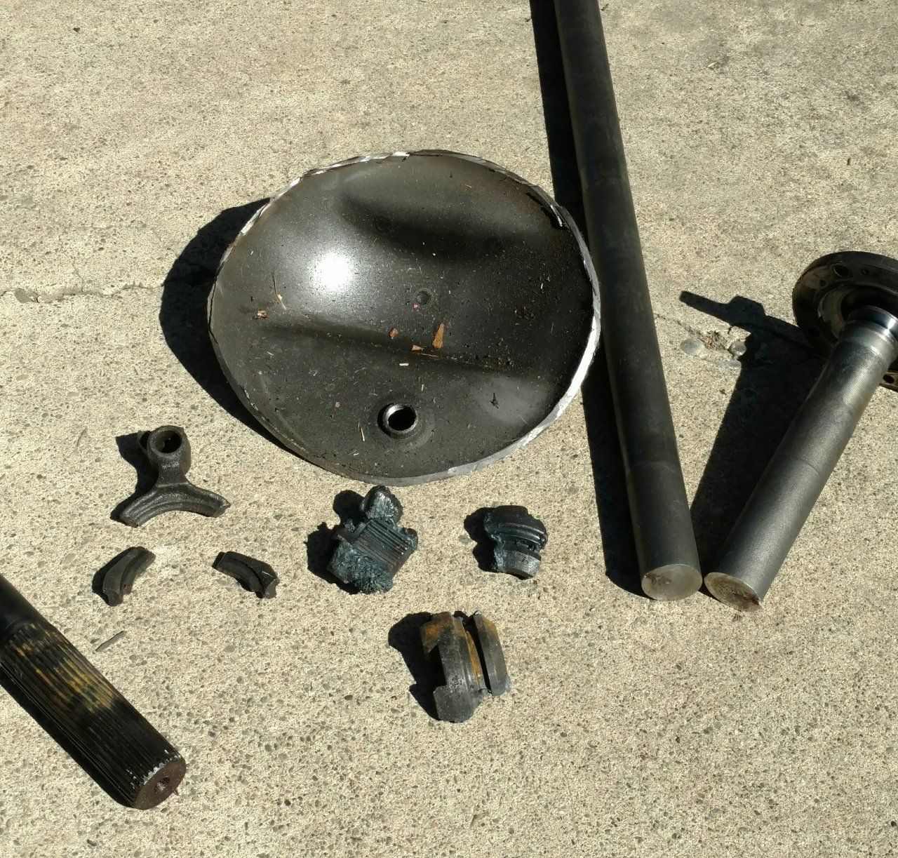

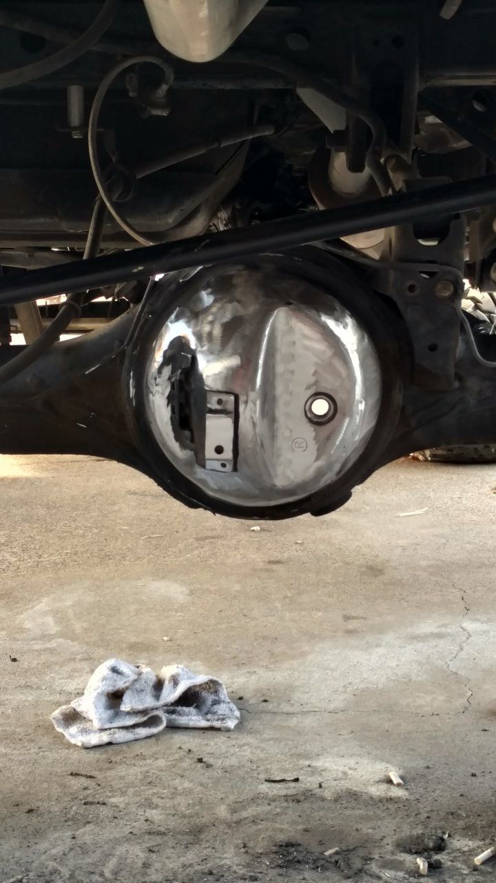

And, I got the housing welded back together. I wanted to weld something on it as an ode to the diff gods, but nothing comes to mind. Might just do a sad face or something in the morning.

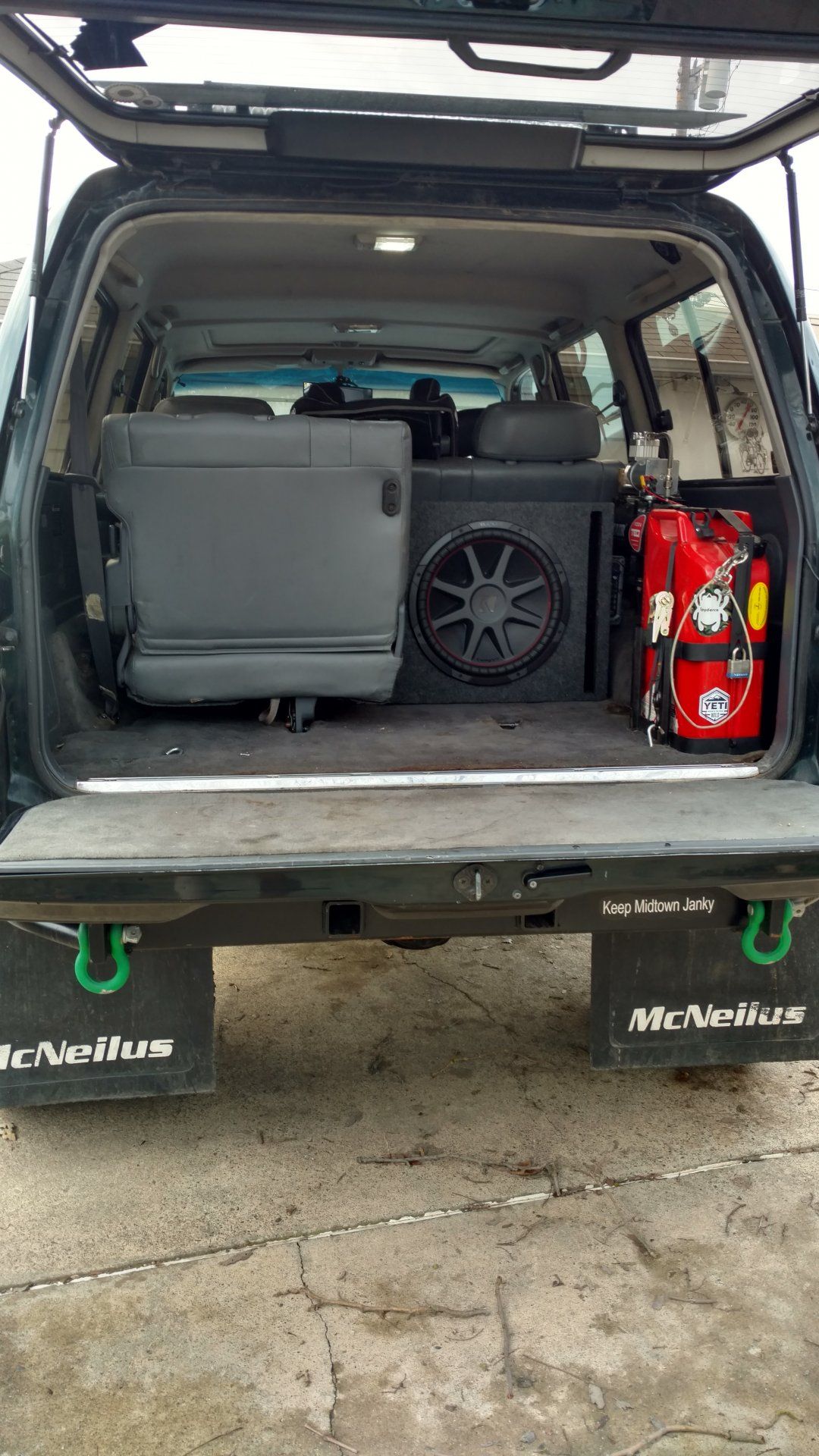

Hello all! Been busy, had a couple more skin graft surgeries so I've been down for a bit. Figured I'd toss up a pic of recent doings, including getting my Viair compressor installed with a custom brackets I welded up for the time being. Oh, and I went back to my roots, I needed some life within my stereo so in went a 15" kicker sub, ported box, and 600x1 amp. I'm beyond happy, except that now I have a hundred different rattles to deal with! Oh well. I'll update as things come along.

@nukegoat had a pair in San Jose he ever so kindly sold me for a very fair price, and he even threw in a tcase skid plate he had that was a homemade unit that needs a little tweaking, but I plan on working on that actually, in a couple weeks. The mudflaps, Ive wanted since I was a kid since my last name is McNeil. Sacramento fuzz usually leaves modified rigs alone if you're running these big bastards, so I'm all in for not seeing Christmas lights in the rear view!

Damn that sucks. You need a Landtank modified axle shaft so that doesn't happen again.
I've looked into chromo rears, and I talked to RCV as I run their front shafts, and he (name I forgot) said that he will build me a pair for $600, same as anyone else, and they carry the no questions, no BS warranty like the front's do. I looked into other brands, and both I found had a strict warranty policy that if they were twisted they wouldn't warranty them, they had to be "broken" to receive a replacement axle. Pure BS IMO! So RCV will get my business again when I have $600 to blow on shafts. Tax return is already accounted for, and as if right now I still need to get my PS pump installed and the new cooler as well. Luckily I have a little Civic to put around town in, I don't mind driving "LaFawnduh" at all, but without PS and 37's make it a PITA! Especially parking that slug in these economy spaces everywhere!

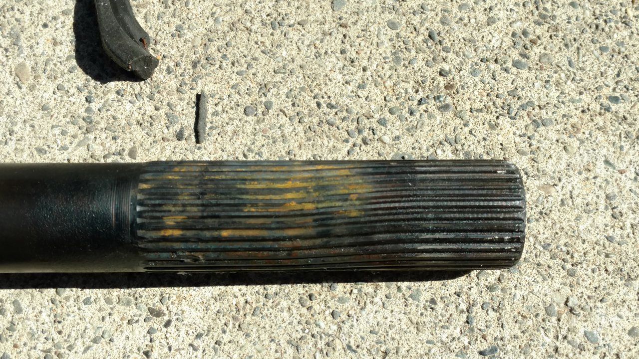

the @landtank axle is a modified oem axle. Allows you to still pull the twisted shaft oUT of axle housing. I think he charges 175 or 200. You would rather twist a shaft than break your whole rear diff assembly. Much cheaper. If you do chromos your diff or hub studs would break instead of axle shafts.

I like your solution for internal jerry can storage. What's the other side of the ratchet strap fastened to?

I did a search for this and found one thread on it, looks like splines removed in sections on the short side rear? I wonder if the specs are out there so people can have this done locally at a shop? Seems like a good idea.
